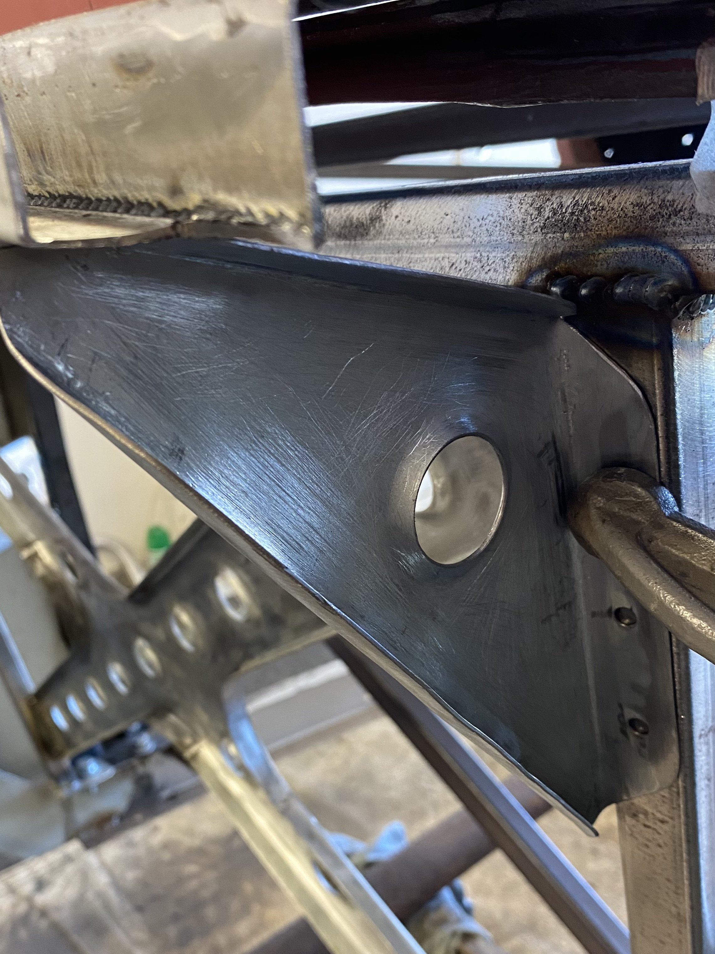

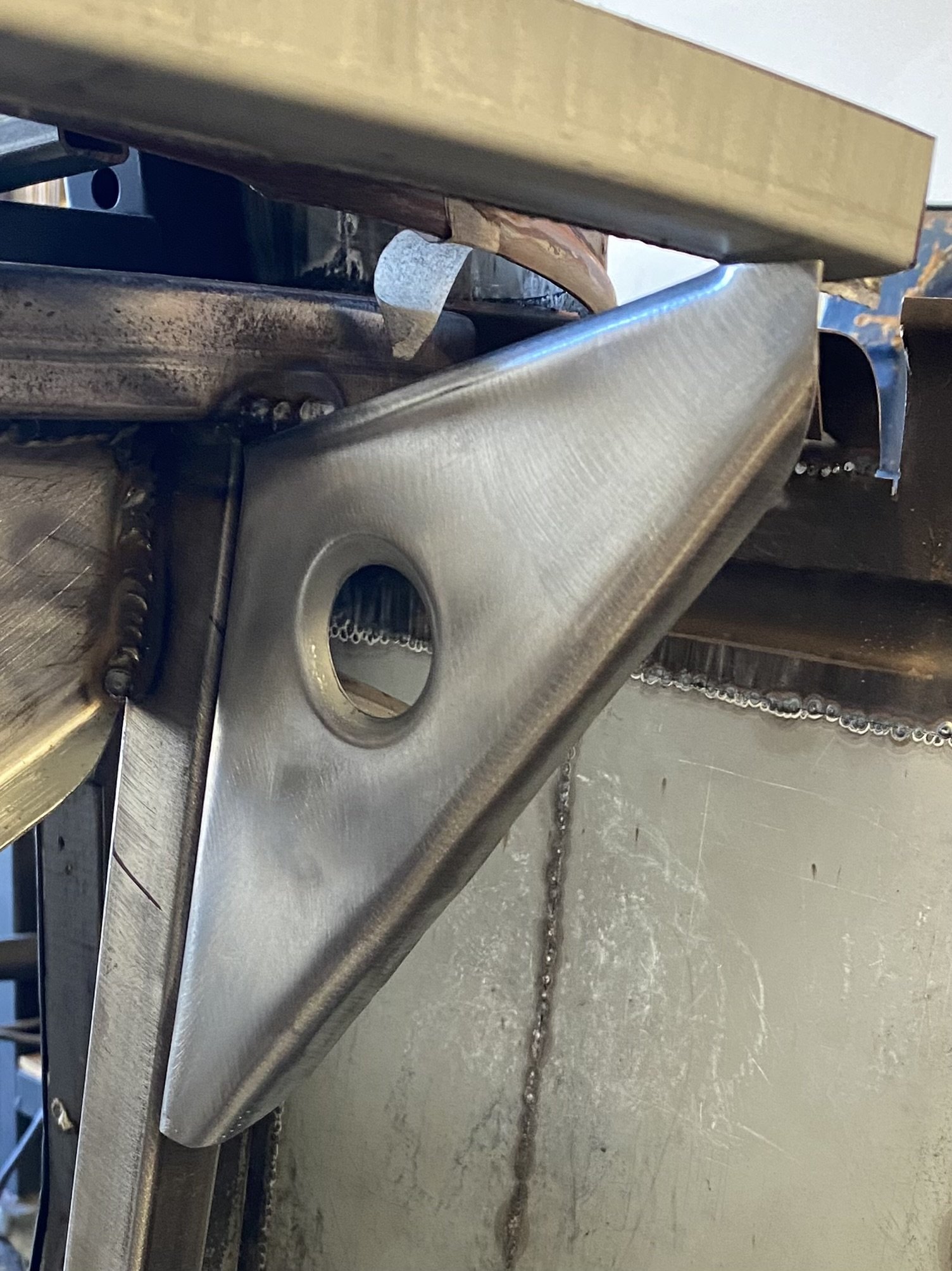

  1. Making up the last brackets for the boot area.

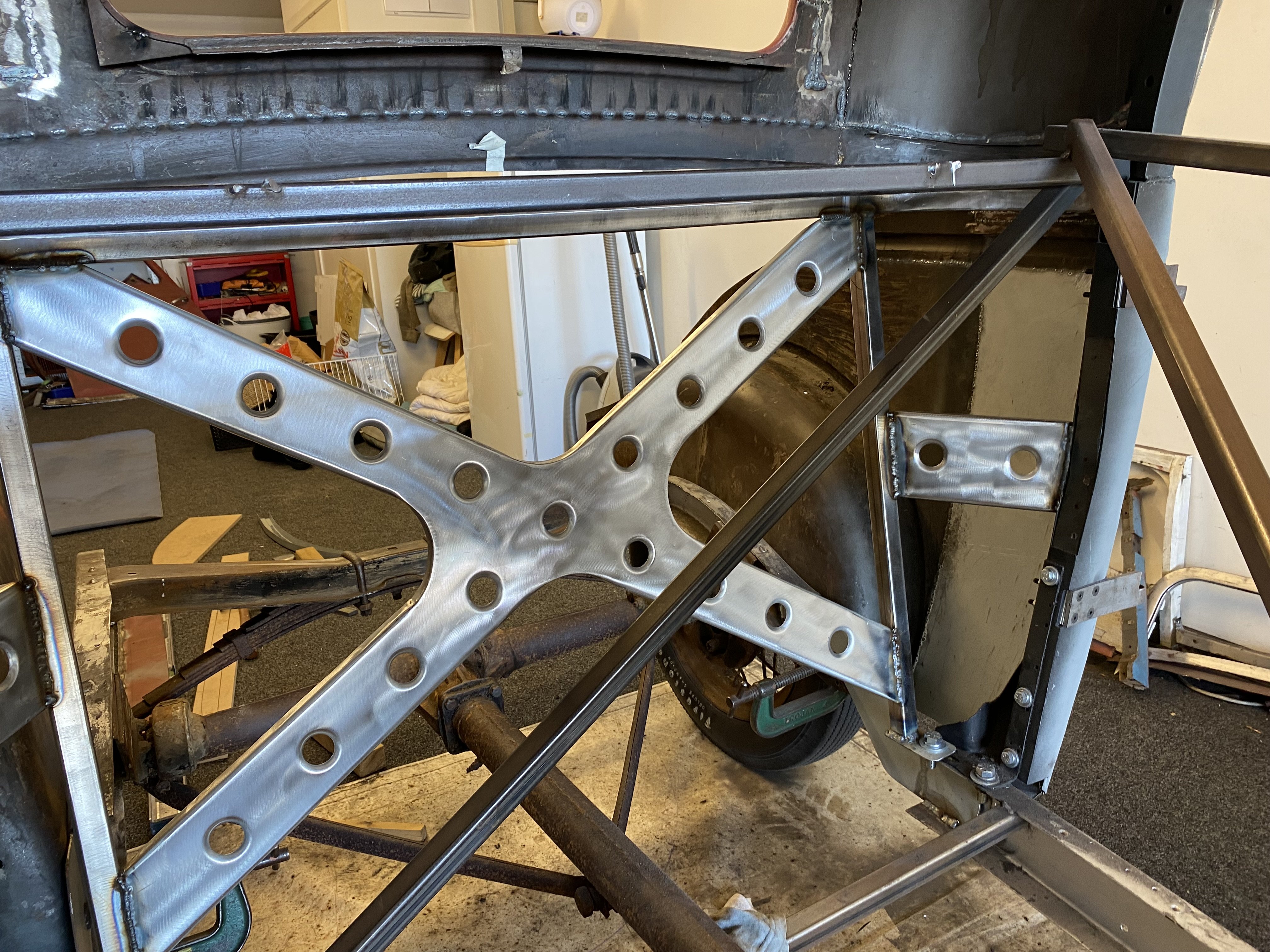

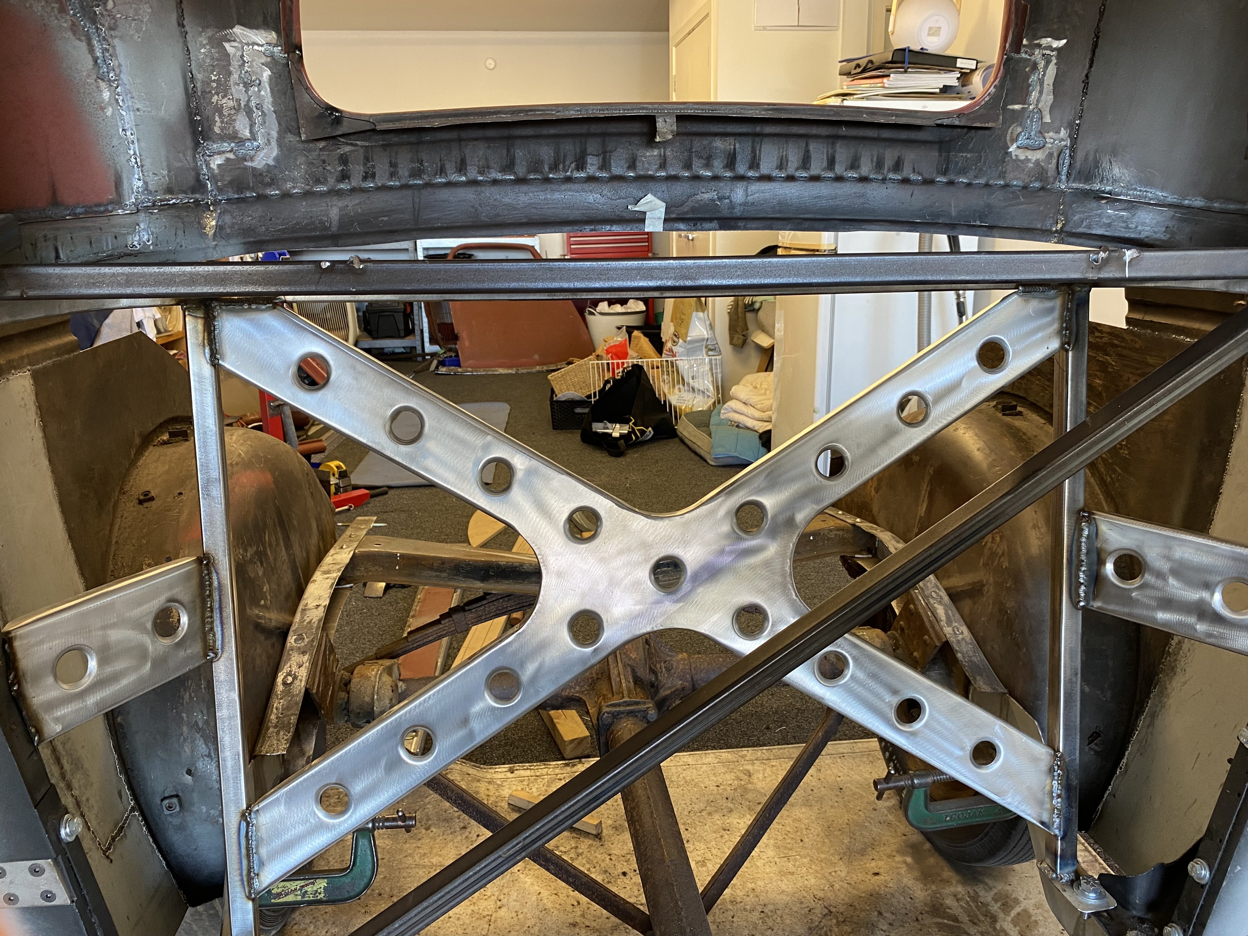

  2. I’ve got all the floor braces done which give me mounting points for the floor.
  3. This is what it looks like
  4. That ties in the last bit of the boot area. Im going to work on connecting the bottom of the b pillars to the front cowl area to lock that area in and it will give me a piece to eventually weld the floor to and make the bottom swage line under the doors that the ford Y doesn’t actually have.

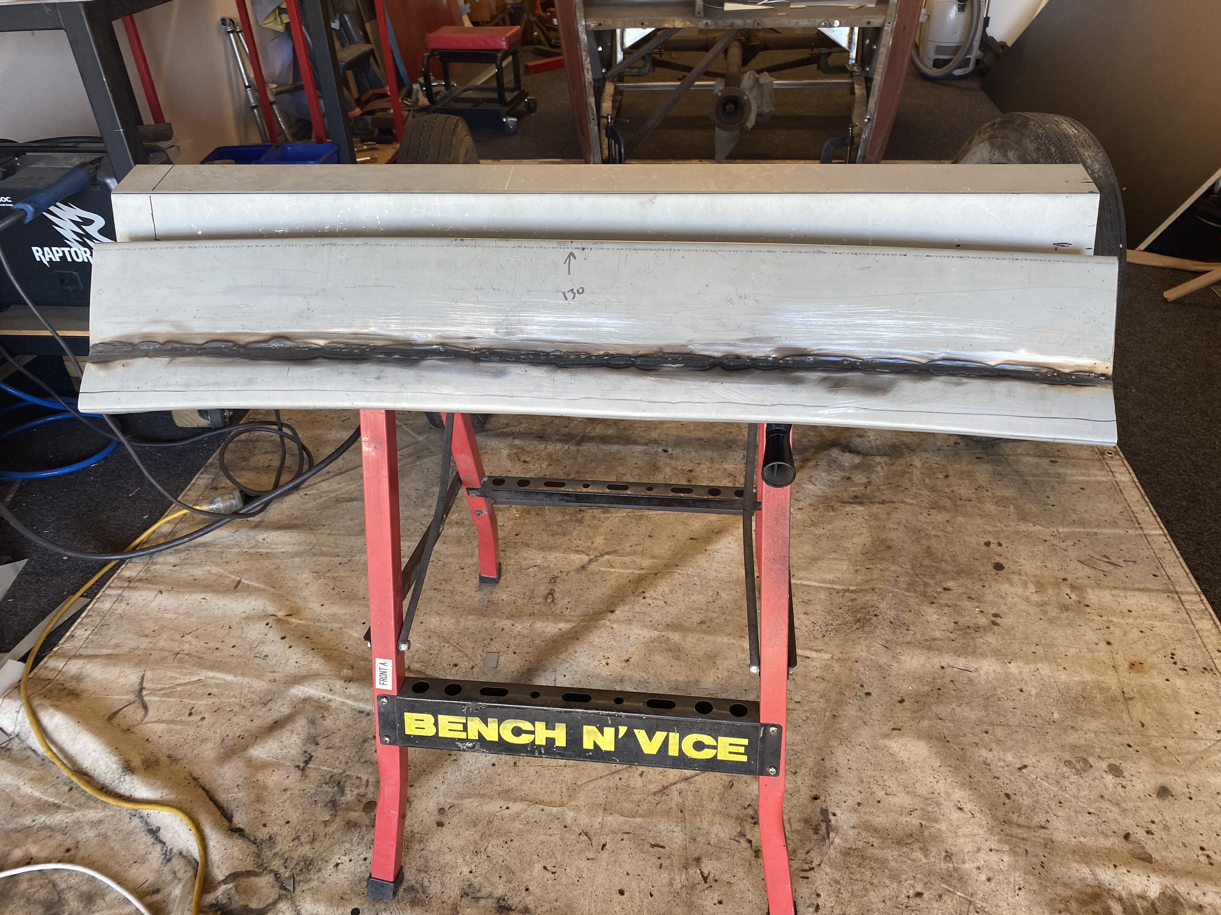

  6. Finally got the rear splash pan area done. this has been the hardest part to make so far by a mile. so many different curves. Bought myself a small Eastwood mini English wheel and had a crack at it. Come out pretty good.

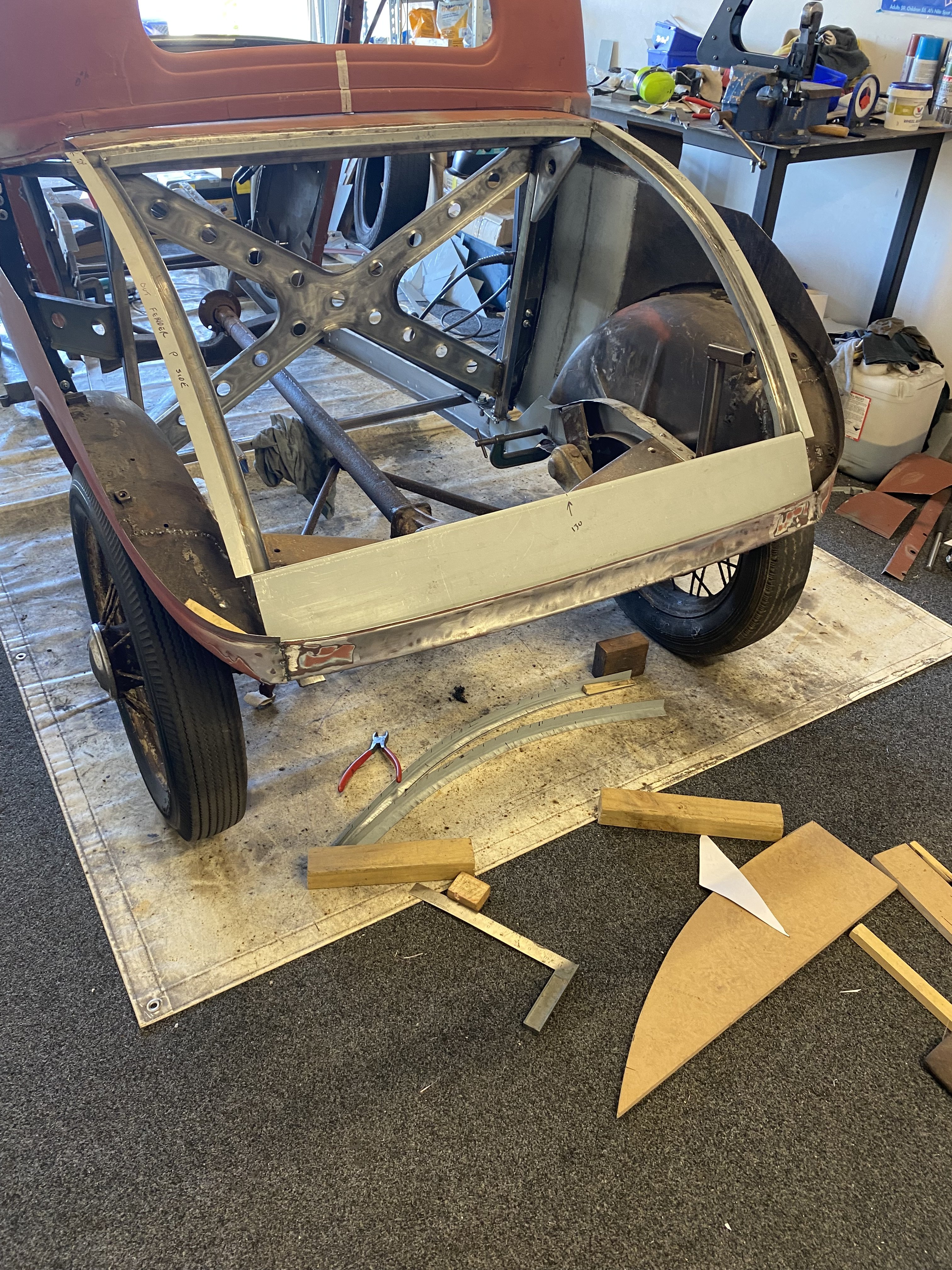

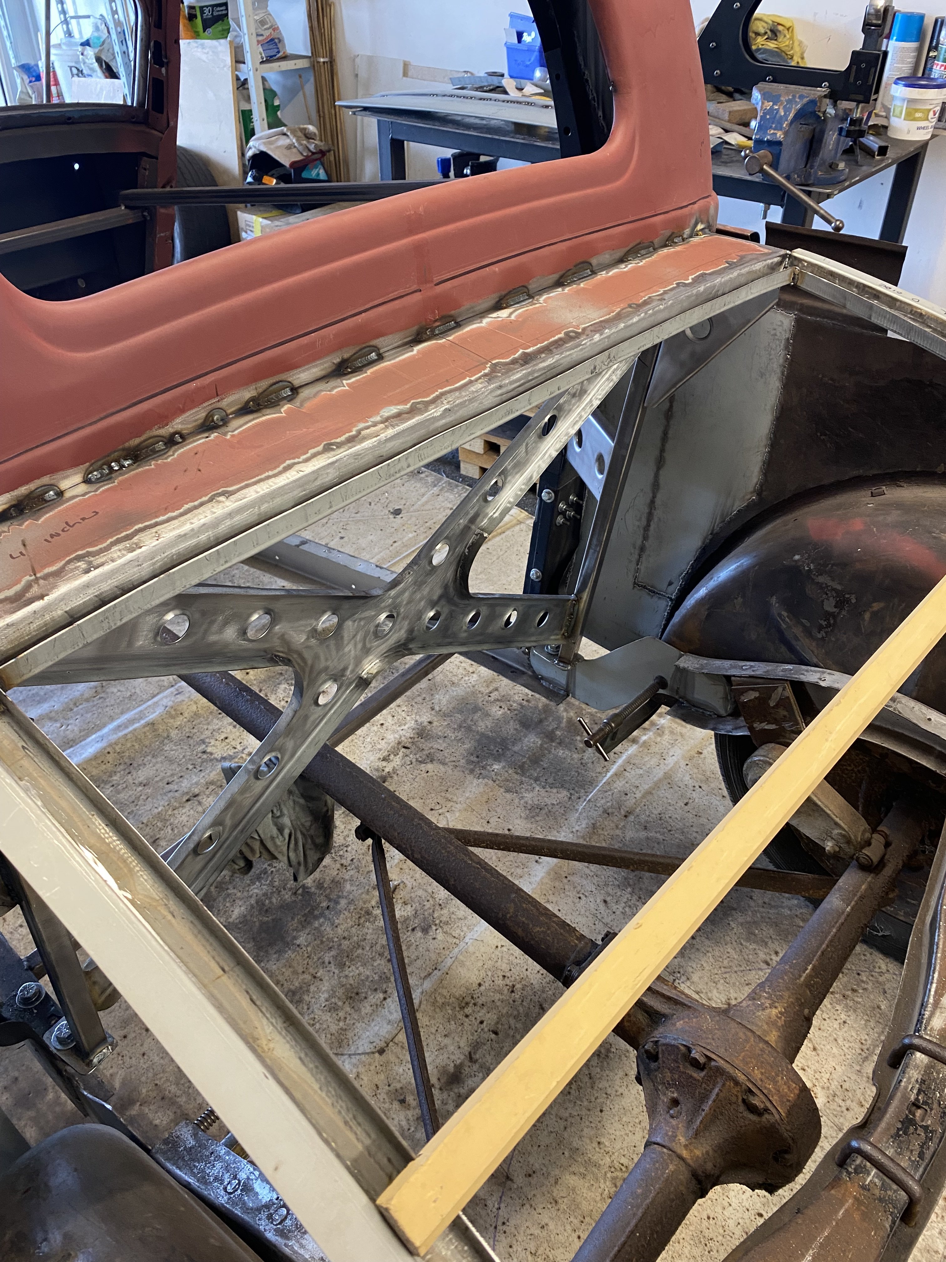

  7. Started welding up the rear boot area

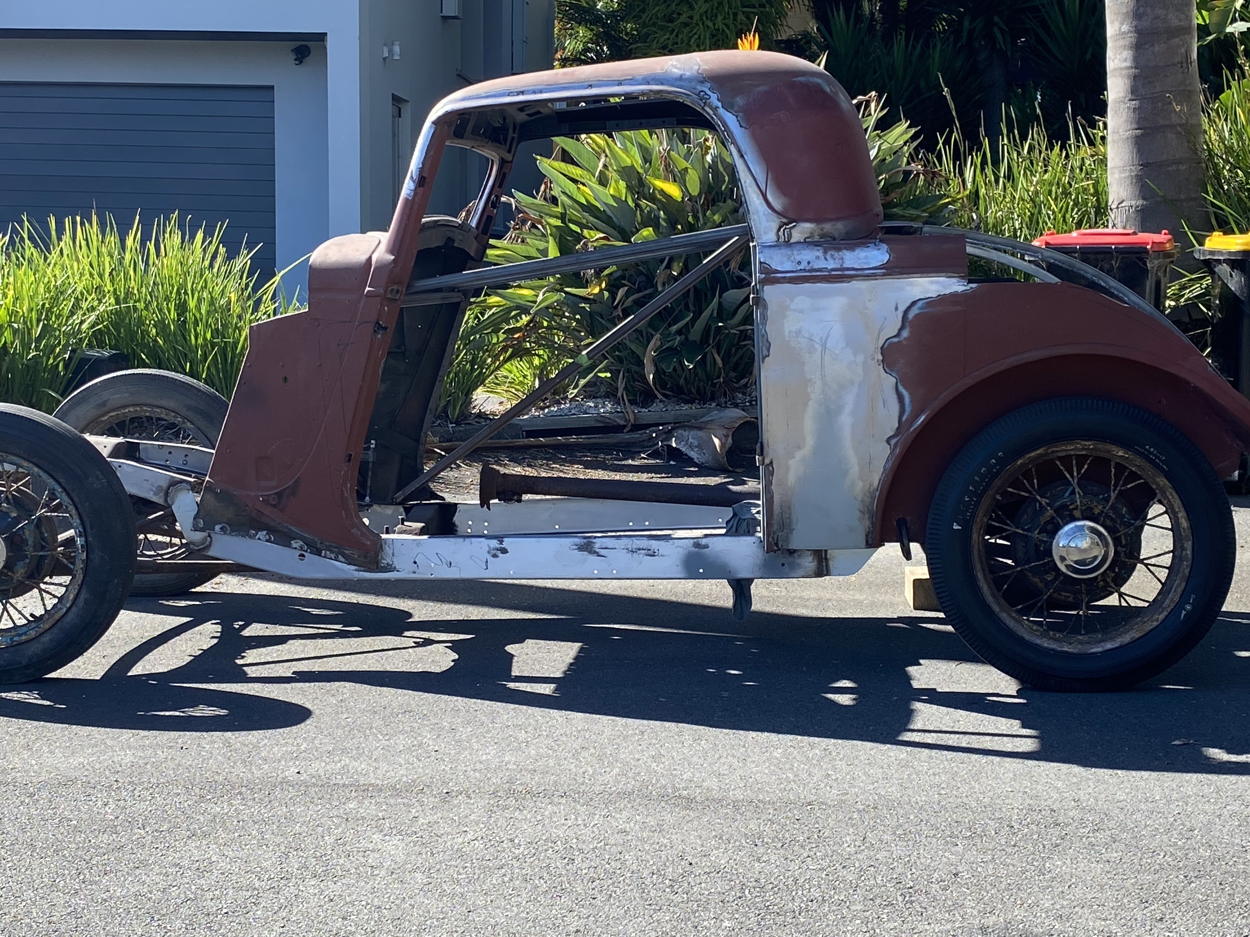

  8. Finally got the car outside to see if the proportions of the rear boot area looks right.

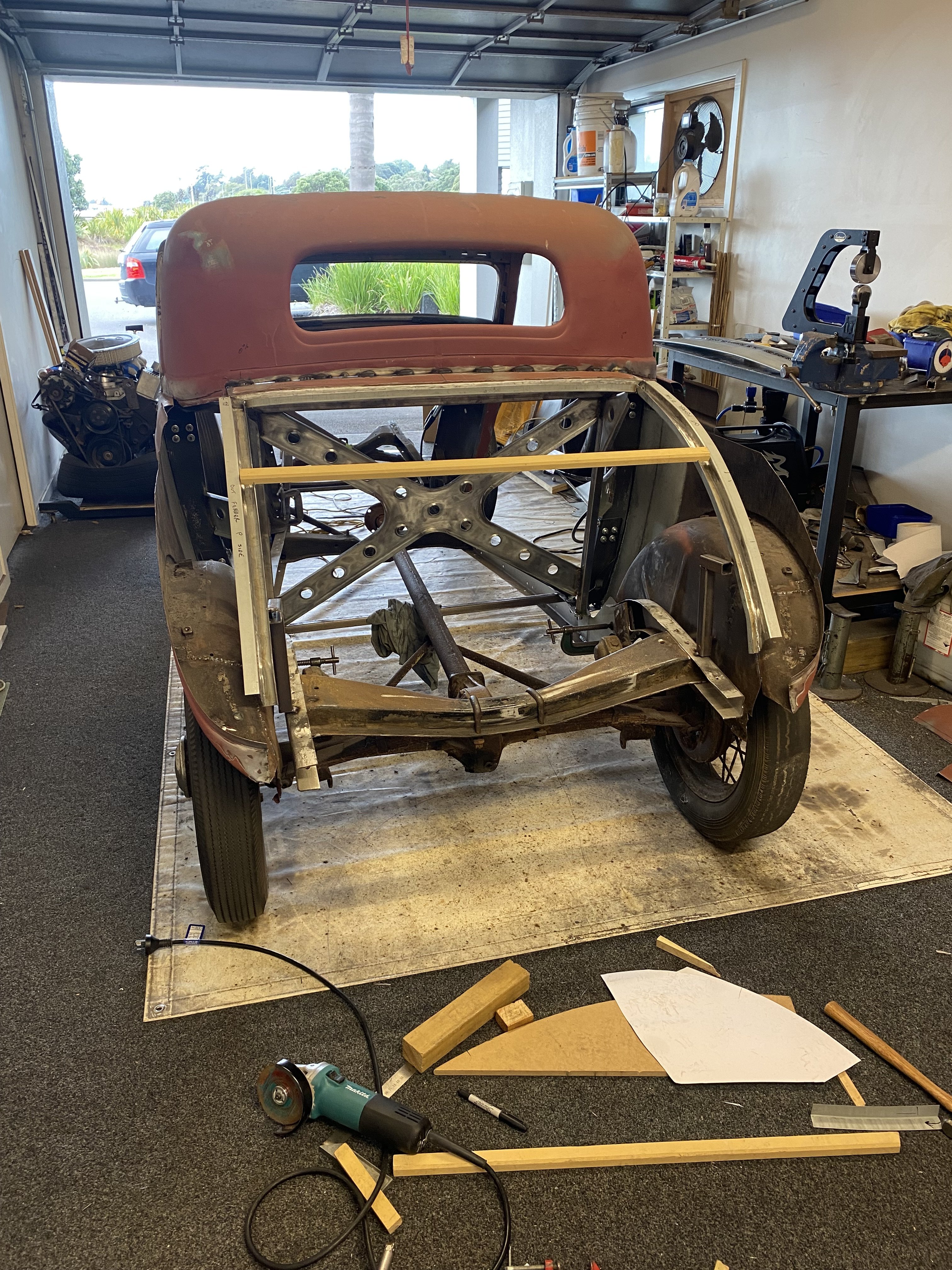

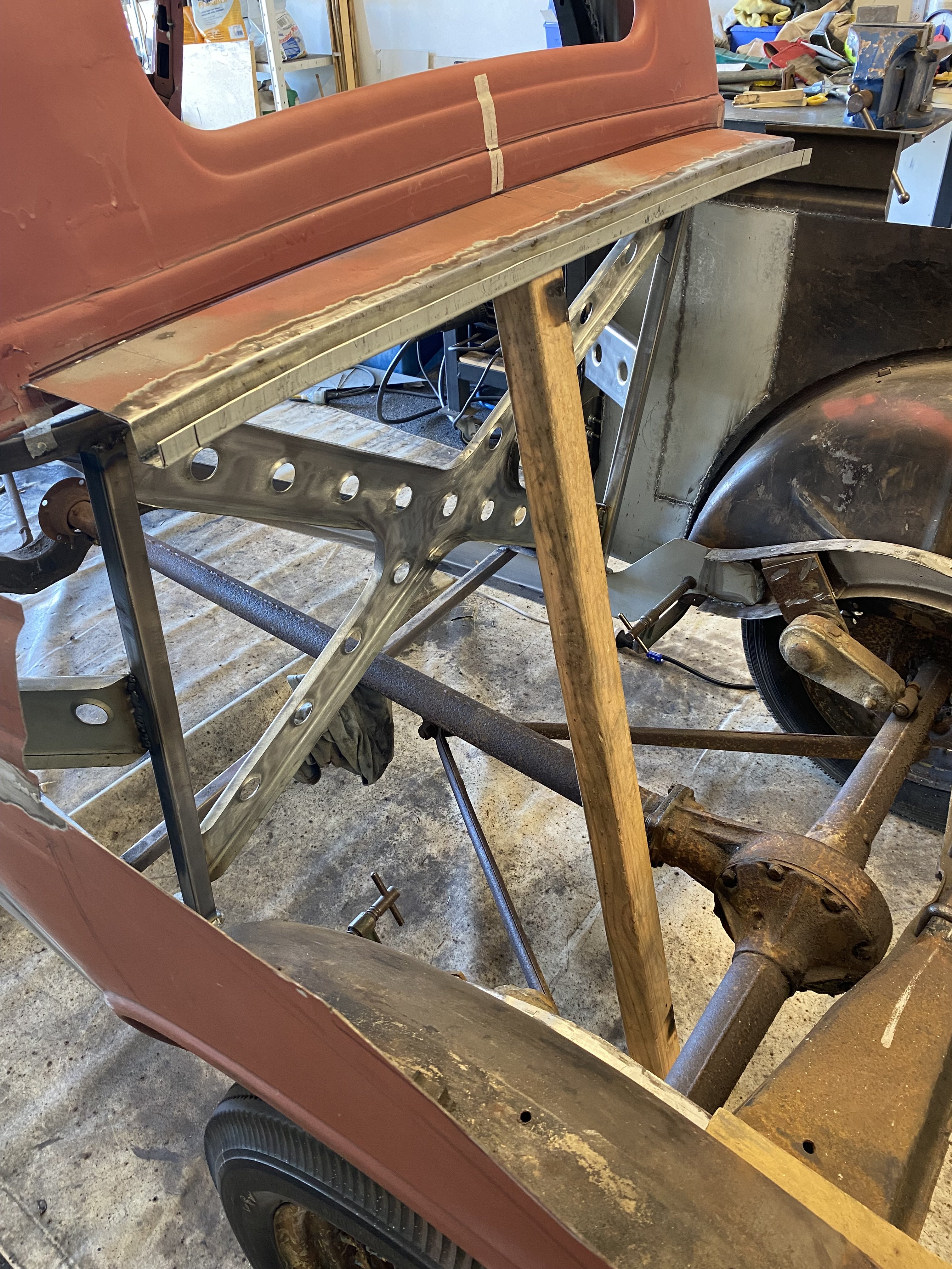

  9. Tacking it all together to see we’re we are at. Ive decided to make a brand new rear splash pan as the old one is very dinged up and the swage curve is actually inverted not curved out like a big 34 coupe.

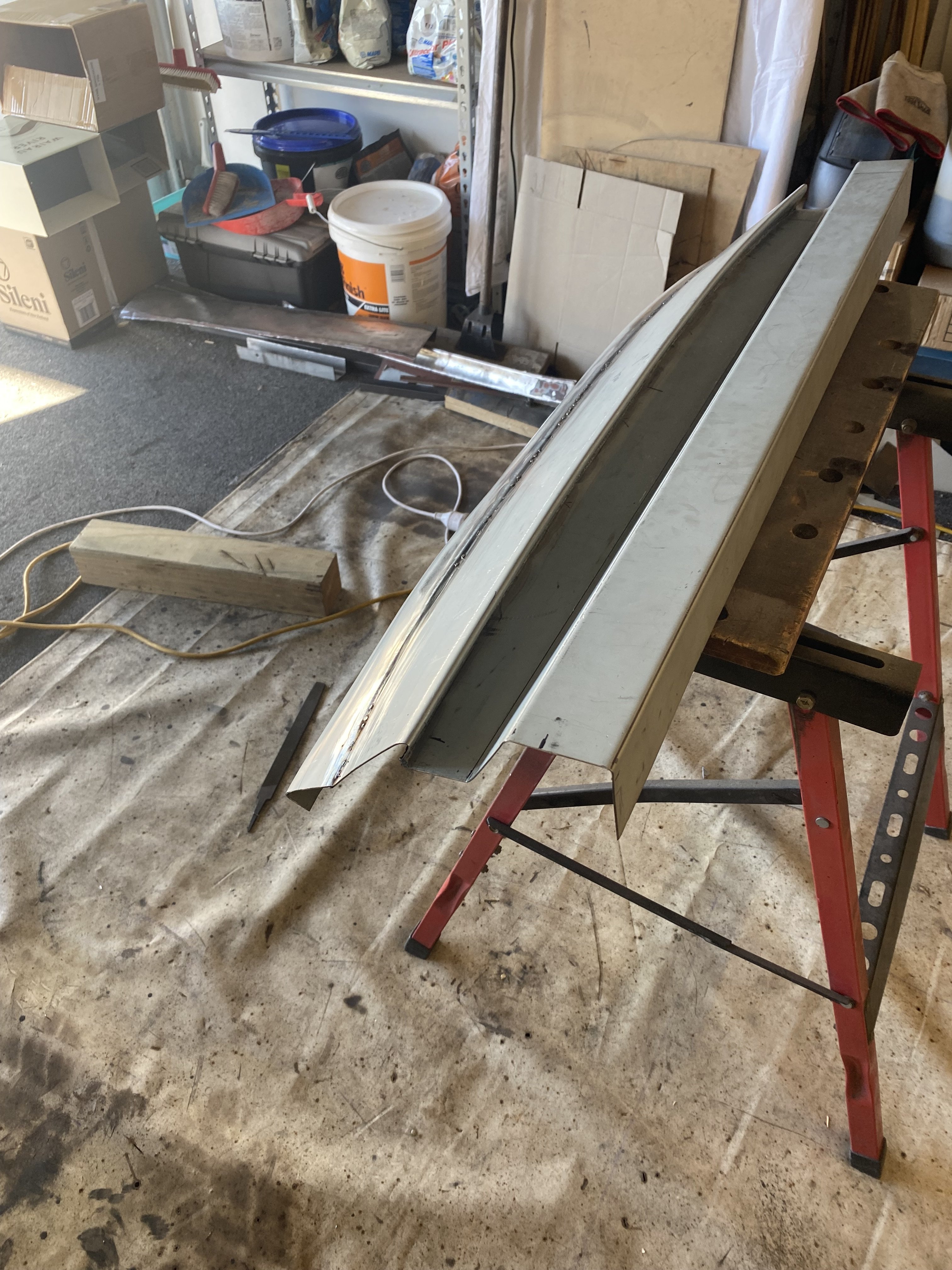

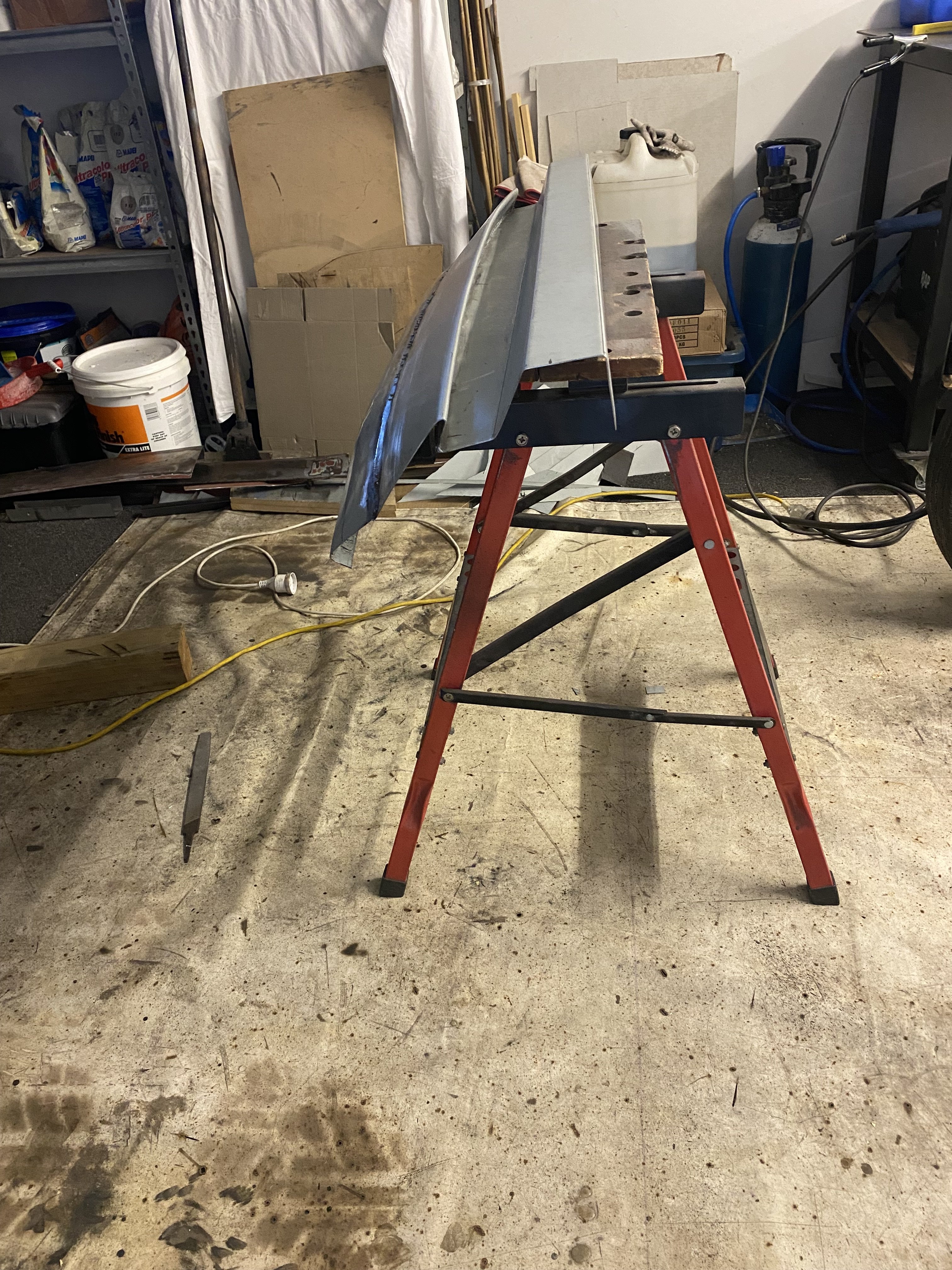

  11. Just finished welding up the boot channels and folding up the lower floor brace panel.

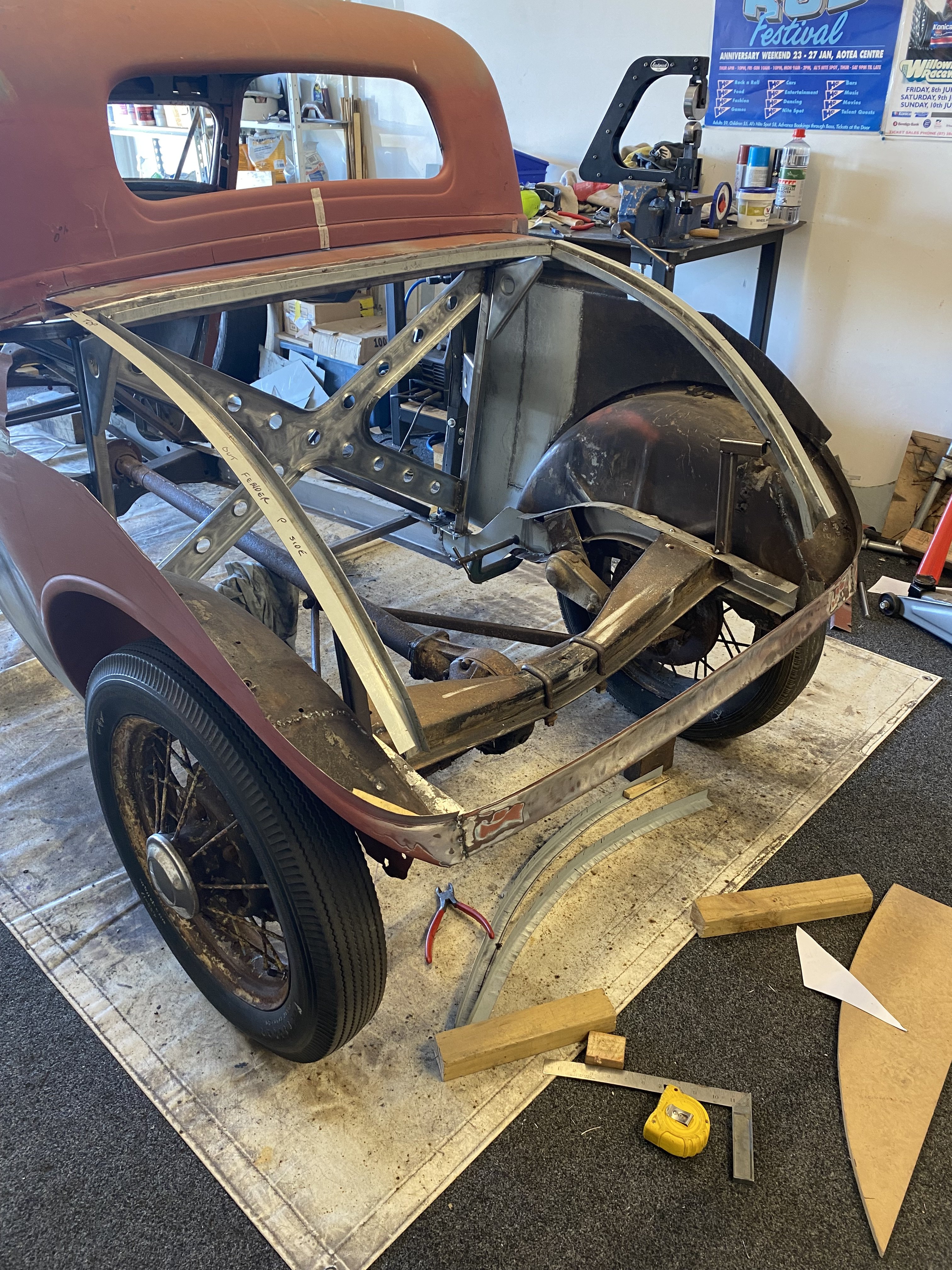

  12. Starting on mocking up the boot area Got the top pieces channel welded in and slotted we’re it needs to be.

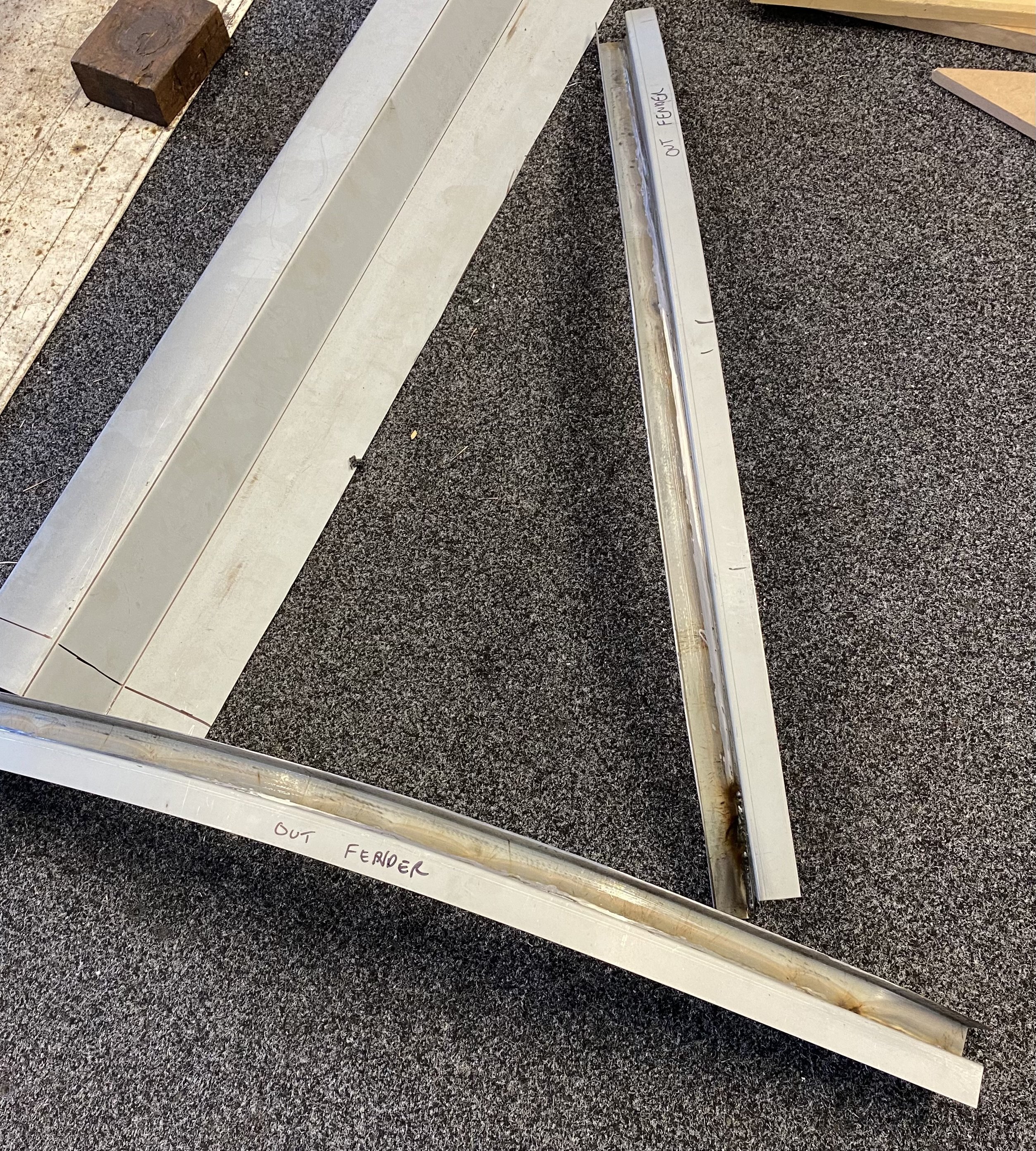

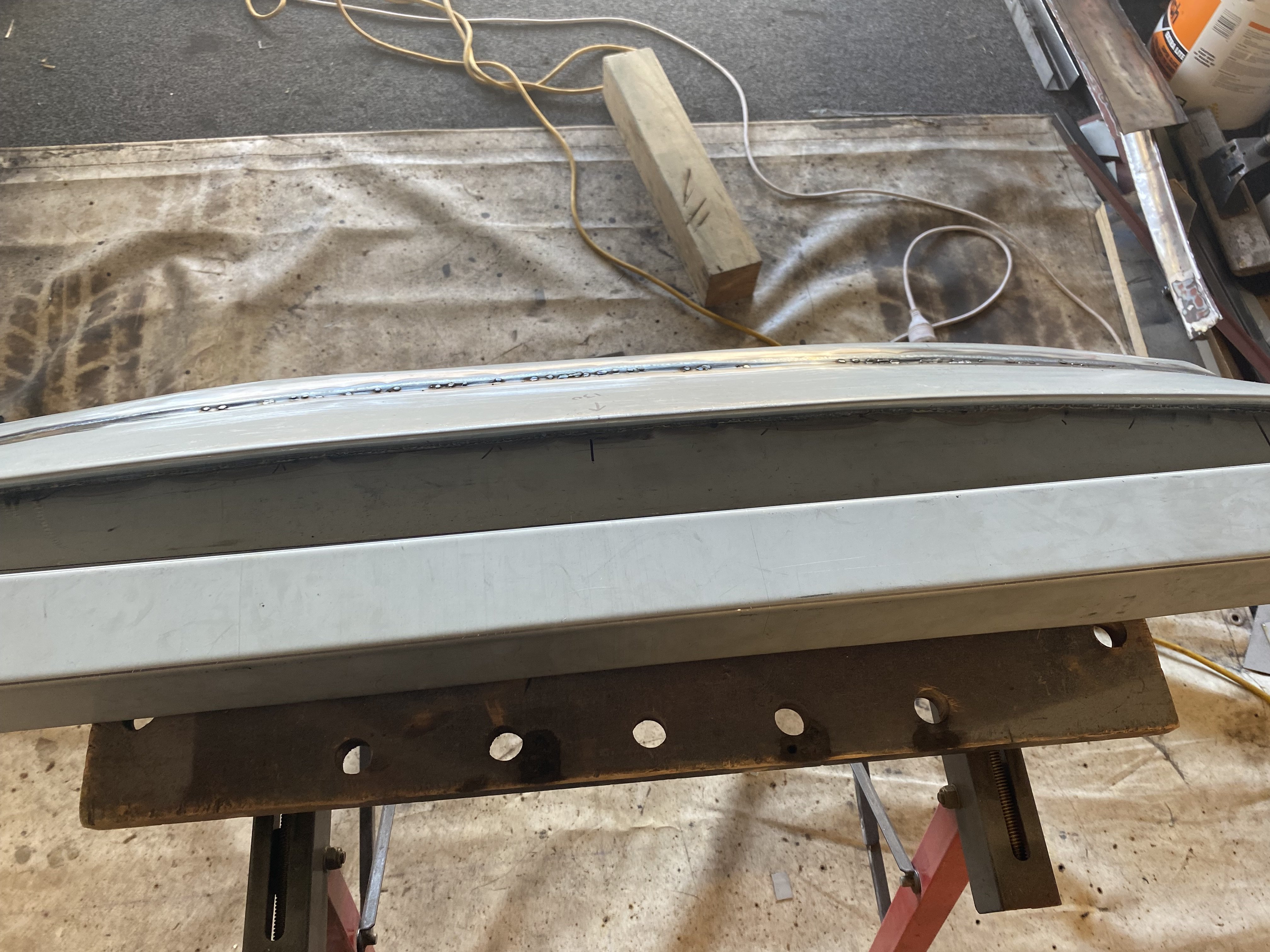

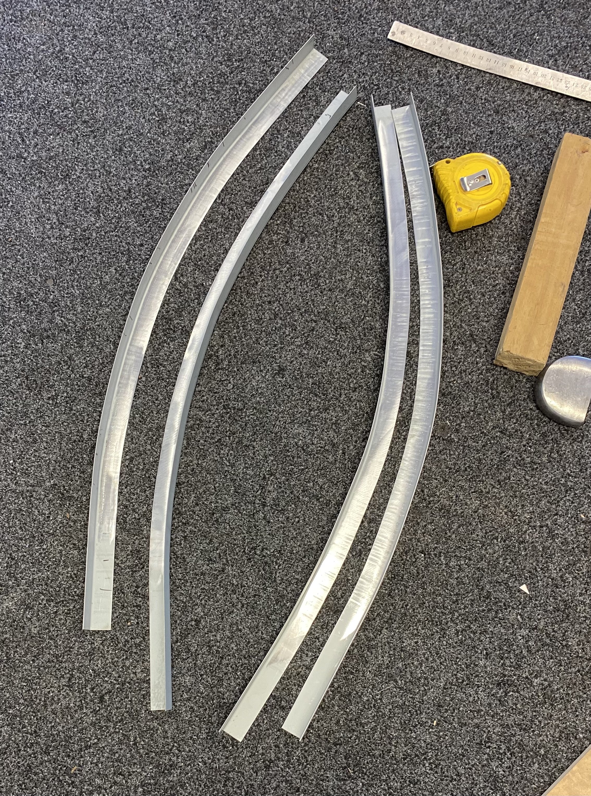

  13. Next job is the boot channels which will help form the shape of the rear quarters. Bit of shrinker/ stretcher work and there ready to weld together.
