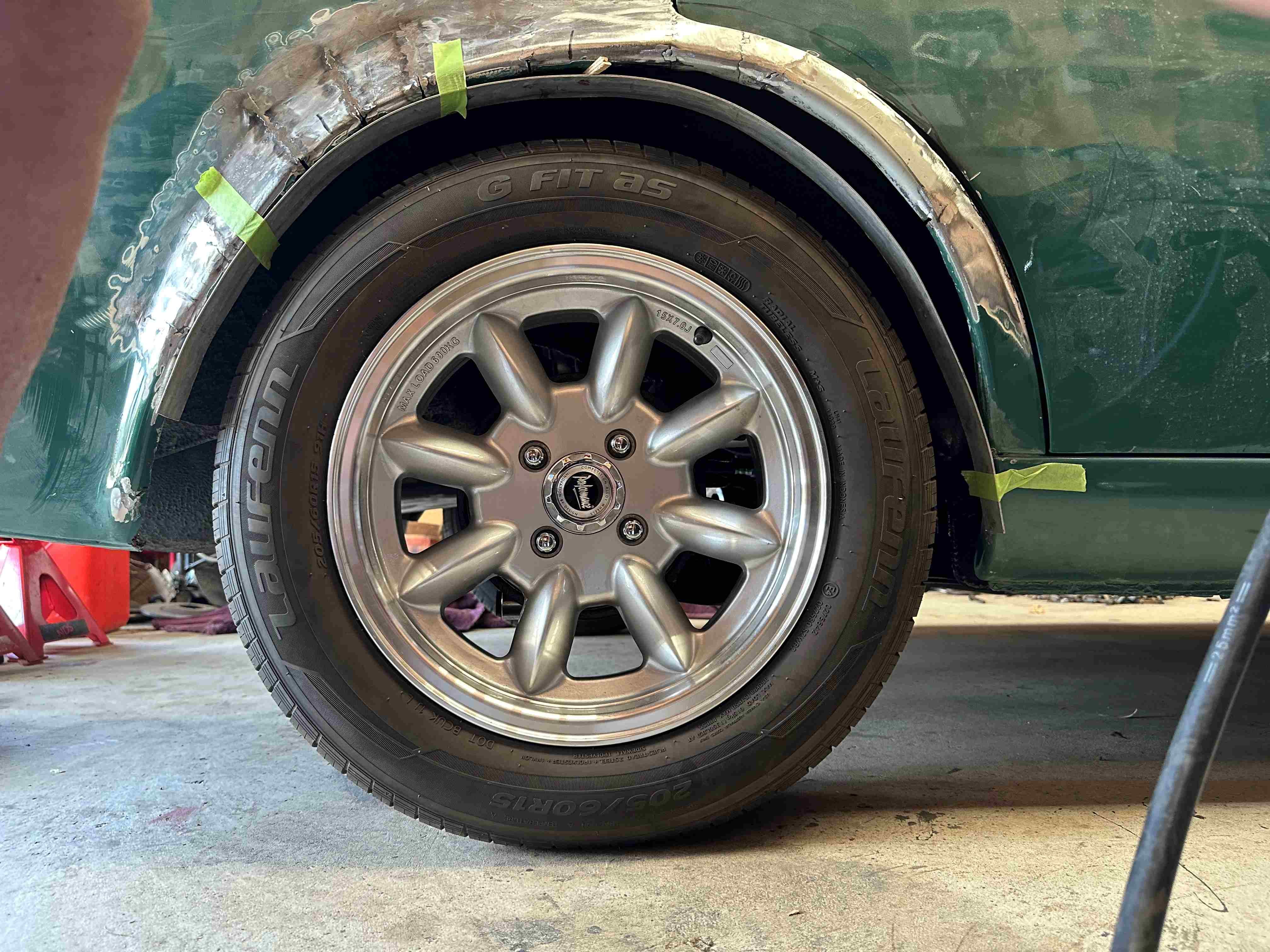

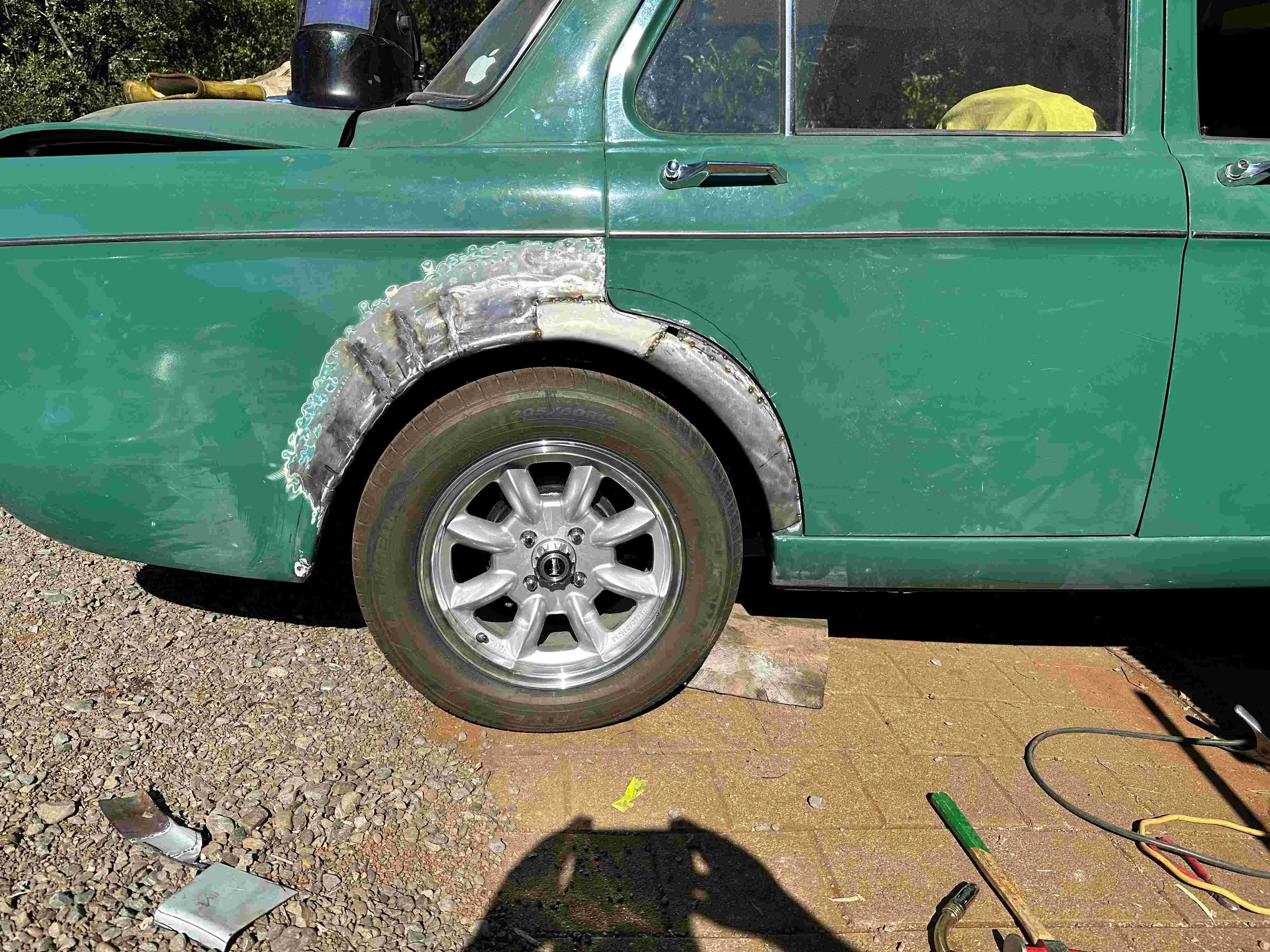

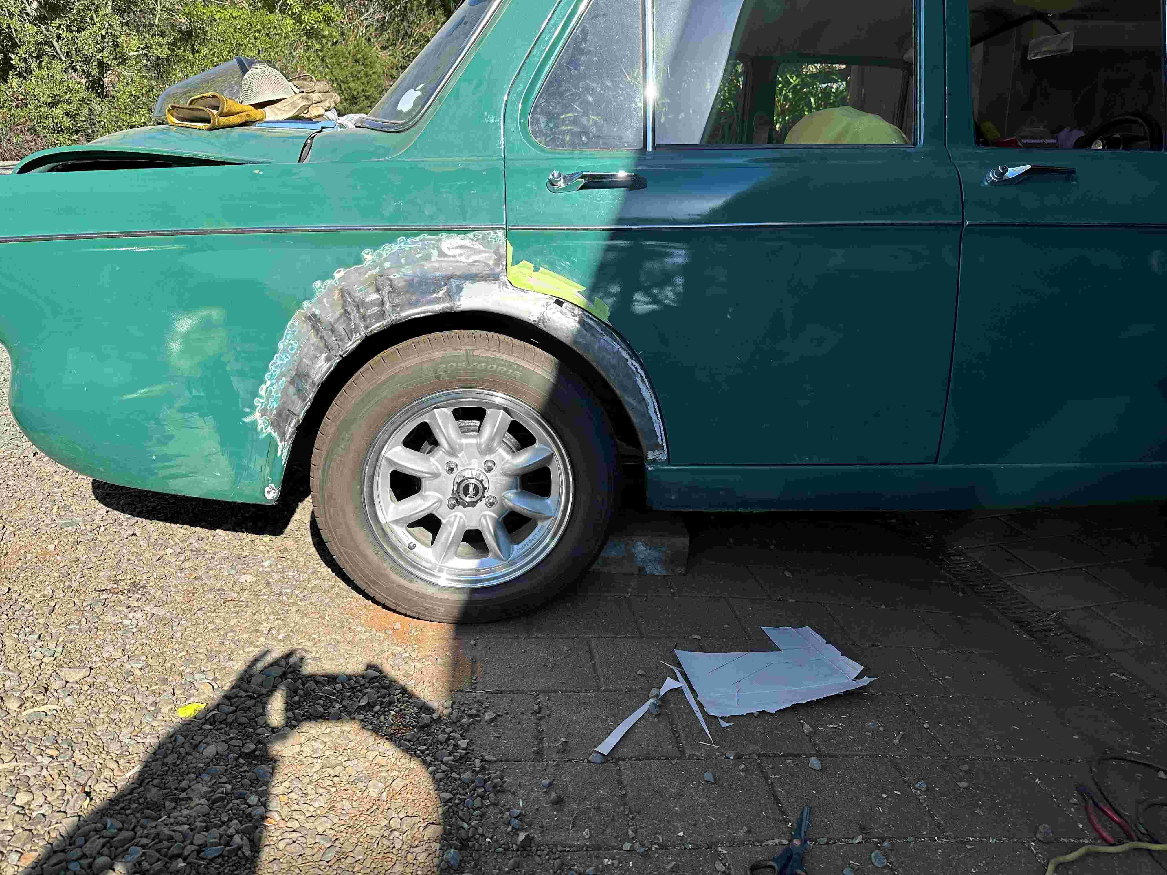

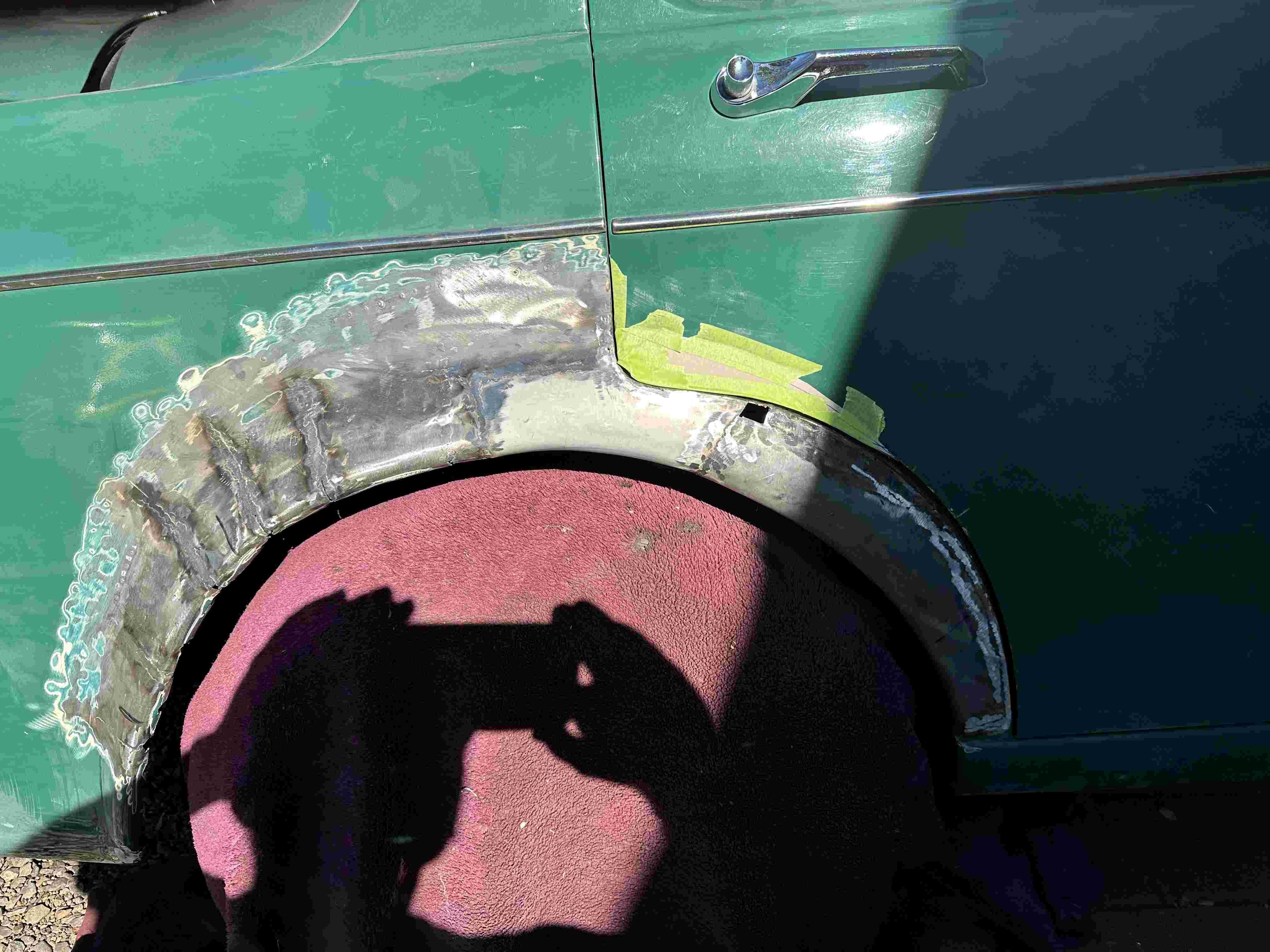

So back to flaring the rear guards. I flared it to (close'ish ) to the original shape of the arch. They are nowhere near symmetrical and once flared it looks crap really. So I marked the shape of the rear half of the arch and then copied it over using plycad and some cardboard cad so it was close to symmetrical. Then I bent a strip of aluminum roughly to the shape of the ply and held it in place with tape to see how it would look. I think it will look much better if I can shape some panel streel up to that shape and weld it on.
My plan is. I copied the shape over to a piece a timber and I will shape the panel steel on this and hopefully it will be close. Has to work as I don't have a plan B yet. We will see tomorrow.
I think the rear will sit a bit lower when everything settles after use so will work at this space for now.

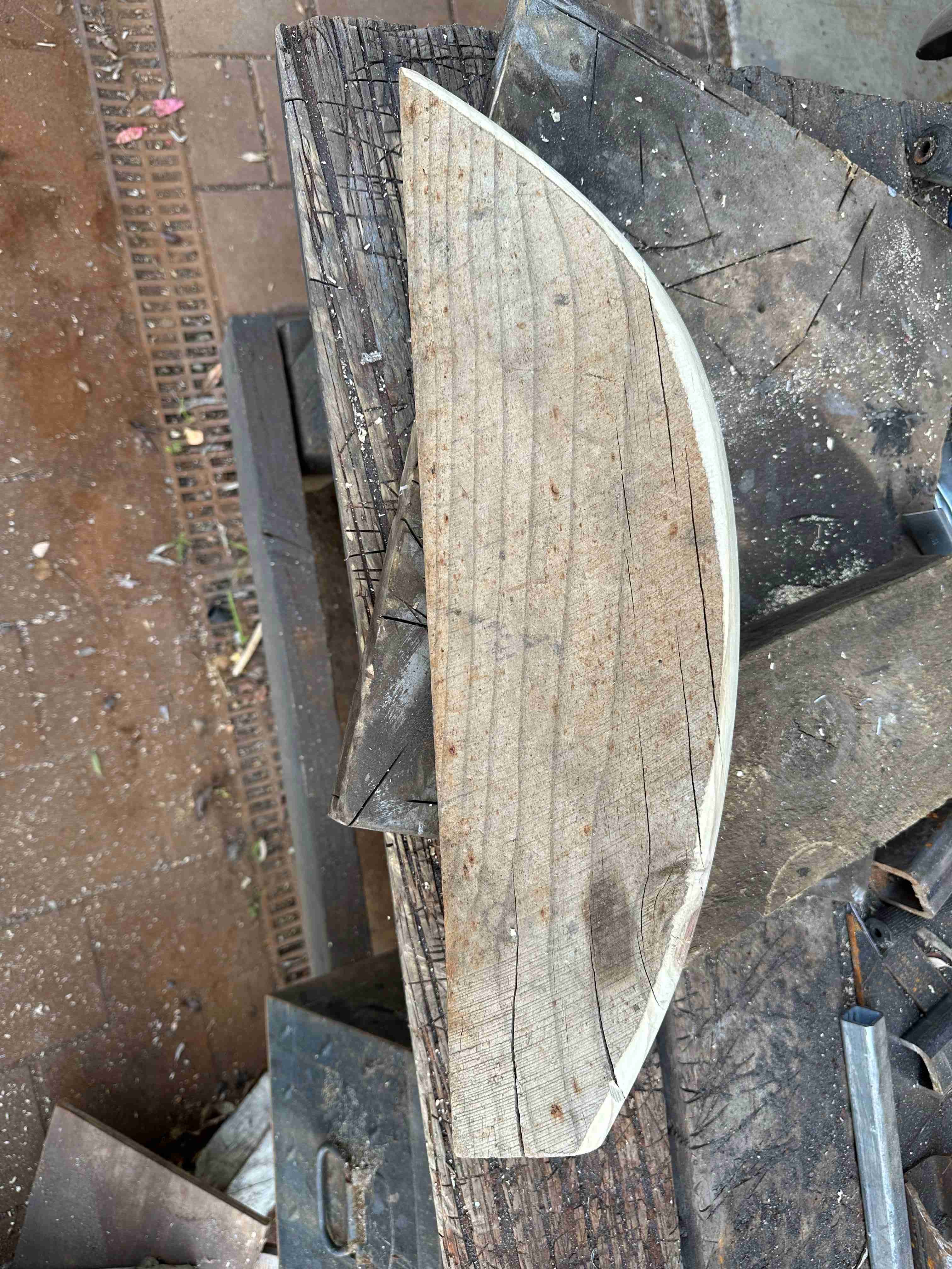

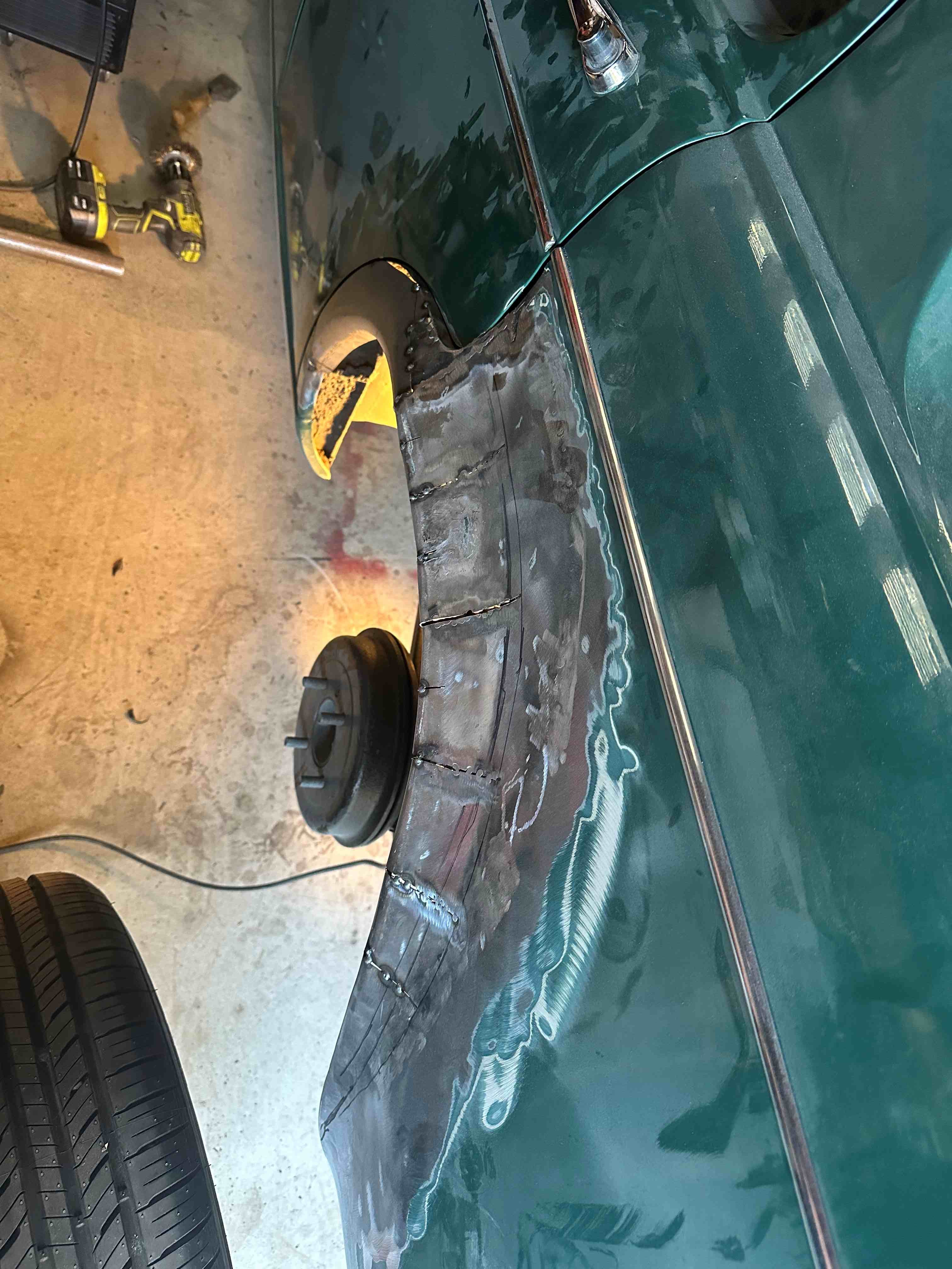

So I totally fooked up the wooden buck as I needed the opposite shape, so I made up a new one the right way around.

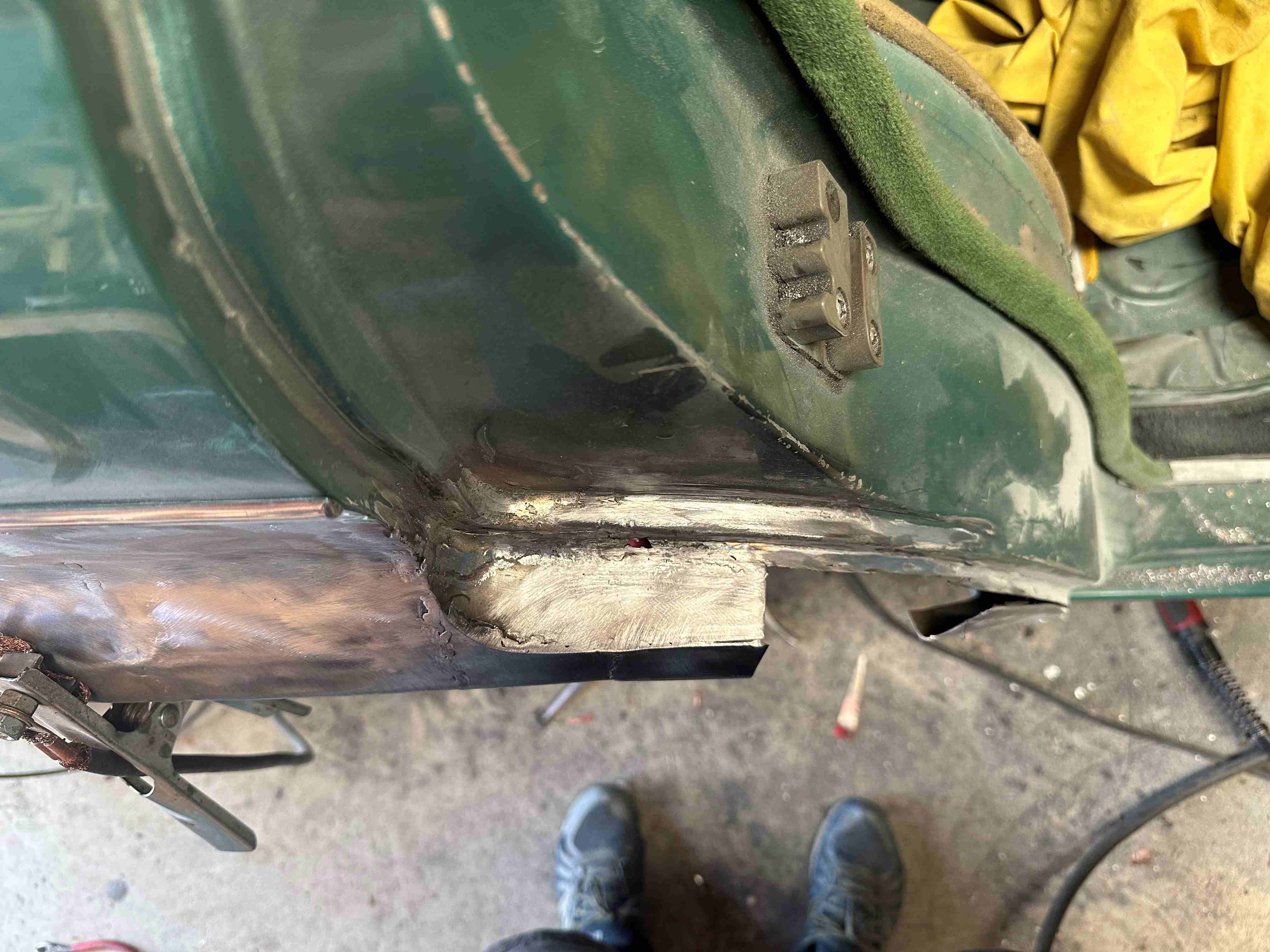

I had to make up the arch in two pieces as I didn't have a piece of panel steel big enough to do it in one.
After shaping the panel to the shape of the buck I needed to put some curvature into it in two directions which I did by using an old pair of welding gloves as a cushion and hammering down on the inside of the panel which seems to have worked out ok. Then tack welded it in trimming new to old and old to new.

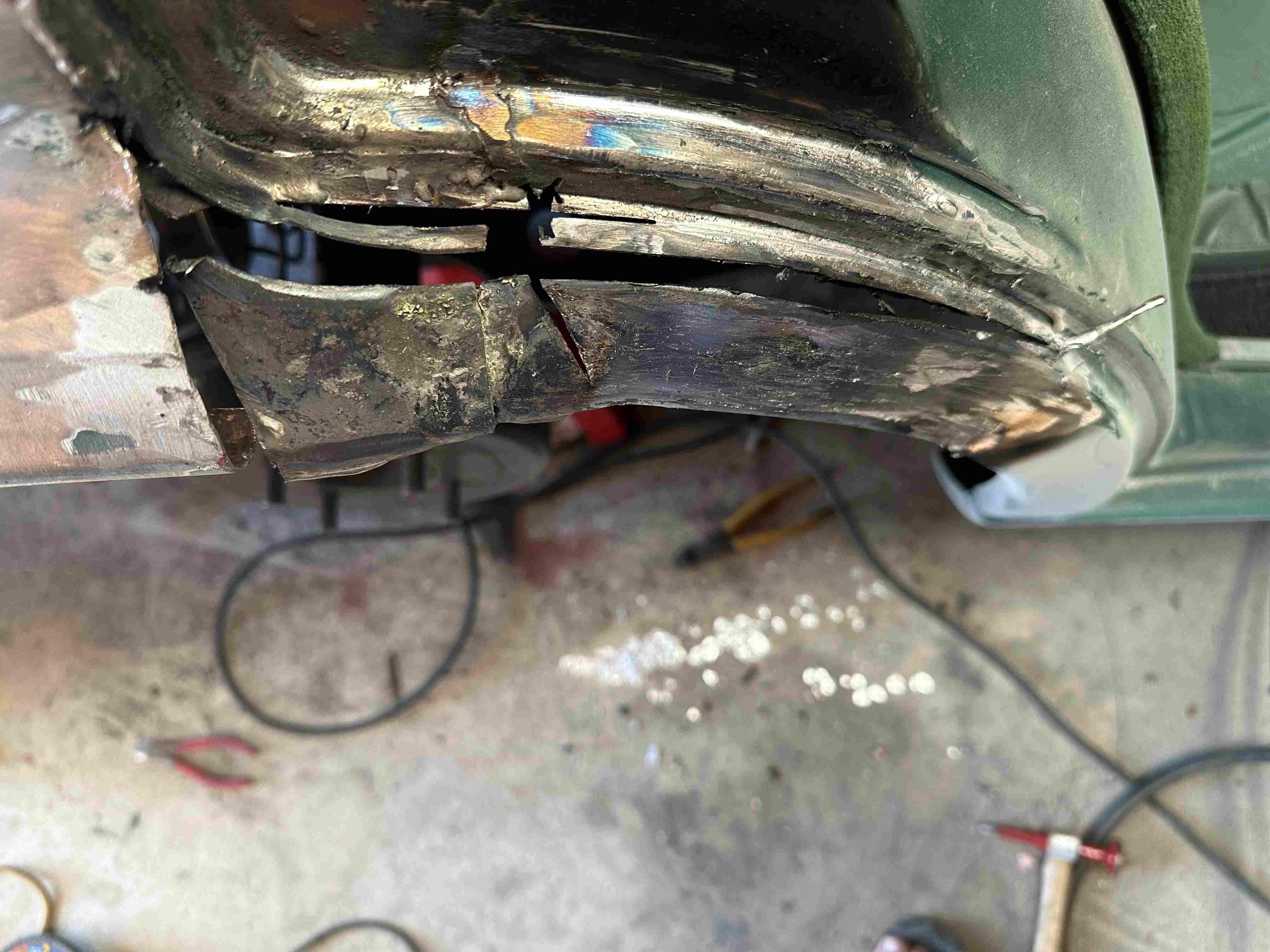

I did a small correction to the shape of the arch to the top new piece I welded in as it wasn't quite right.
The bottom of the guard has been replaced before and looks as though they used some quite thin panel steel over the top of the old rusty original steel. So that's rusted out now and so has the inner panel so it will need replacing as well. The whole rear of the car needs work at some stage. It seems as it may have been parked in a shed to small with it's arse hanging out for some time. Anyway, for now I have to finish the flare and finish the inner guard and need something solid to weld to. I needed more panel steel so I went into steel and tube and bought a sheet of 1mm cold rolled steel, so I shouldn't run out for a while.

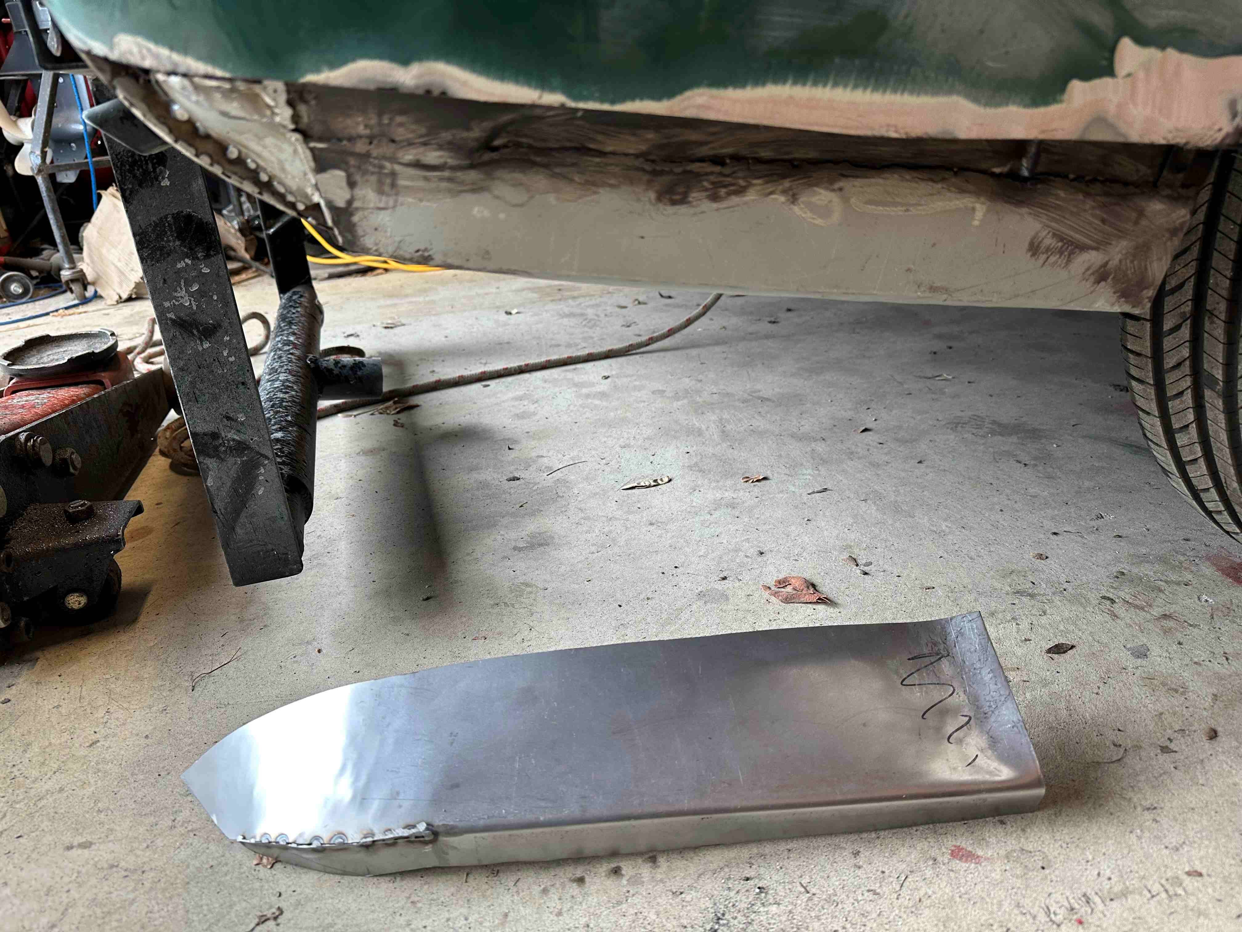

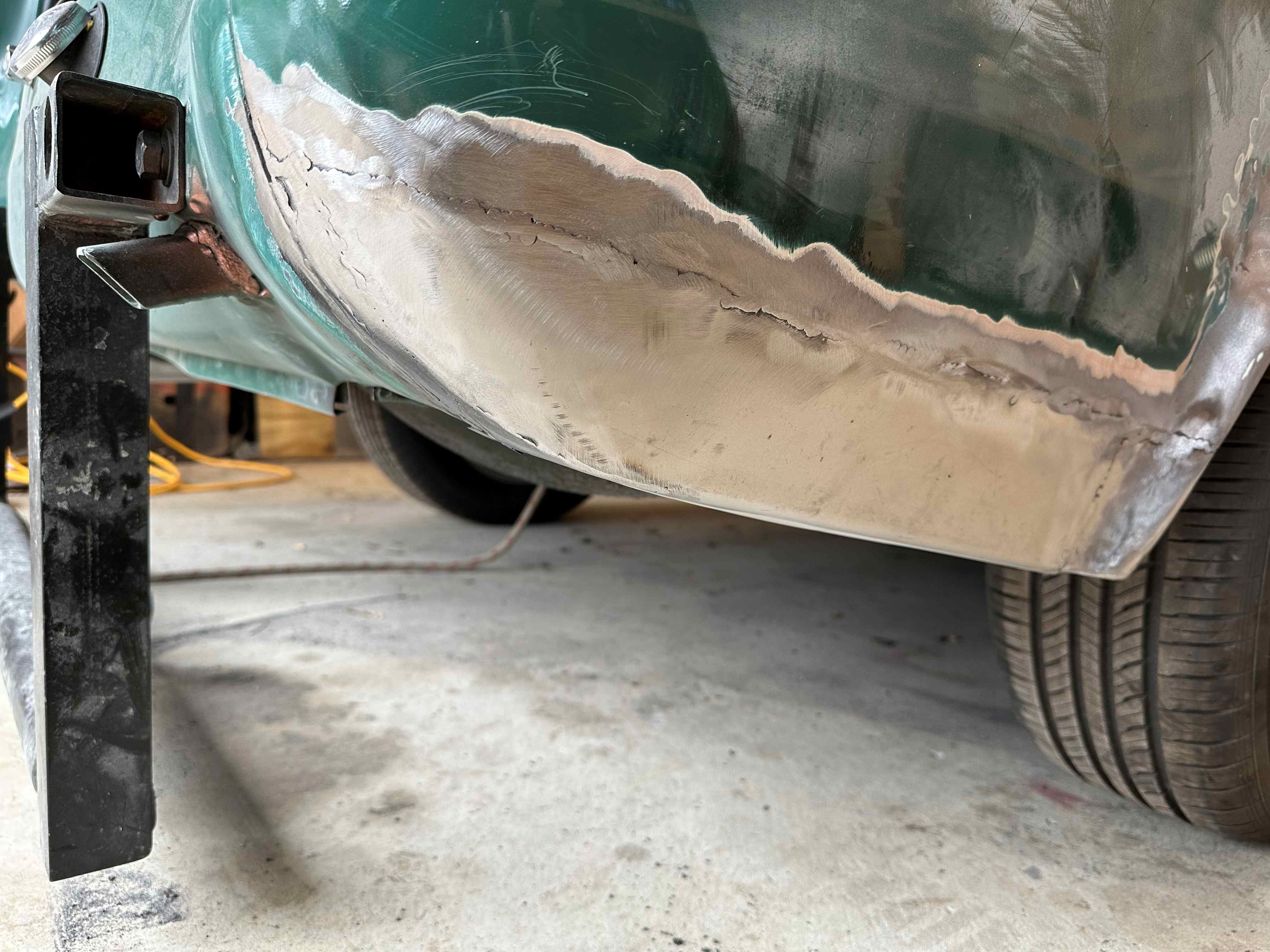

I spent about 6 hrs trying to make up the replacement panels for this repair today. I managed to get the inner panel welded in and a few other internal patches done.
The outer panel is a lot more difficult as it curves in three directions though not greatly. I have it getting near there, but it would be nice to have an English wheel I think. I only think it would be nice as I have never used one before. I will need to do the other side and the whole rear valance panel which is quite curvy and then there is the Cob to do as well.

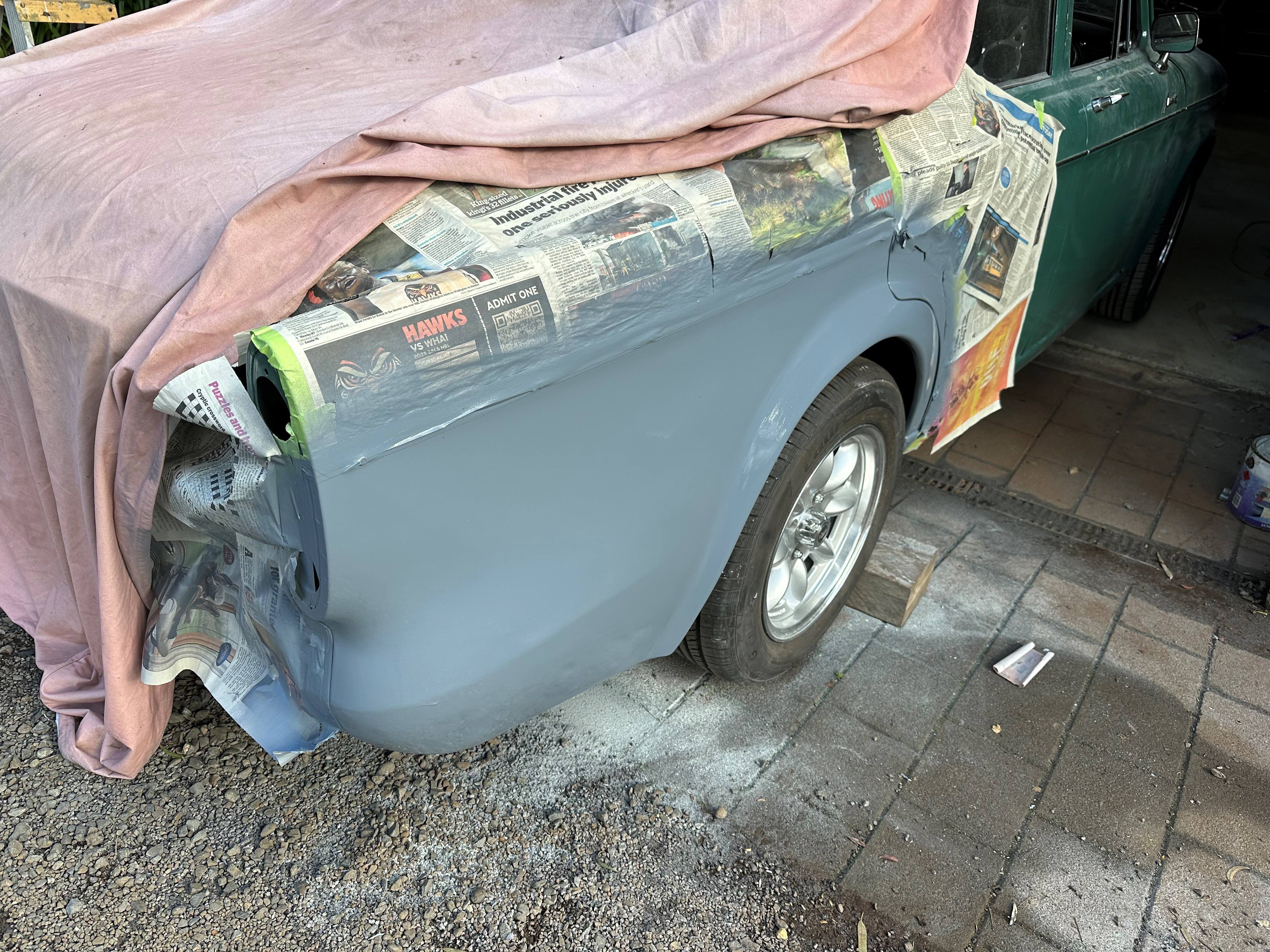

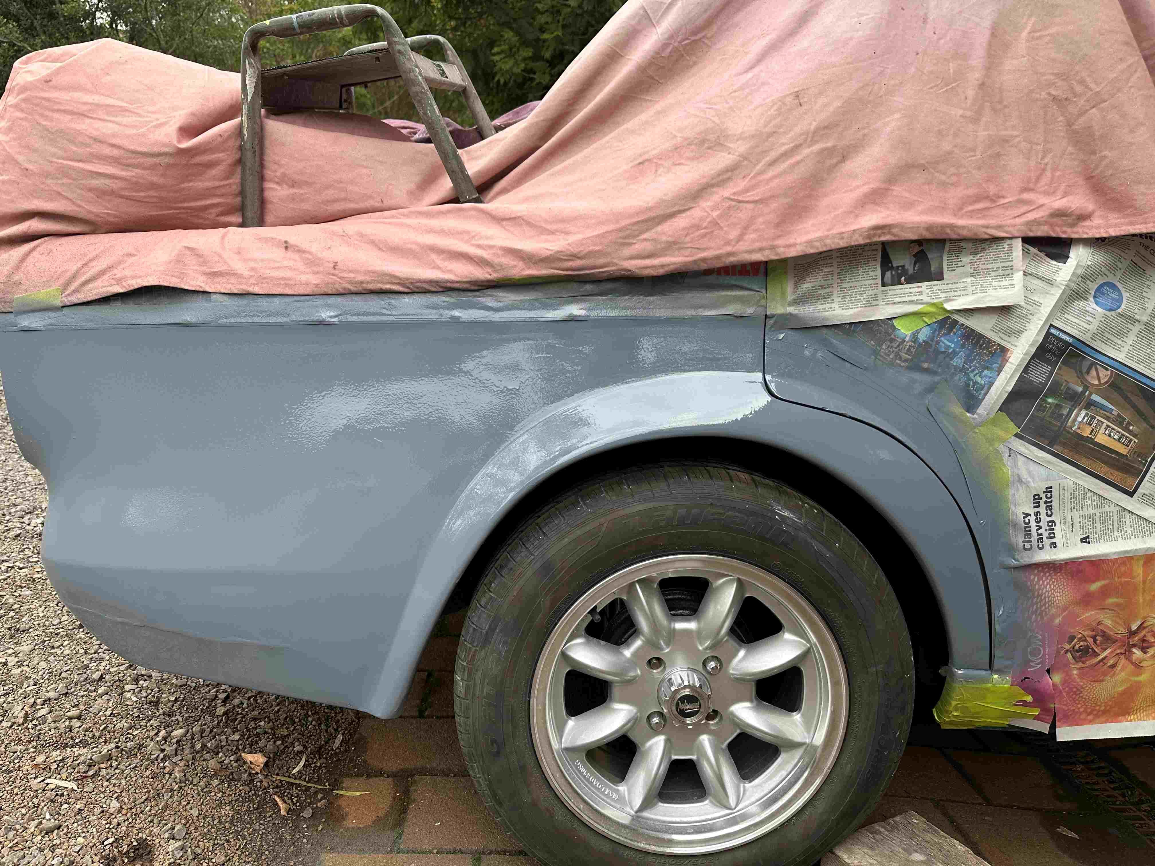

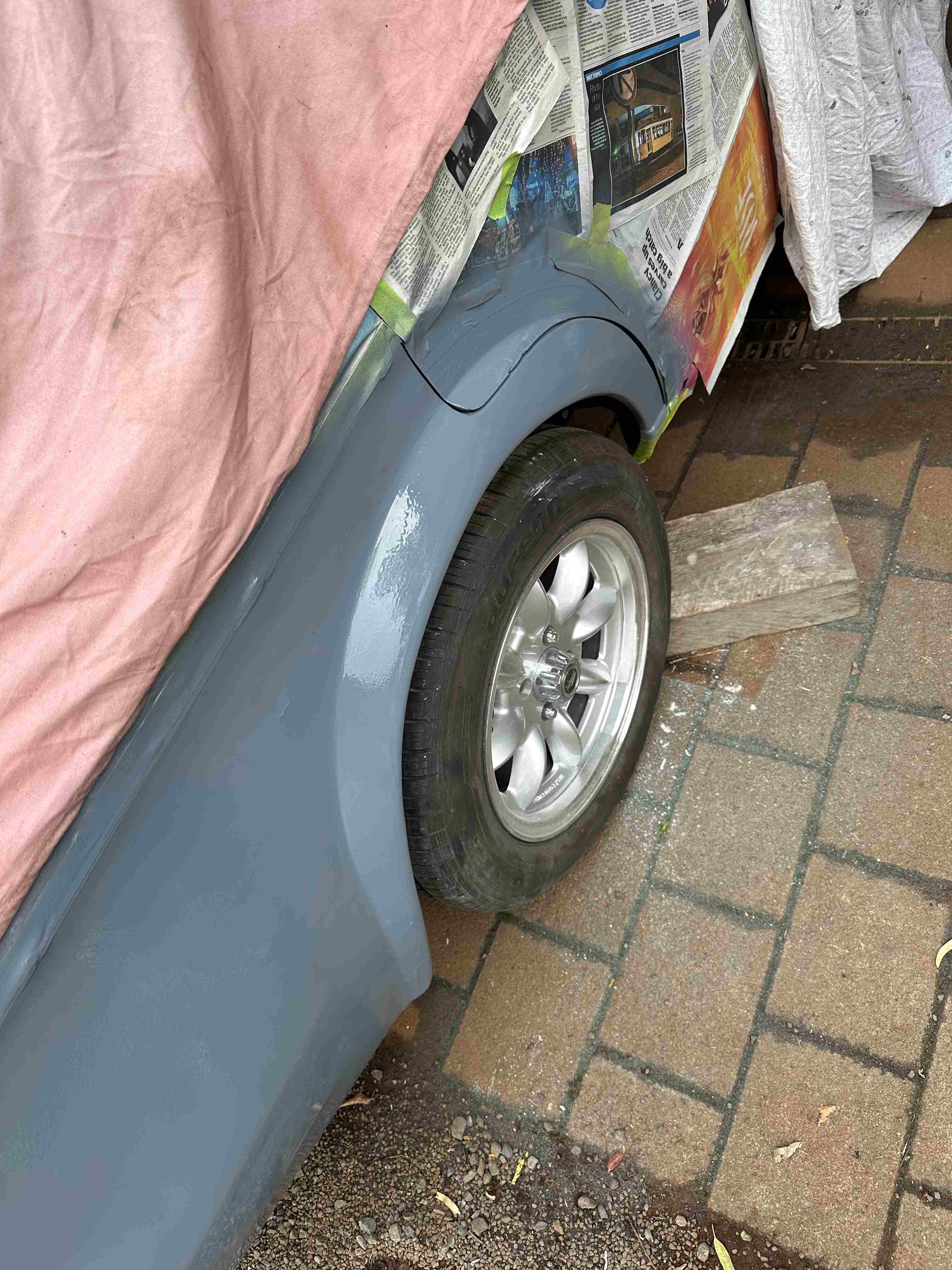

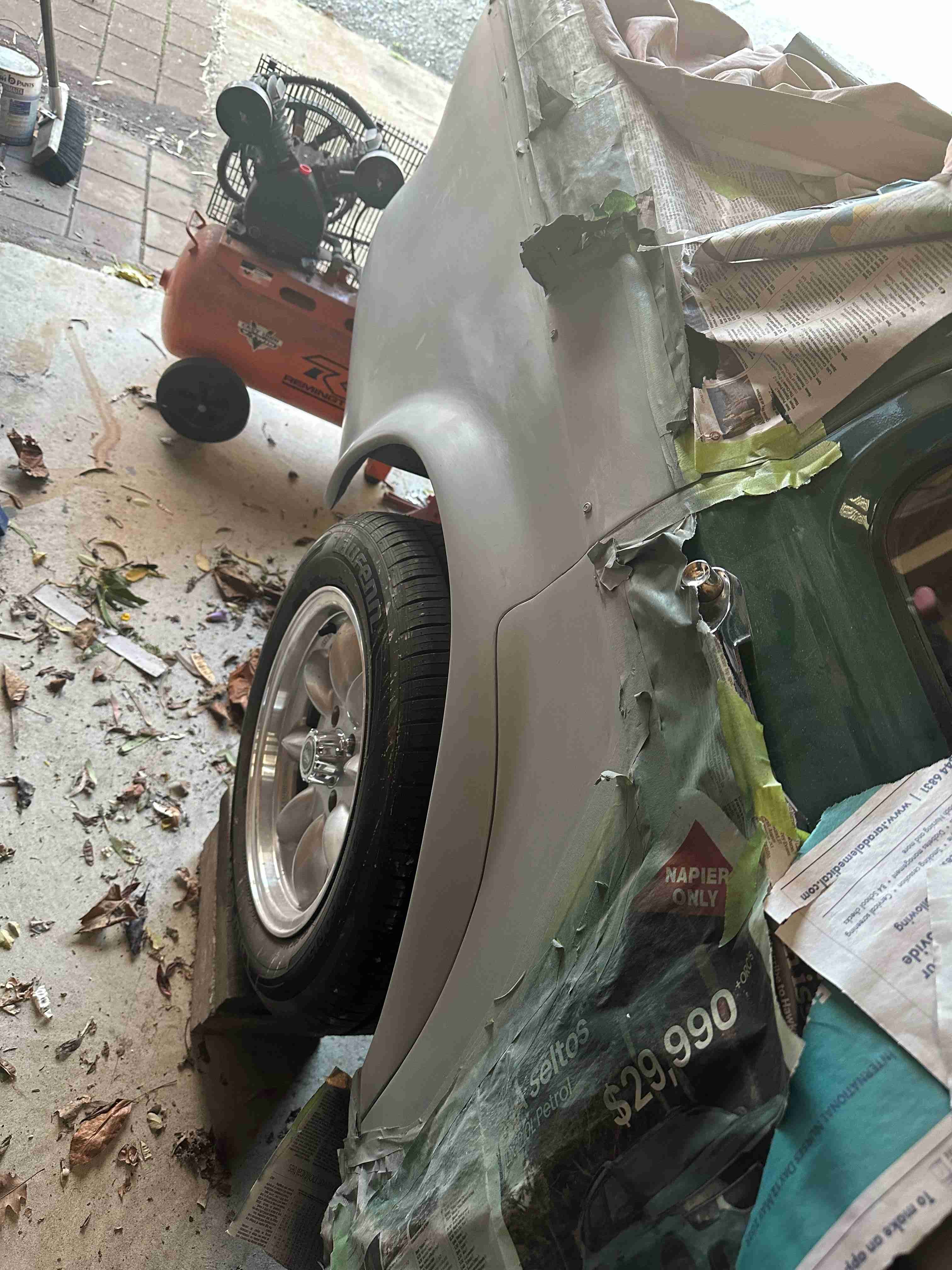

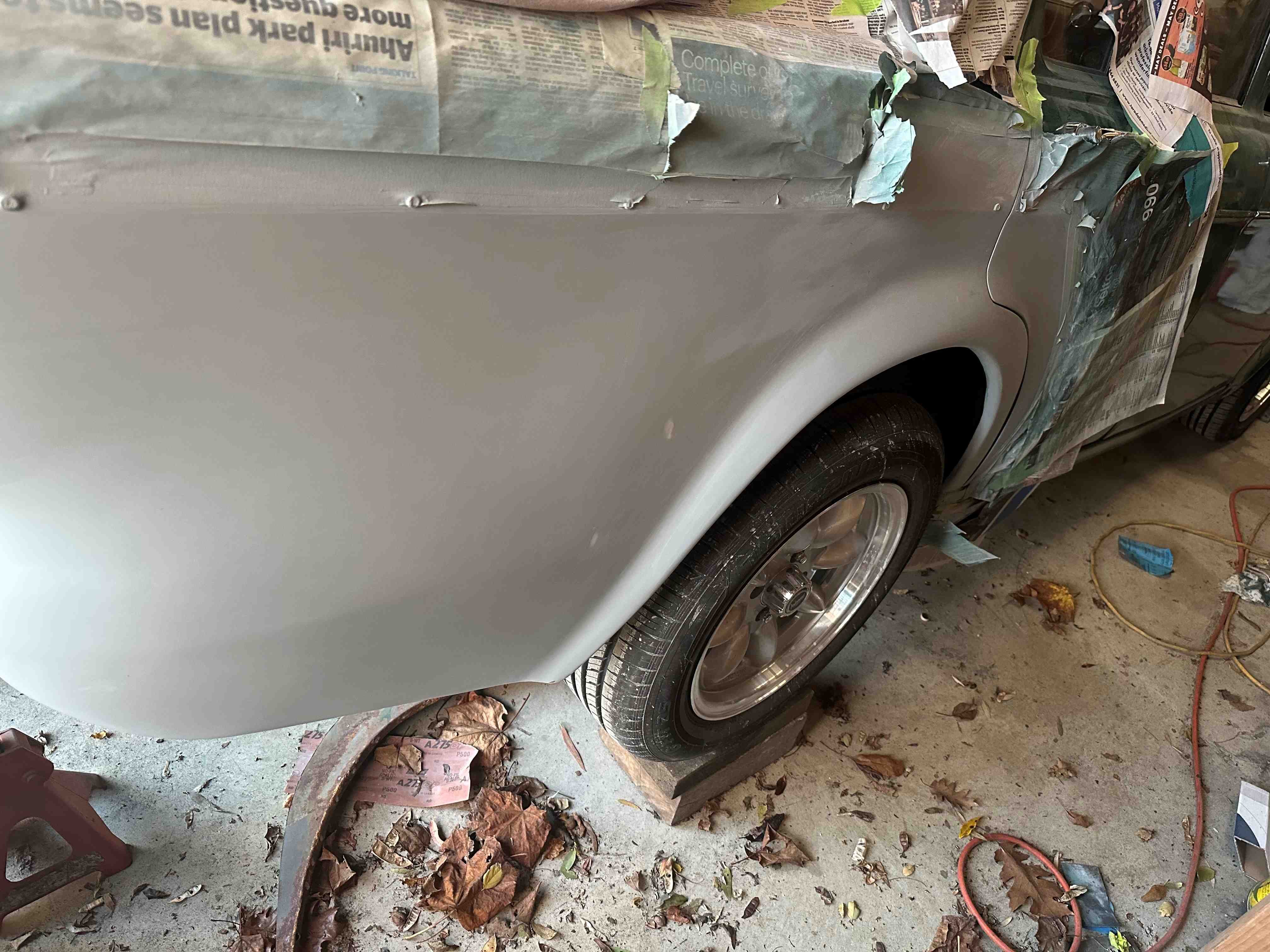

After welding in the inner guard to the outer the panel above the flare got a bit out of shape and popped in and out so I heated the panel in different spots as I have seen done on u tube but never done myself before. I did get it to not pop in and out but it was still a bit out of shape. I did try and improve it with a hammer and dolly but it made little difference, so I used some filler once I had primed it. I had to use filler to smooth out the flare anyway, so it doesn't really matter.
So after spending a few hours filling and sanding and filling again I have it reasonably close to the correct shape.  I gave it a coat of epoxy primer to get the whole panel the same colour which helps to see the shape I have. I can now see where I needs to correct the shape and will also be able to add a skim to the bottom of the guard. Then go through the block fill sand process to get it perfect, I hope.

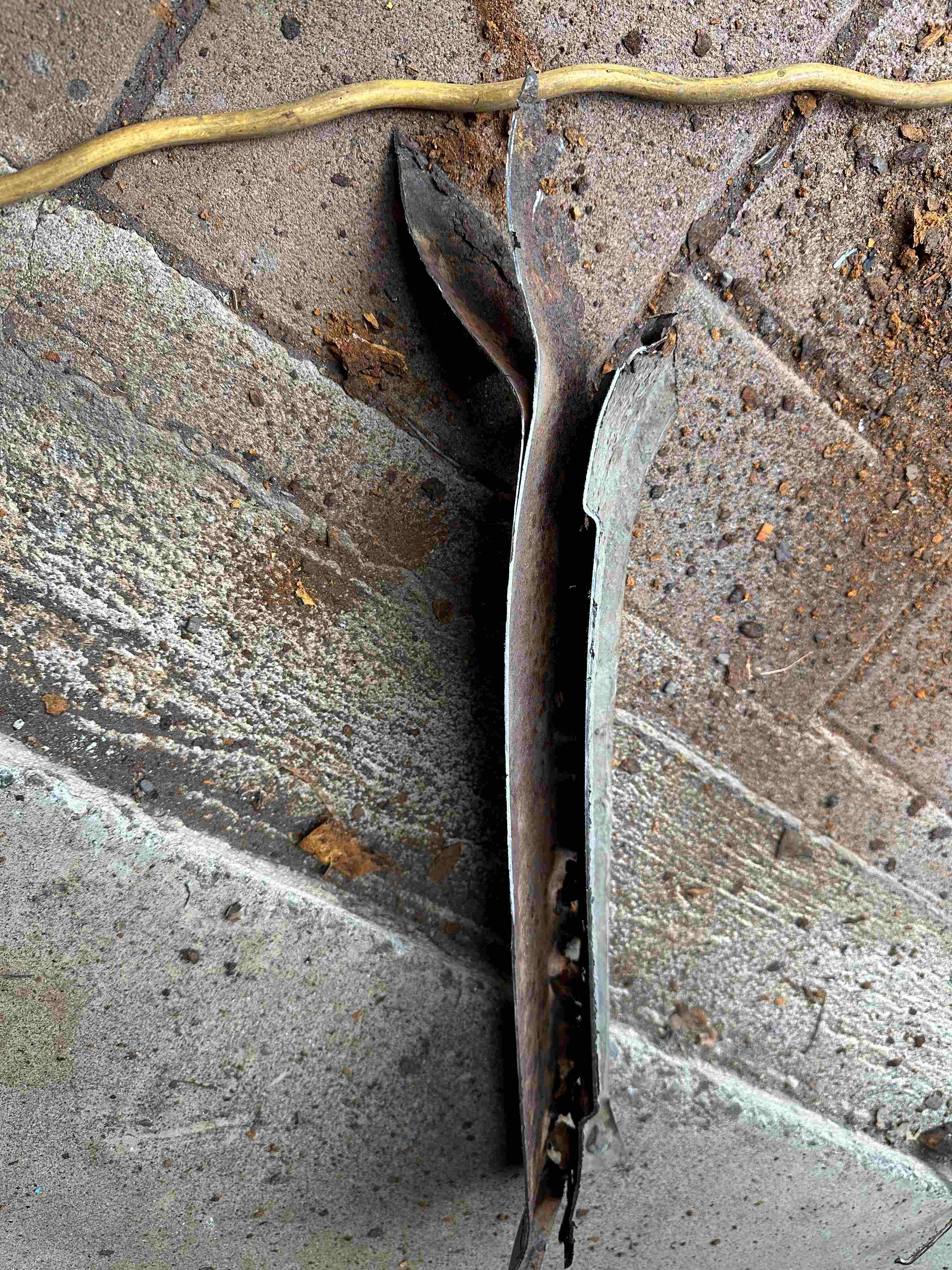

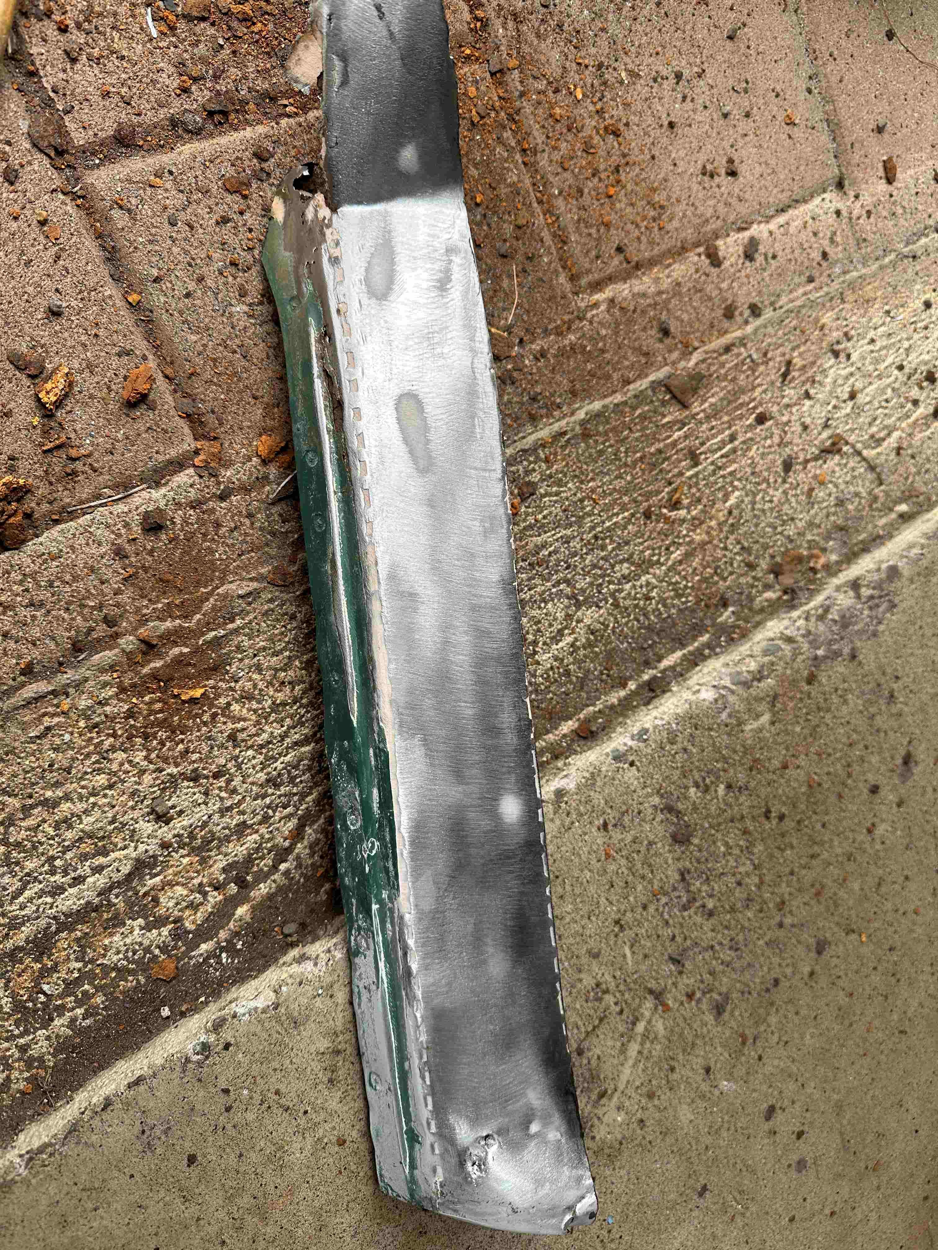

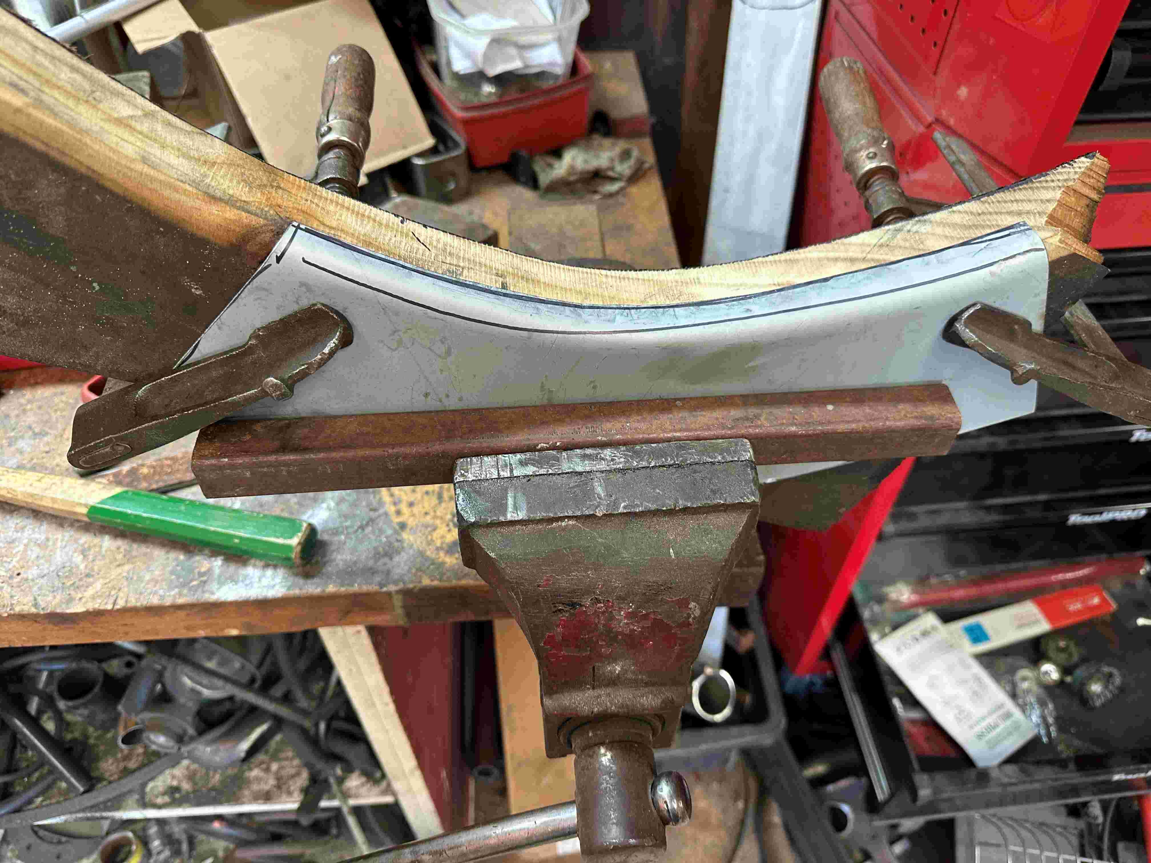

The rear valance panel has a fair amount of rust coming through and needs to be replaced. I was going to leave this until the car was going but decided to start working on it now while I was finishing the left side flare. The panel is quite curvy, so I wasn't too sure how I was going to make it. Anyway, I firstly decided to leave the rusted pane on and cut the section out later. So firstly I put the 90deg spot weld flange on and then shape it to the shape of the car.
