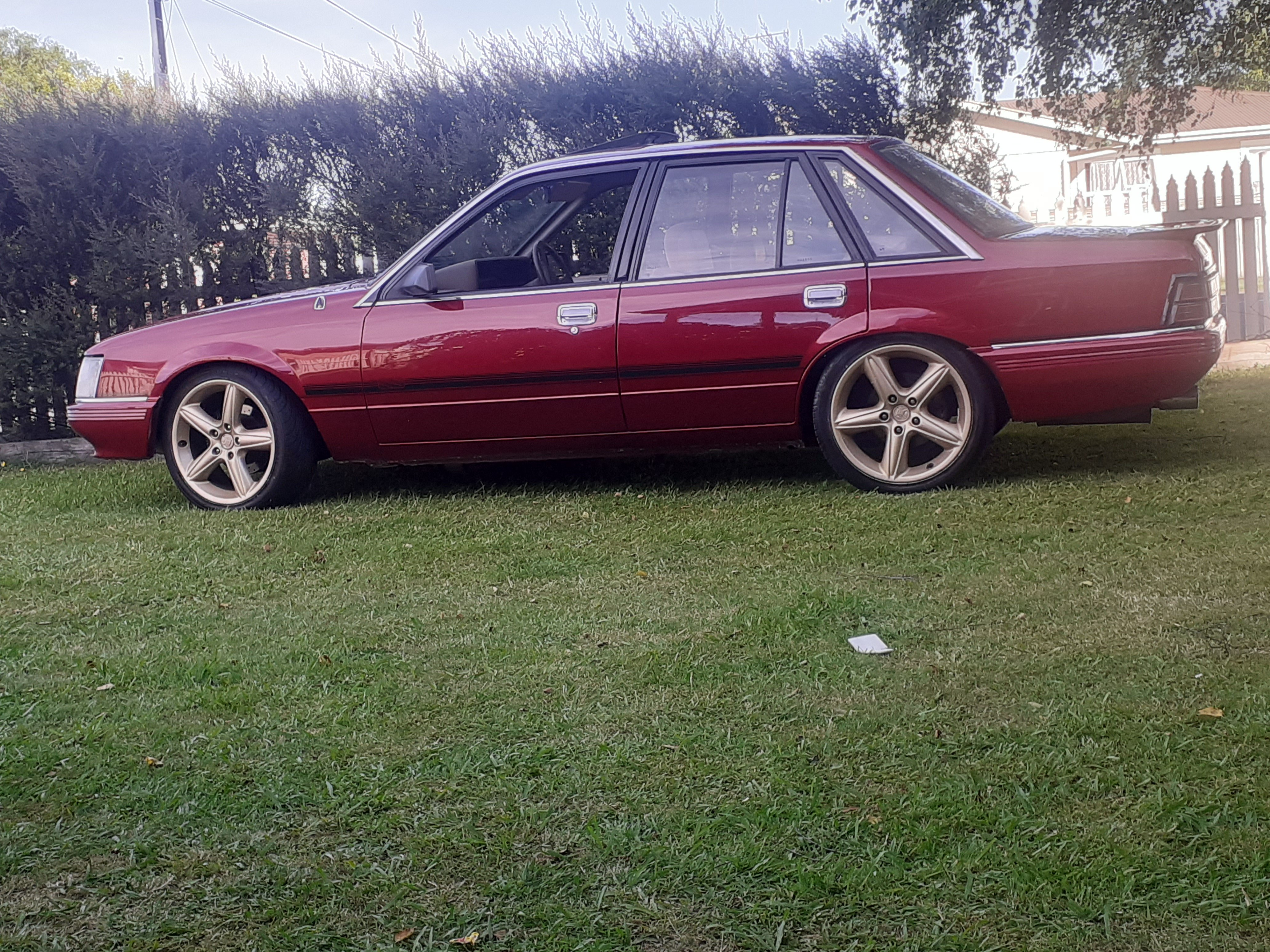

Popular Post Vk304 Posted September 7, 2021 Author Popular Post Posted September 7, 2021 With light from a distance lol 15 Quote

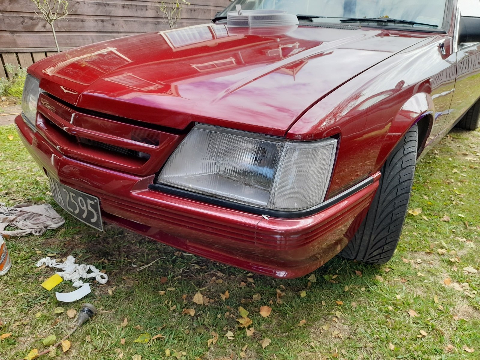

Popular Post Vk304 Posted December 3, 2021 Author Popular Post Posted December 3, 2021 Despite having some paint flaws, which will never make it a show car, i decided to finally fully cut and polish the rest of the car. The front here was dull and covered in rattle can overspray, pretty happy with linkup products, its a lot brighter really brings the colour out ... more to come, takes a lot of time but will compliment the next phase 15 Quote

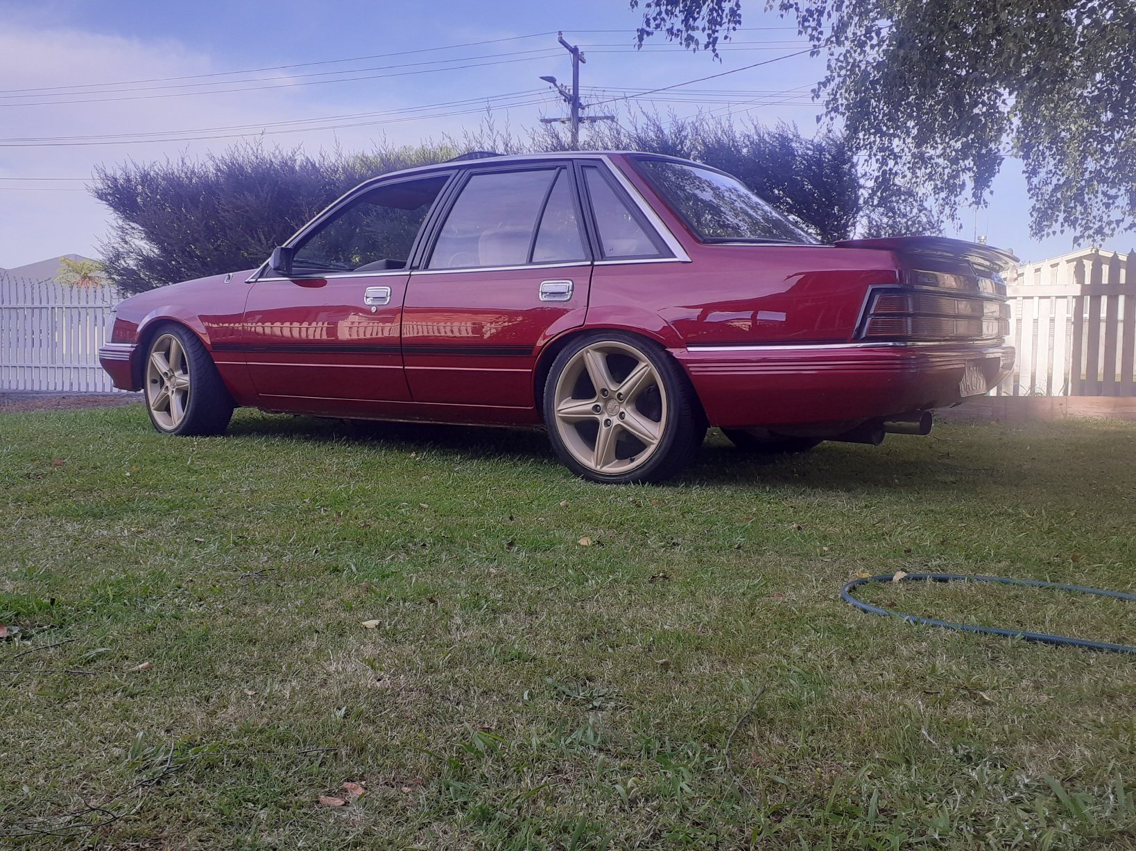

Popular Post Vk304 Posted December 26, 2021 Author Popular Post Posted December 26, 2021 Got a 'ss' stripe kit out of aussy, by first stripes company, hdt ss vk stripe kit, took a while to get here but when it did i wet sanded the quater with high grit sand paper, cut and polished the rest of the passenger side. Pack n saves finest palmolive dishwashing liquid was sprayed on both the car and decals as to line it up (a must otherwise it will stick in the wrong place and never come off) installed it as holden dealer team did back in the day, going off picture of genuine ss cars 16 Quote

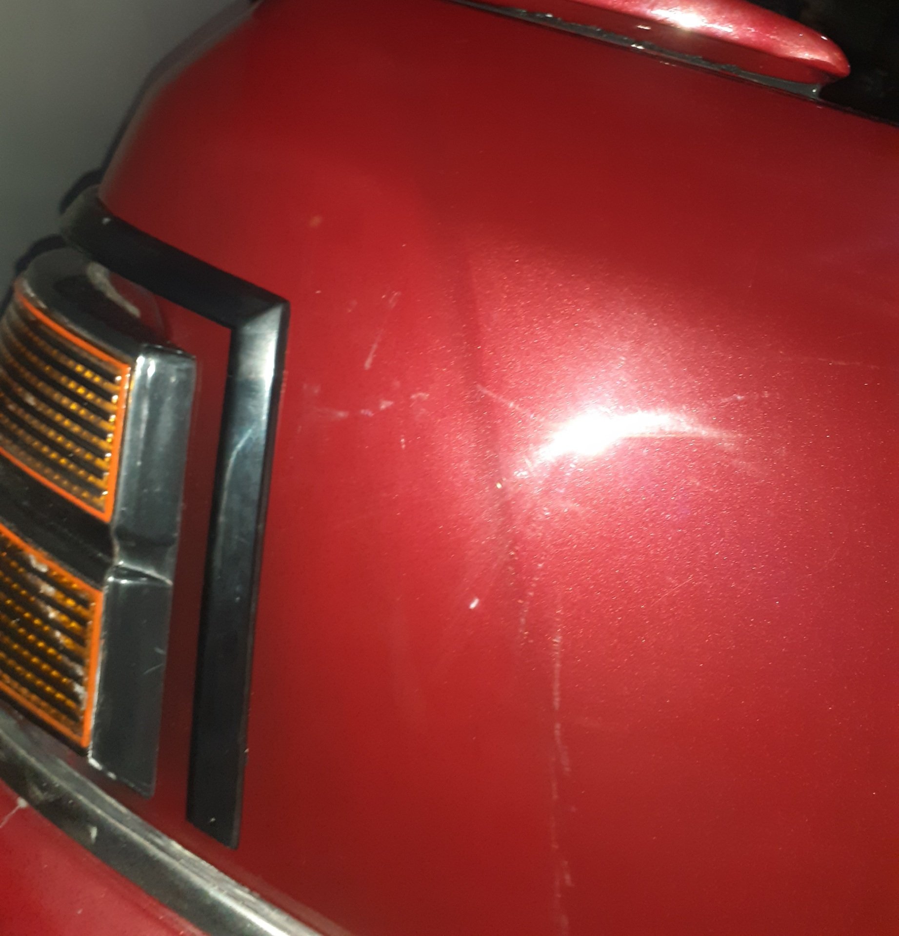

Popular Post Vk304 Posted December 26, 2021 Author Popular Post Posted December 26, 2021 Looking very nice on this side, unfortunately the other side has a bog crack in the door and im unsure how ill fix, got no paint left and dont really want to end up with a different shade on the door... so may leave it there will have to vinyl wrap the bottom chrome to finish 11 Quote

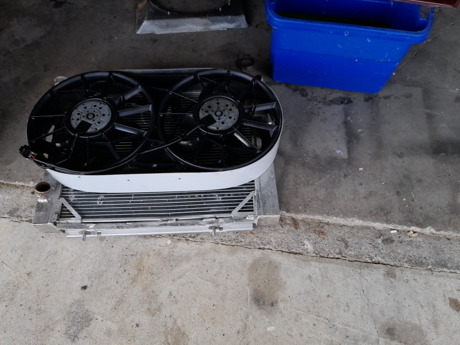

Vk304 Posted January 29, 2022 Author Posted January 29, 2022 For the whole time ive been driving this ive had overheating problems, its fine to drive in colder weather and highway speeds, but this summer the issue came to light again. Its only overheating to just above 100c but thats still not cool... had a 16inch fan on it with custom shroud, and adjustable fan switch with radiator probe. Turns out this switch works when it feels like it and the fan doesnt have any balls... Punched the centre out of the thermostat to see if that helped... it diddnt So i went to aussy spares again and yea got some ford au falcon fans, these are supposed to flow much better 2 Quote
Vk304 Posted January 29, 2022 Author Posted January 29, 2022 Chopped pretty much the whole shroud off because it diddnt fit, moved the top radiator hose and came up with a plan to attach the leftovers to a piece of 2mm aluminum by rivets into plastic, and then attaching the alli onto the radiator, giving the tightest fit possible, they are wider than the radiator but will fit ... used my 3$ metal shears i found at the local dump shop the day before lol, it was meant to be.. 3 Quote
Popular Post Vk304 Posted January 29, 2022 Author Popular Post Posted January 29, 2022 I ended up with a nice oval housing, and had the fans riveted in so that the plastic middle divider between fans was juust about touching the radiator, important because i brought a 2 stage davies craig fan controller, that will activate one fan, then the other when needed, so they arent both going all the time... One fan is sucking through the radiator, not the other fan, thats not going if that makes sense?? some thin alli sheet to attach bottom and miss the cars crossmember, i will be sealing this properly, all around to create a proper vacuum, rivets only go into radiator bracketry not the tanks lol plenty of space yes i welded it onto the radiator, i think itll be fine no need to bolt it on have to modify air box a little bit still getting there, waiting for my fan switch to turn up and install new 82c thermostat, and finish sealing around shroud, pressure test welds.. 11 Quote

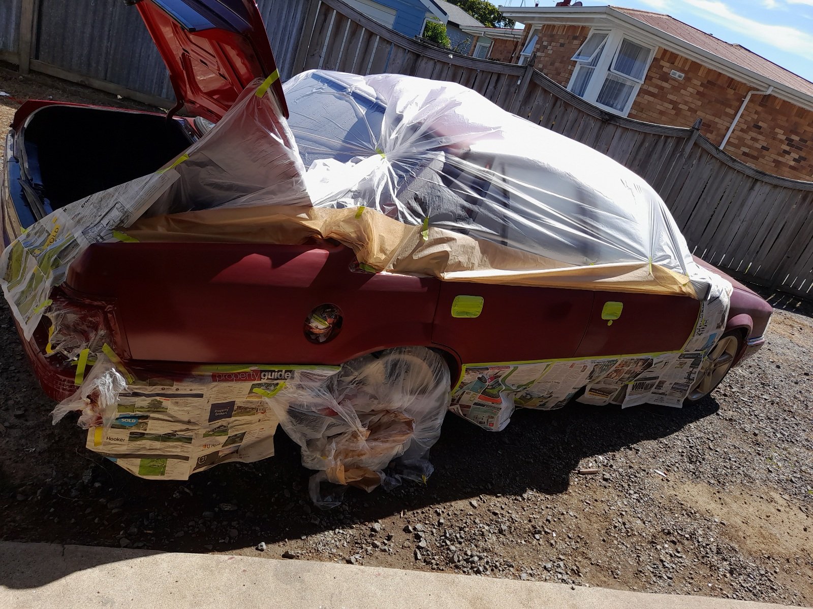

Vk304 Posted March 21, 2022 Author Posted March 21, 2022 Got some colour matched by linkup, sanded the bog crack out of the door and sprayed colour on it, clearcoated quarter and doors, cut and polished the lot and put ss decals on the other side ...its not mint but it looks nice and it got rid of the crack and uneven quarter paint 8 Quote
