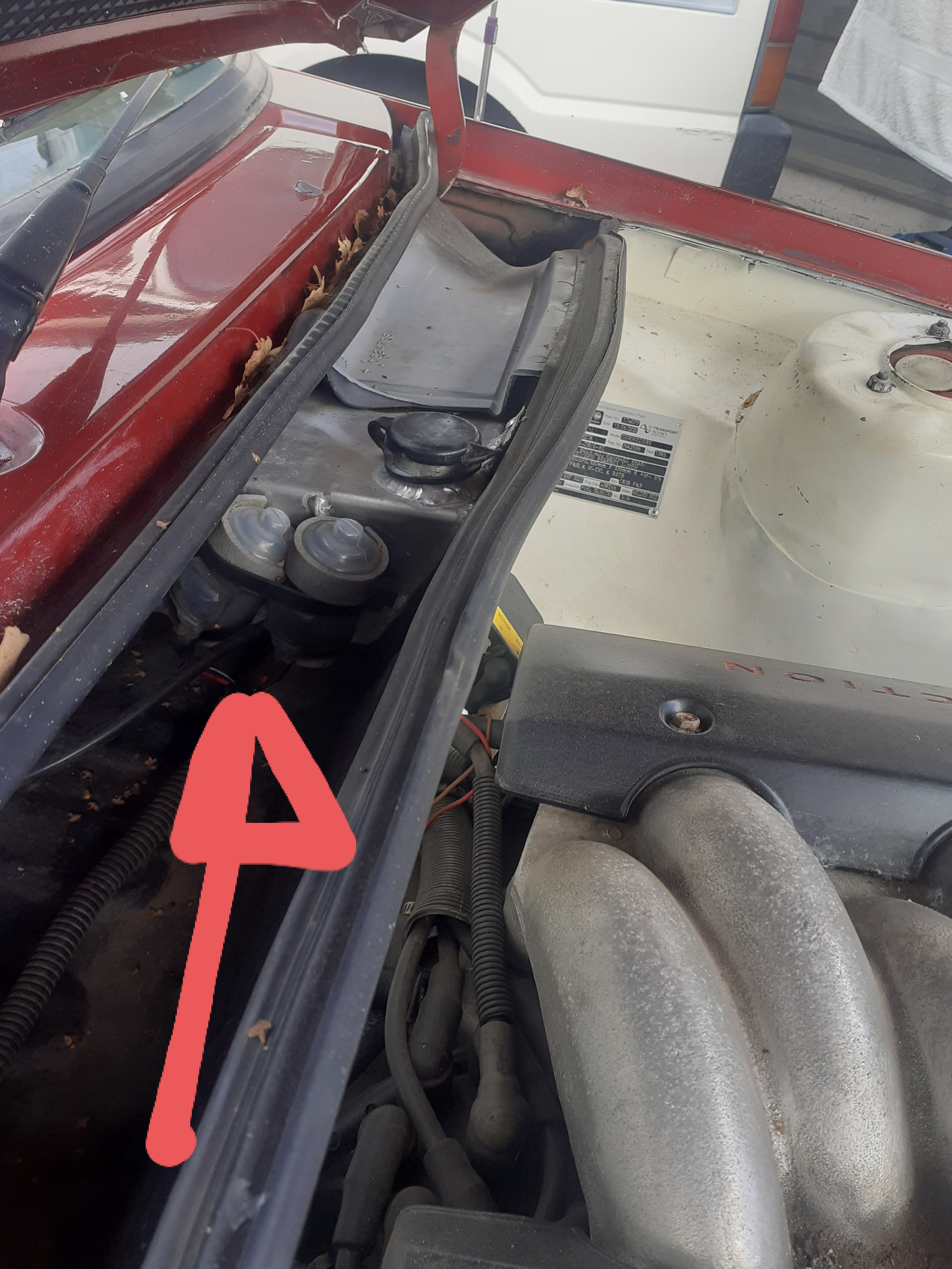

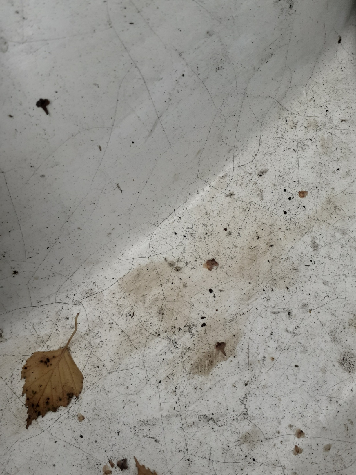

Vk304 Posted April 25, 2021 Author Posted April 25, 2021 Some of the stages the engine bay went through black- too dark, white gets dirty , my white paint had a reaction or something and though it looks nice on pictures, it cracked horribly all over, so this is now on the to-do list, took me a while to get the proper 5litre vt front cover 7 Quote

Vk304 Posted April 25, 2021 Author Posted April 25, 2021 Paint problems, and havent cleaned the engine bay in a while lol 3 Quote

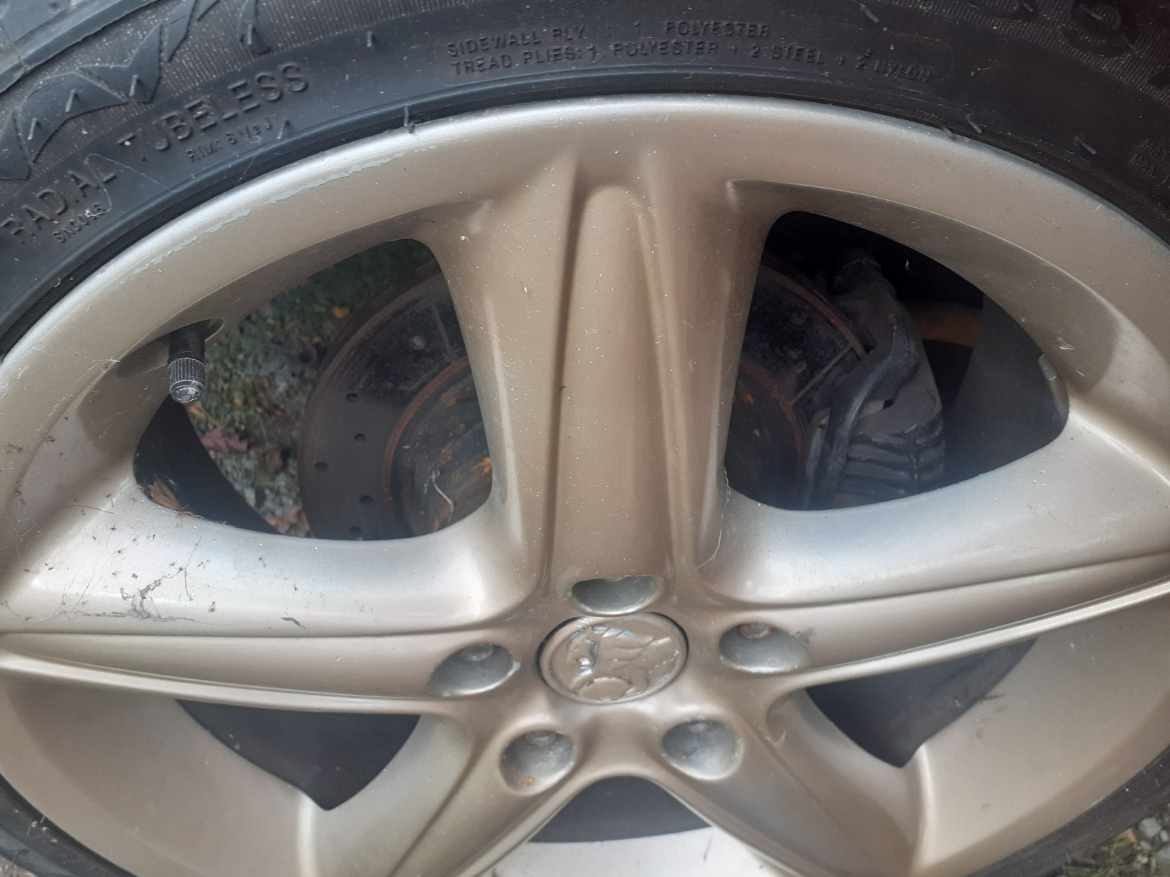

Vk304 Posted April 25, 2021 Author Posted April 25, 2021 I had a set of brakes from the vs ute, slotted drilled rotors and master cylinder etc, had to buy hub adapters to make it work as well as a spacer for the booster, and now works great, the rotors are a bit bigger, calipers finned, rotor no longer house wheel bearings, mate at work skimmed the front rotors to make for a nice brake setup, that can still have small wheels go over I believe. And got certified, first time around was a fail on speedometer out and a fuel line fastener in one spot, not bad! Fixed those things and all done ! 8 Quote

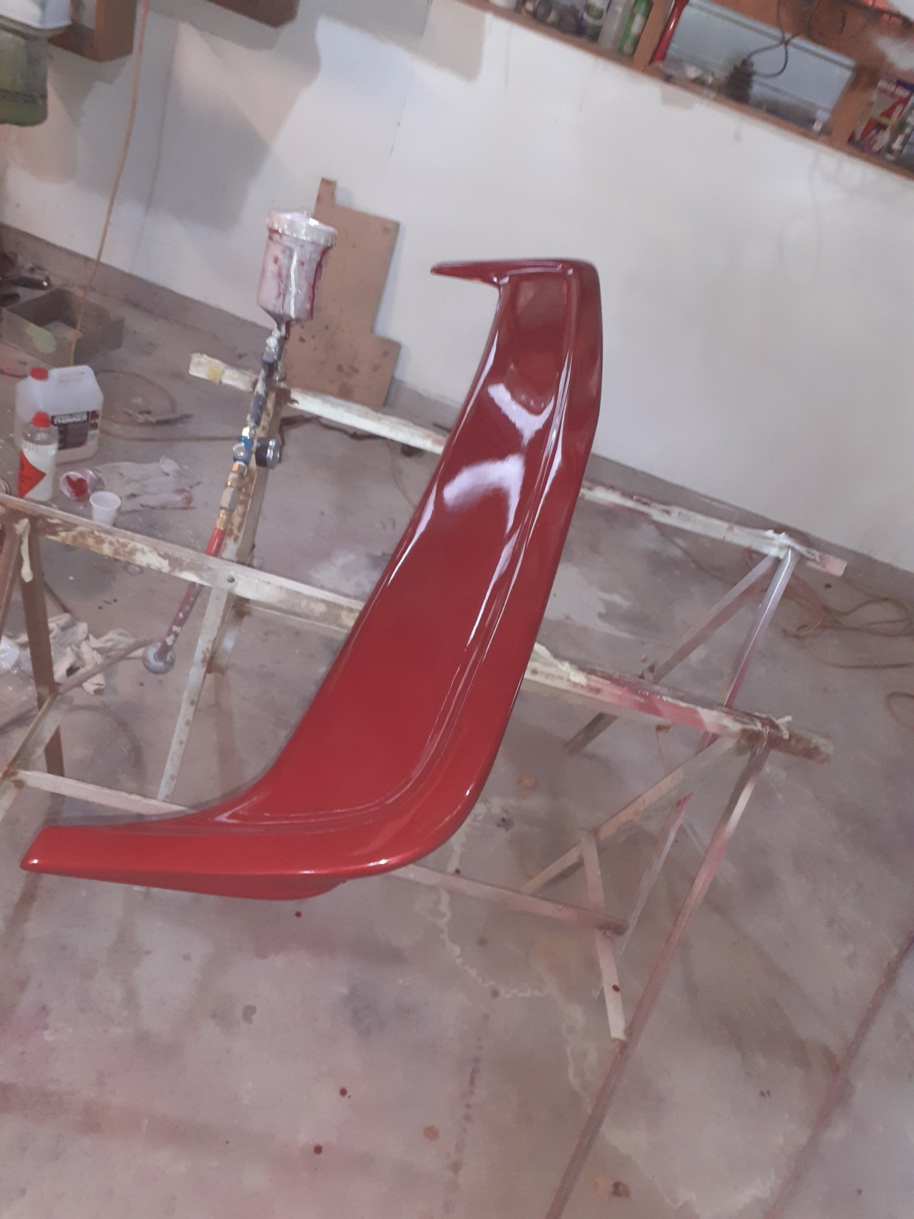

Vk304 Posted August 20, 2021 Author Posted August 20, 2021 Throughout the time ive had this car painted ive always stored it inside, the last year ive put it outside a few times, and instantly the wing started to bubble, turns out the sun and rain with bad paint prep on fibreglass took a toll on it, but no other parts of the car, it still looked good, but had some scratches and the bubbles got bigger and bigger. So i decided to paint it and another part which ill detail later, together Quote
Vk304 Posted August 20, 2021 Author Posted August 20, 2021 A lot of sanding, skim fill, primer and repeat to get it straighter 2 Quote
Vk304 Posted August 20, 2021 Author Posted August 20, 2021 Some black base, and final fitment check before spraying it with 3 coats red and 3 clear to really make sure it doesnt wear as easy and a little cut and polishing can be done without burning through 3 Quote
Vk304 Posted August 20, 2021 Author Posted August 20, 2021 Keeping in mind i did not know how to paint with anything other than a rattle can as of a year ago, im pretty happy with the result Its sealed on front edge and where bolts come through boot with some quality sealer with gaps to let water through, still have to cut and polish lightly but overall the ss wing looks good Yea and i decided this is gonna be a hdt ss rep ( not group a or group3) its got the basic trim, 5l v8 manual, wing, and with a stripe kit, some ss decals front and back it should be pretty close to what the base ss models were . . Well not exact but thats what i want it to be . . 9 Quote
Popular Post Vk304 Posted August 20, 2021 Author Popular Post Posted August 20, 2021 Painted in a garage with no fancy equipment, and cost me maybe 50$ in materials, about 2000$ in labour though 17 Quote

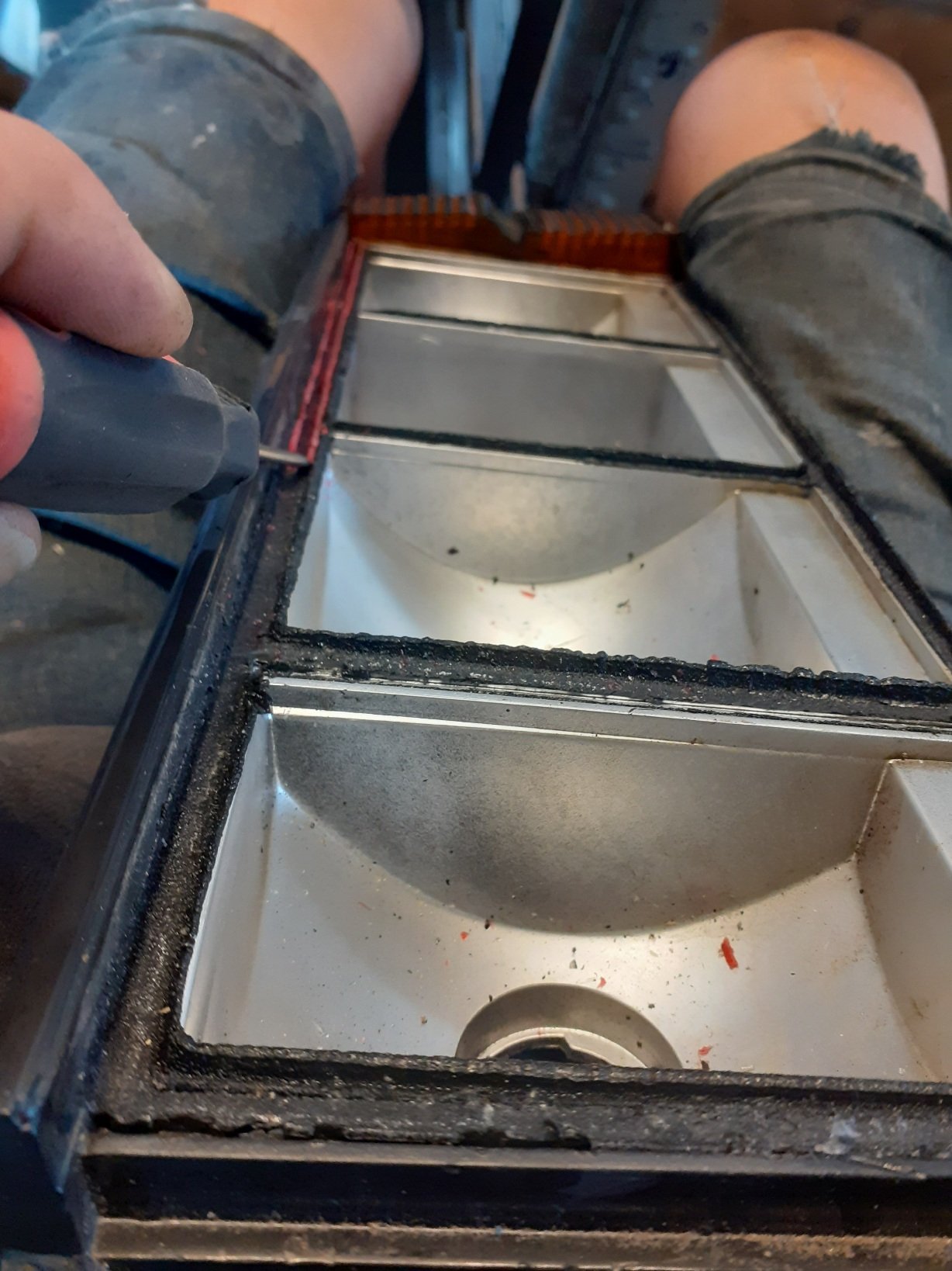

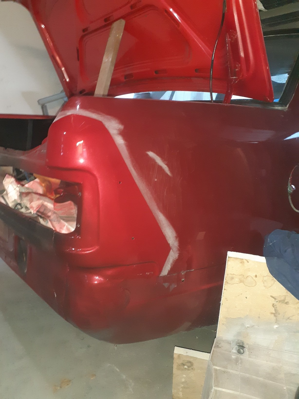

Vk304 Posted August 21, 2021 Author Posted August 21, 2021 So yeaa i backed it into my fence because akward garage exit, non attention and caved the rear quater corner in, broke a light and munted a bumper side, i was pretty gutted put it back in garage, diddnt take pictures hoping it would fix itself, but the next weekend i had regained some motivation, soo off to aussy spares to get some bits and try to make it nice again... I put in quite a few hours popping the corner back out, took bumper side off to work on getting the new one ready sprayed some black on it to protect the metal and left it for a while so i could get paint bits .. There were no lights with no damage so brought the least damaged one, along with 2 i had to make one good light lol This included digging out plastic panels and using some pp/pe plastic glue (worked great), non hardening sealer to seal it, and made it presentable 2 Quote
Vk304 Posted August 21, 2021 Author Posted August 21, 2021 Overall not too bad, painted the stripes same colour, gave them all a polish and tidy up, and some silicone spray .. that parts done onto painting 9 Quote

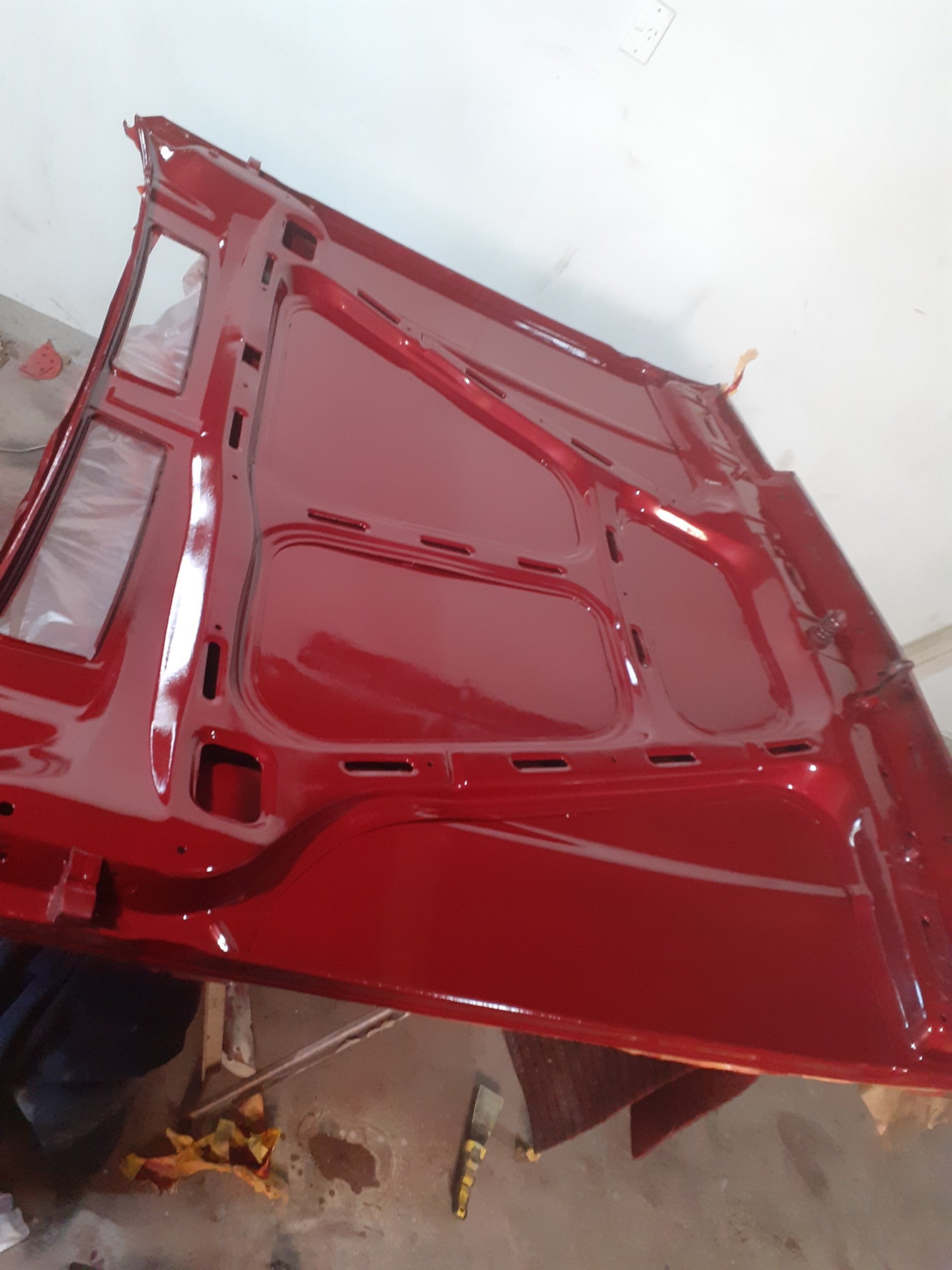

Popular Post Vk304 Posted September 6, 2021 Author Popular Post Posted September 6, 2021 So i went and painted some more bits, this rear bumper side and under the bonnet, which used to be a mess and different shade of bright red, also these are all the same colour, camera makes it look different in the light 10 Quote
Vk304 Posted September 7, 2021 Author Posted September 7, 2021 Then did the inside of the boot as it was a bit damaged and uneven paintand the quarter, which came out too light first time so sanded it right back down, mixed some black base with it and it is now okay, paints nice but unfortunately you can see where it meets in the light, but okay from a distance lol The method i came up with was paint primer, sand it right down, especially the edge where it meets paint, then base, x3 and sand between on the edge part, then clear same again, each time overlapping, drying with a heater in between. A lot of work for average result, but didn't have enough paint left for the whole quater, so it is and now its only the engine bay to do looks alright 6 Quote
