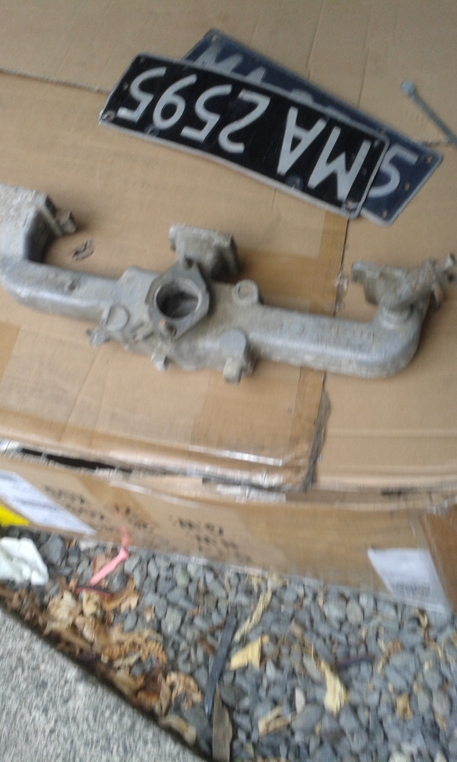

Vk304 Posted March 28, 2021 Author Posted March 28, 2021 I had never been around old holdens, diddnt know anything about them, just noticed it's got a live axle (a first for me then), manual and 6cyl, I gotta say I was then curious about this car despite the state of it ... $1500 quad... surely I can't go wrong with this trade! Started to mess with the carb immediately, came with another manifold and plates in the boot as I recall, carb was a bit munted and had dodgy bits all over it, but being a 202 it did run..... ish. With full choke only haha 5 Quote

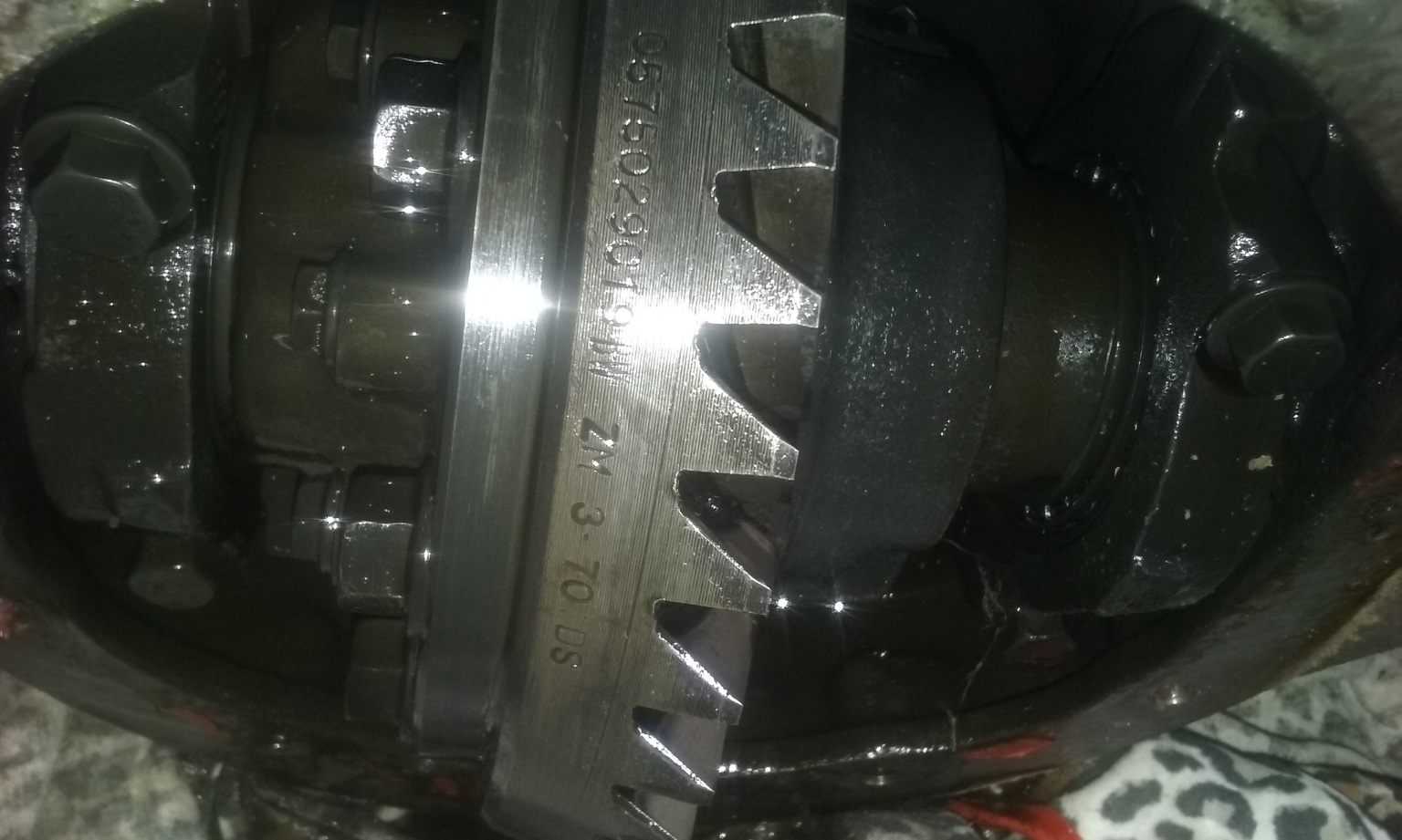

Vk304 Posted April 1, 2021 Author Posted April 1, 2021 Then after failing to buy carburetor set up, I went for injection, brought a 'vl' v8 or 28 spline diff, and went on trademe and brought a vs v8 s-pac ute, v8, de-registered and crash damaged, but running, all it needed was a battery... $1500 , well I wasn't interested in the motor (which had worn bottom end as I found out later ), just the wiring ecu and all the rest, as well as a limited slip 3:7 diff(a suprise bonus!) , parted the ute out and dumped the shell.. Then a mate, had a power glide for sale, which at the time sounded great, being able to hold upto 800 hp with the right mods and bolt onto my 304 (I diddnt know the limitations of a 304 , or what was involved in making a 500hp 304 holden) So I went on jegs website, brought things like input shaft, clutches and steels, manual valve body,summit 3.5k stall,, basically making a drag gearbox, with the purpose of it being a drag-able vk... got it running, did the wiring and ecu chip, aaand... Then I got married, and brought a house, overseas oe, and yea funds dried up real quick, had to change plans.. 3 Quote

Vk304 Posted April 3, 2021 Author Posted April 3, 2021 The diff I had put in "vl v8" turned out to be a vs one or something so it was too wide and rubbed a lot on the guards, I got a vk borgwarner one with some vn 28 spline axles with a trim and some dodgyness, well not that dodgy, I trust it, it's now strong and still awaiting the lsd that came out of the ute 3:70... I run it with a 3:08 currently...I think? Some brass frost plugs as it sprung a leak, new plugs, ecu pic showing the vats delete and 'stage 2 tune' I had done same time as wiring wiring. Adjustable rear suspension bar to center the diff Annnd then I had a bit of a break, had other projects and money to save for a gearbox.. 8 Quote
