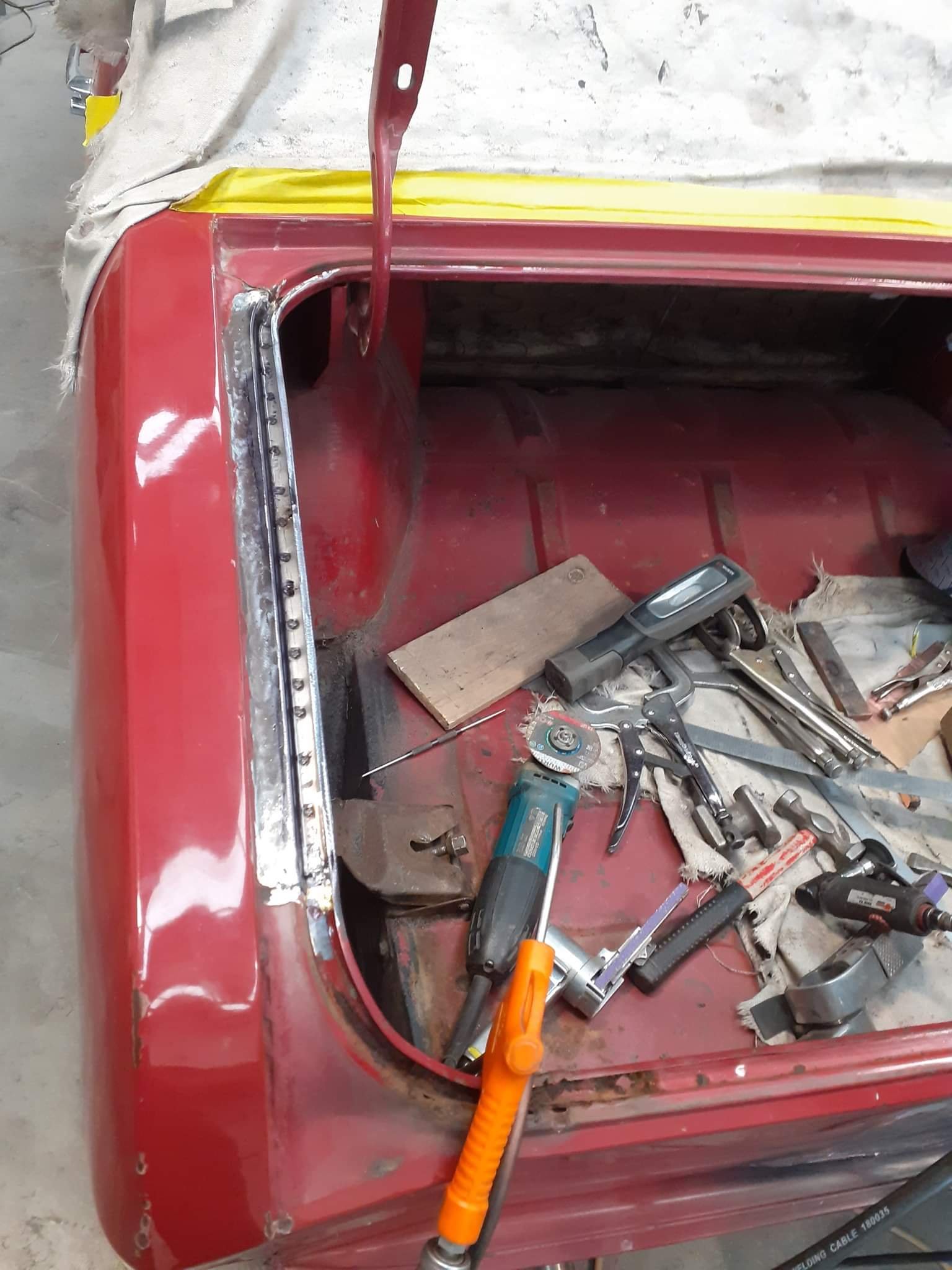

Popular Post MightyJoe Posted October 25, 2020 Author Popular Post Posted October 25, 2020 Small update. I shut the garage door on this after the bump, i was a bit over it and expected insurance to take months. But It was quoted, accepted and cleared in a few weeks so I took it to Warrick at canterbury auto fabrication. Hes got the tools and know how to do it right. He also found some rust under the rubber seal and sent me pics to ask what to do next. I asked him to fix it as shapes and angles like that are beyond my skills to do nicely. Plus with it getting painted it would be stupid not to repair it now. He sent me some more pics of progress today. Shes looking good! Thanks to @RUNAMUCK bart for the recommendation and to @- i5oogt - karl for the replacement rear light. 21 Quote
Popular Post MightyJoe Posted April 2, 2021 Author Popular Post Posted April 2, 2021 Haven't updated this in forever. After I got the car back, she was looking awesome. Just about the best she ever has. I picked it up on the saturday and took it to work the following wednesday, first time it was out since collecting it, and I got rear ended. Again. Start stop traffic. Got shunted. Fuck I lost my shit right there in the middle of the rd lol. So back to canterbury auto fab it went. Less damage tha the first time but the rear panel and support brace were dented and the bumper was gouged through the chrome so that didnt survive this time. So yeah. Lol. Gotta laugh? Got it back again before xmas. Been tinkering with it but haven't actually finished anything yet. I bought a GT dash top that needs recovering and my missus bought me the gauges for Christmas, cos shes awesome like that. They are very hard to come by these days. I was saving up to buy them off the guy but she had sorted it. I spent some time tidying them up as they aren't mint but I got them looking pretty sweet. Dash is also less than mint but that's ok. Its 53yrs old and they all need work. 11 Quote
