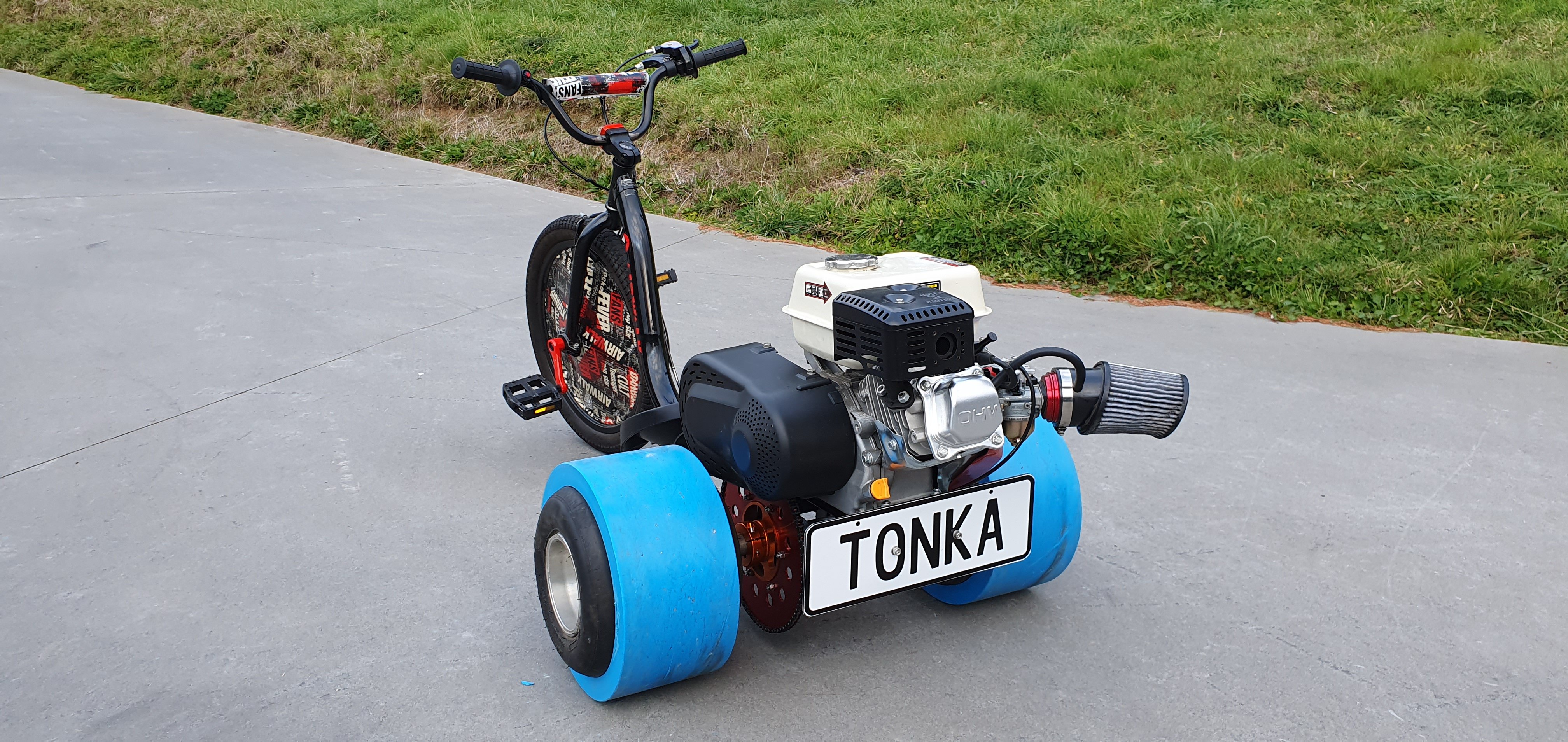

Kimjon Posted July 24, 2020 Posted July 24, 2020 Its just a mockup, but I've accumulated enough parts to pretty much get it done. Going to try a cvt on this one. I've never used a cvt on a trike yet, but I think I may be on to a good thing. Time will tell??? 2 Quote

Kimjon Posted August 26, 2020 Author Posted August 26, 2020 More progress: Brakes...pretty important on most vehicles Fuck yeah...combination spacer/crush tube brakets. Love me a good multi purpose bracket. A lot of over engineering going on here. Smashed it! Pretty much done, just need to order a few miscellaneous parts like cables to hook up for controls etc 4 Quote
Kimjon Posted August 27, 2020 Author Posted August 27, 2020 Brakes all sorted. And I drilled the jet out to 0.95mm and added a pod filter for maximum unicorns. 4 Quote
Kimjon Posted August 27, 2020 Author Posted August 27, 2020 Welded in those brake crush tubes Threw some paint on it after a quick going over with a flap disc, wire brush and some solvent. Then it fucking rained on my fresh paint outside, but only a couple drops. So just going to accept that and bolt it together as is tomorrow. 2 Quote
Kimjon Posted August 28, 2020 Author Posted August 28, 2020 Got all the big bits assembled and running well. I have to clearance out the inside of the cvt housing, because I'm running mine upside-down to usual, in order to shorten the chain as much as possible. I've hooked up throttle and wired in a kill switch on the handlebars. Its only got front brakes, which on a trike are completely useless. I need to get hold of a master cylinder and some brake line to finish the rear brakes. Pretty happy with it so far, its all falling into place. 1 Quote
Kimjon Posted August 28, 2020 Author Posted August 28, 2020 Fuck yes...seriously...fuck yes! Ready for action now. 4 Quote
Kimjon Posted September 4, 2020 Author Posted September 4, 2020 All done. Well except ummm brakes, but meh...does skids and brakes are for pussy's 3 Quote
