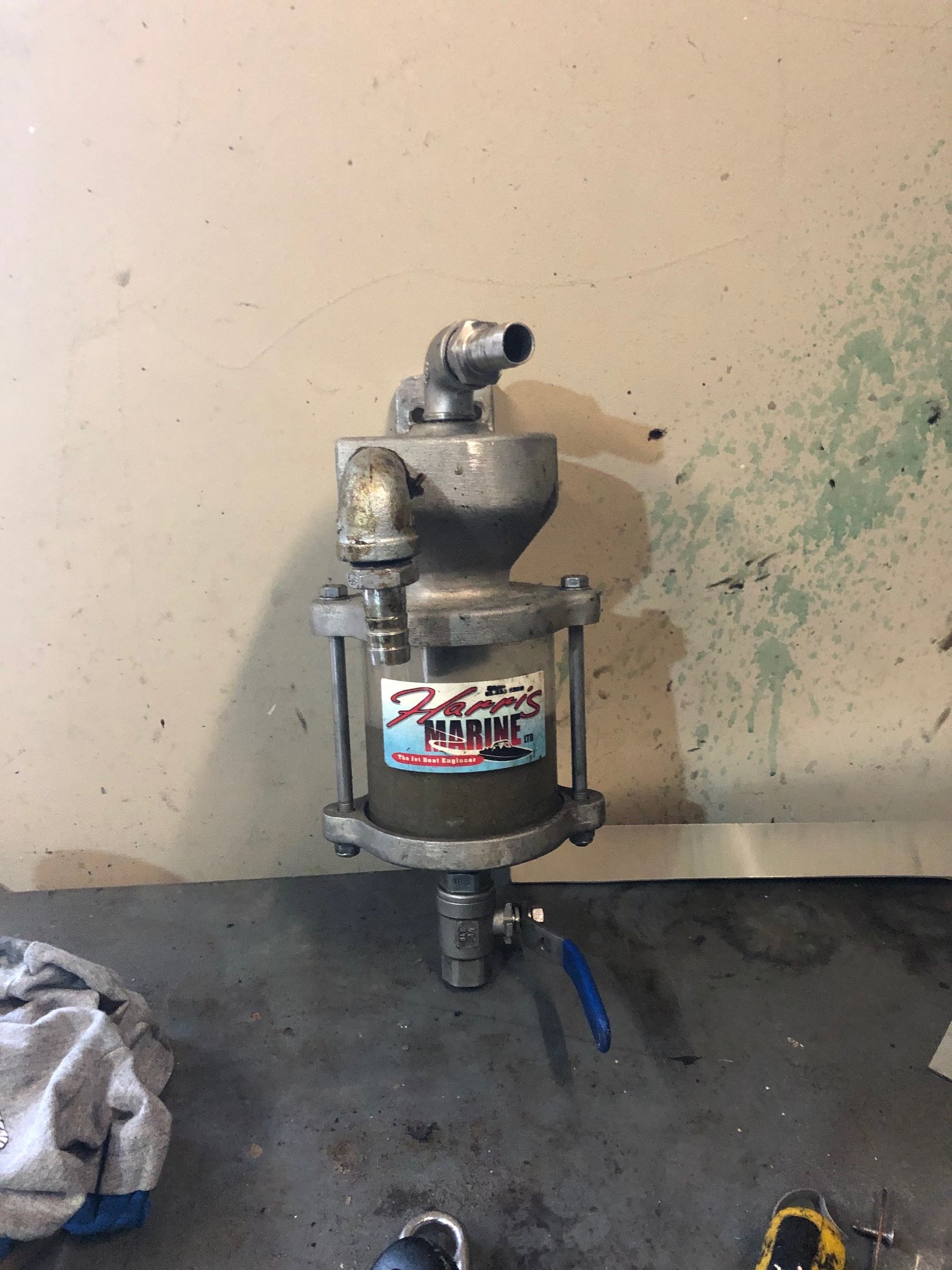

Popular Post nzstato Posted June 28, 2020 Author Popular Post Posted June 28, 2020 Got it out this weekend.... had reset the tune on it and it starts/idles alot better, still not perfect without ICAV but good enough.... trying to track down a log manifold so I can setup an O2 to do some proper logging/tuning. Also, when I did my sale inspection I noticed a decent amount of water collecting in the bilge. Mr mechanic seller wasnt to phased and was happy to use the pump most of the time to clear the bilge, I used this to negotiate thinking that either the jet unit for the bolts holding the keel plastic on would need resealed. Turns out the solution is way easier... water is fair pissing out of the lower seal on the sandtrap. Where the seal fits to the housing was loaded up with old silt and preventing it from sealing (likely pulled apart in a hurry and never cleaned), likewise the seals are old and caked up with grit. Should be an easy fix.... 12 Quote
Popular Post nzstato Posted August 30, 2020 Author Popular Post Posted August 30, 2020 Took it for another quick blat down the local river. Still haven't been able to find a log manifold to rig up an O2 but jammed another 10% of fuel across the map and pickup/idle is a bunch better. After fixing that sandtrap now bugger all leaks. Need to put in some carpet to quieten the ride and get a road cover made. 10 Quote
