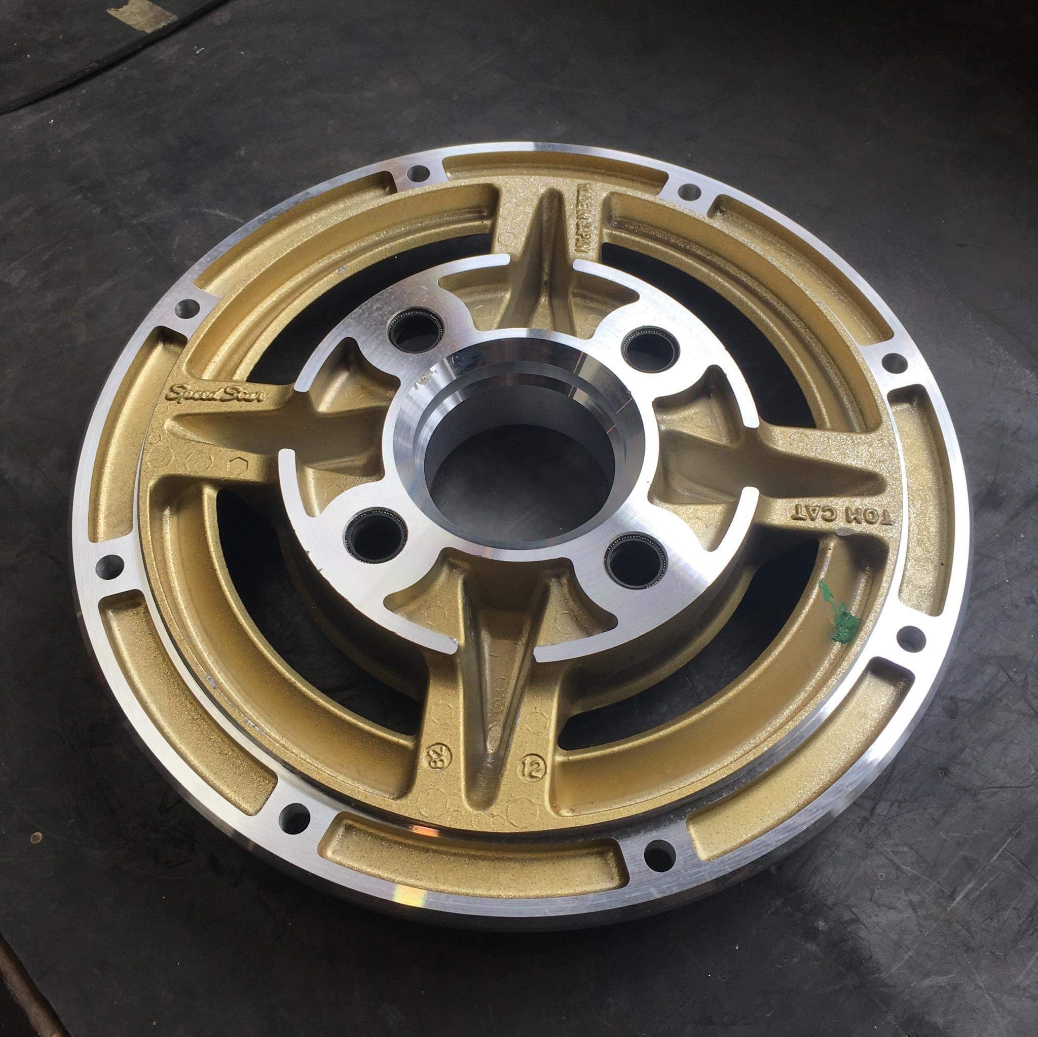

Popular Post Jeffs_Emporium Posted March 29, 2020 Author Popular Post Posted March 29, 2020 Interior all back together. Next on the list is finding a suitable double din / two single din unit to ditch the current mismatched setup (have misplaced other half of stock radio) Also try sort out aircon (1geu pump has a v belt pulley and doesn't interchange with the ribbed 1gge pulley and both pumps have different fittings for the lines) Purchased a different offset pair of 14x8 ssr mark III to hoard and try find other singles to make a set. Also have this single ssr tomcat center I've had for a while in hopes of finding three more 17 Quote

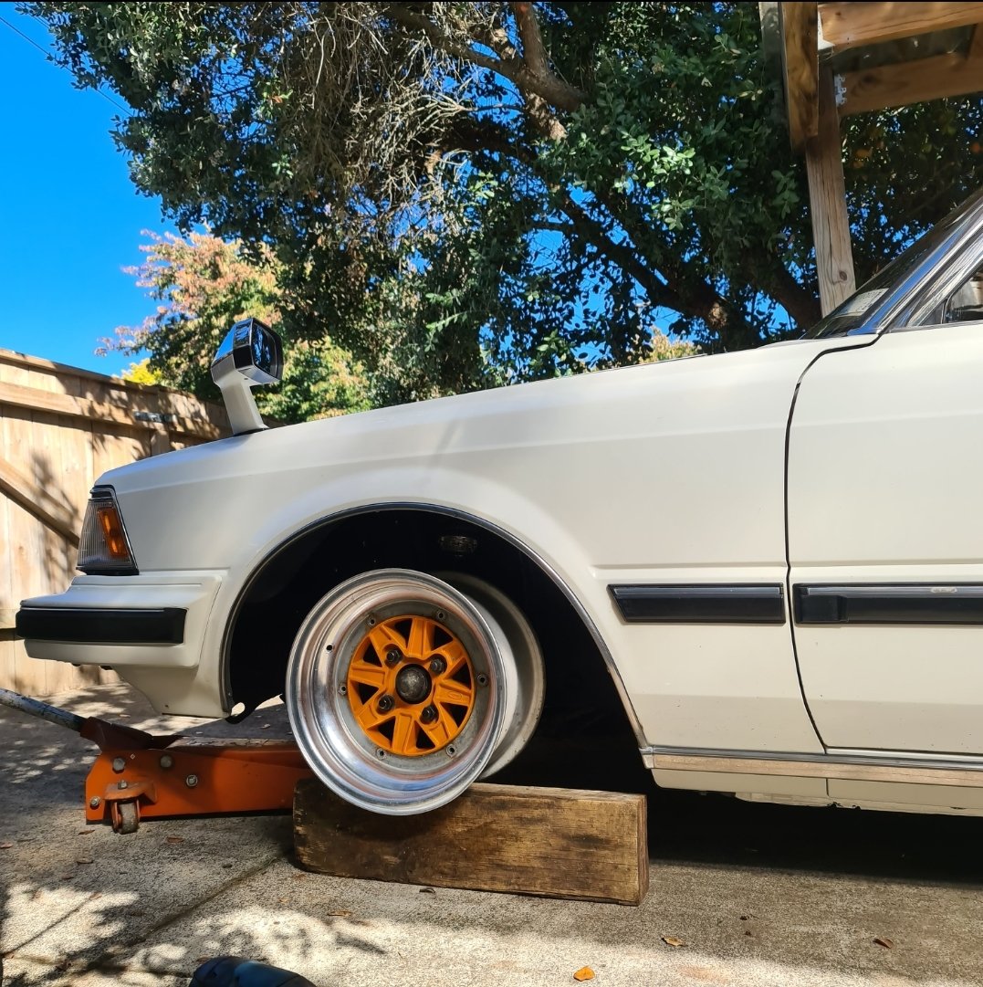

Popular Post Jeffs_Emporium Posted May 19, 2020 Author Popular Post Posted May 19, 2020 Less than ideal My options are raise 40mm to get rear camber to -1.5° or re do the camber mod with slot lower to get within correct adjustment range. Car is booked in for cert inspection Tuesday to confirm he is happy with the ride height/ everything else before I go and blow the budget re-doing. While I'm back in the back section pissing about with 1 trailing arm mount I may as well piss about with 2 trailing arm mounts and move them inwards to suit a shorter axle to suit a wider wheel. Short Axle: Wider wheel: 17 Quote
Popular Post Jeffs_Emporium Posted May 27, 2020 Author Popular Post Posted May 27, 2020 Went for cert check yesterday. Failed on relatively minor stuff, probably a half day on a hoist honing the suspension for droop and camber and bleeding the brakes properly. Going to try lift rear 20mm with original rubber spring insulators and use an offset trailing arm bush. Failing that use the adjustable perches to lift car untill camber is within spec. 15 Quote
