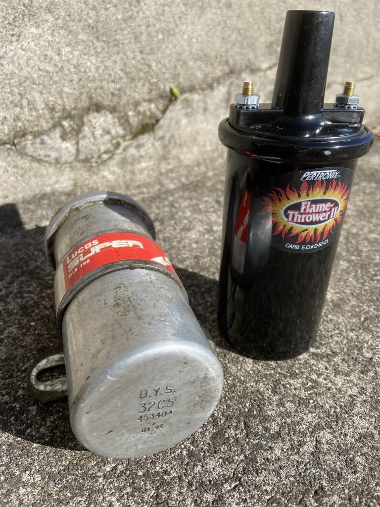

I'm still working under the assumption that the problem is caused by fuel starvation rather than by ignition, because surely if the coil was too weak to provide enough sparks at high rpm, there would be all kinds of backfires from the unburned fuel? My old Alfa would cut the spark to limit engine rpm, and when I hit that limiter too aggressively, it would just about blow the muffler apart.
