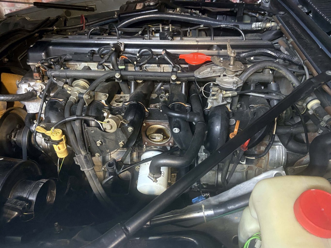

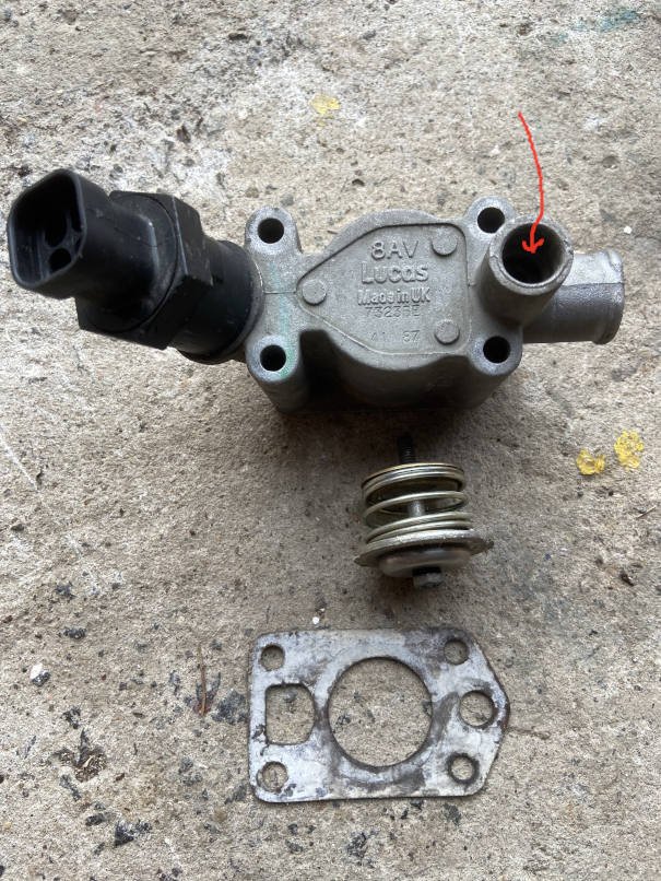

Popular Post Thousand Dollar Supercar Posted June 30, 2020 Author Popular Post Posted June 30, 2020 In my last post I thought I'd made the idle better, but it turned out I just made the car idle faster when warm and hardly run at all when cold. So I kept researching. Most results relate to the more-popular V12 engine, and you also have to contend with the fact that the AJ6 had at least two different fuel injection systems on it over the years, with and without various anti-pollution devices. Here I've removed more of the intake bits to check for gunk and vacuum leaks: Some crankcase oil must end up condensing on the throttle plate and running down into the throttle position sensor mounted underneath it (TPS arrowed, throttle assembly shown upside down): I cleaned the TPS and measured its resistance. It seemed correct and linear except slightly higher at idle than immediately off idle. I measured and adjusted the throttle plate gap, reassembled everything and followed the idle setting procedure. Basically you fake the coolant temperature reading to cause the idle stepper motor to close, then you unplug that and set the base idle speed with the air bypass adjustment screw. I couldn't quiiiite achieve a low-enough base idle even with the air bypass fully closed, which I guess isn't ideal. The idle speed seems good now (hot and cold), but the car still struggles into life if it hasn't been started in a day or two and its idle still stumbles a bit. I tried new plugs and I tried spraying flammable stuff all around the intake to check for more leaks, but no luck. The next step of the idle setting procedure is to check the exhaust CO at idle, but I'll obviously need to find a shop to do that. I think you adjust the CO with a calibration screw on the airflow meter. My iteration of the AJ6 engine has no exhaust gas oxygen sensor, therefore I guess it just bases the fuelling on the AFM reading, a wing and a prayer? (fun fact - this is better than the early AJ6 EFI which just used manifold vacuum with no possibility for calibration - the vacuum would deteriorate at quite low mileages because the engine's valves didn't seal very well, or something nightmarish along those lines...) Anyway, my aftermarket electric aerial destroyed itself already. A piece of a little cog broke off and jammed the big cog..... ....but the Jaguar inline fuse did not blow. Instead the motor got very hot and began to melt the surrounding plastic, until a wire connected to the motor burned through. Electric aerials are very important and I couldn't deal with mine being out of action, so I bought another of the same brand. When I opened it up to oil the crap out of it, I noticed it had been revised - the cog which broke in the old one is now made out of a black material in the new one. Hmmm. Also, I spotted this XJ-S (not mine) with a lame personalised plate: It looks like they've parked their planet-pillaging V12 in a bay reserved for bicycles only, which of course they could get away with....because they've got a Jaaaaaaag. 17 Quote

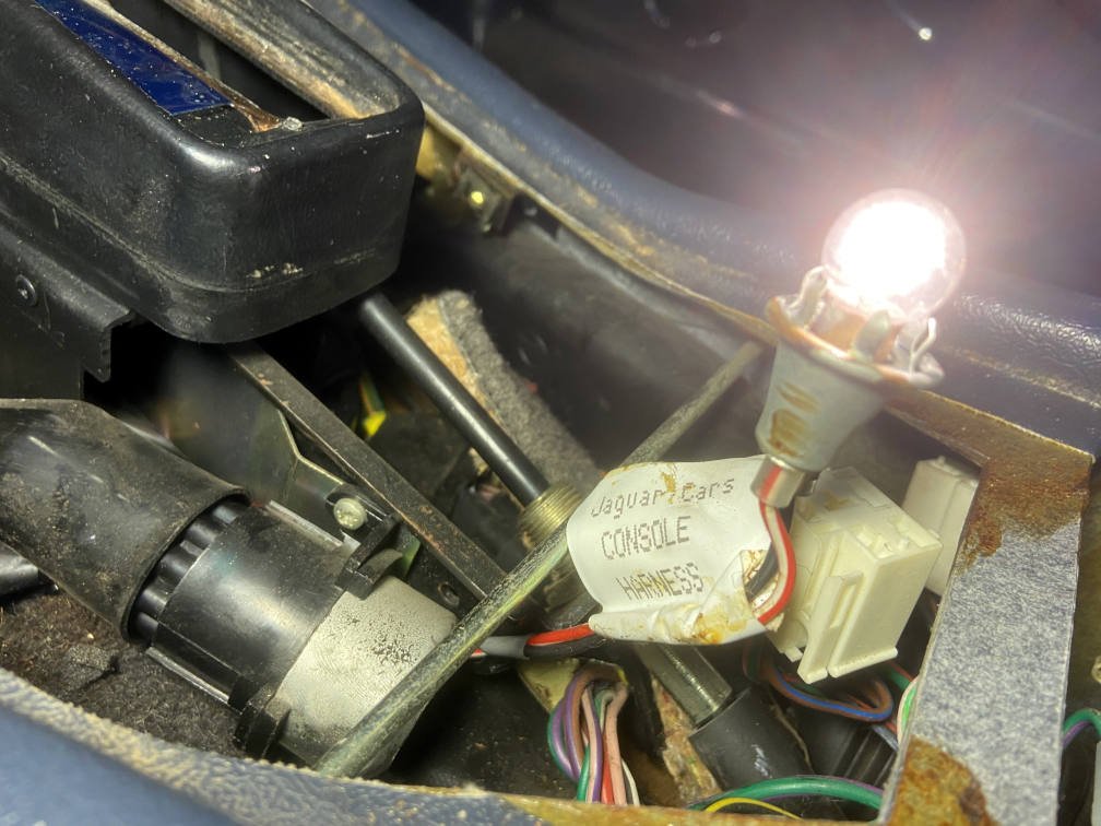

Popular Post Thousand Dollar Supercar Posted July 19, 2020 Author Popular Post Posted July 19, 2020 On 19/04/2018 at 11:18, Dolan said: dont these have hilarious early fibre optic spec dash lighting? It turns out I do have such a thing, hidden under the gear selector: One bulb to light them all Quite a job to find them Ten leads to bring them all to the Prince of Darkness bind them. Why was I taking my centre console apart? The varnish was lifting off the veneer: I removed the varnish pretty easily with a stripping disc, but this just confirmed that the veneer itself was cracked, not just the varnish. I probably should just buy a new one for £175.00 from the finest English craftsmen, but meantime I tried some Danish oil: Unfortunately if you press that growler face below the right-hand ash tray, it doesn't call upon the power of ten tigers. It's just a switch blank where the cruise control would be on a V12 car. 18 1 1 Quote
