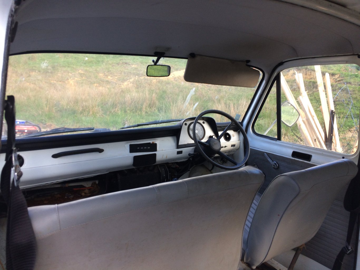

Popular Post pusherman Posted July 30, 2017 Popular Post Posted July 30, 2017 Hi team. After a bit of attention in the whipping a v4 thread i figure there is some love for a dirty old transhit so here we are First impression Discussion: 16 Quote
pusherman Posted July 30, 2017 Author Posted July 30, 2017 As far as i can see complete and unwelded. And not terminal with the big c. 7 Quote
pusherman Posted July 30, 2017 Author Posted July 30, 2017 From day dot I determined this one is staying dead stock standard. As the kray brothers would have used as a getaway motahh. Hasnt run in atleast 2 years. Has no brakes. Last reg is march 98. I did some snooping via facebook amd the old boy that had the van died in 2014. No kids or family to speak of. Aparently he used it to collect his produce in orchard. And has always been barn stored. Hence the not being rust fucked 8 Quote

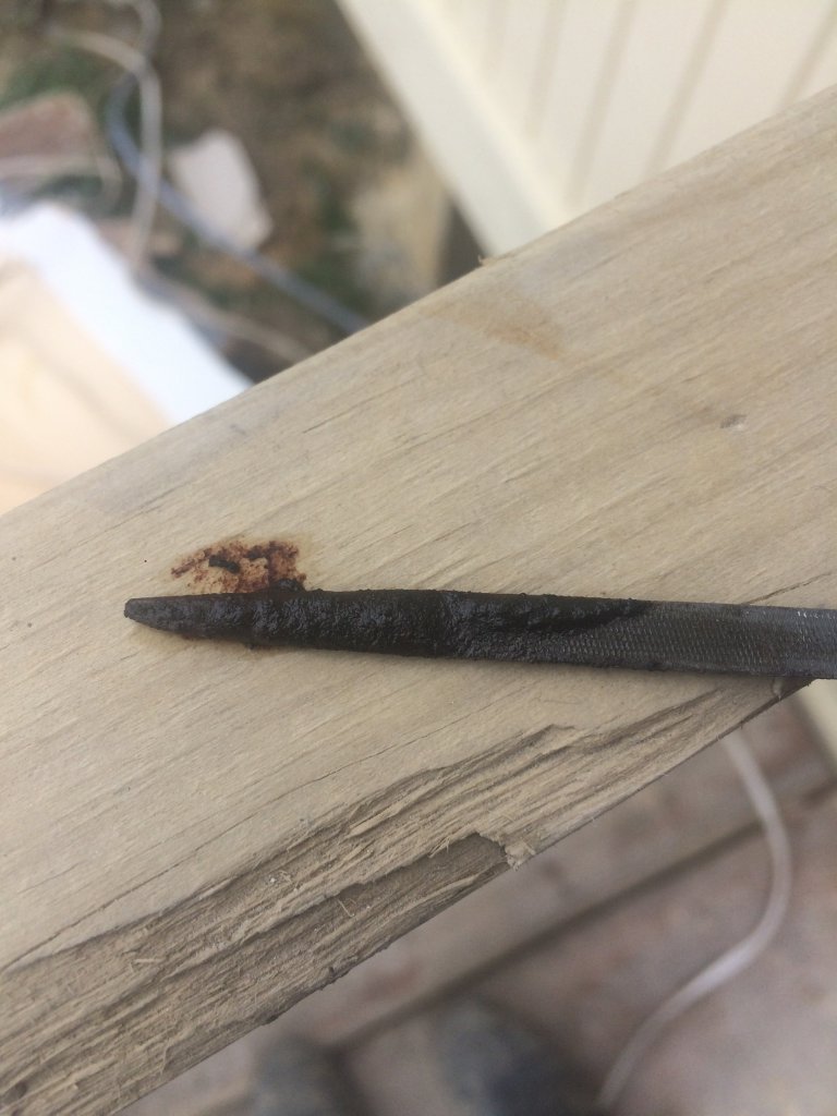

pusherman Posted July 30, 2017 Author Posted July 30, 2017 So i lovingly removed the plugs and gently turned it over. Got some fresh plugs in. Checked the oil was still oil And put a battery on after changing battery and adding another battery coz ive got 3 and they were all dead. It spins. Wouldnt fire so i gave the points a quick tickle and added mor ether to the carby it fires!!!!!!!! Wont run buy itself but for 3 seconds at a time if you feed carby it runs 8 Quote

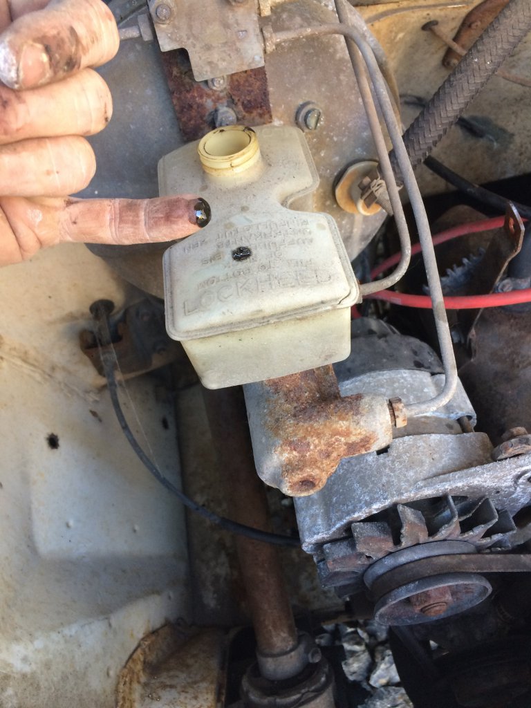

pusherman Posted July 30, 2017 Author Posted July 30, 2017 Found out why it has no brakes. Like no brakes at all coz it has no brake juice 6 Quote
