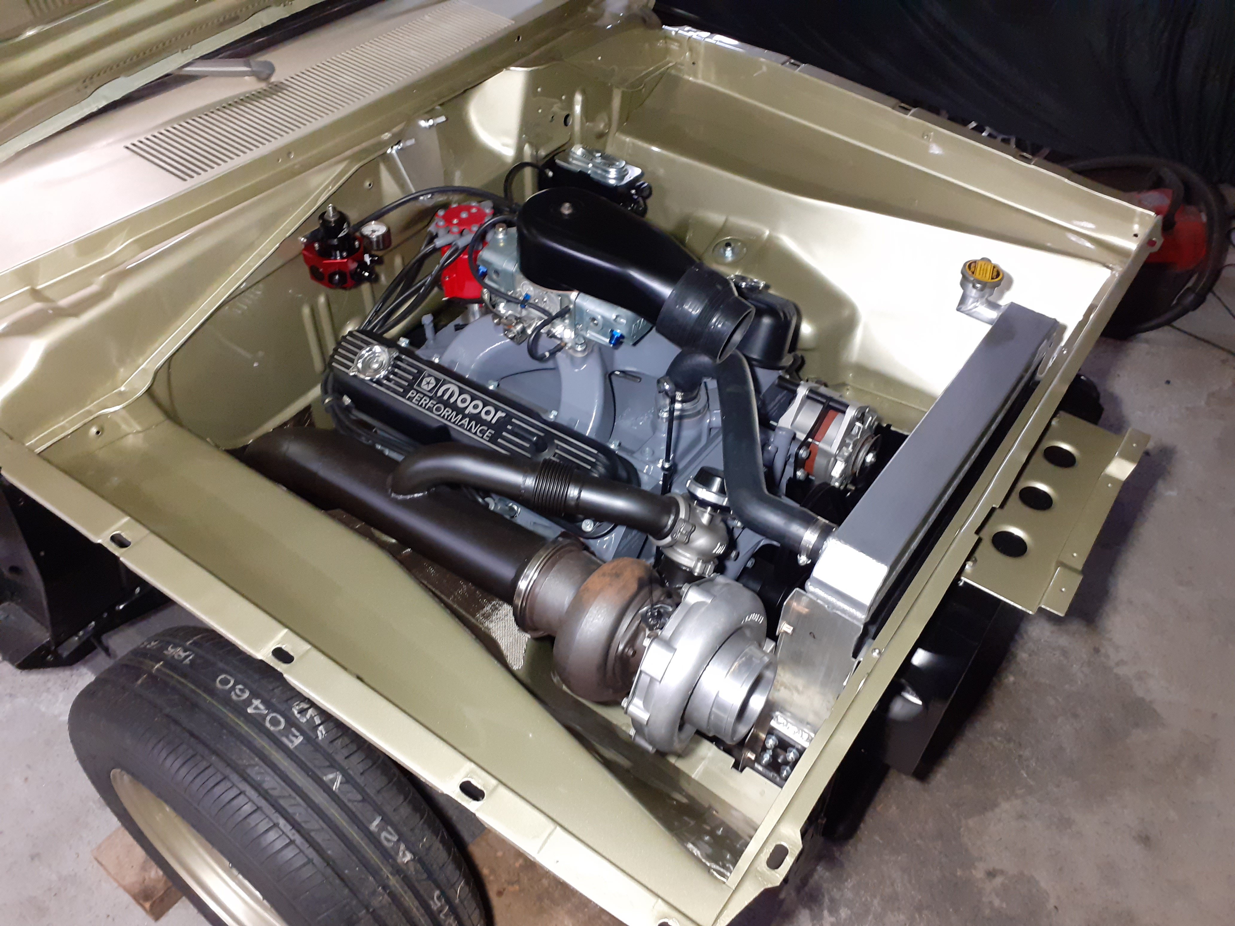

Popular Post cletus Posted May 21, 2022 Author Popular Post Posted May 21, 2022 Kicked er in the guts trev 16 5 Quote
Popular Post cletus Posted May 22, 2022 Author Popular Post Posted May 22, 2022 Set float levels, idle mixture, decided there was no better time than now to get all the piping back on for good. Now goes waaahhhpishhh tested all gears, wheels go round. I think the cooling might be borderline, it gets pretty warm (195f) and twin 10" fans was as big as I can fit. I'll see what it's like once it's mobile and can be driven in traffic, I might have to get some better quality fans 48 4 Quote

Popular Post cletus Posted June 19, 2022 Author Popular Post Posted June 19, 2022 It drives. Got a few bugs to work out though. The main one is it gets hot, and can't cool itself down. This might be a bit of a prick to sort out as there's no room left I think it has more boost than it should do Brakes are a bit spongy, might need next size up master cyl, might improve once they bed in a bit Seats are a bit low Needs something to stop the pinion angle changing under accel, driveshaft just knocked the floor slightly 59 5 1 Quote
