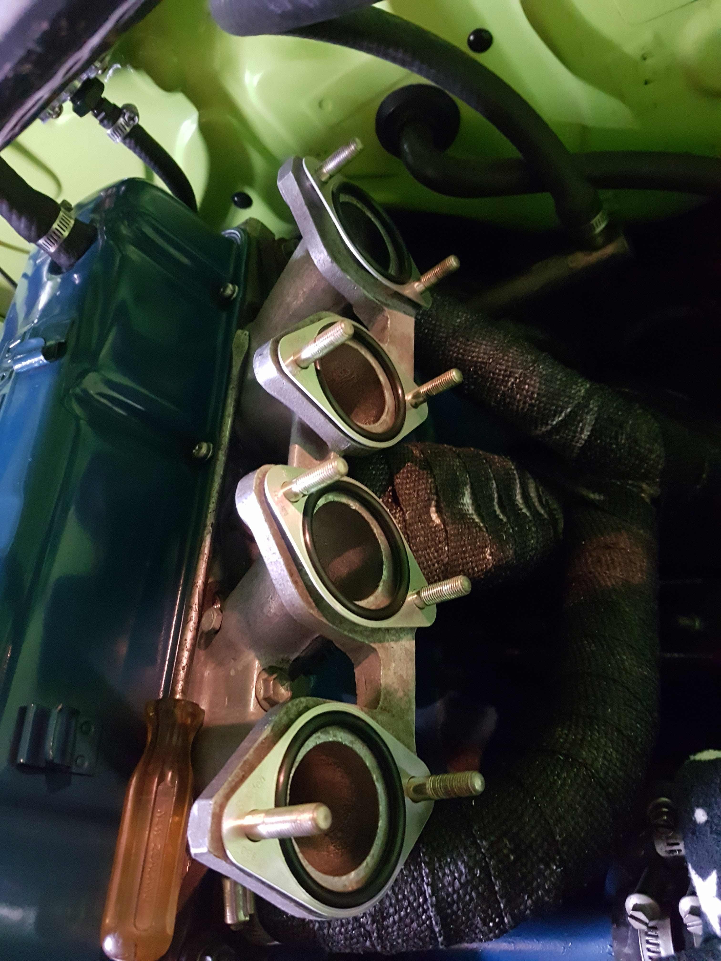

120why Posted August 29, 2018 Author Posted August 29, 2018 new rubber carb gaskets from palmside AND WHO STOLE MY ORIGINAL STANDARD DATSUN GREEN!? TOYOTA PRIUS.... 4 2 Quote
