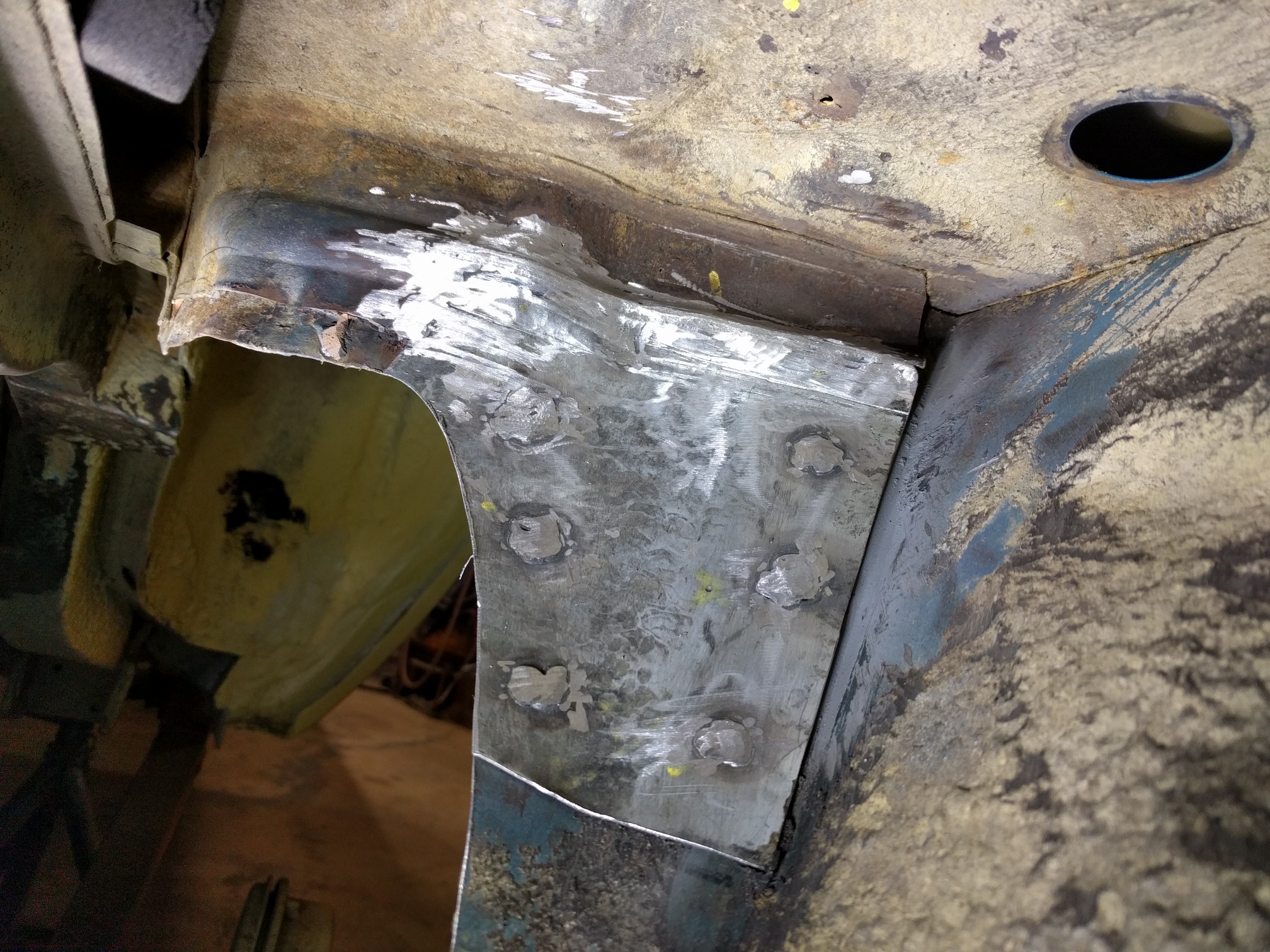

Popular Post bmxnz11 Posted November 23, 2015 Author Popular Post Posted November 23, 2015 ...Fuck. So dug a little deeper and got to this point before finding good steal. This is directly above the rear wheel. Effectivetly its 3 layers. The bottom two fold over each other to create a seam over the wheel arch, all spot welded together. The rust was between these two layers. Not sure how it started because it was covered in underseal and doesnt seem like a prone area. Anyway, i made up patches for these two, primed and welded the top piece back on which was rust free. The holes on the right were patched up too. These were for the poorly made back seat bracing which i'll remake later on. Decided to check the other side, same story, rust between the 2 bottom layers. Cant work out why. So i gave it the same treatment. This knocked me back a bit. Before the day was done we were able to blow the whole van down, prep it and spray 2k epoxy metal sealer through the seams, chassis, sides, anywhere paint cant be sprayed. Finds its way into every seam and hole throughout, messy job chasing the drips. This stuff is great, similar idea to cavity wax or fish oil but this stuff sets and can be sanded and then painted. Busy 3 days. //oldschool.co.nz/index.php?/topic/43995-bmxnz11s-mk2-escort-van/ 13 Quote

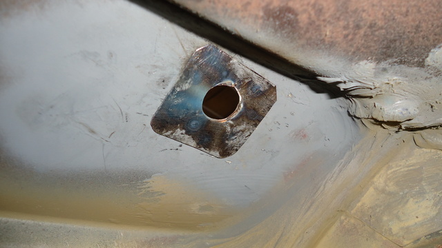

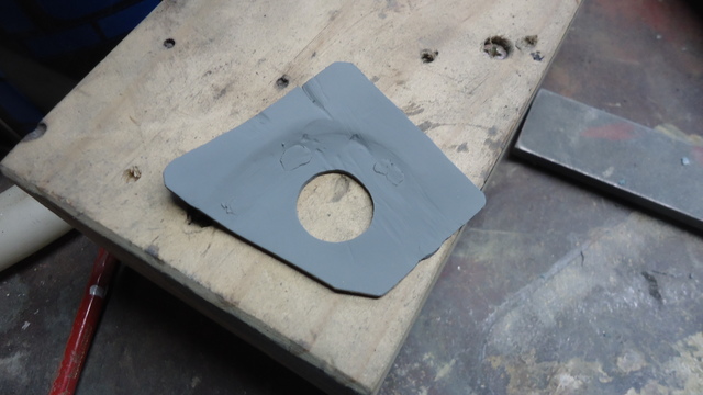

bmxnz11 Posted December 10, 2015 Author Posted December 10, 2015 One of the small jobs ive been putting off was fixing the window wiper holes. These were flogged, the hole wiper system was flogged. There were stress cracks and the holes were no longer round. Opened up the cracks, drilled a few plug holes and welded underneath a backing plate to give it a bit more strength. Did the same to the other wiper hole. All cleaned up. 2 Quote

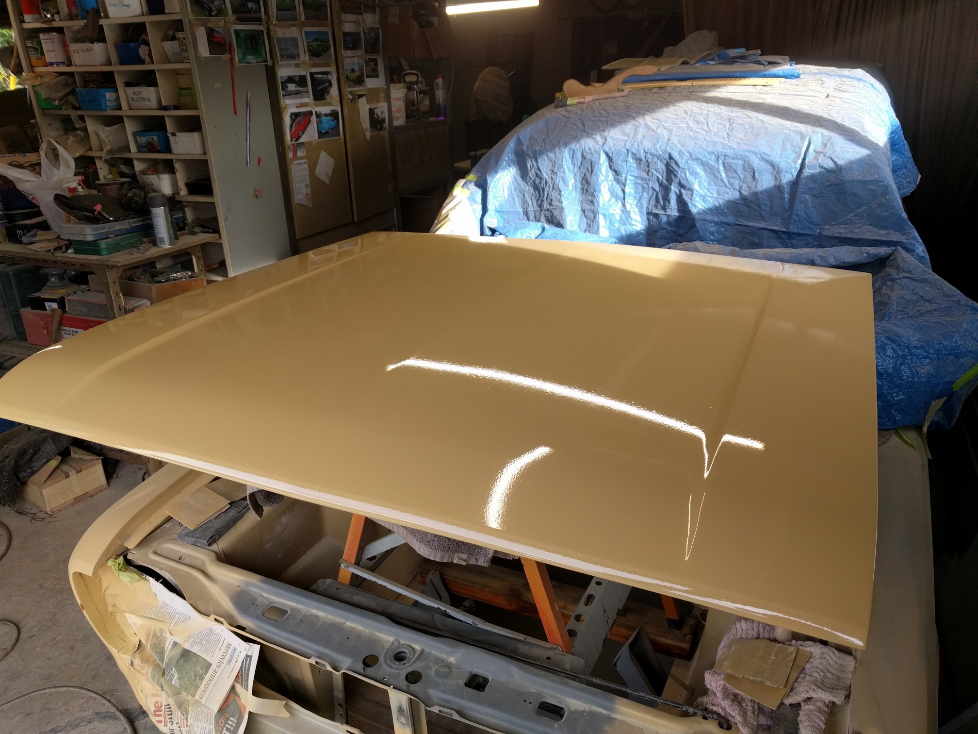

Popular Post bmxnz11 Posted March 27, 2016 Author Popular Post Posted March 27, 2016 The roof was long boarded down and any imperfections were sorted out. Also seam sealed the two edges where the roof panel meets the sides. This is the rear corner looking over the roof. Sprayed on the final primer, dried very quickly but was able to keep it wet and glossy. Looking very straight now. 10 Quote

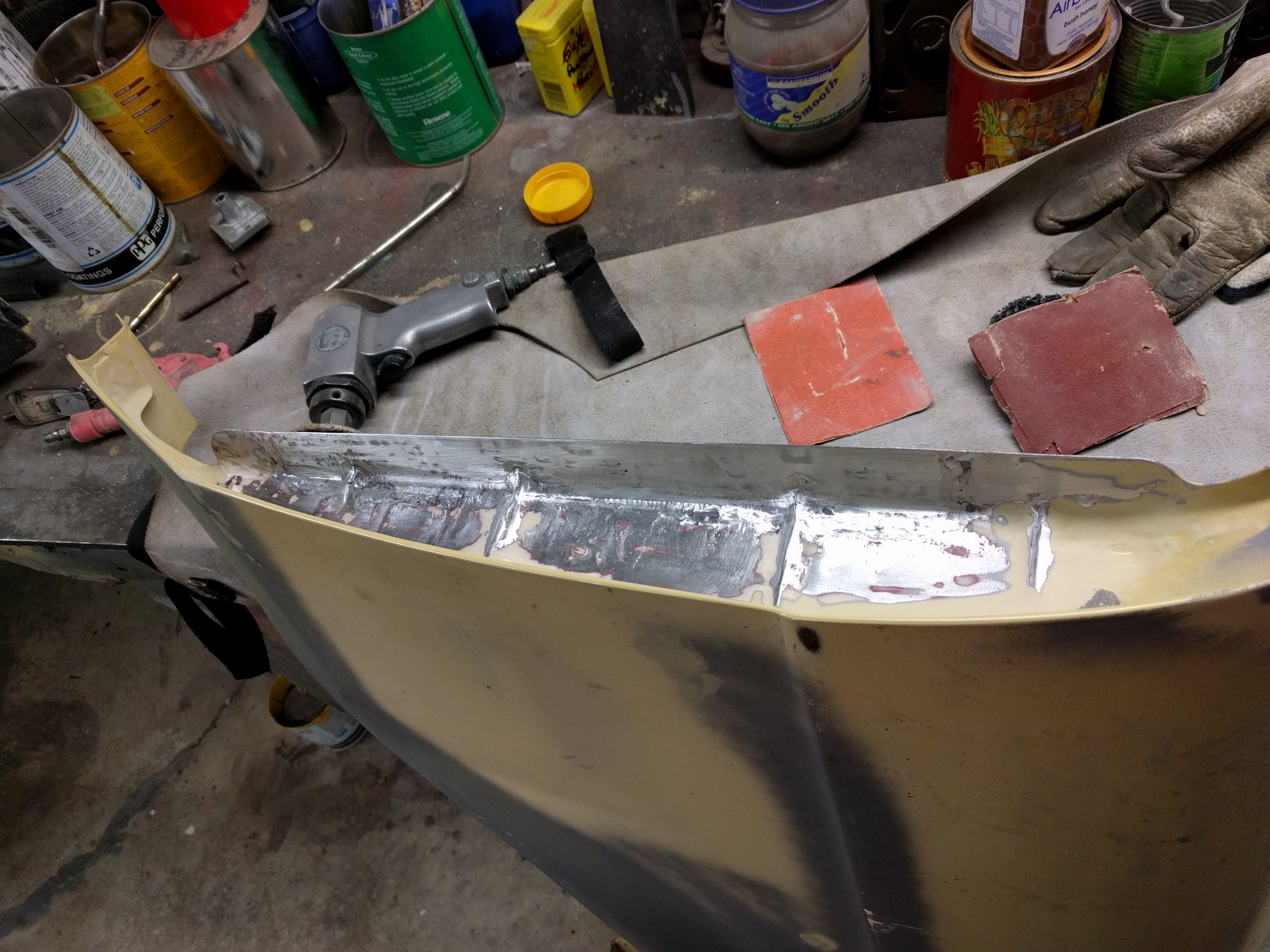

bmxnz11 Posted July 6, 2018 Author Posted July 6, 2018 Have been working in this. Just seems to take for ever. Lined up the drivers door, guard and bonnet. The guard was poking out too much by the door. The inner vertical section of the guard that holds to the pillar was too wide. I ended up chopping this piece out and redoing it. This time it hugs the pillar and holds the guard correctly in line with the door. I also found a few imperfections and spots of rust bleeding through on the drivers guard. I had to rub most of down to metal and reprime and fill. The guard and bonnet were then primed in final primer. 7 Quote

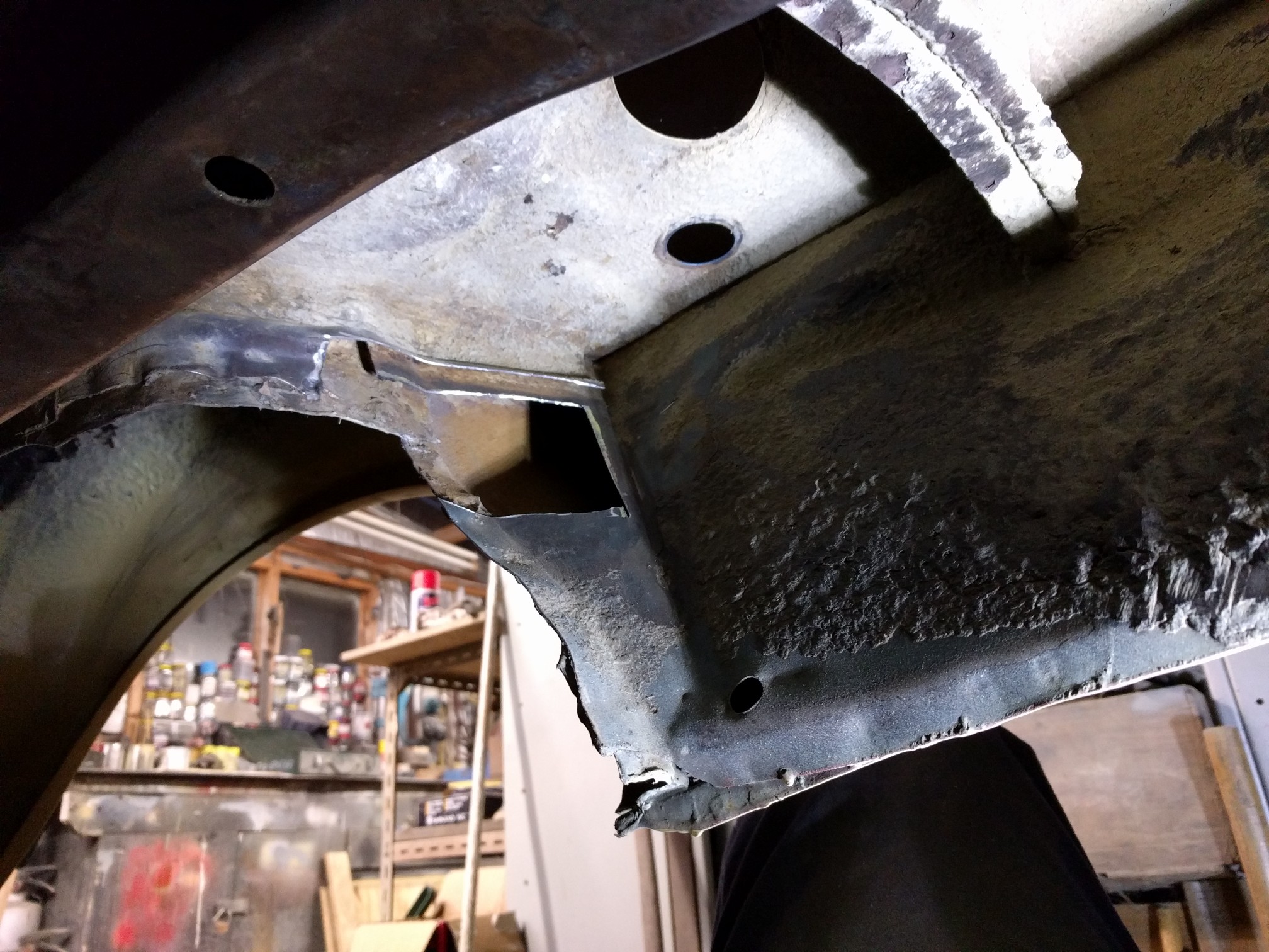

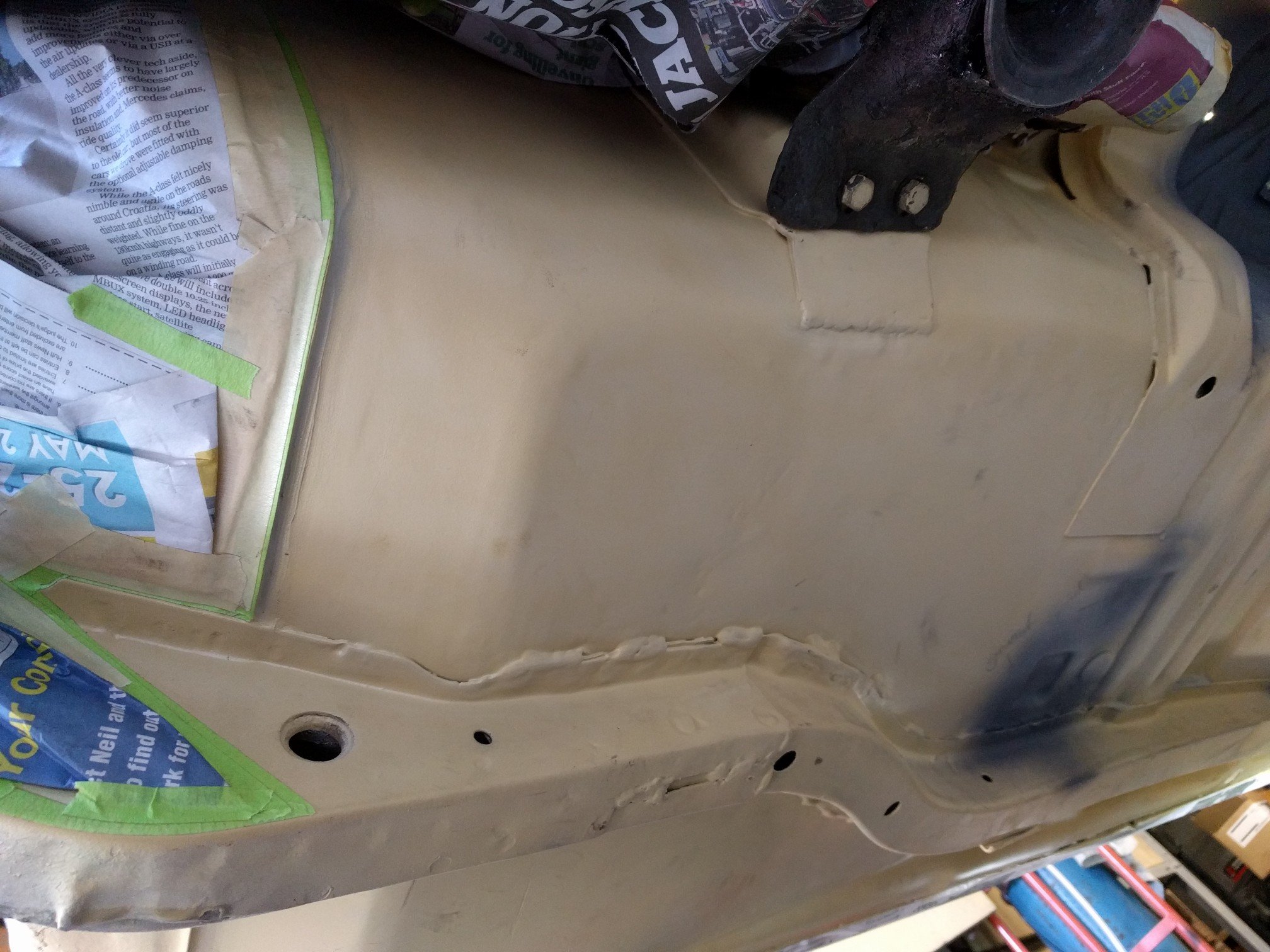

Popular Post bmxnz11 Posted July 10, 2018 Author Popular Post Posted July 10, 2018 Next job is getting the underside ready for underseal. Whilst I was with wheeling I found a spot of rust. It's an area I have repaired of my blue van and the passenger side of this van, but for what ever reason left the drivers alone. It's behind the rear wheel arch. 2 layers of metal which trap the dirt and moisture in. Cut the layers out and replaced with new steel. So much fucken otago dirt. Will etch prime the bare areas once it's clean and then onto underseal! 10 Quote

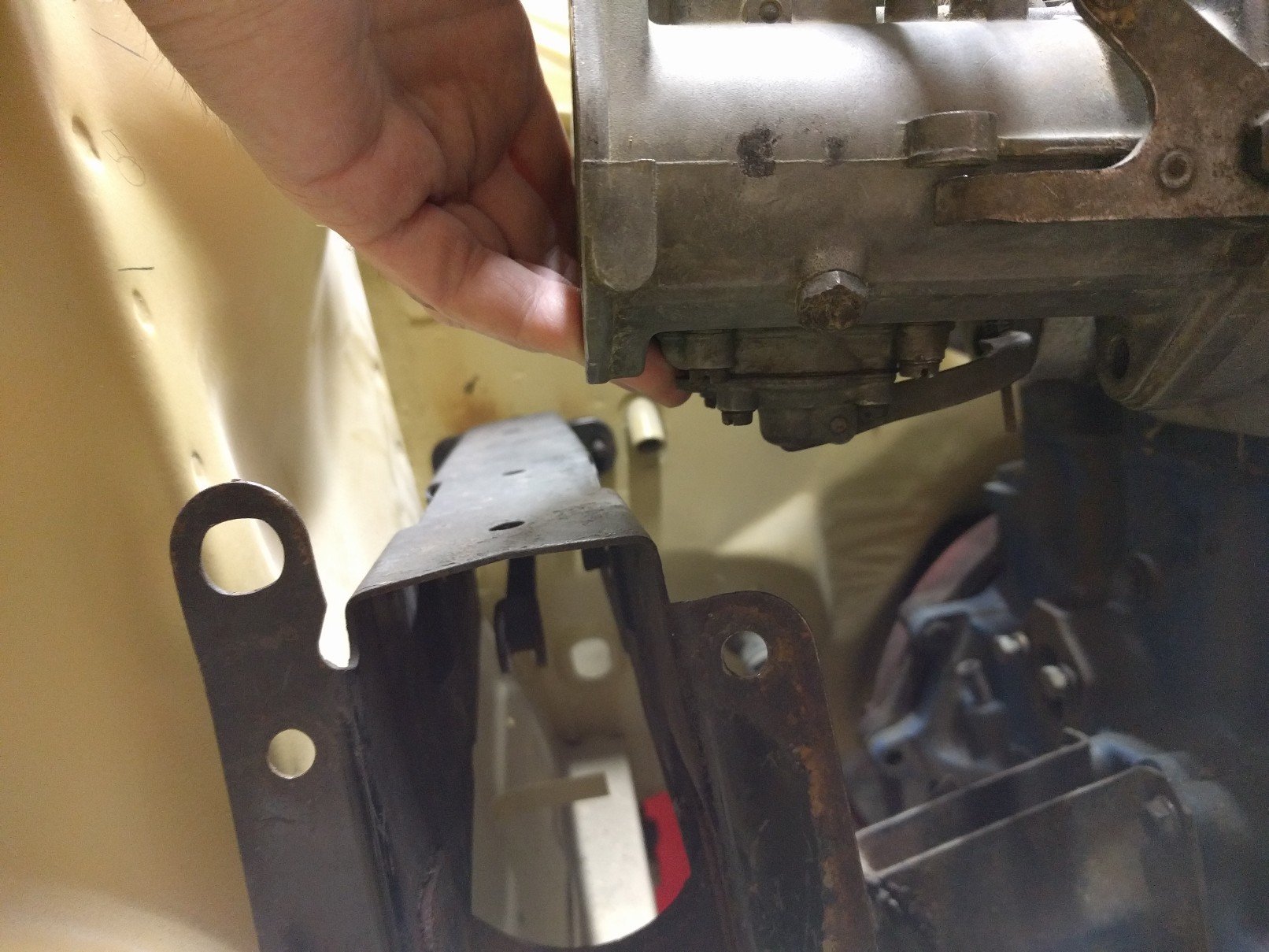

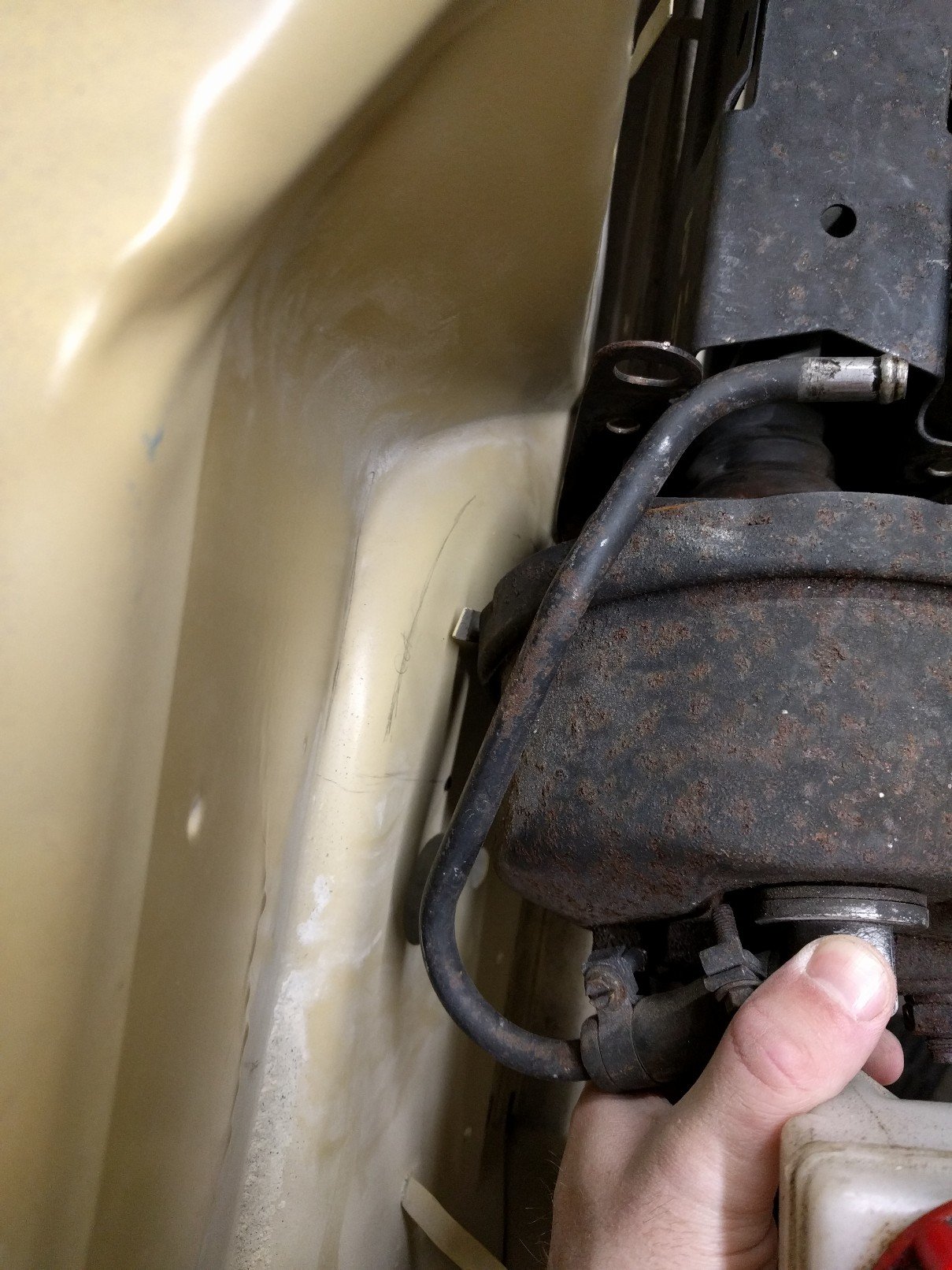

bmxnz11 Posted November 6, 2018 Author Posted November 6, 2018 Where has the time gone. I finished cleaning the underside, primed it and redid one of the sill areas as I wasn't happy with my initial repair. Have still to underseal the van. Another of the jobs that needed doing before paint was to lower the brake booster for the side drafts clearance. I read and talked to a few people and everyone said to bend the rod and lower 50mm, redrill the holes. I couldn't work out how to lower the bracket without fouling on the inner fender or the area around the fan where the brake line is. I decided I wanted to keep the original holes and mounting points in case it all turns to shit. So instead I modified the booster bracket and made a new bottom section which is 50mm lower but uses the same holes. The other issue was the mounting tabs to the firewall. When the booster is lowered, the top pulls away from the firewall. I fixed this by slicing, bending and welding flat against the firewall. The next step is to push out the inner fender so the booster sits in nicely. Hopefully everything will look factory once it's done. 5 Quote

bmxnz11 Posted December 3, 2018 Author Posted December 3, 2018 Finished the brake booster mod in the engine bay. Plenty of room for the side drafts. Will clean up fine with some underseal and another coat of primer in the engine bay. 2 Quote

bmxnz11 Posted February 11, 2019 Author Posted February 11, 2019 Finished all the mods to the engine bay for the brake booster and the bolt in battery tray. Seam sealed and reprimed. Have done a few more small jobs such as sand blasting and painting the pedal box and battery tray. Just need to get some paint samples now. 7 Quote
