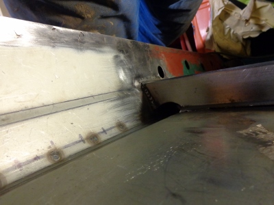

Started work on flaring out the under skin. Cut most the old lip off and flared it out to meet the new flare. Want to do it correctly and give myself as much clearance underneath as possible

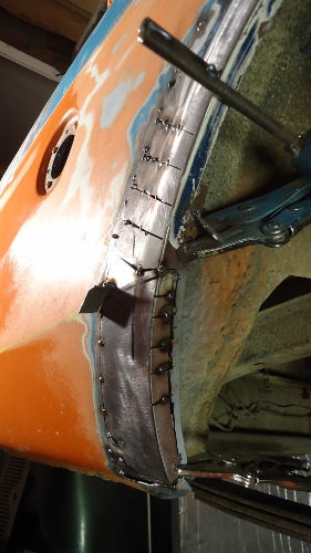

Tacked on the new flare and started to make the the panel behind the rear wheel to match it
Tacked the flare to the outside of the van to shape and mock up. This is where the ferris wheel jig proved magic. Not only did it provide me with the correct/ original circumference but i also welded tabs onto each point to limit how far the flare sticks out. At this point the under skin touches the flare and this will be welded up later. lots of cutty cutty and weldy weldy and i had a flare i was more or less happy with.

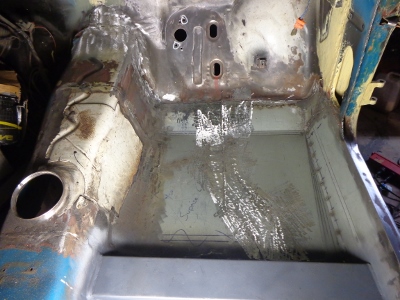

Did the last of the rust repairs and metal work around the sill and arch. Taken back to glorious glorious metal and then for now just brush painted on 2k primer. Skim of neutech and it should tickle it up quite nicely
