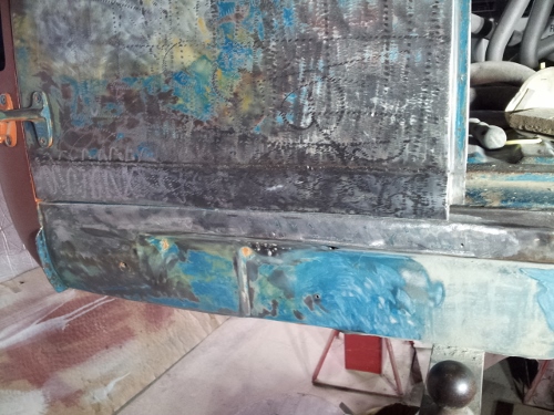

2 nights of careful painfully slow welding and grinding and i have a warpfree panel in place. Welded it on the inside as its a flat surface compared to the channel on the outside, this made for easier grinding. Hit it with the flap disk, quite stoked with the result. Patience paid off. Will give it a coat of 2k primer and a skim of nuetech tomorrow
welded from the inside
Outside

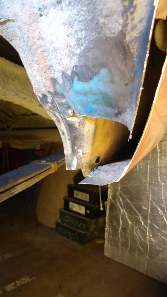

Have been replacing it with new metal this week. Then started on the skin under the flare. Cut back the old rusty stuff and tacked on a new strip. Will trim it later to suit

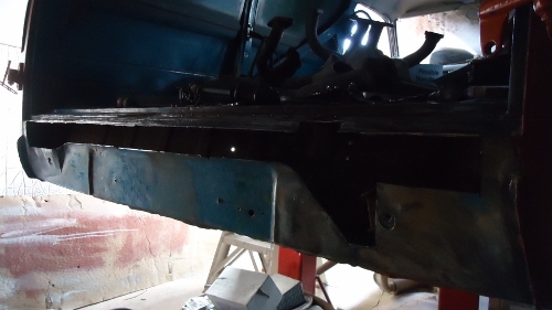

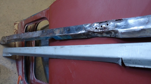

Have been doing alot of rust repairing and prepping for the flare. Tidied up the ends of the sill, the under skin, cut to suit, gave as much clearance underneath as possible

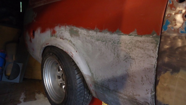

It just didnt look correct so after alot of measuring i decided the passenger flare didnt match the drivers side and stuck out 5mm too much in the centre. Decision was made to cut the edge off and move it back.
Wasnt too much hassle, just disheartening. Finished the rust work in the corners under the flare while i was there
Took away the supports and sat it down on the reset leafs to see how low it sits. Bonners all round.
99% happy with it now, need to cut another small section of the flare out and move it back in. 2 steps forward, one step back it seems
