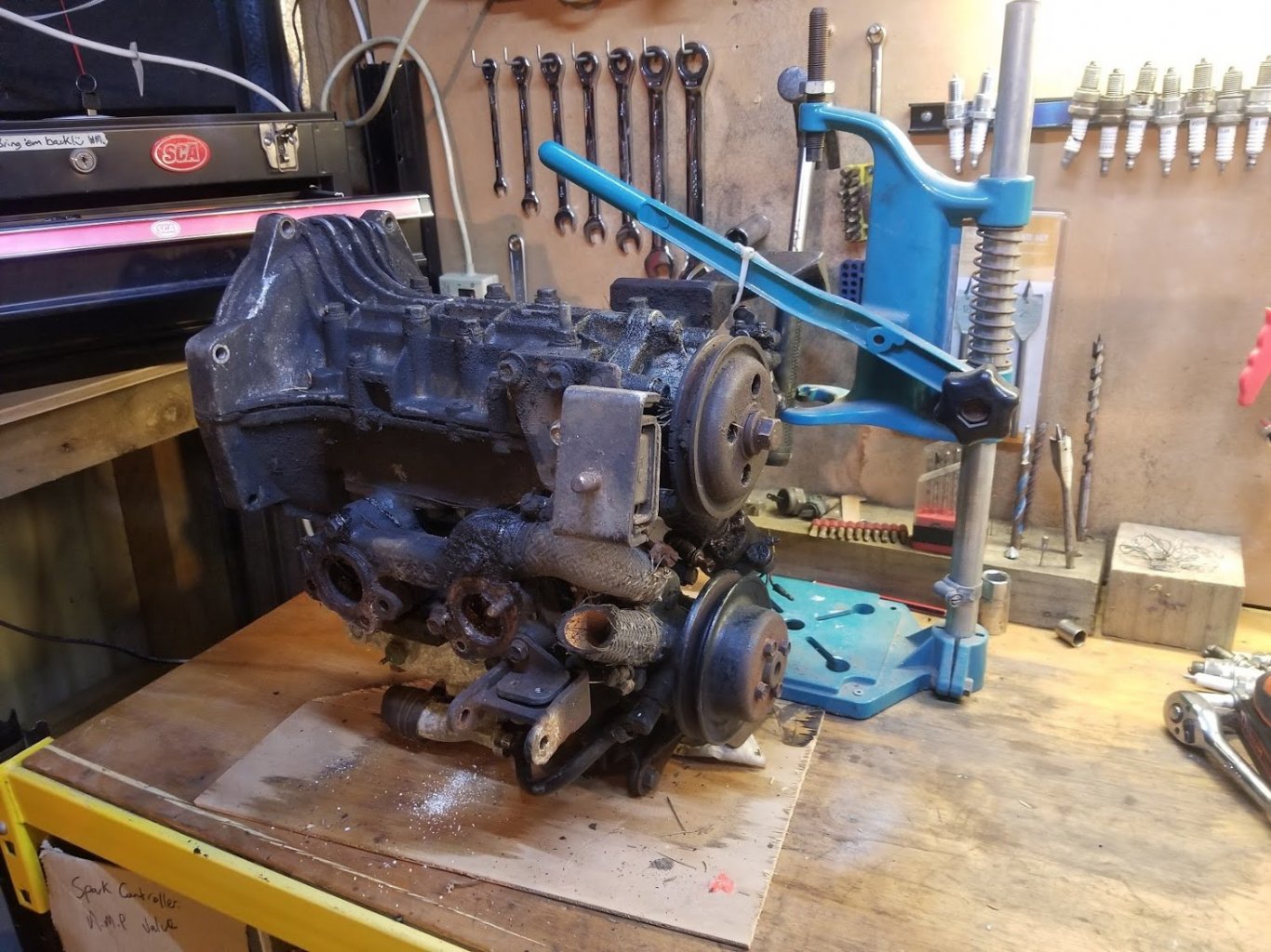

I've been chipping away at that corroded boat anchor motor.  Bits of it were OK (starter fine, alt could be ok) but the carbs had inhaled water for years, so lots of the motor is junk. I was quite interested in getting the distributor assy off it (have disassembled most of it) but I think the cog / gear wheel at the bottom of the shaft may be corroded solid. I haven't been able to split the engine cases to see in there, even with all the bolts out. I may just give up on it soon. I had hoped to have a spare to match the spare engine I have.
  • 4 weeks later...
The lump above is still on the bench, other life things have needed doing.

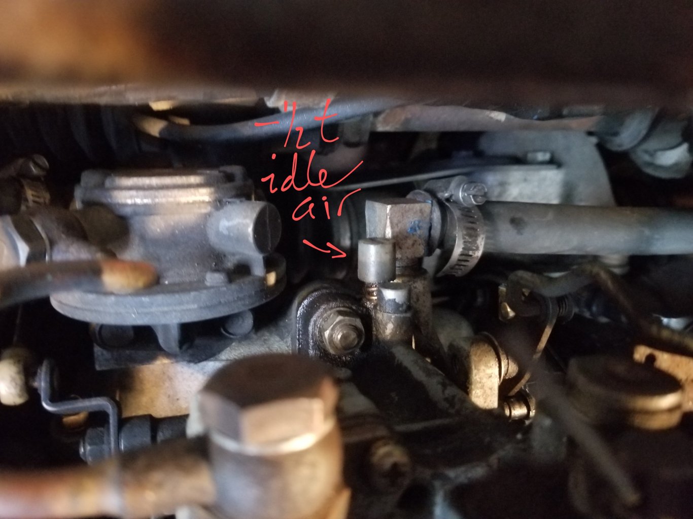

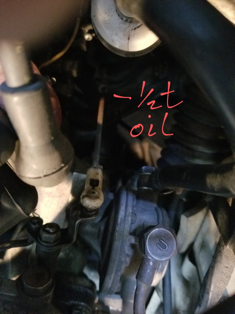

This engine still feels like it's leaking in air at idle / over run, but I closed off the 2T oil by 1/2 turn (was too oil rich) and the idle air circuit 1/2t, and it's now acceptable enough until I get time to swap the crab.
So, looking down the back of the motor (my tuning notes for later):
20200524_142257_2.thumb.jpg.d11b65acec8a0918d29f36d17bbe3df5.jpg20200524_142306_2.thumb.jpg.7acb1fc6de957933c74ae893d12f4559.jpg
