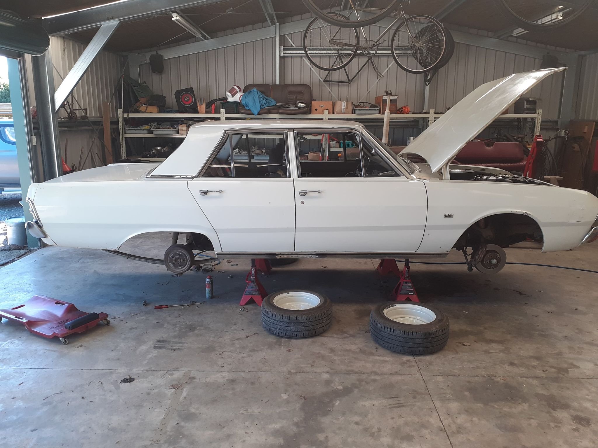

Popular Post Valiant Posted November 15, 2020 Author Popular Post Posted November 15, 2020 Low level stuff here but worthy of sharing? The car is still going great, I have taken the computer back a couple of times as the car was prone to kicking back on cold starts and to raise the rev limit slightly. No problems though and no charge so A++ to PAD Racing again. I've been driving the car quite a lot since the last update and noticed that the steering was getting nastier and nastier. The front wheels were squealing on roundabouts etc. I jacked it up and found that the front lower arm, inner bushes have died on both sides, disappointing really, they were only 15 years old! While it's up in the air I have a couple of other things to do, the rear brakes are iffy, I think the wheel cylinders are getting a bit tight, I'll sort that out. The LPG tank is a bit on the small side (about 57l I think) which gives me range anxiety, I also had to mount it back to front when I fitted it which means I can't see the manual level gauge. I have a much larger 80l tank that I will fit to the boot while I'm working on the car. I have a couple of other odds and ends to do, I'll keep you posted. 22 Quote
Popular Post Valiant Posted November 22, 2020 Author Popular Post Posted November 22, 2020 I pulled the lower arms out of this today and what a crumbly mess I found. Luckily last time I had it in bits I cleaned all the threads and greased the torsion bar hexes so it came to bits nicely today. after a little grinding and a nudge in the press, good as new, Thanks to Valiant Precision Driving Team captain @cletus for supplying some new rubber bushes. The old bus should regain its razor sharp handling characteristics. 17 Quote
Popular Post Valiant Posted December 29, 2020 Author Popular Post Posted December 29, 2020 Bushes replaced and the Valiant drives nicely again. One of my boys finished year 8 schooling, they have a formal and parents etc are invited to drop their kids off at in front of the school hall pre formal. The valiant beached quite loudly as I was turning onto the field which my son thought was fantastic. Good boy! He was very keen on some school field paddock work. I exercised the utmost restraint and no circles were done. Here's a pic of some previous grass silliness. I put the Superlites on for the school run. Then decided I didn't like them and took them off the next day. I'd quite like a set of these modernized Cheviot Quattro's but the budget won't stretch that far at the moment. anyway that's enough sharnes. I have done some productive stuff too. I got my big fuel tank re tested, blasted and painted. It's slightly larger in diameter and considerably longer than the old one. My calculations suggest it will hold about 20 Liters more fuel than previous which equates to about %30 more. Luckily I managed to fit it into the old tank straps which was a bonus and saved much fucking about. Old. New. I Need to sort out some new ducting as the tank has is designed for 60mm as opposed to 2 inch as before and I'll be ready to run. This tank has a little magnetic gauge sender unit that is miles different resistances to what the factory sender had. It looks fairly simple and I'd like to see about getting it changed so I can use my factory gauge. Has any one in ChCh delt with E Parrot and Sons since it has changed hands? Are Robinson instruments still around? Suggestions please. 21 Quote
