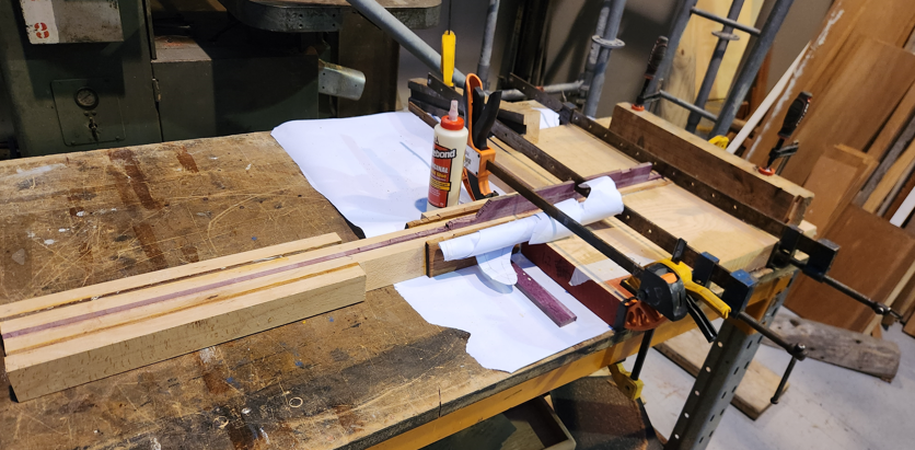

  15. There wasn't much left, but I've saved it with a mind to turn it into control knobs, perhaps laminated with metal.
  16. i certainly will, far too much risk to not have any way to adjust the neck, doubly so when that neck doesnt come off. though if anything goes horibly wrong i can still route out a neck pocket and convert it to a bolt on. if you have any other recommendations for quality truss robs im all ears, otherwise im sort of thinking about just making one in the same style as the stewmac ones. for all those unaware of what we are talking about here, in the neck of most guitars and basses exists a component call a truss rod. this component is an adjustable method of counteracting the forces from the strings (in the case of a bass, it can be a metric fuckton of tension) and this force arches the neck forwards. To a certain degree we want the neck to have an arch, otherwise when pressing down on a fret, the string would touch multiple points but if the strings pulled too much of an arch, it would be unplayable or it might even snap. the truss rod applies an adjustable force in the opposite direction by way of two rods, one fixed length and the other adjustable, causing the assembly to bow and allowing a balance to be achieved. there are a few different setups but they usually all follow this general idea.

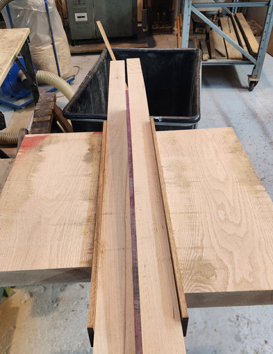

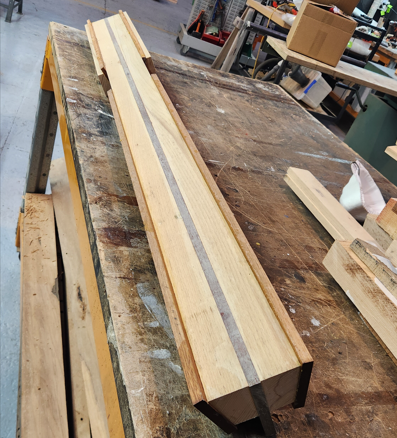

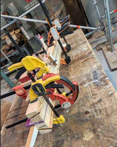

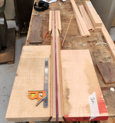

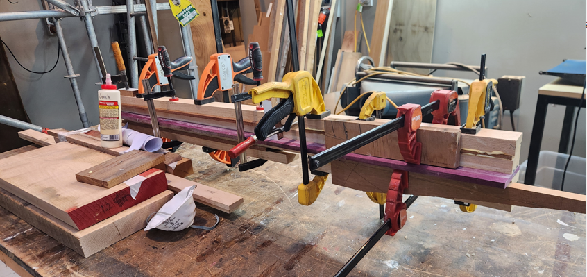

  19. I then loosely flattened off the bottom so i could clamp the wings down aswell as into the neck blank. one downside to the angles was that it was pretty anoying to glue up, as i had made nice slippery ramps, but nothing that clamping scrap timber across didnt sort. And clamped the Oak wings on and left it over the weekend. (there is alot of excess timber on those bits and ive left is there for now incase its beneficial for clamping it down later.)

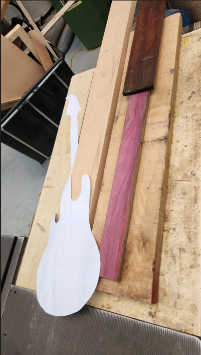

  21. When i was starting to think about this project i was looking around at various construction methods. The moment i laid eyes on through neck, decoratively laminated instruments i was blown away, they just looked so great. its not especially difficult but it is more labor intensive and probably hard to automate you dont tend to see many cheap instruments looking like this. So with a very loose plan in place i set out to acquire several different bits of timber. I ended up being given some Filipino Mahogany and some (not picture) Australian Iron Bark and purchased some African Purple Heart aswell as some American Red Oak for the wings and i ended up with some European Beech for the neck. I had wanted Maple for this but it was a special order thing. however because im laminating the neck and will also be reinforcing it with some twisted carbon twill, the Beech' properties are near enough and it looks great to boot. Next i had to figure out what i was going to do in terms of laminations, que several hours of blankly staring at a pile of timber and shuffling it around. I knew the two lengths of Beech were too wide (i hadnt commited to a layup yet) but i still wasnt too happy with the look. Then i had a thought, which kind of required commitment before being able to see it as i may not be able to square the timber back up.. i put, i think a 20 degree angled cut along one of the Beech Necks and the corrosponding Red Oak wings, putting the outboard decrotive Mahogony strips on an angle. Not something i had seen in any of the instruments i was looking at. I hope theres nothing inherently wrong with doing this because i really was happy with how it looked. Shown below with Beech on both sides. And with the Red Oak And again, with the headstock blank, which uses the offcut Beech vs the Oak. Happy, I set to glueing everything up. Clamping it to hell and back to ensure a solid joint. I used Titebond Original for this as the internet said it was good. Ive run out of image space, so will continue next post
