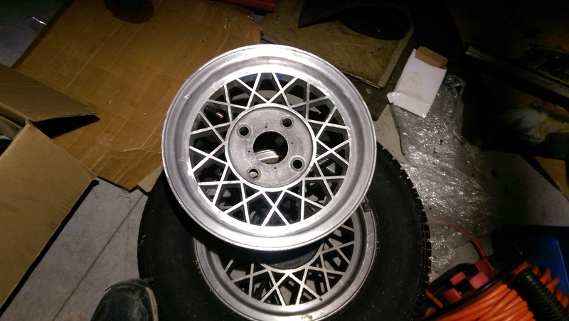

Makin' a patch panel from a firewall I got sent. I dunno how much of it I will end up using. The pile of bits I spot weld drilled off. The hotwire I got from @pusherman after paint stripper and water blaster and 400 grit. The original coating and lacquer are removed, but there is still a bit of the blue paint that was all over it. WTF was that paint, it's nearly indestructible?? Still need to scrub a bit between the spokes to get rid of any loose stuff then mask it off and repaint the black bits.

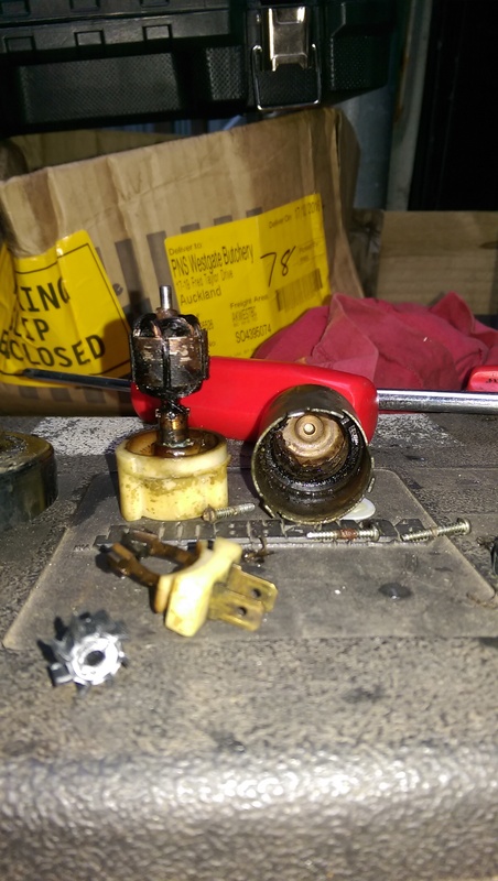

Washer jet wasn't working. How did it get a wof...? There was power at the motor without pressing the button on the stalk to make it go. Took the button apart and a plastic pin that holds a brass cone in place was missing causing it to be always on. Dang! But then I found it under the carpet!!! Button works as it is supposed to now. I took the motor apart and it was well burnt out from being on for ages. I'll find a suitable replacement at pickapart

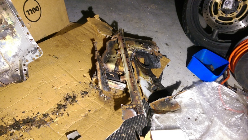

I found an old icecream wrapper in one of the backseat ash trays. I think it's 80s or 90s. I ripped and hacked the foam rubber mat off the firewall because I knew there was run under there. It all looks fairly simple to repair with the engine out(and the mat/stuff under the dash). Anyone got a good firewall they can cut out and send me to make patches with?
