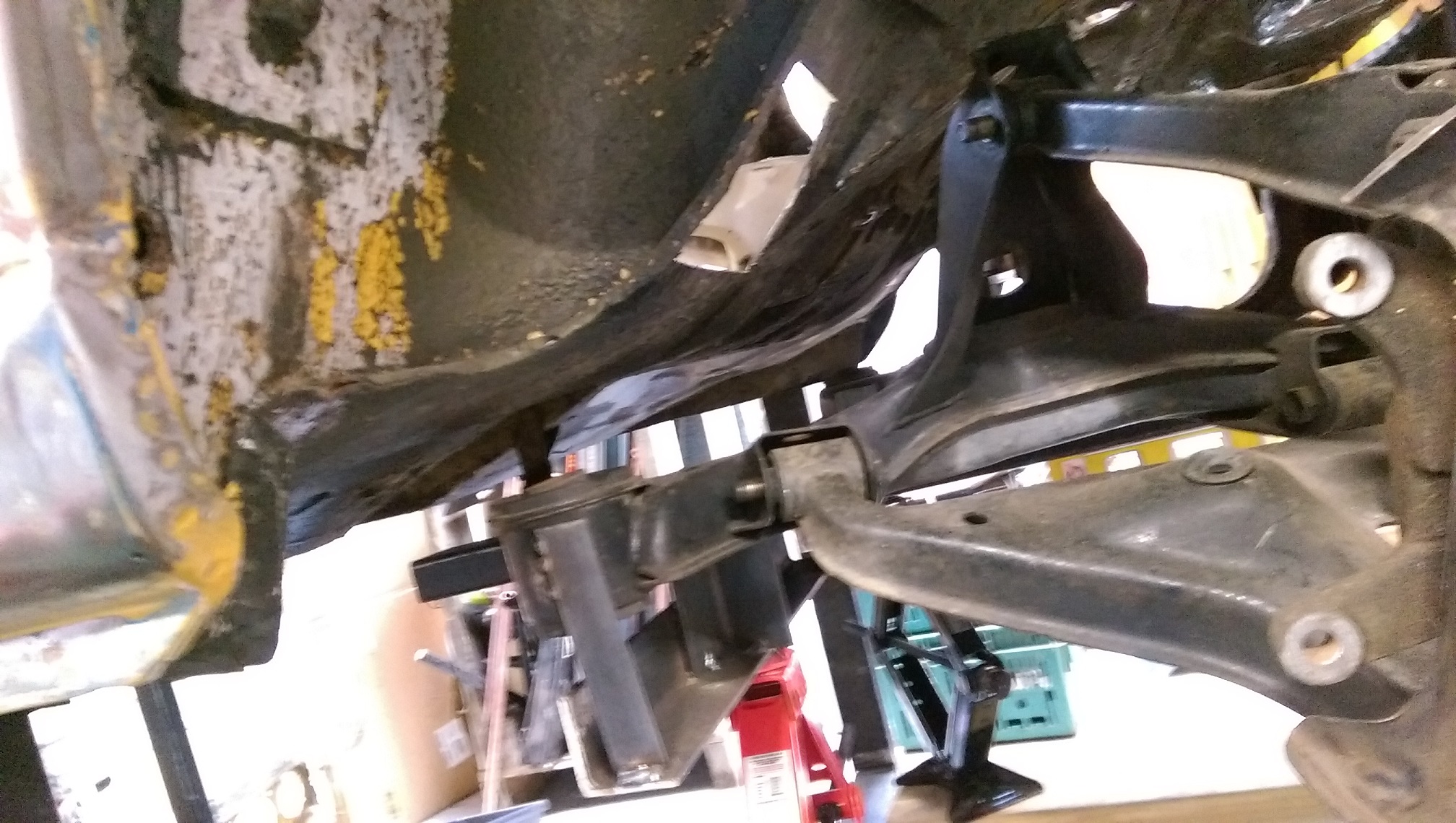

Snip snip snip. Moved the subframe back so the wheel hub is in the factory location. Still need to work out if the subframe is high enough. There is a clearance issue for the top rear arm which means there is only about 20mm of upwards travel from what seems like a good lower than std ride height. Making more clearance does not look too hard. I was thinking that the front mounts hang a bit low, so thought the subframe might need to be higher. But then I measured the std front mounts on the white triumph and they hang down just as far but are more outboard.... Still not decided yet. There is room at the front and above the top/front arms to raise it about 40mm without cutting. You can see the temporary bit of angle to show where the diff mount cross member needs to go. Lots of room for it. Even if the subframe is raised further.
So I welded a temporary bit of metal for the front diff mount cross member, so I can trial fit and see how much space there is available for the cross member. I put some bits of wood on a wheeled dolly and 3 scissor jacks for raising and leveling the subframe under the car. As it is now, the subframe is wedged in there, and level, and I think the height is okay so I don't get crazy camber when the car is at ride height. But, it needs to move 90mm further back, which will give me lots of room at the front, I won't need the two holes I have already cut. But I will need to extend that existing box section further into the boot space. Fortunately, there doesn't appear to be anything stopping me from doing this. I may still even be able to fit the spare wheel! See I have marked where the wheel hub is on top of the arch, and where it needs to be. This isn't full suspension droop, one of the braces on my jig is in the way of a suspension arm moving any further. Aaaaaand with the subframe 90mm further back, the shock mount on the back of the hub is directly below the shock mount on the body. Hopefully I can find/make some coilovers that will fit in the available space. I'd like to avoid making the existing shock 'towers' larger because then I would have to also modify the fuel tank as it is a tight fit between the shock towers. The rear subframe mounts are hard up against the existing box section. I have already removed the original mounts/studs from the box section to get the subframe up this high. Once it moves 90mm further back, there will be plenty of clearance for that front/top arm mounts so the hole is not required. Not visible in the photo, but there will also be ample room for the diff mount cross member. Not sure how to make the mounting point for the front mount. Ideas so far are: strengthen the floor with plates and build a mount point down from the floor. Or make another box section/outrigger to support the subframe mounting point. Here's another picture of that existing box section. The red line is where the bottom of the existing box section is under the car. The blue box is where the 'new' rear part of the boot floor would be so the subframe can move 90mm further back. I need to think about how to best make 'whatever' that the subframe rear mounts will attach to.

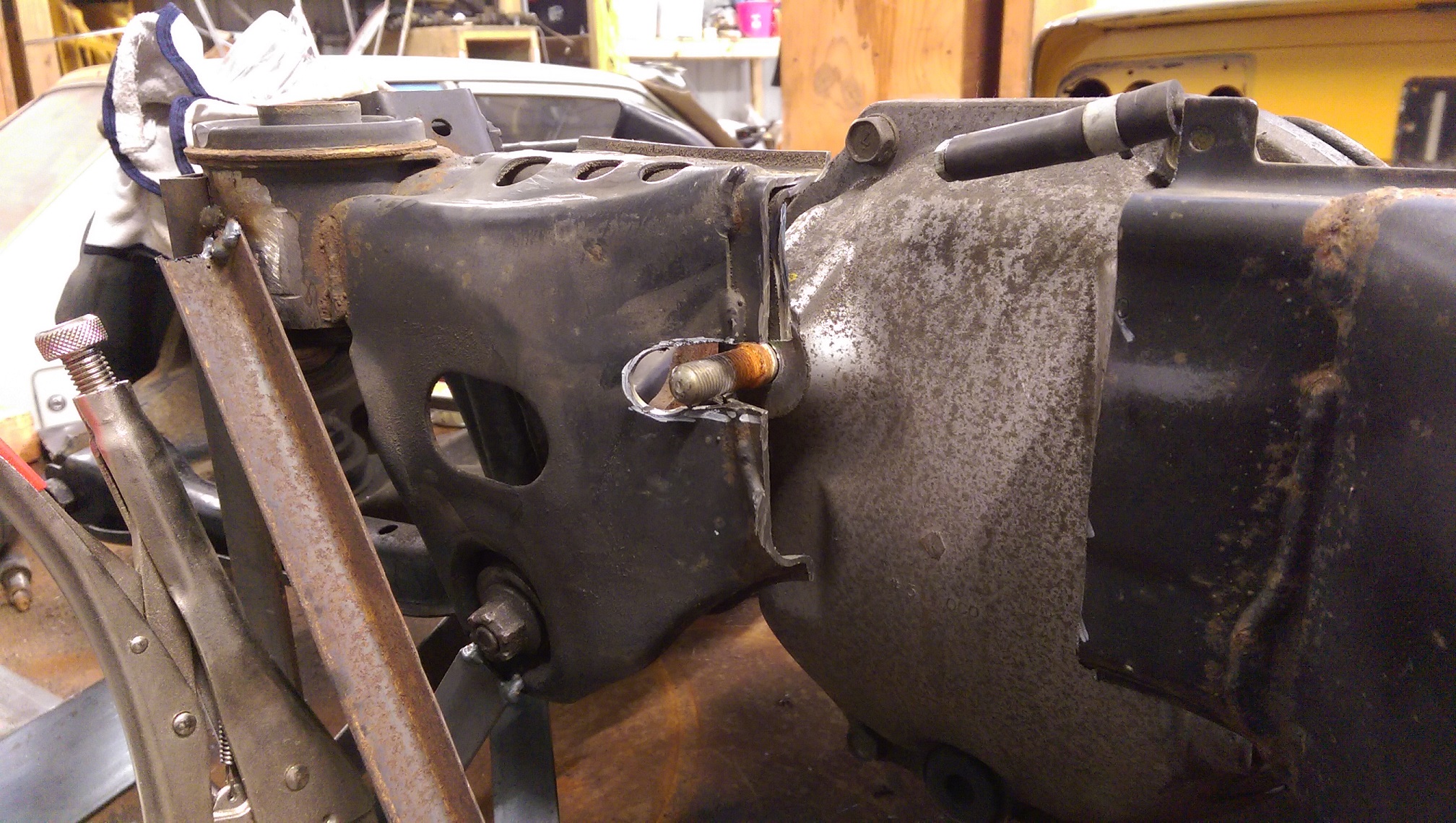

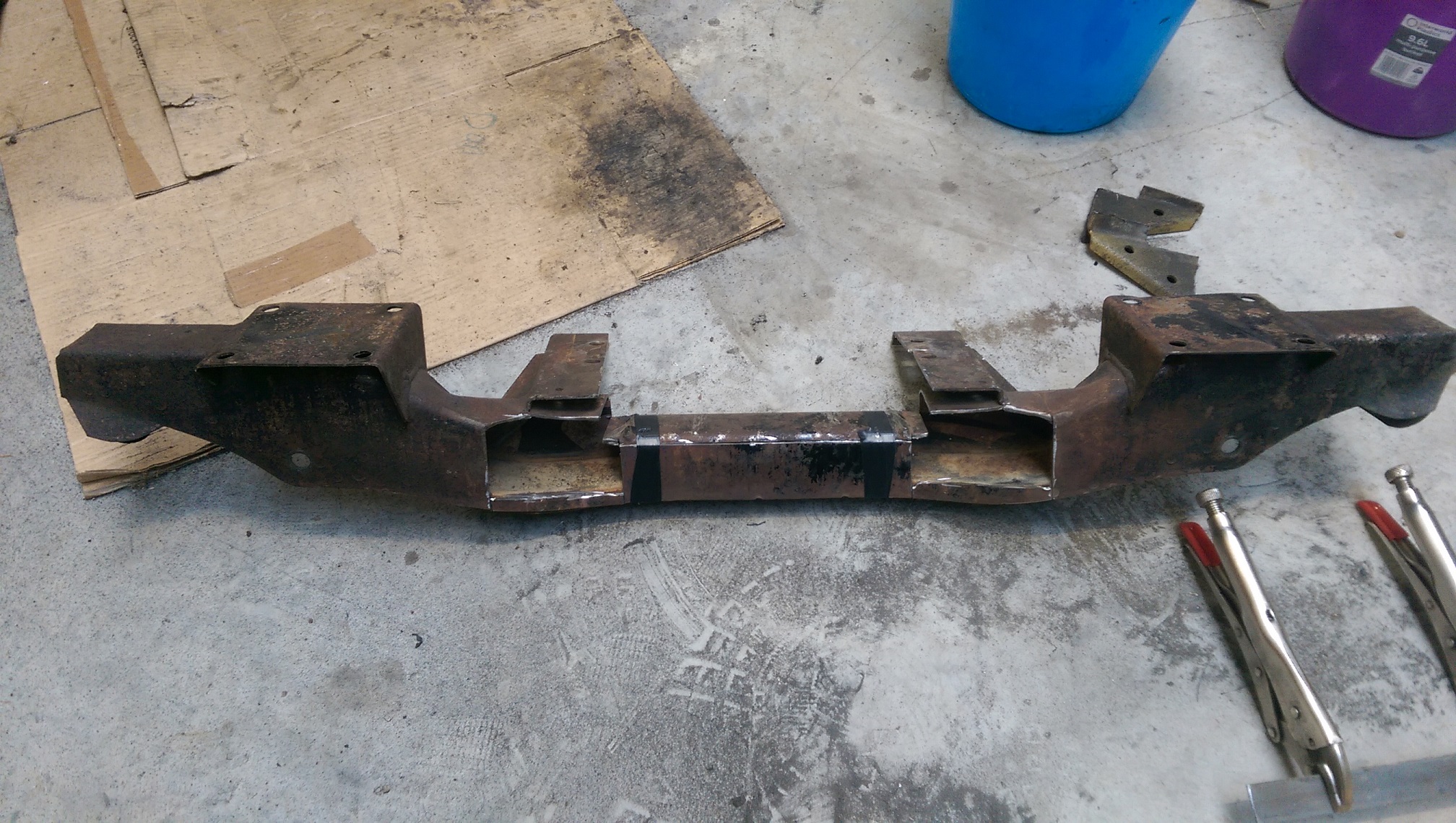

The engine is now as far back and as high as is practical, so... Hack hack hack. Don't worry, I have another. Now the cross member bolts on again and clears the sump. But the steering rack needs to be, much, lower to fit.
