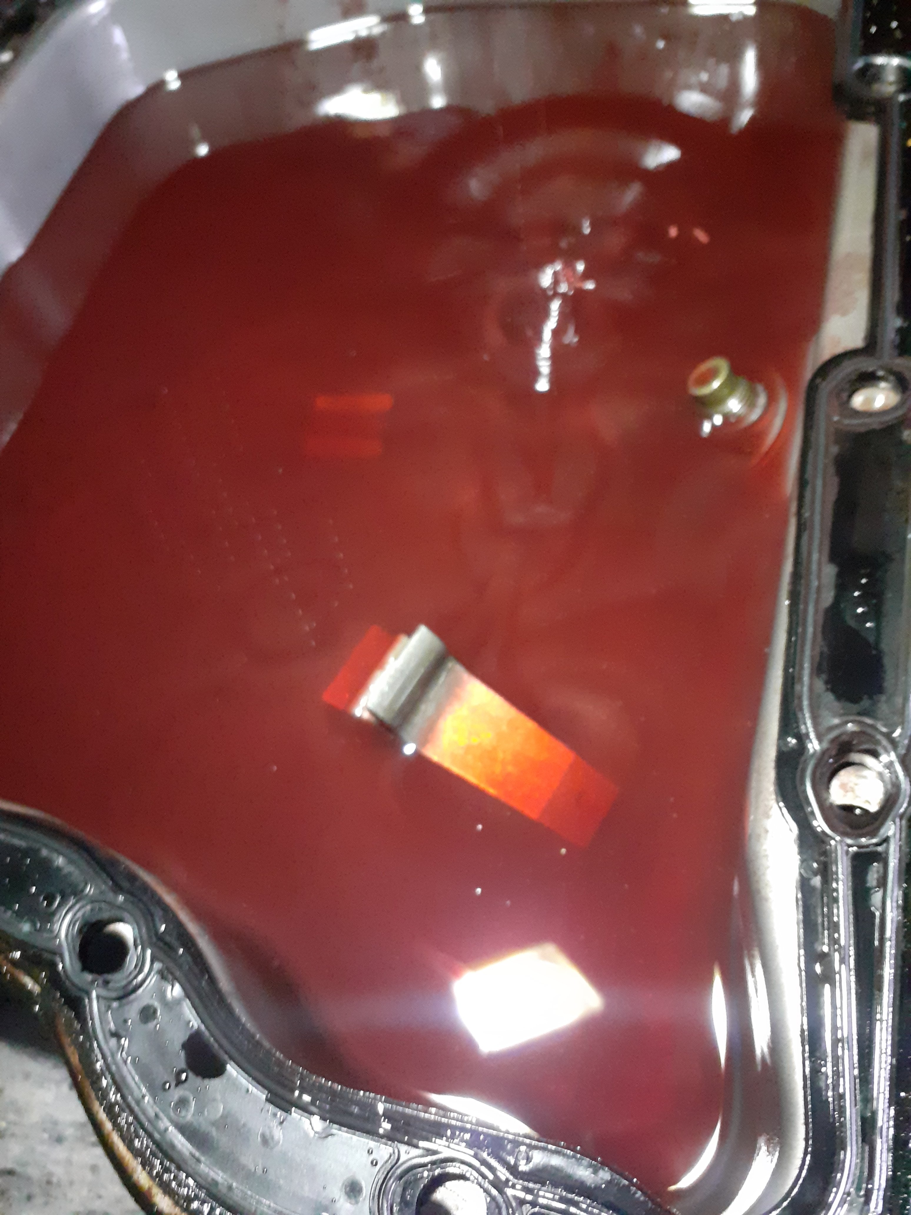

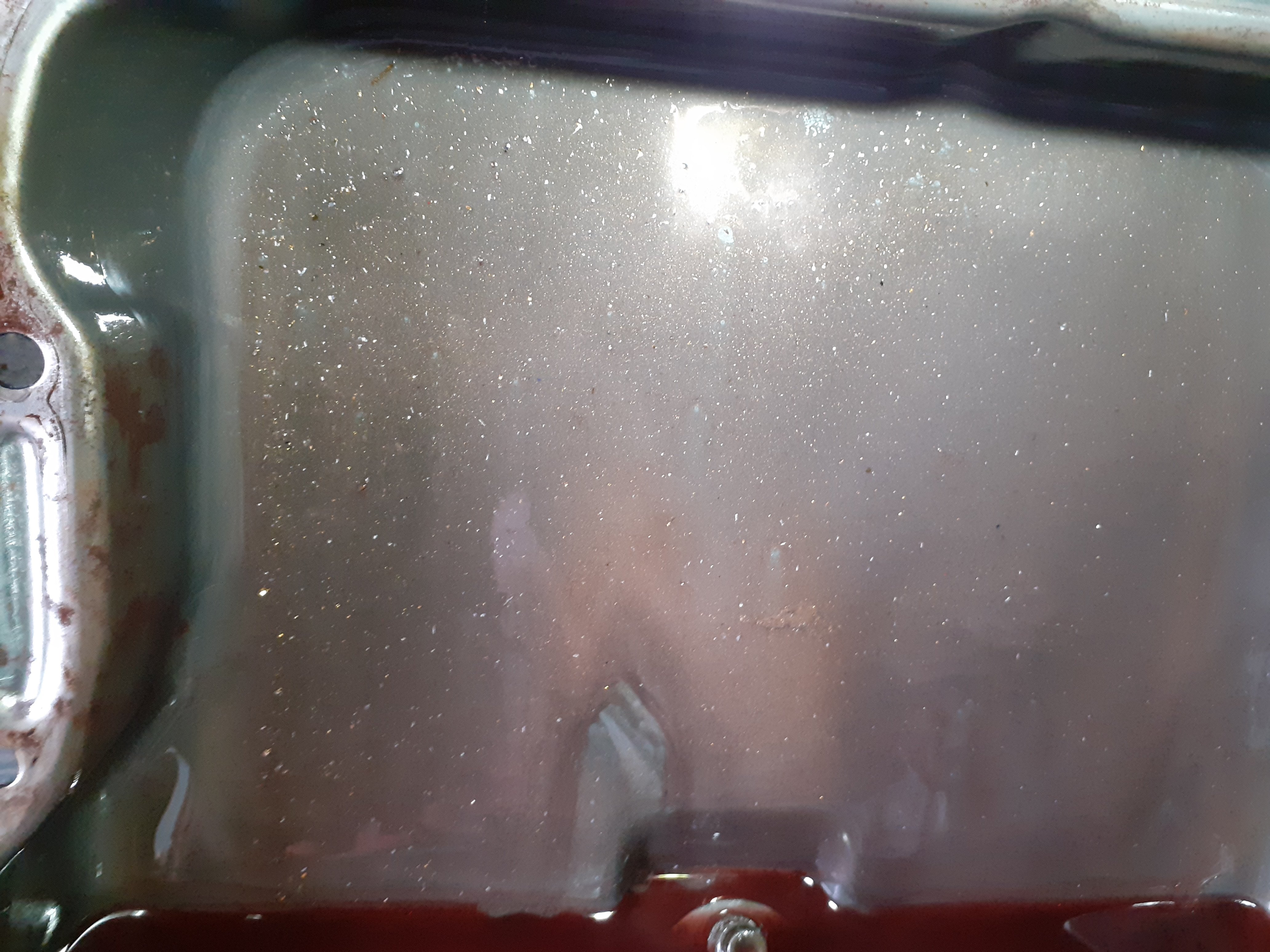

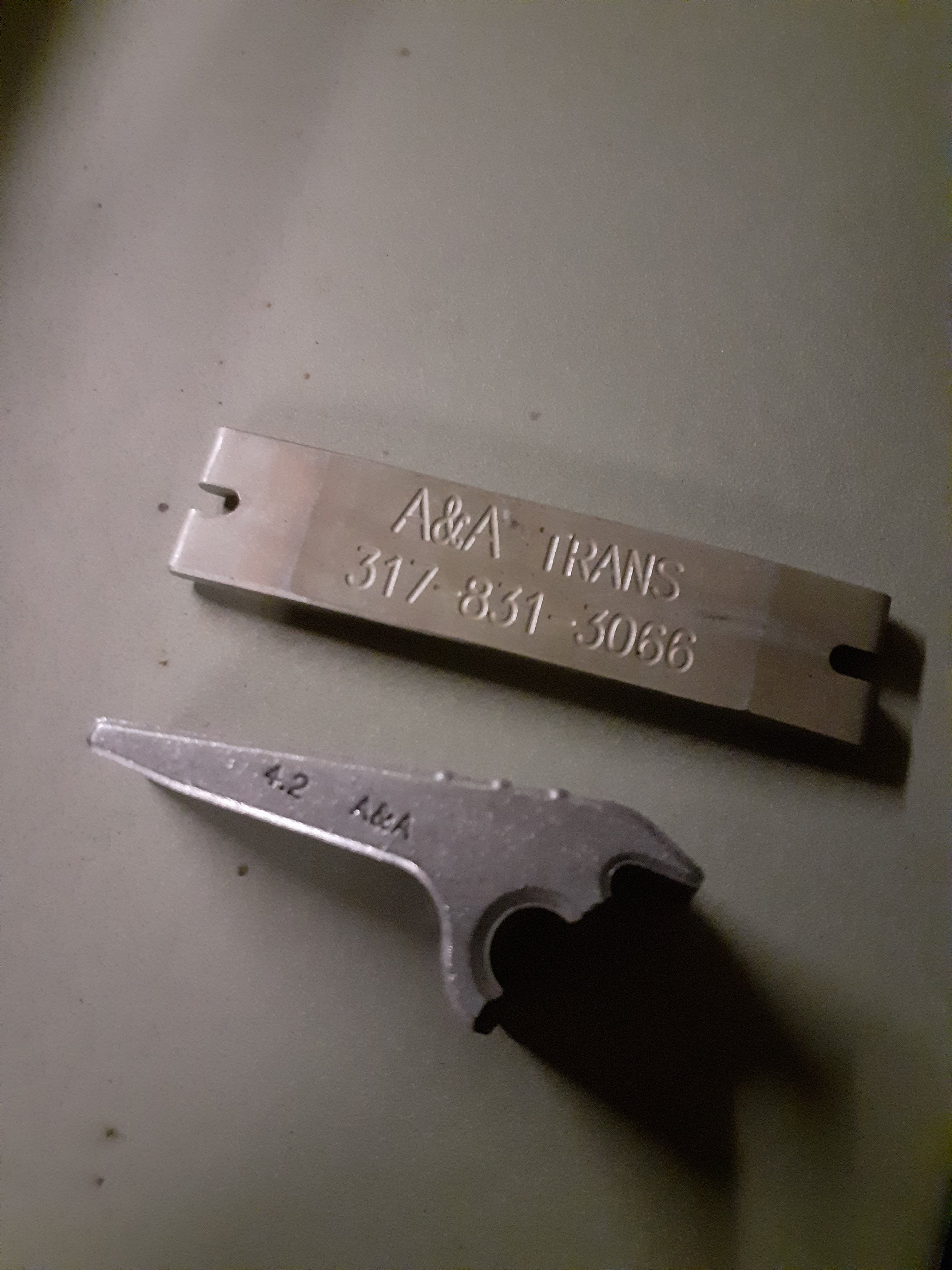

Went to chrome at Hampton downs for the weekend, gave it all the beans, took heaps of randoms for a ride , did a lot of skids, used quite a lot of fuel It was good fun and I was pleased with how it handled a beating , until it decided to do a power glide conversion on itself and delete second gear. Came out of a corner and floored it, and it went nowhere Still had first and third gear and wasn't making any puddles or noises so drove home , pulled the pan off and it's broken the second gear band apply lever, which is an upgraded aftermarket one I think I can replace it without pulling the box out There's a bit of sparkly stuff in the pan and on the filter but I dunno if it's anything to worry about, I changed the fluid a year ago but this is the first time i have taken the pan off since it was built I'll have a chat with the guy that built it and see what the best plan is

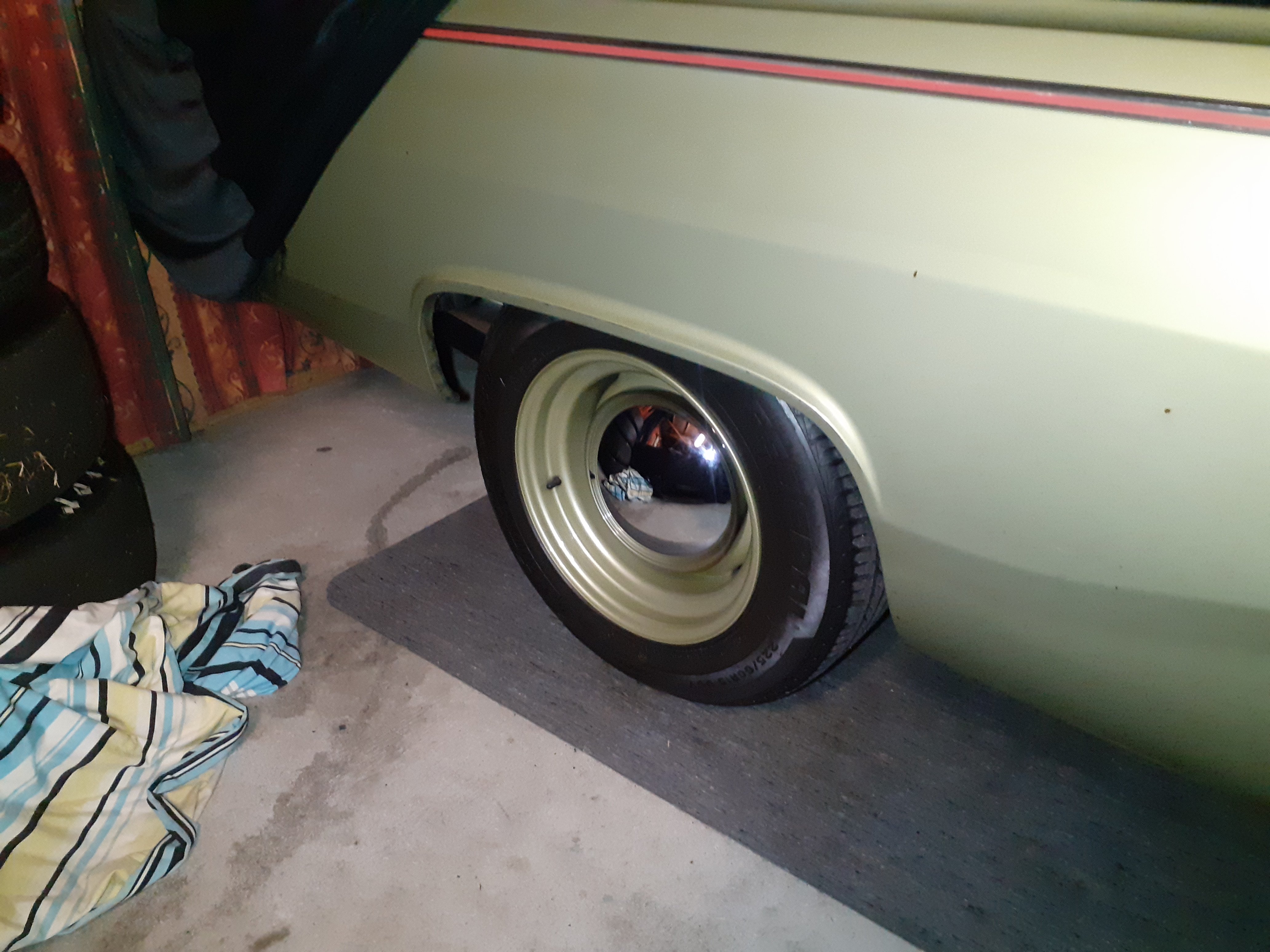

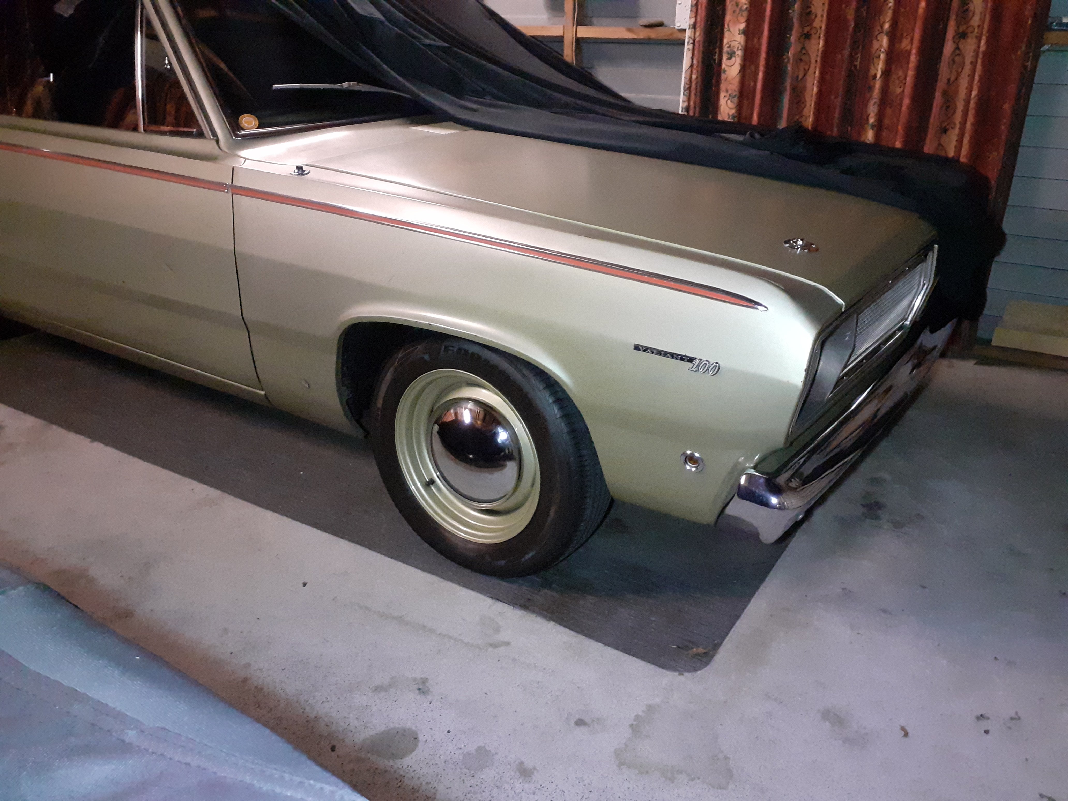

I wanted some dog dish type hub caps, did some research, it's quite difficult to find a 10-1/8 cap that has the right shape, the wheels are a reproduction of 60s chev or Ford wheels so the caps you can get have ford or chev emblems on them. Mopar caps are smaller and don't fit this style of wheel I took a punt on some chrome dome type caps but I don't think I like it, there's too much of a dome shape to them, reminds me of a vw wheel

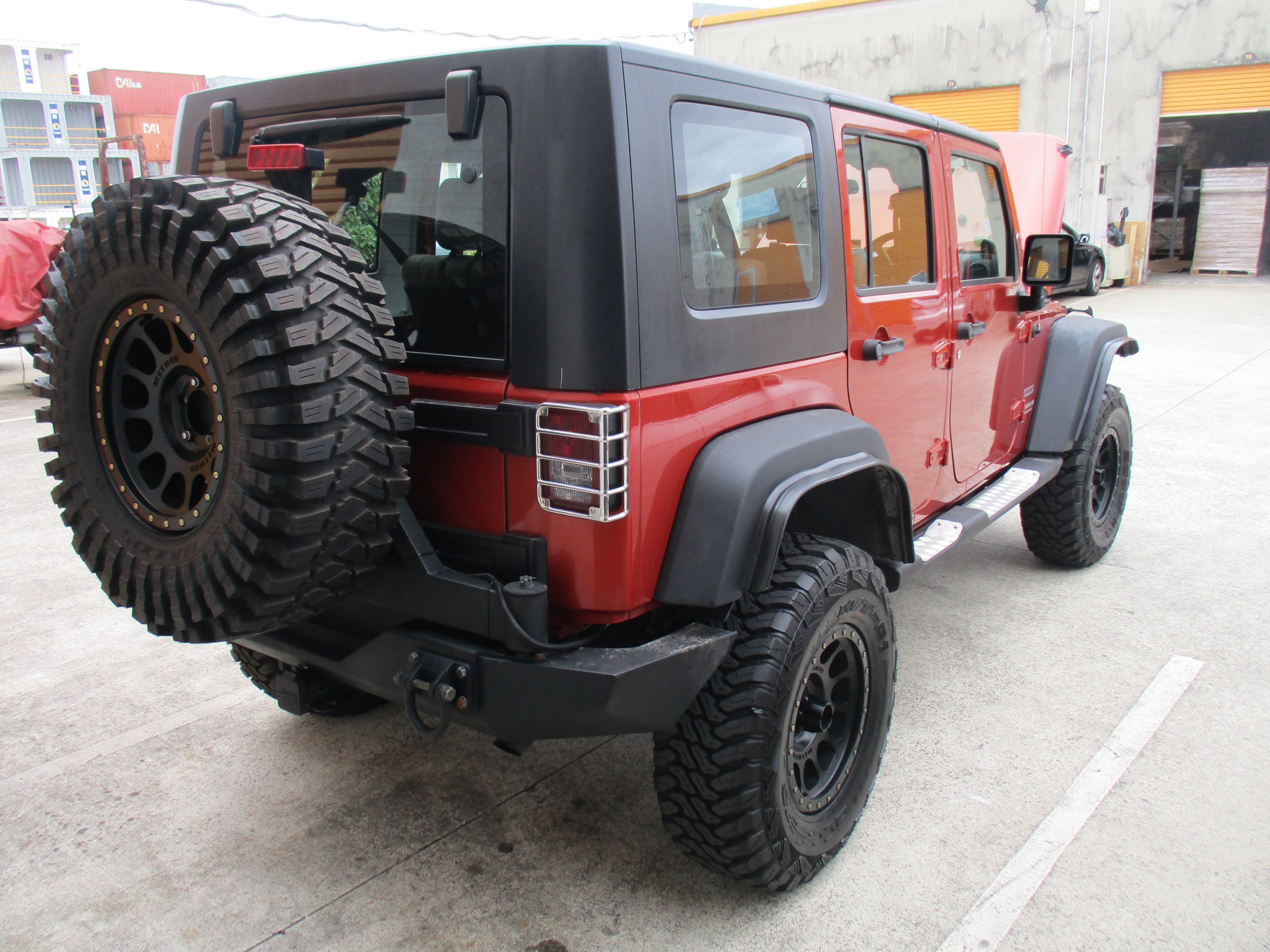

ha wof guy was actually right it was a car i certed, it had 37s on it but wouldnt pass the brake test so it had 35s fitted for final check, i still had photos of it
