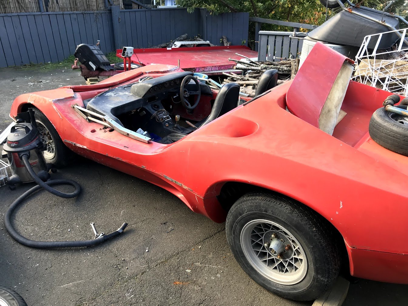

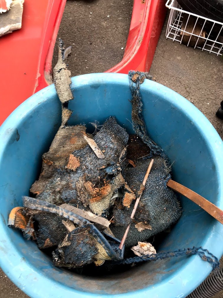

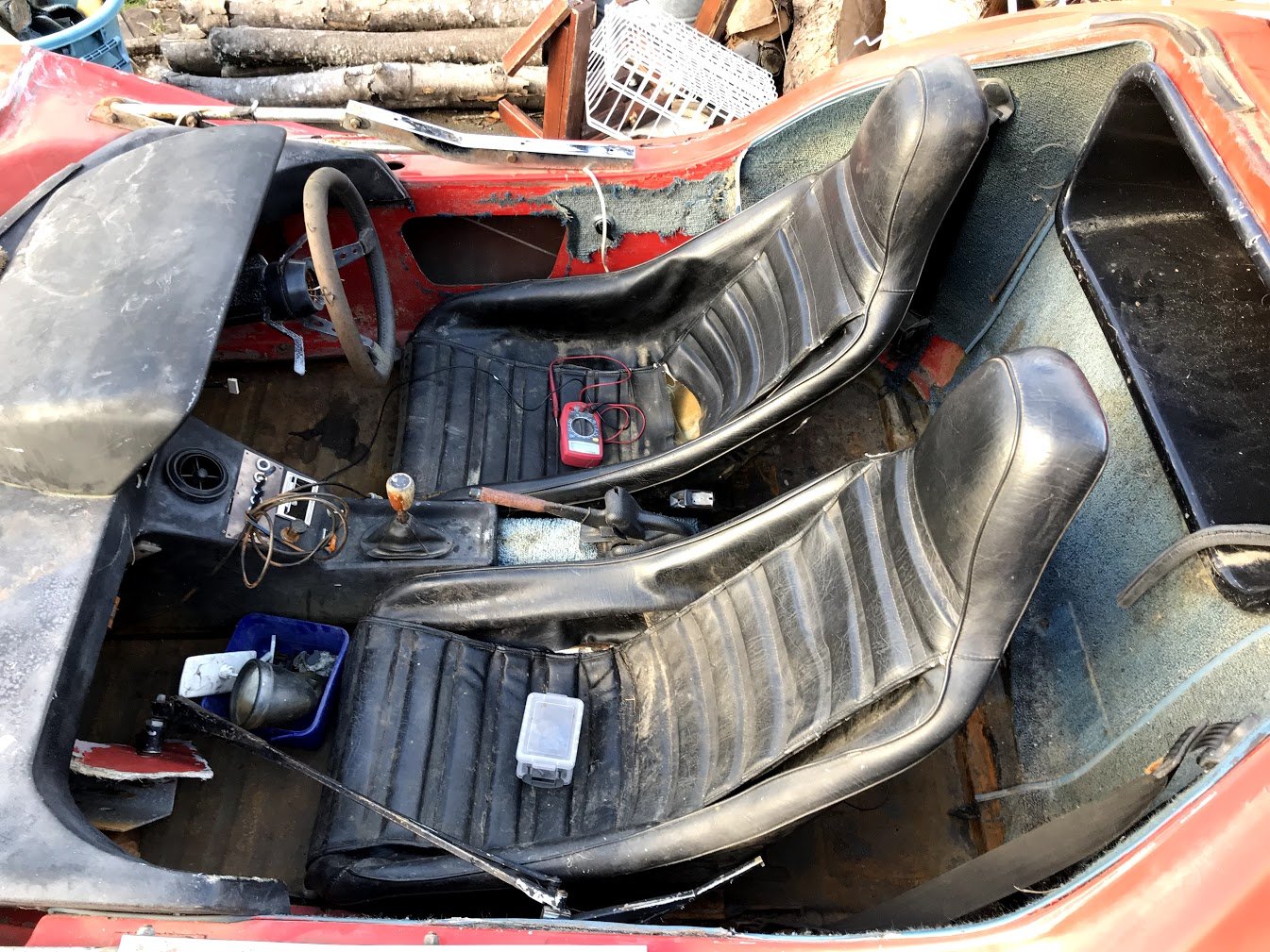

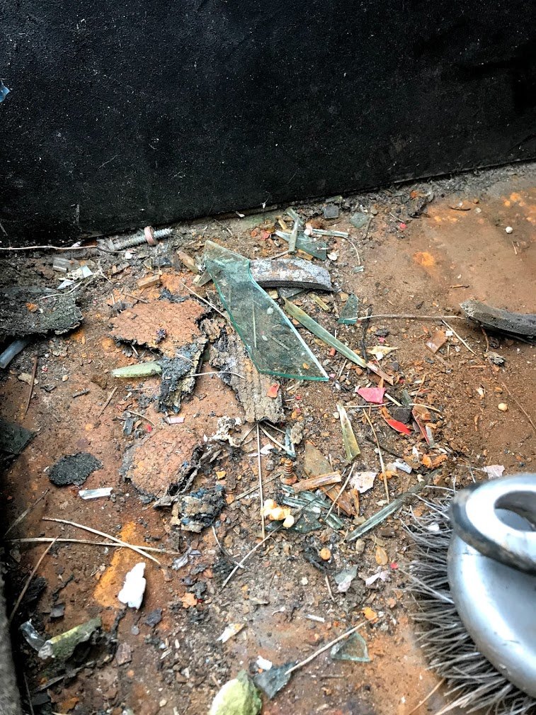

  6. Got the roof off, you can see how damaged it is. I reckon it must have hit something while open or possibly someone tried to pry it open from the front? I have almost all of the bits to fix it but I am also hoping to get a whole 'new' roof. Started cleaning out the crap from the floor, lots of broken glass. Not safety glass either, its in fckn everything, even the air vents and gearshift holes: It's all dry inside now, so pulled out the fcked carpet (classy 70's blue loop carpet): Found a key! (and some rust in the floor): Tried the key in the ign key hole but it snapped in there...cool. Coolcoolcool. That's annoying but it refused to turn with the other key as well which was also rusty. So no real loss, I was thinking I'd need to replace the barrel anyway. Also found this magazine behind the drivers seat under the carpet, lol: The steering wheel is weirdly bent: Cut the ign key wires because I wanted to see what would happen with power. Not much, although I can get a click from a relay in the back which must be the starter motor. There is a crude fuse box which is a bit stuffed so might explain why I don't get much happening. So out of interest I put some fuel in the carb, plugged in the coil that was inside the car and connected it to battery positive. Tried to crank over with the jumper leads straight on the starter but nothing happened. Think that spare battery is stuffed. Took the battery out of the 200sx and tried with that. OK so engine is cranking over again, but pretty sluggish and no sign of it wanting to start.... that was kind of optimistic. Ran out of time to do anything more so haven't checked to see if there is any spark. Have chucked the battery on charge and will see if it cranks over any better tomorrow. Maybe the starter is just tired or the bores are rusty, who knows

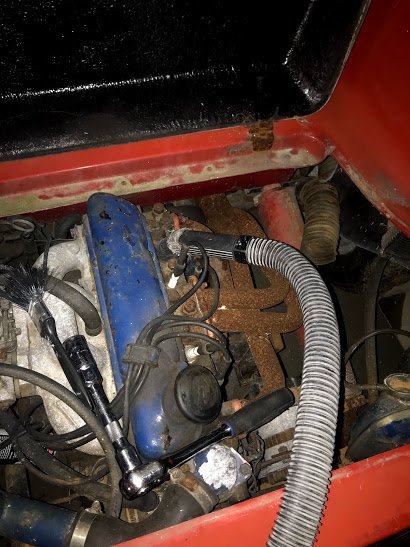

  22. Nope, I've just sent a join request since its a closed group. Thanks for the heads up.

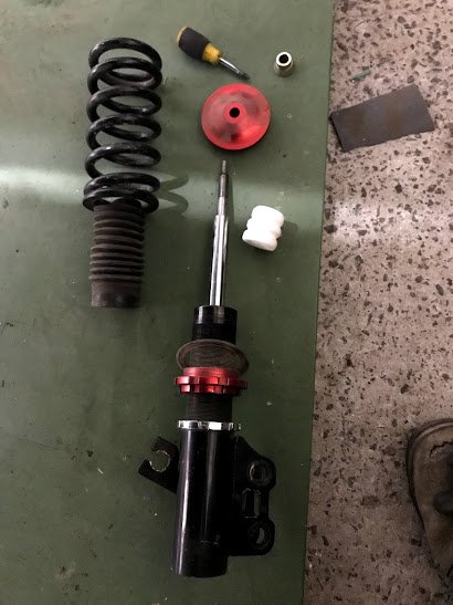

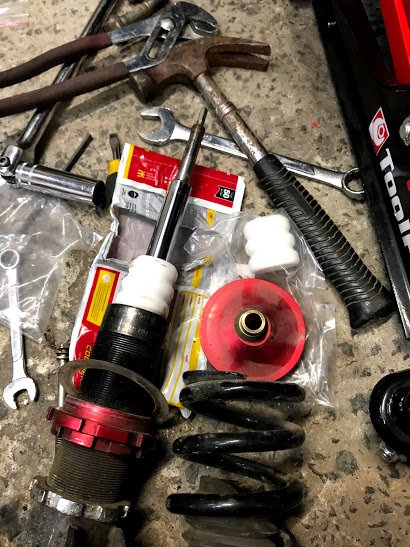

  23. Did bump stop installs on these jobby's: Also found that the brake caliper adaptor bolts are JUST too short once I add a spring washer, these are the supplied ones with the kit without springwashers. So I got some 10mm longer ones from Coastal Fasteners and shortened them to clear the rotors. One step closer to being back on the road, it's been off the road for 12 years.
