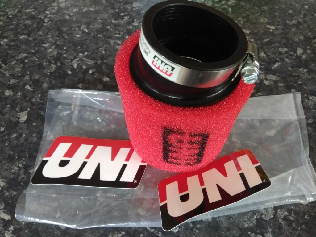

Need to get a filter ASAP! Thinking Uni pod, thinking 92 or 94 should be about right jet wise (add the 30 powerjet to that figure and it isn't as small as it sounds) The variator still has a LOT of travel left, heavier rollers will help that, should see 90k out of it at a guess (heavier centre spring means it needs heavier rollers than before when I was needing 4g rollers) Exhaust hits the ground on big wheelies, might need a wheelie bar hahahaha -
