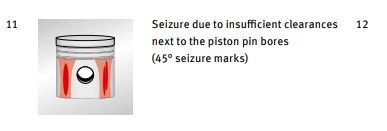

  3. anyways, i ran the piston over a stone, dingleballed the cylinderactually measured the cylinder and piston by digging out my dusty bore gaugesand its now slighlty over the minimum clearance, so its self clearanced nicely (gn125 clearance being 0.03-0.051 to 0.12 max dr200 being 0.04-0.05 to 0.12 max) i measure 0.055 going to chuck it back in and go do some 11000rpm shifts

  19. hmm i might just run a flat stone over the rough spots and pop it back in then, ran pretty happily after it nipped up
  20. whad did you do to machine the piston @cletus? did you measure the bore clearances to find the tight spots or just eyeball it? il probably take one of my cylinders and a 160cc piston to a machine shop and tell them to make it fit and not bother with another 150
