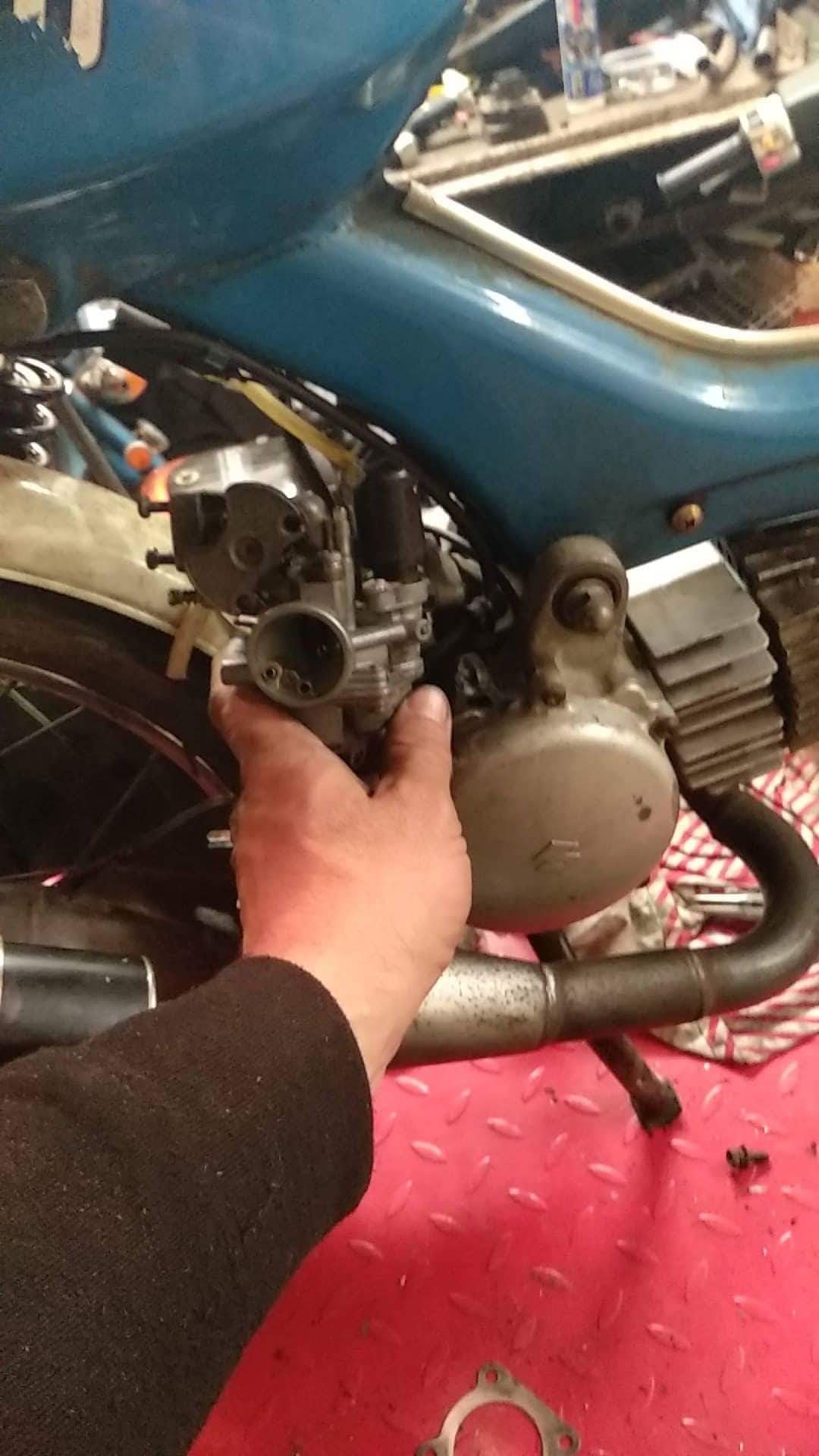

Yay, parts day! Unfortunately there's a bit of work needed to make everything work. I gambled on the Polini cylinder for the Chappy being correct because of some info that I'd found on the internet, but it turns out the Polini kit has HUGE transfer ports that are far too big for my crank case. This leaves gaping holes around the edges of some of the ports... So I'm stuck trying to find a solution. You can see the difference between Polini and standard ports here: My first option is to use JB weld / some type of compound to goo up the ports on the cylinder. I'd also add goo to the mating face on the crank case to get a good sealing surface. Then I can port match the cylinder from there. Option two.... Um.... A metal gasket or something? Not sure. I also need to modify the inlet to get the reed cage to fit. It needs a couple of MM taken off to fit nicely. I'll also need to modify the chappy inlet manifold to suit. I could either add a wedge underneath to get this angle or add to the manifold with an elbow / new tube. Once I realised nothing was going to work today, I set about trying to make it go as a 50cc again. It was a pretty mad mission and I was trying to finish it in time for the oldschool meet tonight, but it wasn't to be. I got it going afterwards though! Here's my temporary headlight until I sort the wiring out: Took it for a hoon. It's going much better than the last test, but still not well. It splutters a lot, although I did double up on oils (premixing incase the oil pump didn't work) and the carb enclosure was open, so it was likely running lean, causing the splutter. I just had to ride it to make sure the next lot of effort will be worth it! And it seems like it will be... The thing is quite peppy when it decides to pull through the revs.
