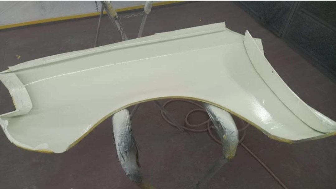

Panelbeater has finished the boot, and body opening, so the painter is underway now, all reprimed, and he's done a small repair on front crossbar, all nice and straight now -

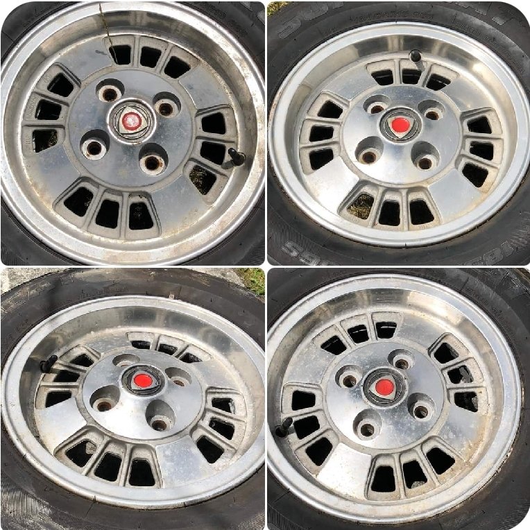

No more progress on the shell atm, been held up as after test fitting the boot lid again, found it wasn't fitting right to the body, awaiting panel beater to redo it, can't progress until then. Picked up these rare optioned rx3/4 factory jdm mazda alloys recently. Not sure if I'll use them, but I've only ever seen a few sets, so had to jump on them, might rotate them with the other 3 sets of wheels I also have for the car.- 119 replies

mean progress, is the car going black?
Nice ride, love the availability of parts on these. ill be the first to say it - looks ripe for a barra swap
yes its off white almost creamy, code WN Aurora white, was used on rx2 through to series 1 rx7. mine is off a colour match though, so might not be 100% as per factory
