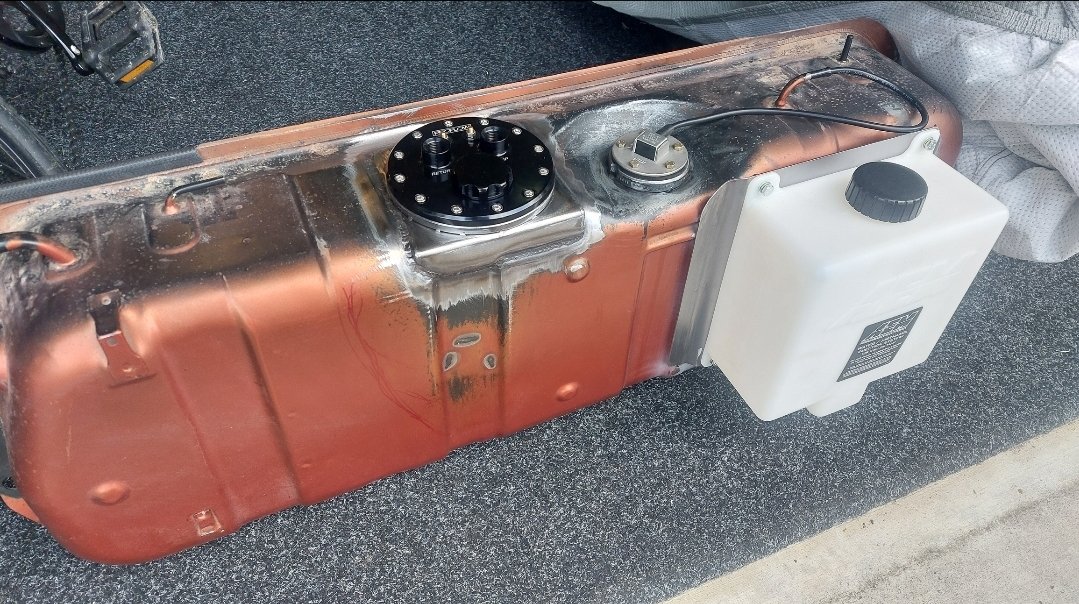

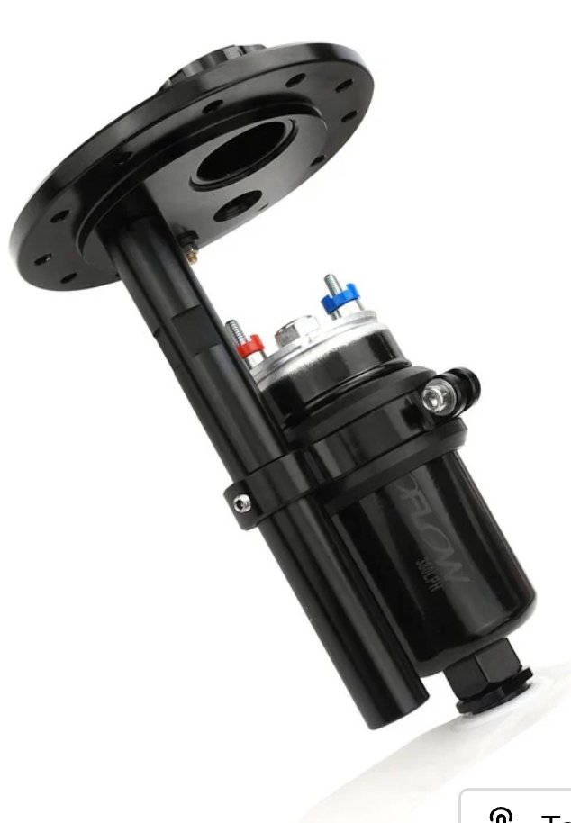

Have altered a few plans, diff is on hold, I decided It's not important right now, and can wait till after car is legal and I've put a few kms on it. But I have an open 5.1 for it and will buy another LSD centre later on to swap out. The current 4.3 LSD has been refitted. Have modified all the brake lines so there is proper clearance without fouling now. Just got fuel tank back from Choppers autobody. I asked him to fit a proflow efi pump hanger, and mount the water meth....ahem "water" tank to the back of the fuel tank, and modify a new compact marine fuel sender to allow clearance for the custom internal surge tank. All still to be painted up etc, but surely now that will satisfy the certifier?! Side note, super stoked how internally clean the 50 year old fuel tank is!- 119 replies
