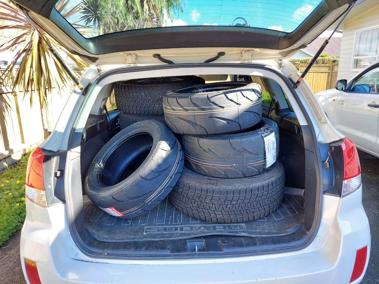

Looks like pretty much nothing is available. The only semi-slick you can get in BOTH 225/45r15 and 205/50r15 are the Nankang AR-1s.
So I guess that's what I'm buying.
