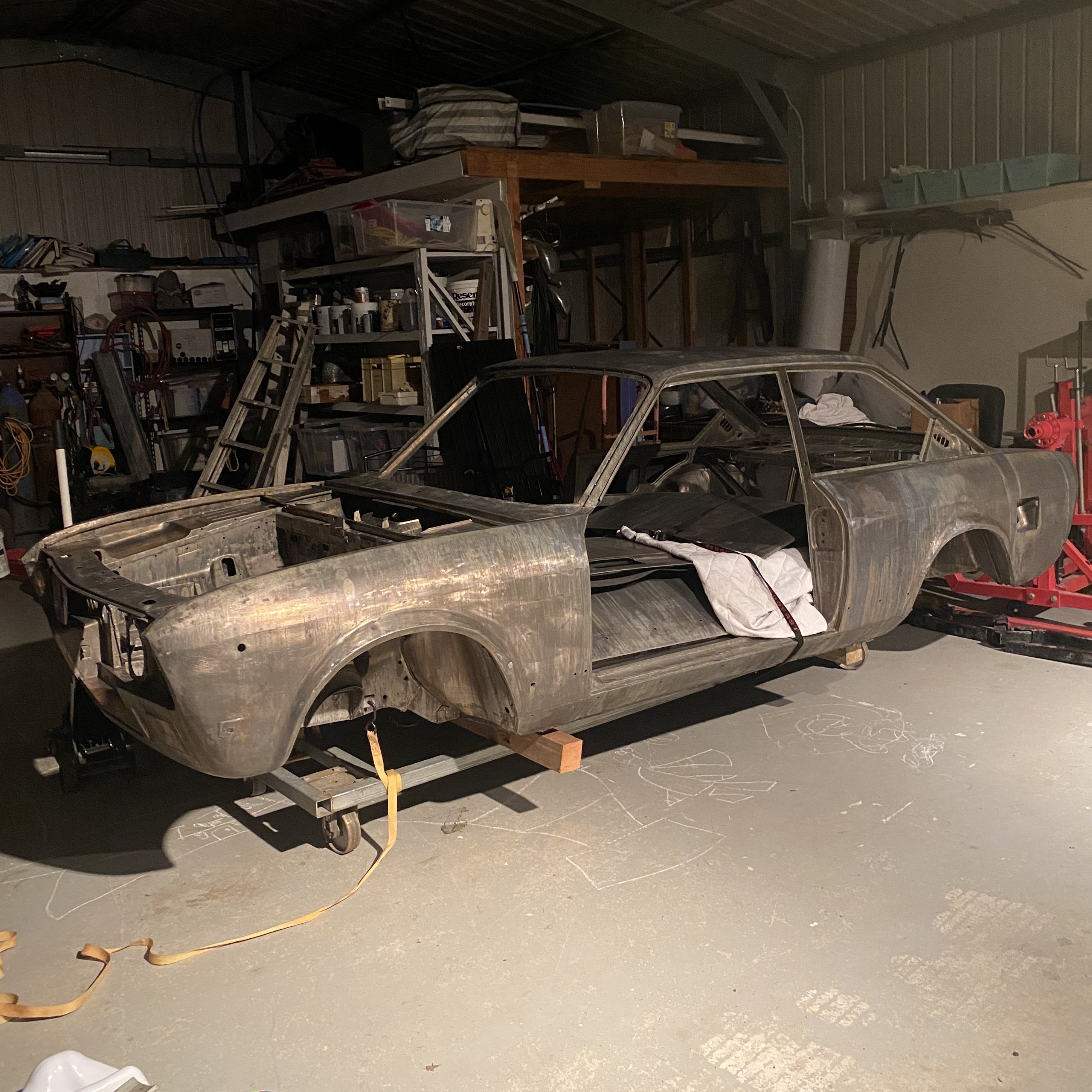

  2. Then shipped off to have the paint removed...
  3. But I mean really stripped to a shell...
  4. Sheesh, a lot of time has passed, and not that much has happened. Stripped to a shell...
  5. I have my car stripped down to a shell, and am considering chemical dipping to strip the paint and other matter. I have had a place in Rotorua recommended, but that would be a long haul from Auckland with a car trailer. Does anybody know of other shops around the north island that provide this kind of service?
