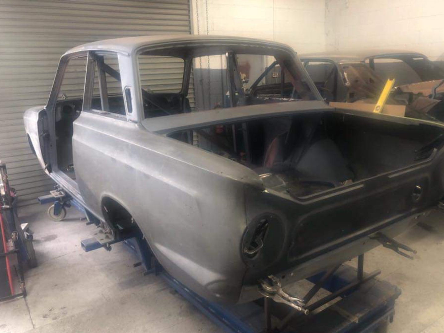

  2. Back from the blasters. A couple of minor things to do and it’s off for paint.
  3. Off for the final blast, then refit the bonnet, doors and boot lid and then off to paint woohoo

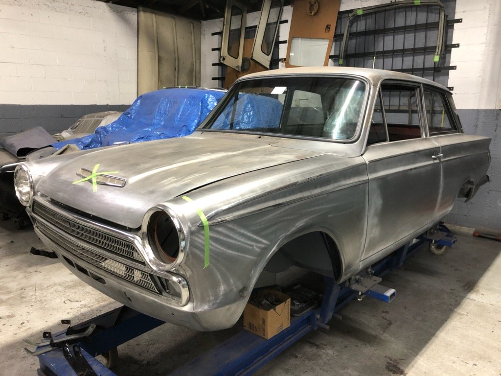

  10. Drivers door complete and only the boot lid to go and body work finished. Still trial fitting parts etc and once done it is off for the final blast and prime then off to paint.
  11. More progress with gapping the doors bonnet and boot. All welded back together again. Trial fitting allthe exterior body parts to check all good and also fitting the front and rear screens and rear quarter windows to check new rubbers all work.

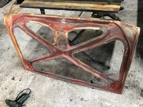

  12. Doors taken apart with skins removed and hinge plates. Frames off to the dippers.
