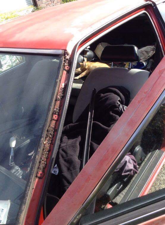

Picked up a media blaster to sort the windscreen sill out. want to give it a layer of boat cloth and westsystem epoxi then paint. bits of trim were also hiding forren objects. glad all the chassis works nearly finished, just need panel and paint -

Started assessing the last of the rust repairs. Drivers sides been lecking into the floor for a little while. See if I can borrow a media blaster attachment for my compressor think I'll pull the gaurds off and hit it with the black epoxi sealer. Maybe some boat cloth glass threw the windshield sill Heading overseas for works meaning I'm short on car time more and more. And as much as I love the rustic look, the paint jobs no longer sealed so a full respray is more and more imminent -
