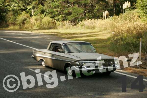

  15. The car is sitting on Kings 'low' Holden HQ springs in this photo. The front X member is 80mm off the ground. I cut 40mm roughly off the rear bump stops (still enough meat on them to pass WOFs) so the car was about 10mm or so off the rear bump stops with no one in the car. The result was badass, sore backs and girls suggesting they needed to wear sports bras when riding in the '61 I kept the car like this for about 2 months, then put Kings 'standard height' Holden HQ springs in the rear only. This raised the car in the rear about an inch at the most which was enough to roll around with less bump stop action. The car is now about 40-50mm off the front x member with the air ride in it.

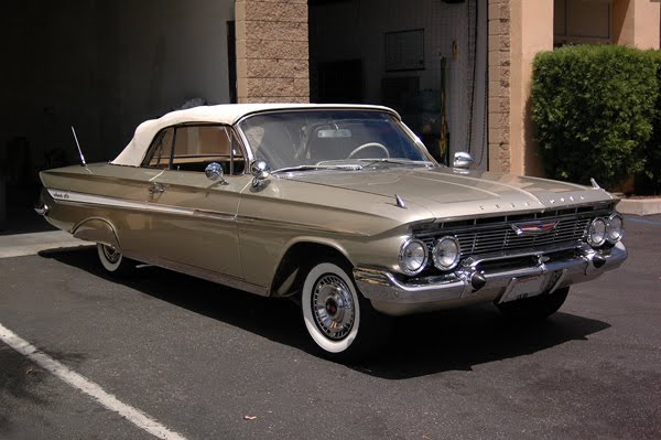

  17. These are a few cars which are inspiring the look I'm after. I don't know if I will ever paint my car, I quite like the patina look. If I did I would take it back to the original colour which is the same as the bottom 4 door hardtop on wire wheels
