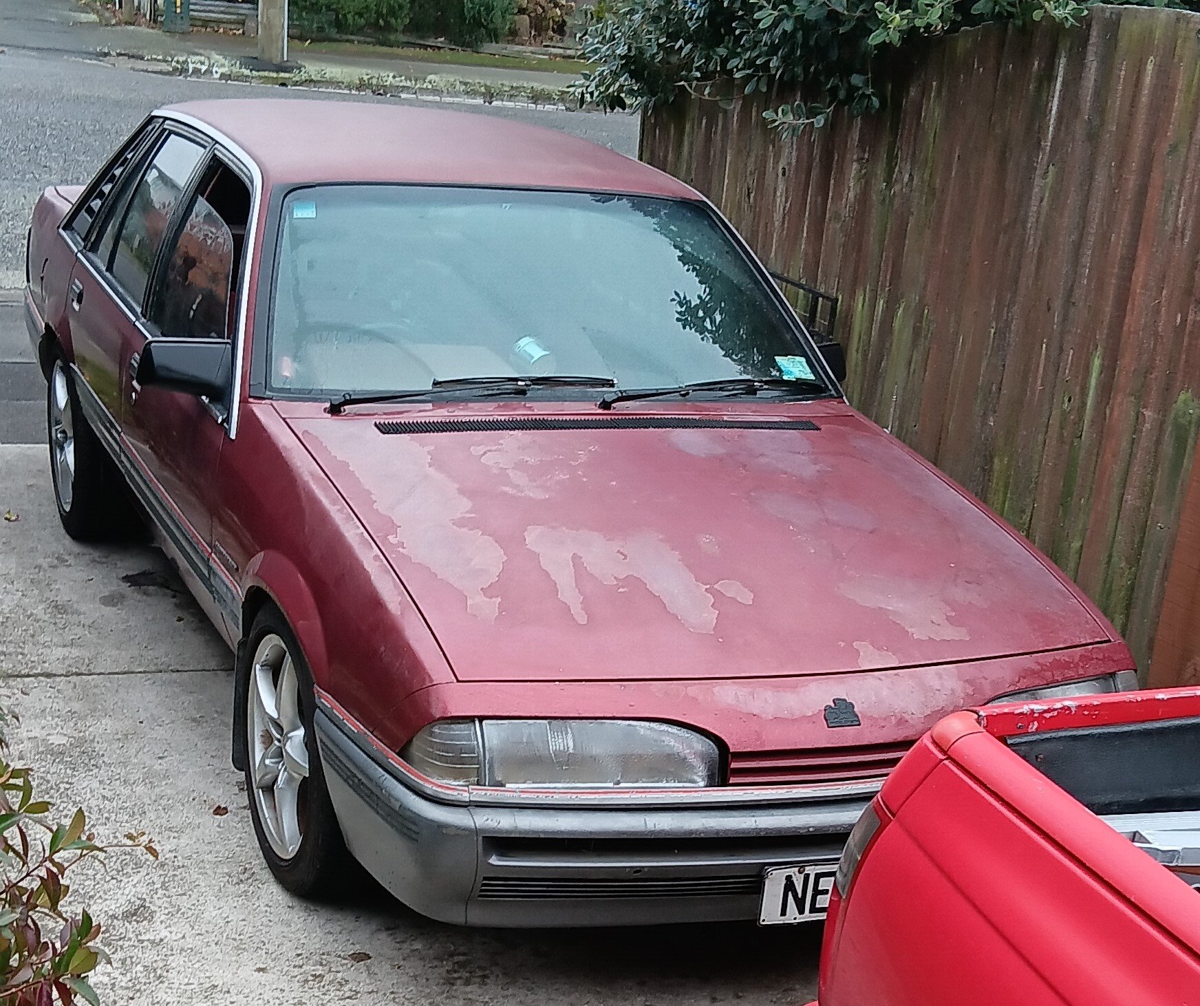

This has the typical misread speedo on the WOF check - Early Holdens (even with a trip meter) only had 5 digit + 1/10 so someone put the 50,000km as 500,000 but I will make sure it gets righted by the next one. -
Unloaded some bits out of the boot and checked for rust, a bit of surface rust on a guard and on the metal plate for the tow bar so wire brushed and sprayed with rust treatment. I will vacuum out and wash clean once we get a sunny day. First stage accomplished, WOF and Rego done. The Marketplace engine and box I have in it turns out may be a series 2 engine which is perfect for boosting as it has the additional water and oil plugs. I read somewhere all the S2 blocks had bungs where the turbo That's a bugger as the one i I have prepped is series 1, at least I know exactly where to drill and tap the good block. I will start with a decent clean soon but removing the sub, amp and a Raptor Farad Capacitor? plus the spare parts has taken a bit of weight out. Not sure what i will do with sub as I will unlikely put it back.

Bristling with worn out clearcoat and on the roof and boot worn out paint. The one bit of trim missing above left front bumper I need to find. Uber lovely 1980's interior Rev counter on the dash as well as the stock dash one! Oh and the small diameter steering wheel! Who needs to oil change. I need to modify to allow better drainage and breathing, xorst looks good, lets hope it lasts.

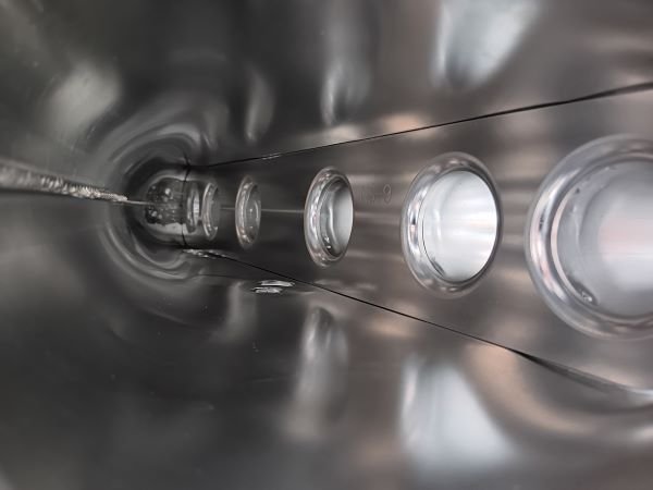

Things have been progressing, I have a few minor issues to sort before she is on the road as a standard version so I can put a few k's on the clock to make sure everything is ok. The parts are building up and I made some more room in the garage by selling one of my bikes and plan on taking another back to its owner. I picked up another couple of heads as I needed good rockers as the ones in the stock engine had some rust from sitting 8 years in storage and as I have upgraded to heavier springs and plan to spin the engine up to 7500rpm its better to be safe than sorry. I have most of the main stuff sorted but still require some mods to the engine cover for better breathing and oil drains etc, I have another sump which I will increase oil capacity, baffle and add return lines into. The Carrillo pistons have 2 valve recesses in them instead of the standard 4 valve ones which is standard for the RB30 and the Valves are bigger Stainless Steel units for maximum efficiency and to handle the additional heat. Porting to match the valves has been done and an aftermarket plenum. I have a billet Kelford Camshaft that's rated at 650hp and with the mods should be capable of this without using crazy boost so should be reliable at this but to start I will run the lowest boost possible

Yep, one of the reasons I bought it along with 1980's plush holden red seats and obligatory cigarette burn hole between the drivers legs. -
