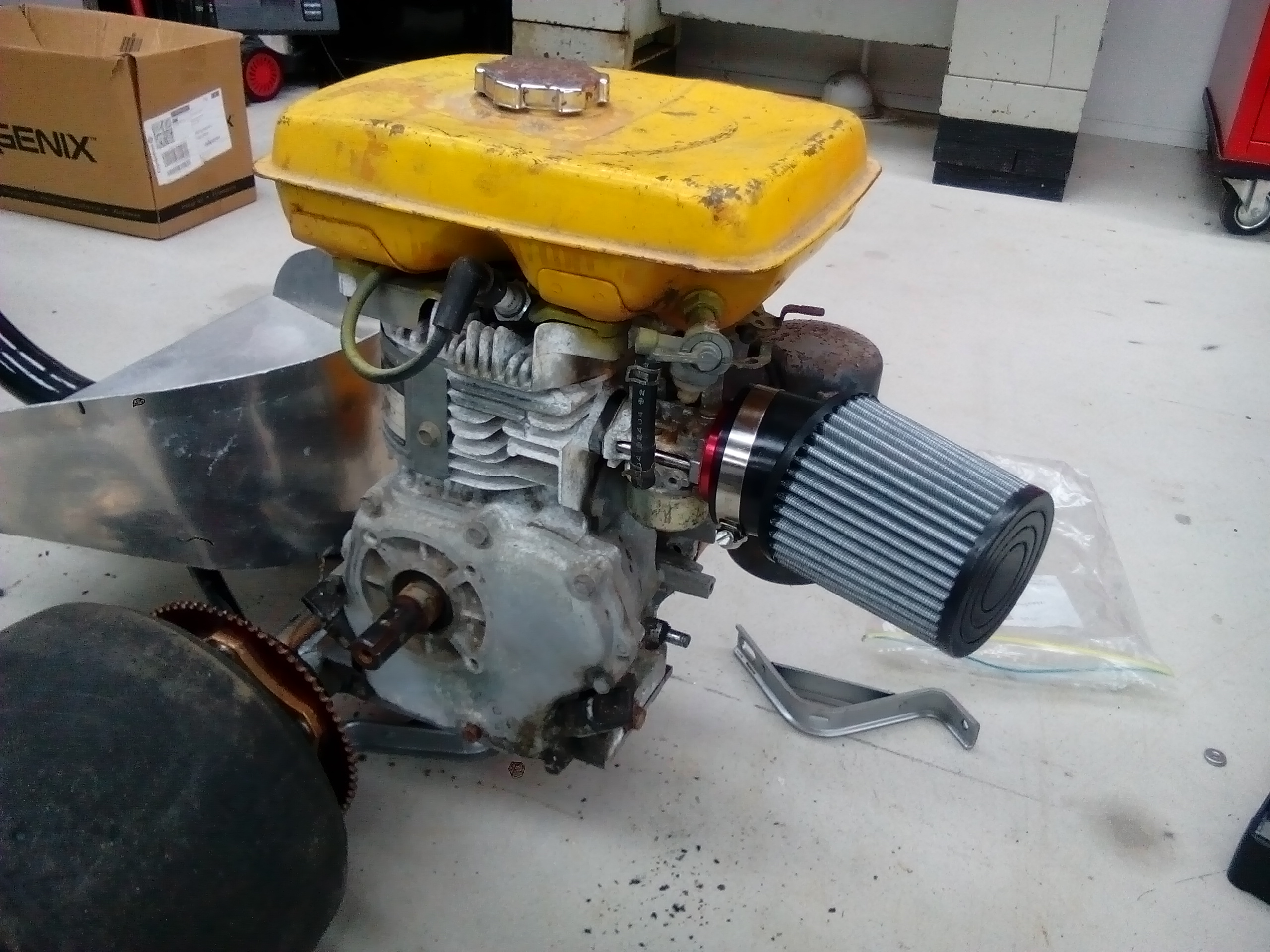

Rear assembly done: Motor with governor removed the lazy way (I'll tidy this up later). And I modified a honda GX200 velocity stack and performance air filter to fit this motor. I was very happy to see mikuni make the carburetor for these Subaru motors, so at least you know it's quality. Everything will get a clean up and paint after I test it.
All sorted: So a couple hours, to save about $70. Some would argue that's a false economy...but hey, every little bit soon adds up if you're making a project like this.

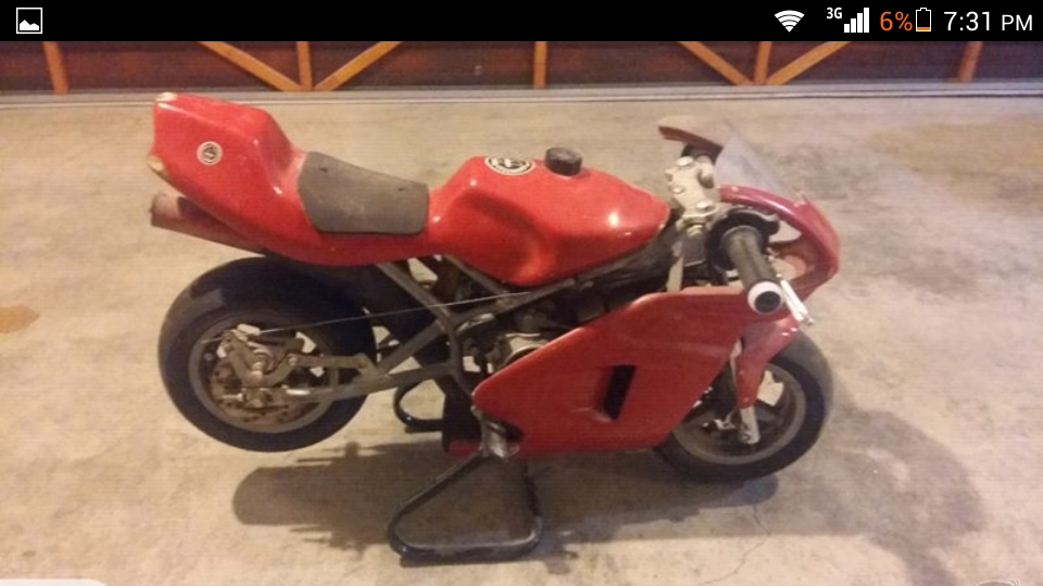

Ok...I think I have mental health issues: This came up for sale on trademe...Looks like another project is in the making... -
