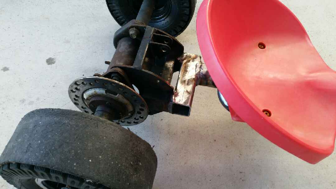

Had a bit of a low after saying goodbye to the naomi trike. So time to get back on the horse (trike?)...so to say. Then that other axle and trike looked a bit lonely...so I united them in an unholy union too: The wheel are just temporary on the red seat trike.

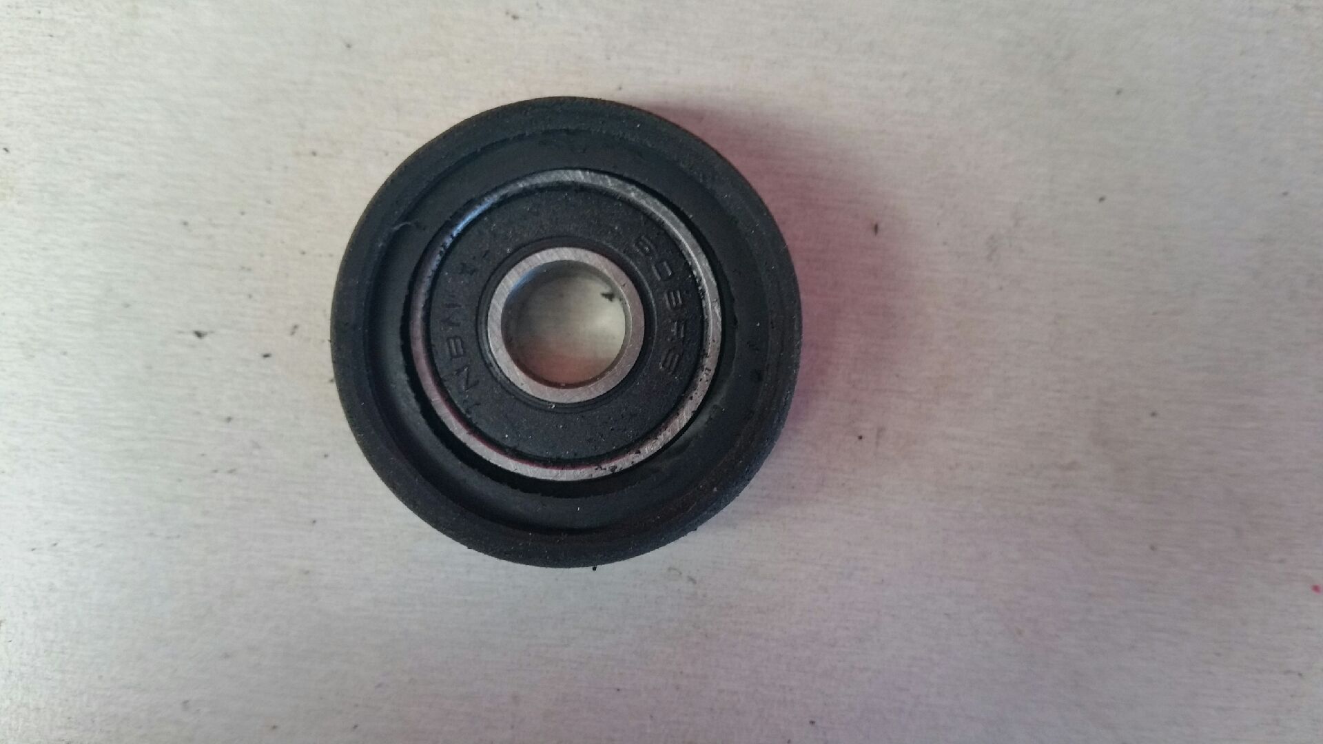

Version V1.0 chain roller shredded itself. Actually it was still functional...but well flogged out. It was quite a hard rubber...but not hard enough. The initial idea was sound, so i reused this solution, but changed materials...with a much harder composition. Ebay to the rescue again. $2.90 delivered to my door rural delivery included. Versus paying $10, plus another $10 delivery on trademe ($20 total). It's holding up really well after riding it around all morning. Success! -
