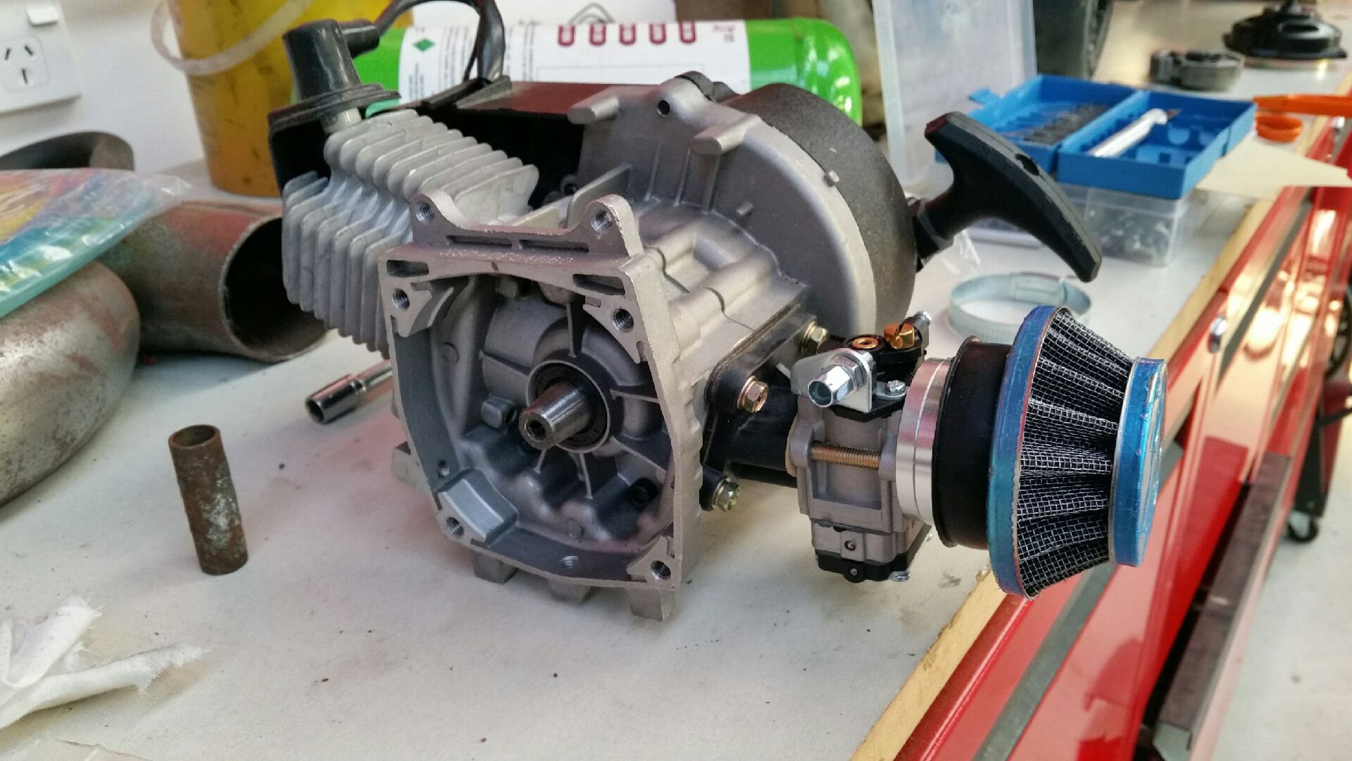

When you make a few things over the years...no doubt you'll end up with a few boxes of shit you don't need, but is too good to throw out. I was rummaging through these said boxes and found a few interesting bits that started taking shape on my workbench today. This motor came with a pocket bike. I got the original motor going so never used this spare one. I had a pumper carburetor lying around from when I made the goped Bigfoot with the highly ported 49cc motor last year...so on it goes. This goped was purchased for parts last year. It's a geo-ped which was a stupid idea (eco friendly) goped made to comply with Californian air emissions regulations...dumb! I figure the tiny amount of time I'll spend on it, putting a much bigger motor won't make an ounce of difference to the environment...but it will be way more fun and twice the power! Obviously the motor won't just bolt on been twice the size. Geo-ped were about 23cc from memory...this will be 49cc. I cut a bit of the deck out to clear the carburetor (will tidy up later). Looks like I can make it fit. And mocked up for inspiration. Looks like it's worth pursuing this idea further:) So I'll give it some absorption time to think over some ideas...then make this shit happen!

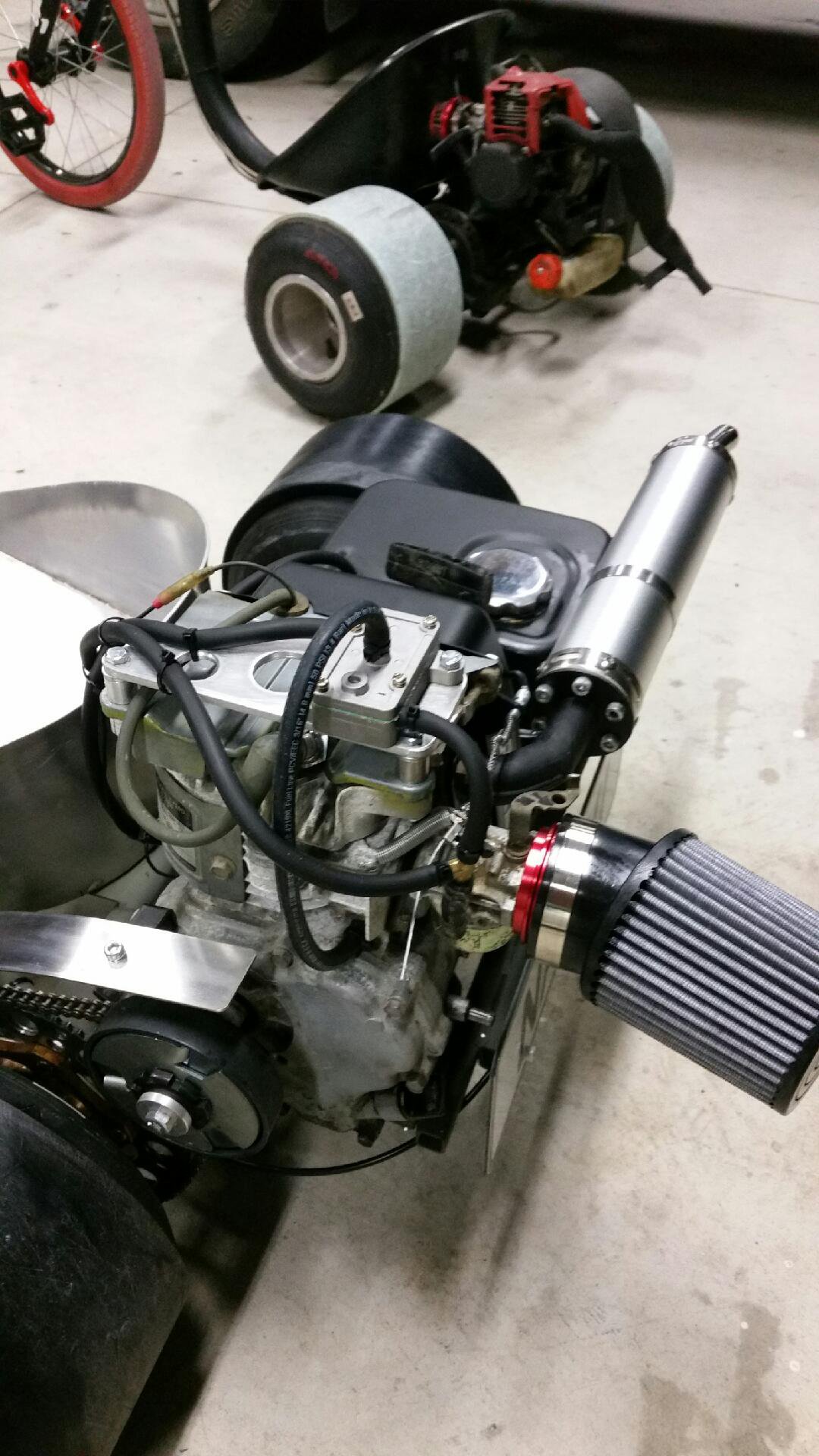

Holy bejeus yesterday/last night was a huge effort. My friend Mike came around and we worked to about 10.00pm to finish up all the loose ends and get the trikes race ready for the coming weekend. Result: JUMBO trike is now completed and rearing to go. This motor gave it's share of problems...but that's what you've got to expect when you buy a cheap swap meet motor with no knowledge of its history. But it's roaring with un-governed life now...so bring it on! -
