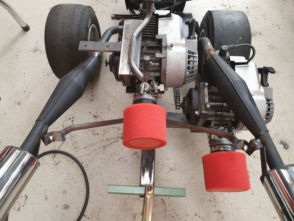

Clutches sorted, first test on ridiculously big sleeves. Yip...it'll do skids! Will make a world of difference going to small diameter sleeves (think trying to start off in 3rd gear Vs 1st gear in a car). And some brakes would be nice too. -

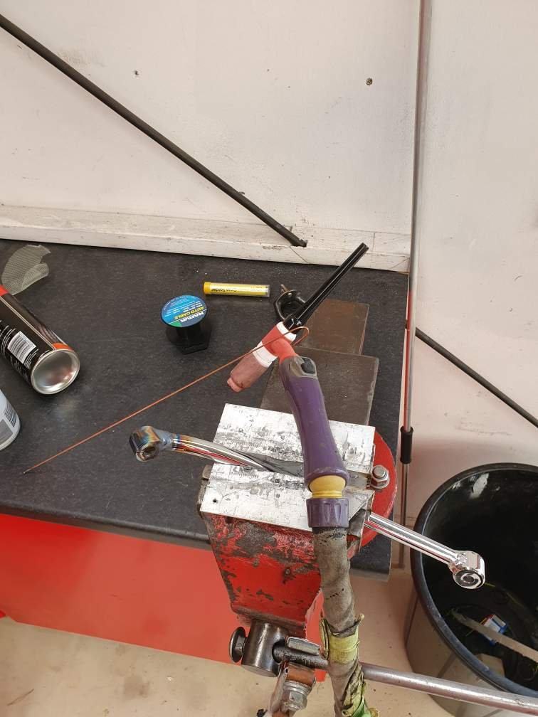

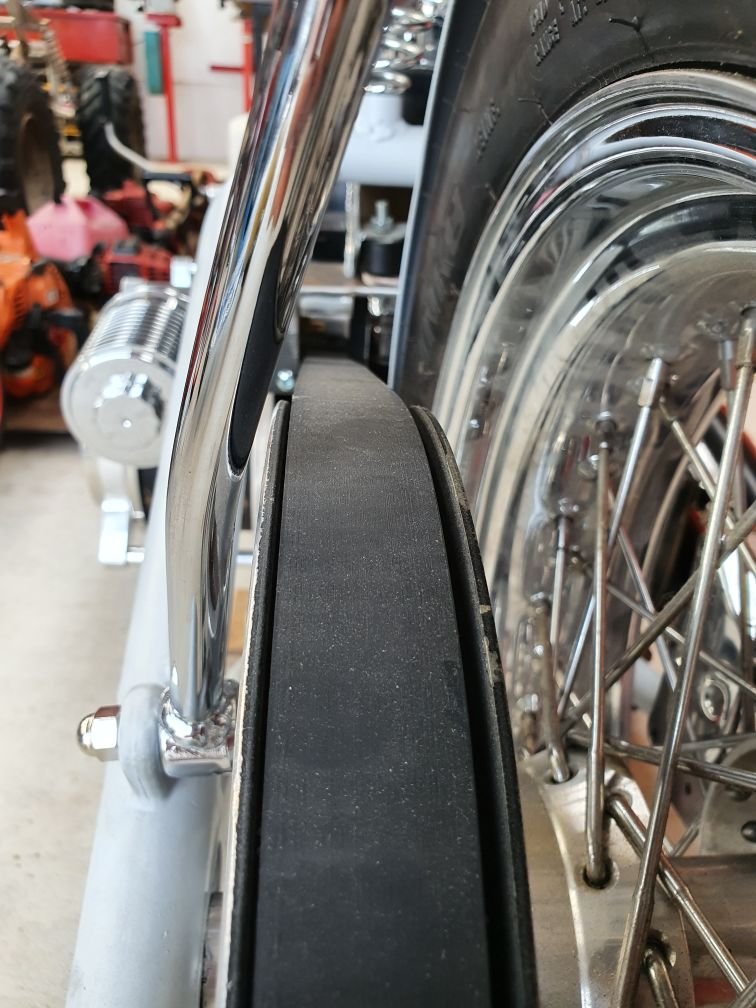

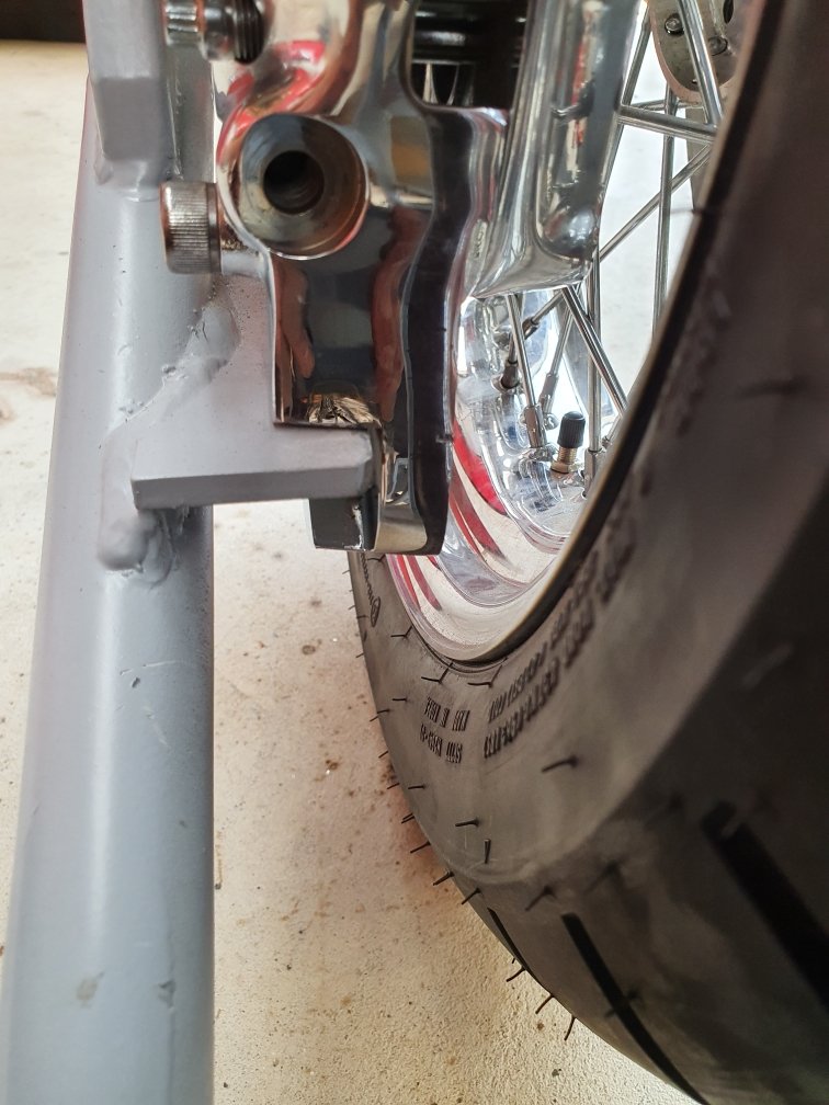

Tig welding like a boss! Doing this because everything shifted over by fucking around with the wheel spacers to centre the rear end perfectly. Unfortunately my fender strut had to shrink a bit. So I cut and welded it with the tig. I'll get it chromed again. Bit sad, as I made these 4 years ago and was quite proud of how they turned out. Back then I arc welded them. Clearance for spinning bits is now all mint! Brake tab is perfectly positioned thanks to my new hub and rotor centric spacer block I made yesterday. Fender sitting just right. Needs a little hammer and dolly love...but good enough for now. Stoked!!!

Brommmm broommmmm!!! Fully working. I've ordered brakes off Ebay to suit. Need some pvc sleeves and done. But those are bolt on parts that will take 5 minutes to install, so pretty happy with it really all things considered. -

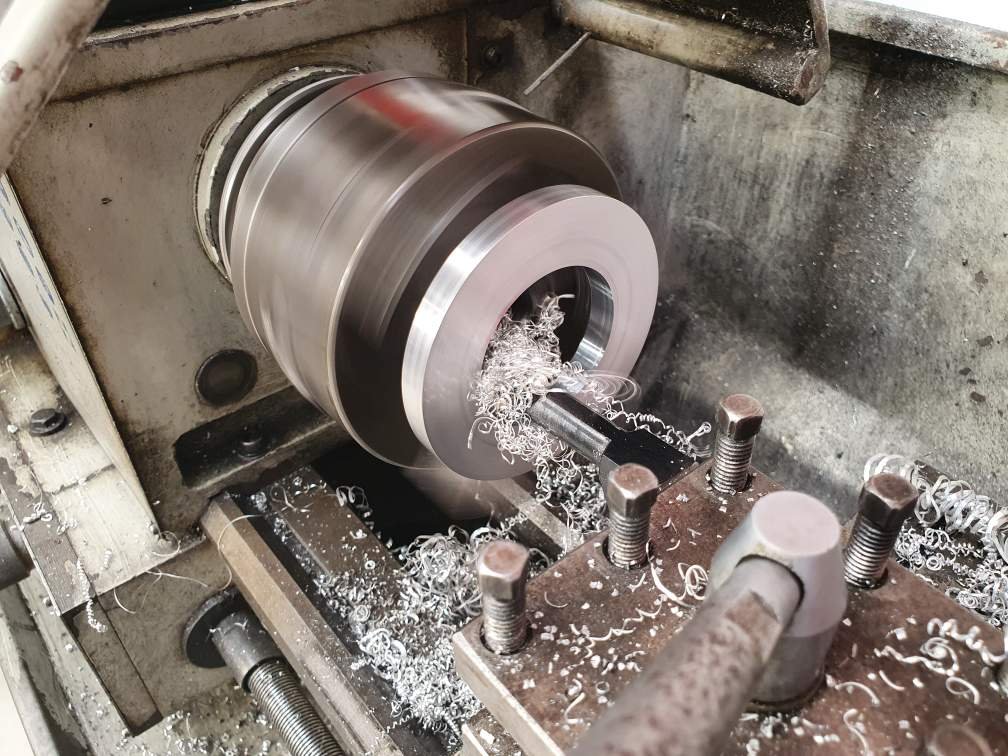

Lightened the flywheel by milling off every other fin on the flywheel fan. Then I shoved it in the lathe and machined down the length of the blades. Mild improvement in performance...but probably more in my head than reality? I've also gone back to the original pull starter, as my adapted "easy pull" mechanism made of the finest Chinesium pot metal die casting man can make...um broke after about 10 pulls (turns out you really do get what you pay for eh). But let's just say my compression ratio is probably a bit more than what it was designed for...
