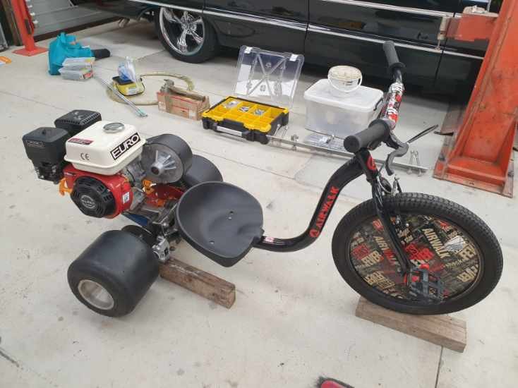

Got all the big bits assembled and running well. I have to clearance out the inside of the cvt housing, because I'm running mine upside-down to usual, in order to shorten the chain as much as possible. I've hooked up throttle and wired in a kill switch on the handlebars. Its only got front brakes, which on a trike are completely useless. I need to get hold of a master cylinder and some brake line to finish the rear brakes. Pretty happy with it so far, its all falling into place. -

More progress: Brakes...pretty important on most vehicles Fuck yeah...combination spacer/crush tube brakets. Love me a good multi purpose bracket. A lot of over engineering going on here. Smashed it! Pretty much done, just need to order a few miscellaneous parts like cables to hook up for controls etc -

Bit of action...que cutting and welding montage: Mate it with a drift trike: Boom! One axle setup ready to rip! -
