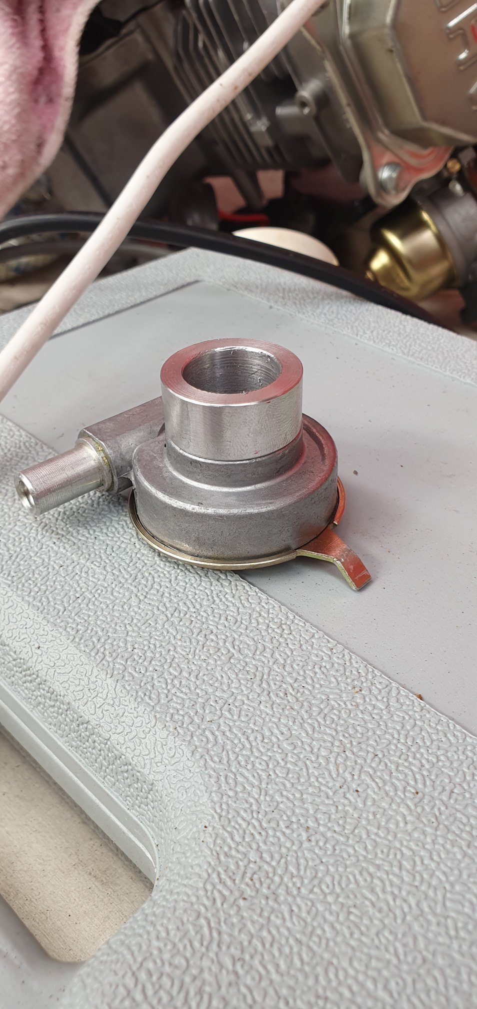

Solutions: Cutting it down, machined in lathe afterwards. M4 cap head to act as a pickup. This M4 drives the tab that turns the worm thread. Spacer made to add back on, what I cut off...but on opposite side. Tadah!! Fuck yeah! All sorted.

Long story short, speedo driver unit for mechanical drive, adapted to fit a late model wheel that doesn't have mechanical driven speedo. Problem was this gap. The older shovelhead wheels have the bearing recessed in an inch, so that tab connects. Also they are mounted on the RH side. Mines on the left. Problems!!

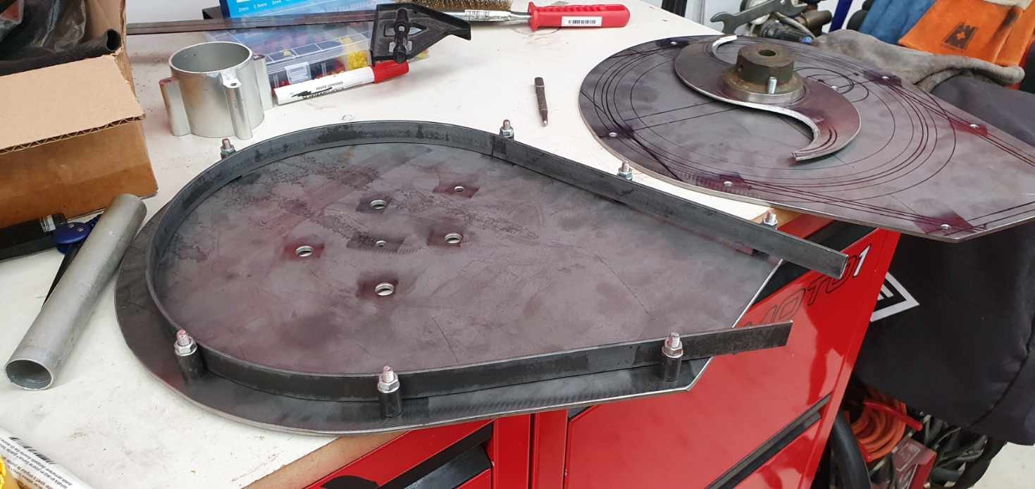

Starting to take shape. I cut that plate from 4mm thick steel. I'll weld it under the transmission. It will hold a few items, fuses, relays harness etc. Hopefully mostly out of sight. Each branch of the loom goes to a different part of the bike. The deutsch connectors are huge and fucking ugly, so these will be hidden under the bike too.
