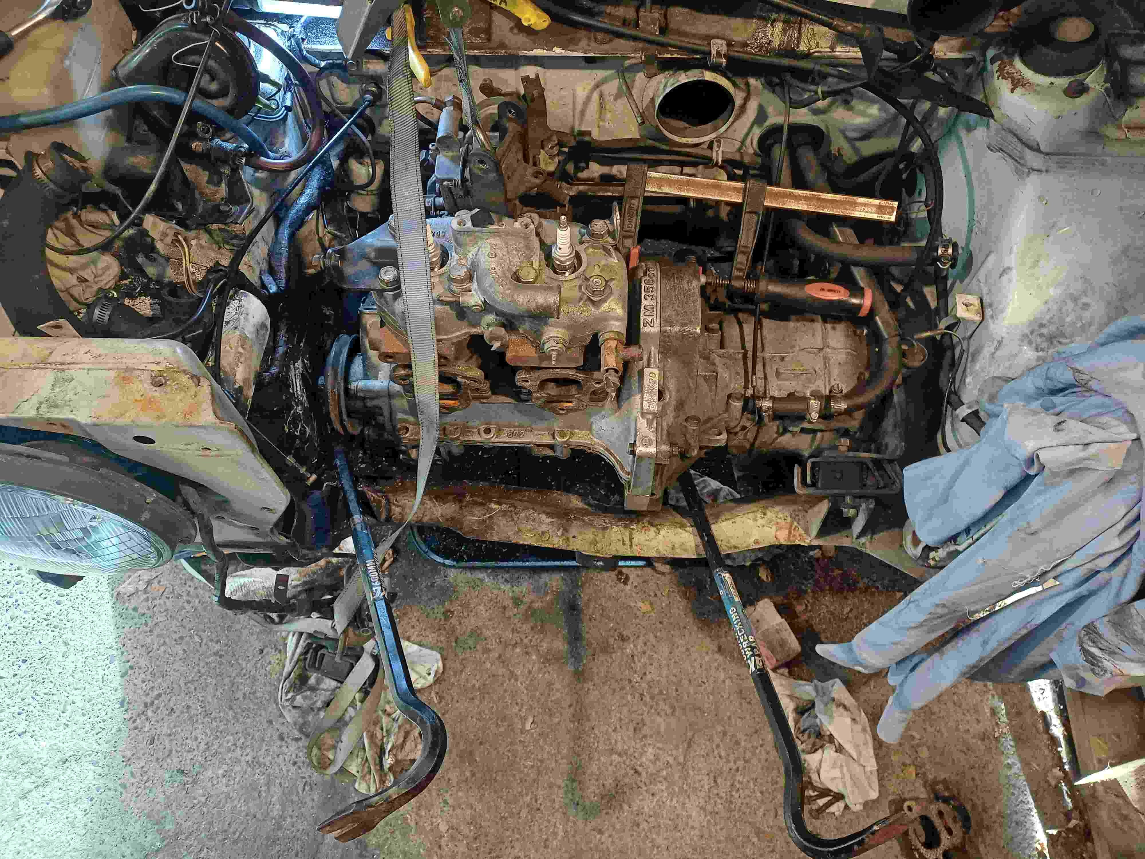

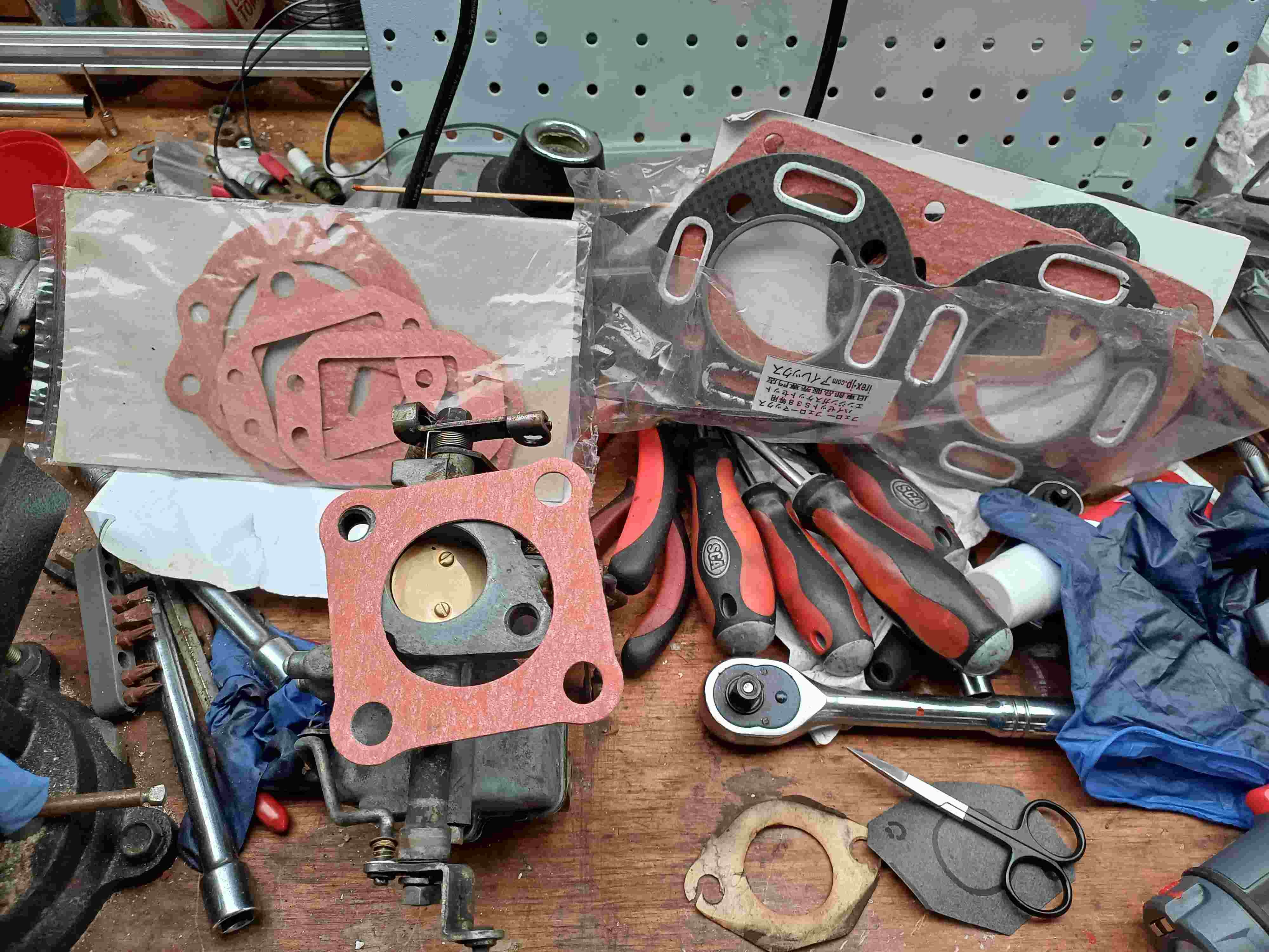

So I had a pretty good set of gaskets, courtesy of @kyteler, which fitted nicely except for the carb one: Sooo, down to Repco! /s Generic gasket: some assembly required Then bung the motor in the hole, line up the stick thingy with the hole thingy I have some new tricks to make this a one-man job: drop the engine mount off the motor rear-left; also remove the fuel filter and bracket from that corner, Suspend the motor with a ratchet strap, TWO pinch bars: Once you get the first bolt from motor to box in, ye can squeeze the rest together with any old G-clamp. 1/4 inch socket set doing the good work to get the bolts back in that left-rear engine mount. Now it just needs fuel, oil, spark and starter hooked up for the traditional piss the neighbours off test. It'll be a few more days to get it roadable (Alt, cooling etc), but mostly this (these): Yar, those won't buff out. Well, off to see Hamish at Hammer-n-Weld, he's a nice chap anyways.

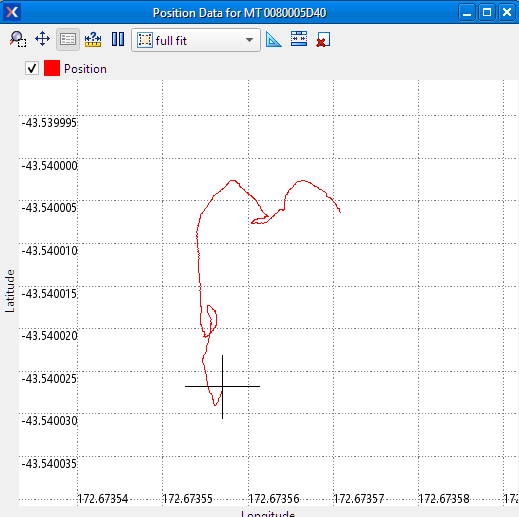

Fencepost took a walk (no it didn't). Missing our 10cm target by about 330m Update: yeah, nah, I slipped the decimal place the wrong way, that's the track over 3m, about what's expected without the RTCM correction.

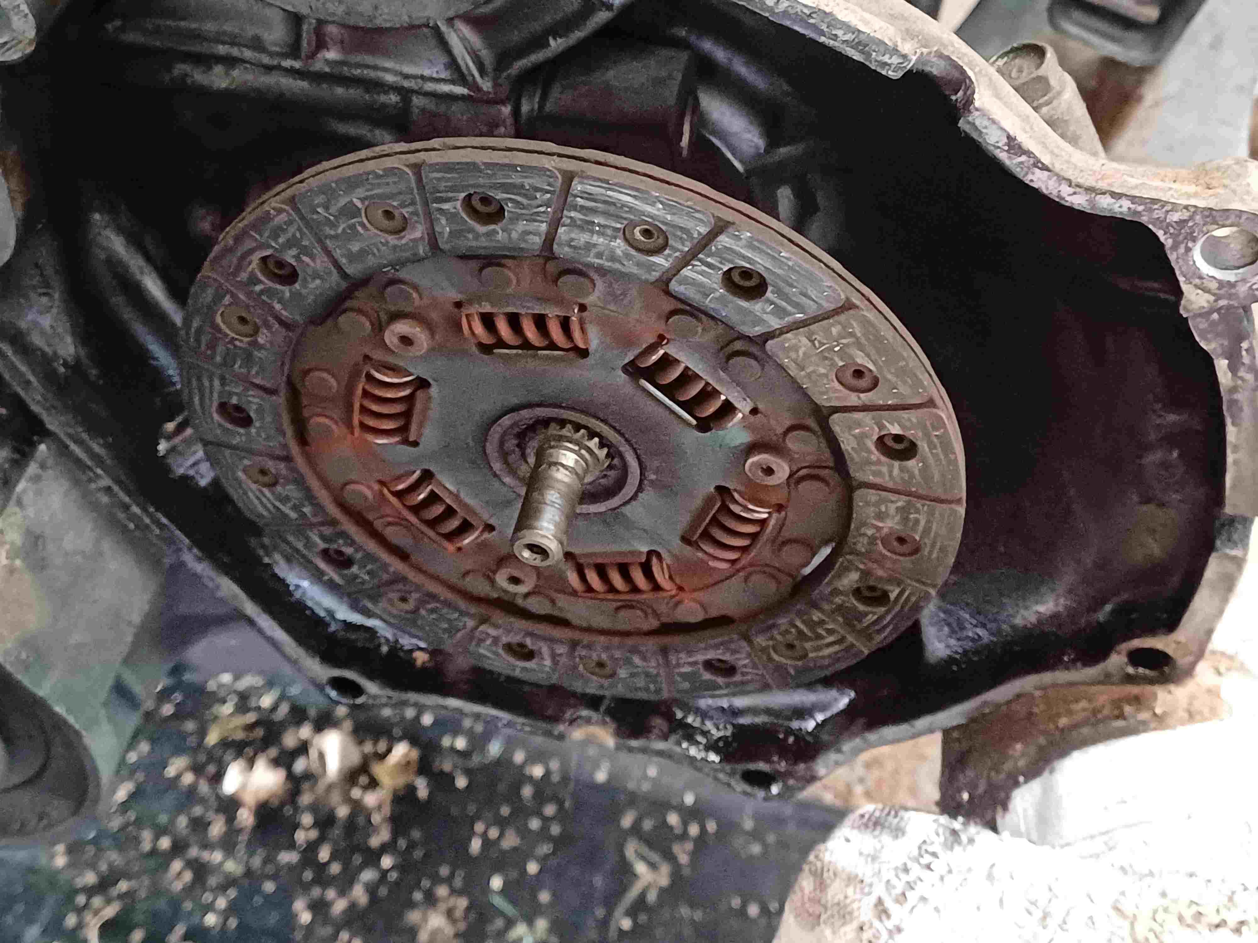

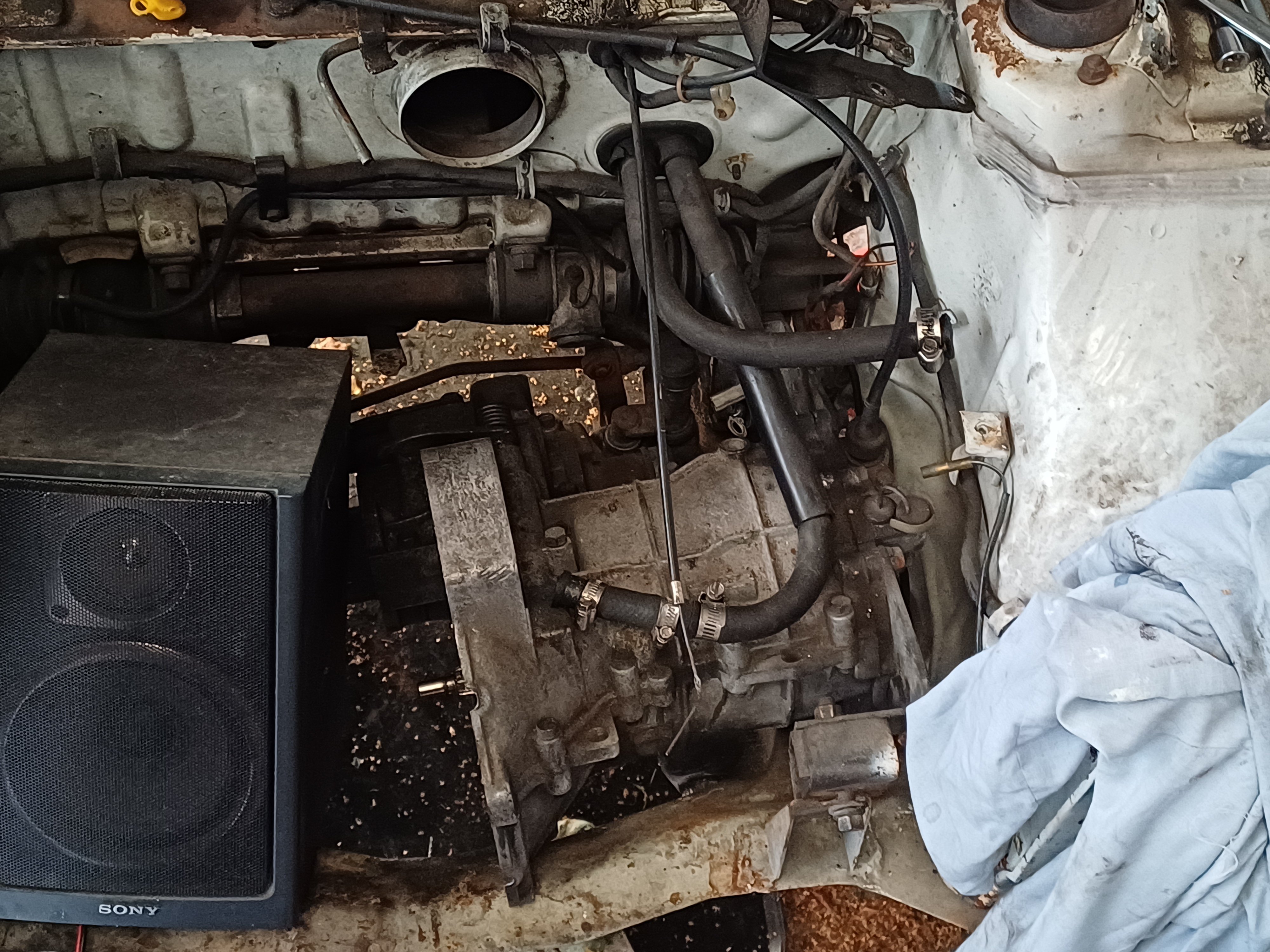

@ajg193 was kind enough to chat mech, and pointed out that the gearbox doesn't spin when the clutch is depressed, so the rumble is probably the motor output. Of the shit motor I want to change out. I should'a just gone with my first instinct and slapped it together and sent it.

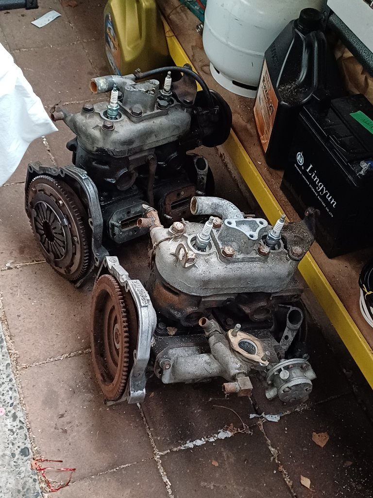

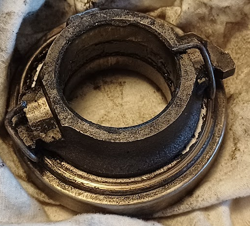

That was all before x-mas mind. I got the repaired expansion chamber / muffler back, then split the motor from the gearbox about a month and a half ago, but the bus run to new work is so quick, I got lazy... While the motor and box have parted company, I thought I really ought to investigate the grindy clutch noise: It feels fiiiiine, so I guess I'll go find a 2nd opinion? (i.e. procrastinate putting it back together again)

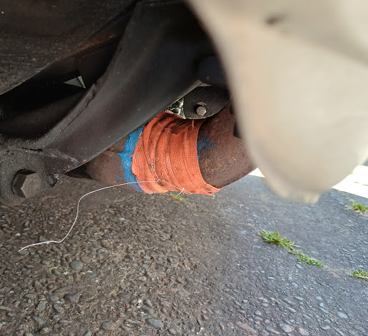

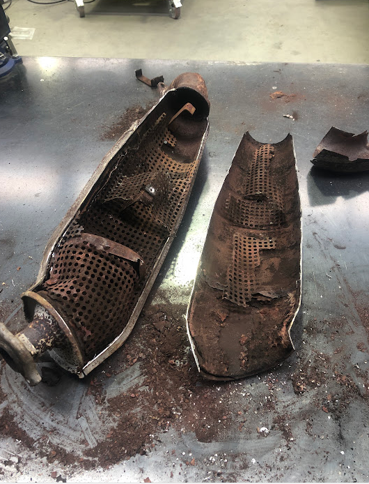

Oops: this was getting substantially loud British tech to the rescue (temporarily) Whilst Hamish at Hammer and weld did this to the other one:

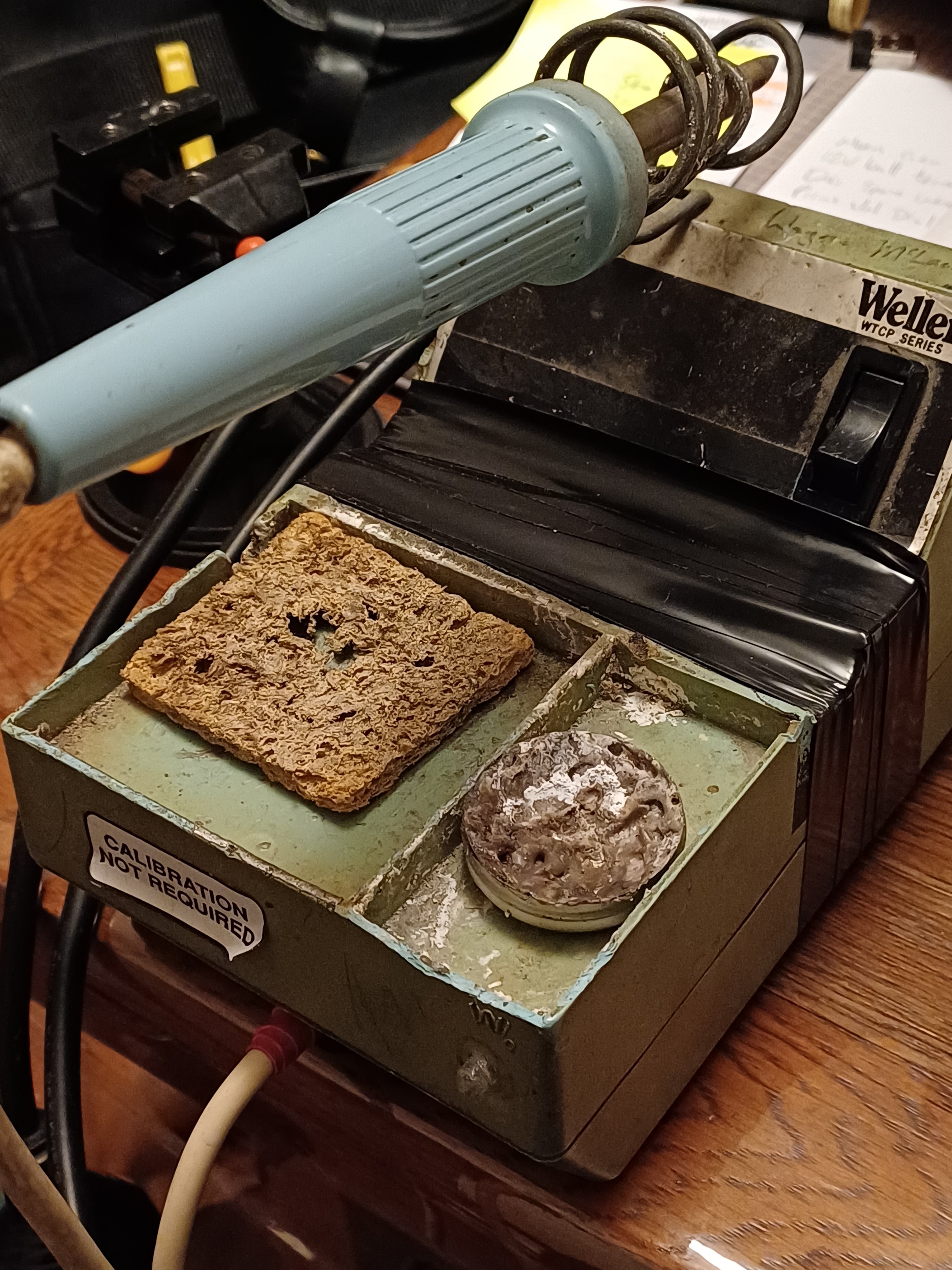

OG Weller iron refurb. Baby h4nd could have done better rebuilding this 1/3 century ago. I got the sizzle noise out. -
