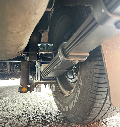

anglebox94 Posted June 13, 2023 Author Posted June 13, 2023 And a bonus pick of an MGC I saw at MG Motorsport when I collected the new box. Quote

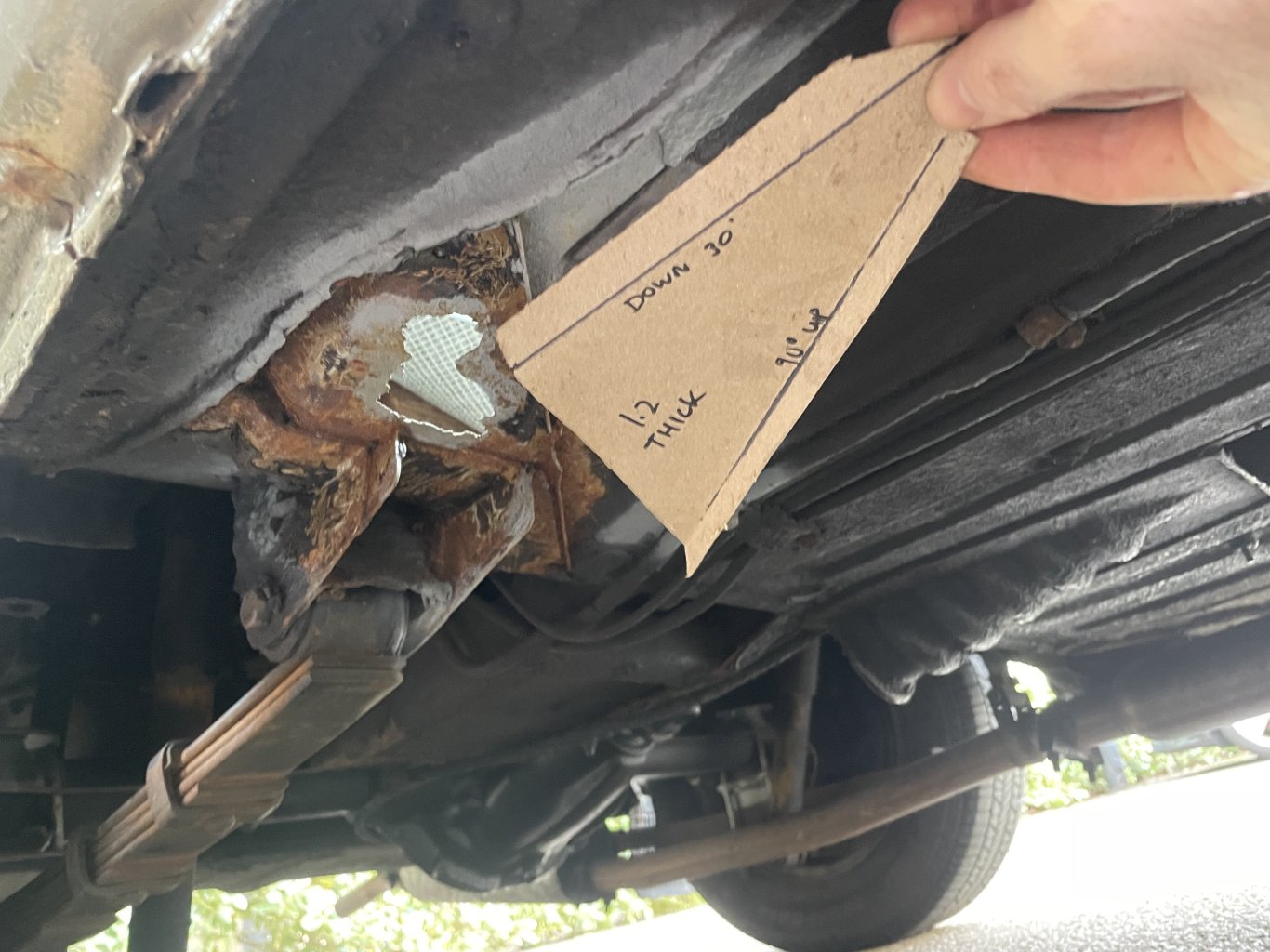

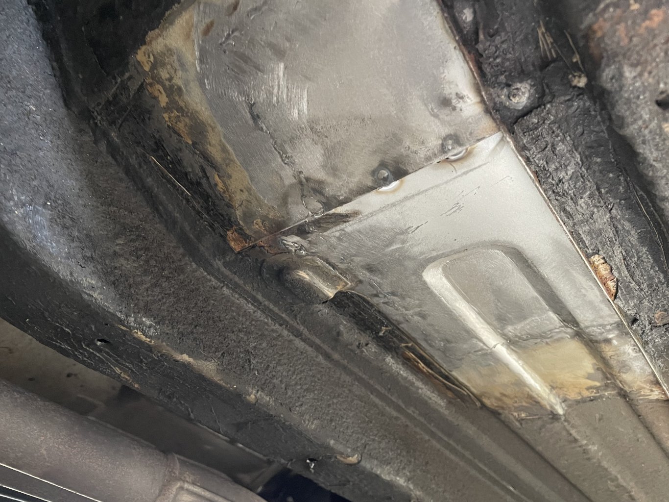

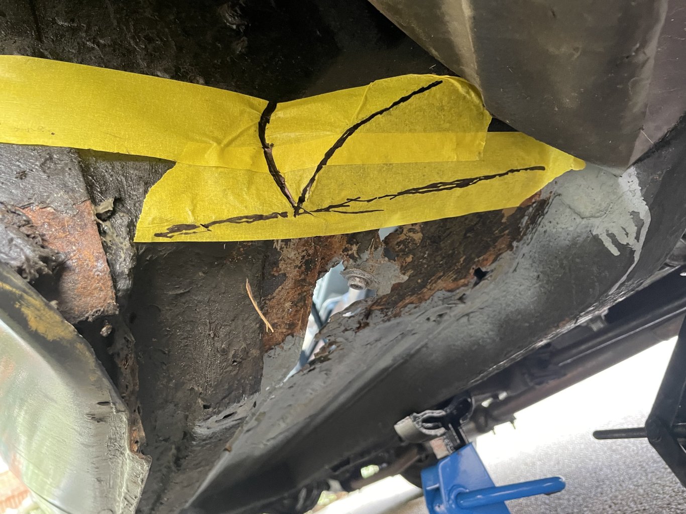

anglebox94 Posted February 19, 2024 Author Posted February 19, 2024 But the salt has not been kind to the floor… Quote

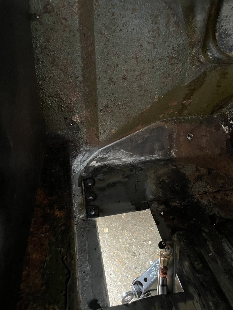

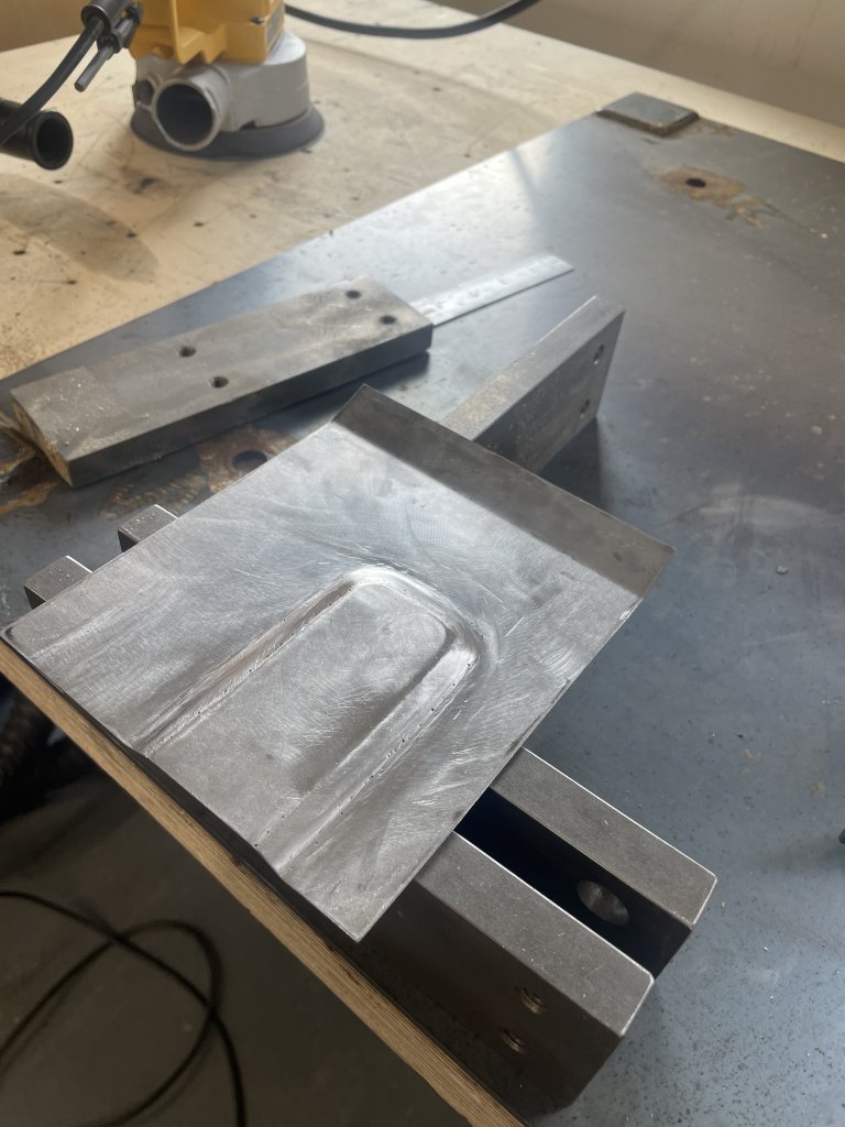

anglebox94 Posted February 19, 2024 Author Posted February 19, 2024 Been making some peripheral patch panels ready for a new floor section. Still working out how to get them welded in the carpark though :/ Quote

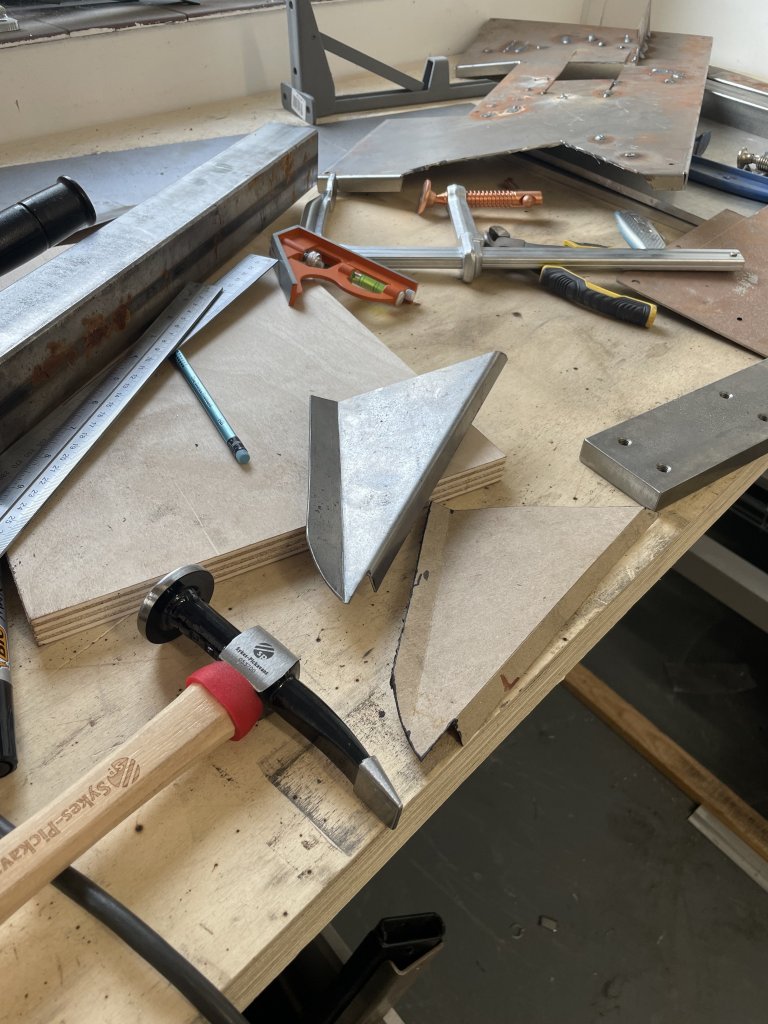

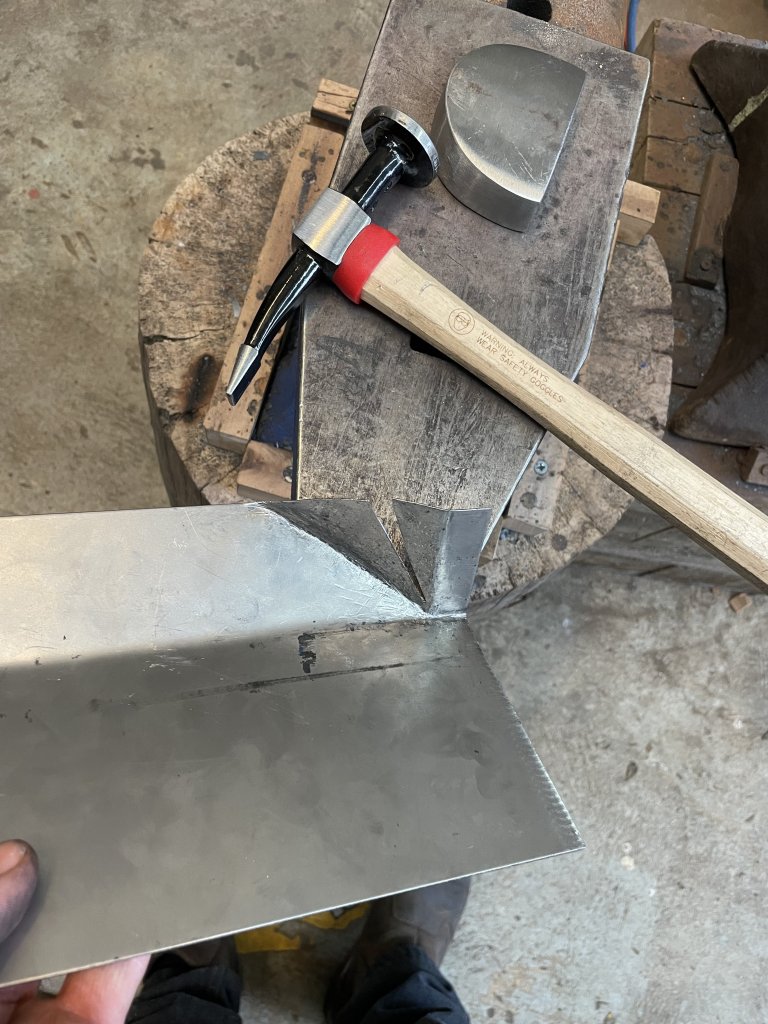

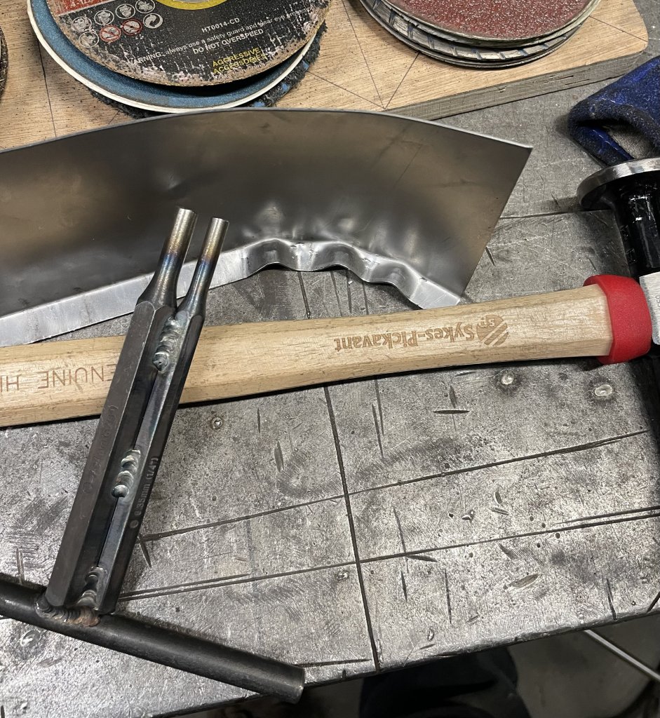

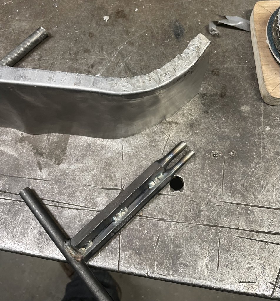

anglebox94 Posted February 19, 2024 Author Posted February 19, 2024 Got a bit side tracked and made a tucking fork to give manual shrinking a trial… hard to get even but bit more practice and it'll work alright. 1 Quote

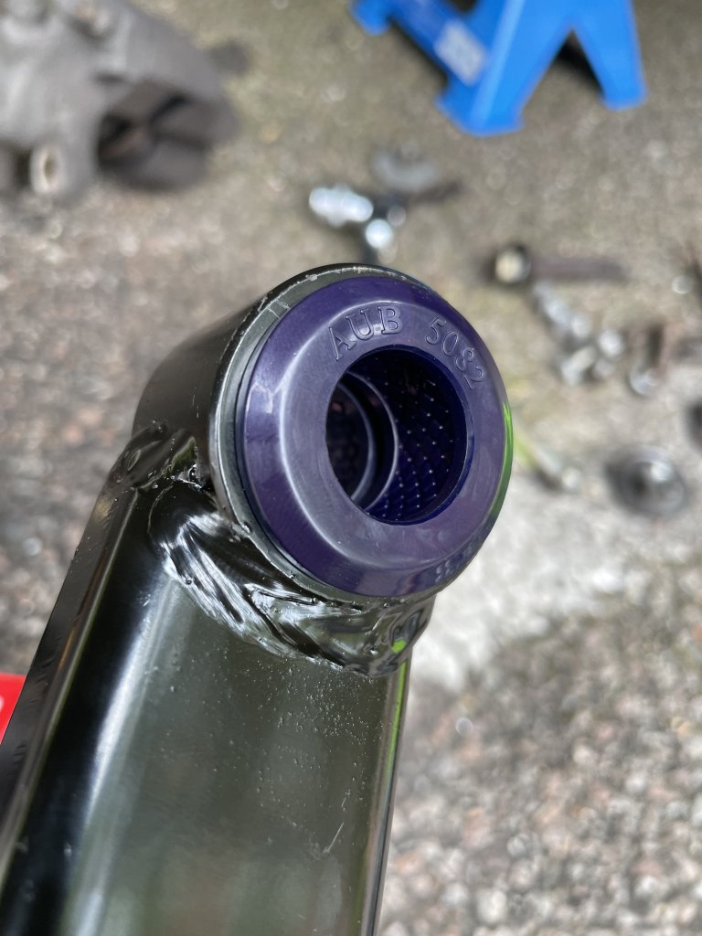

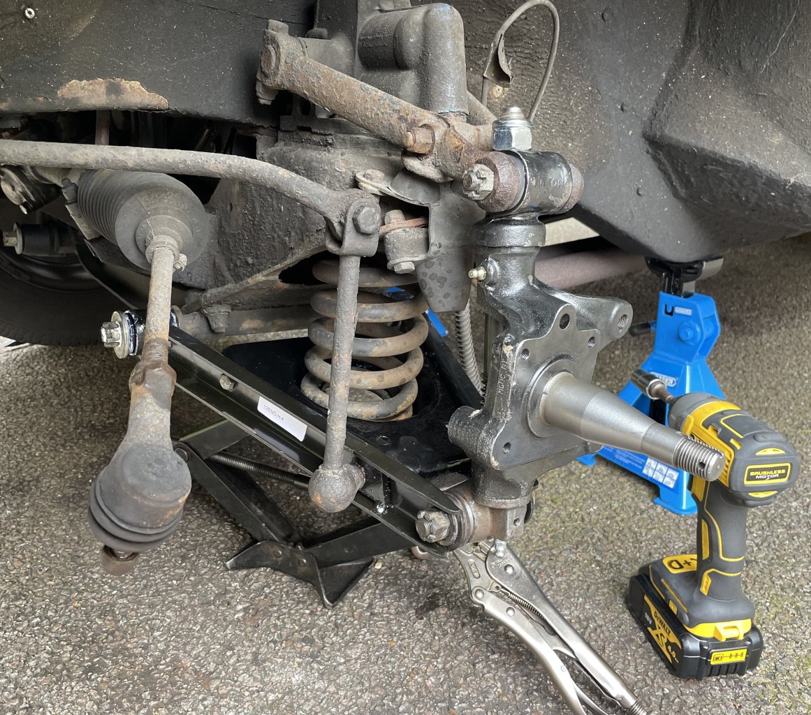

anglebox94 Posted April 8, 2024 Author Posted April 8, 2024 Would not recommend mg rubber bushes - they only lasted 6 months… would recommend greasing your stub axles though…. new poly bushes and axles installed this weekend with the help of @Sambo Quote

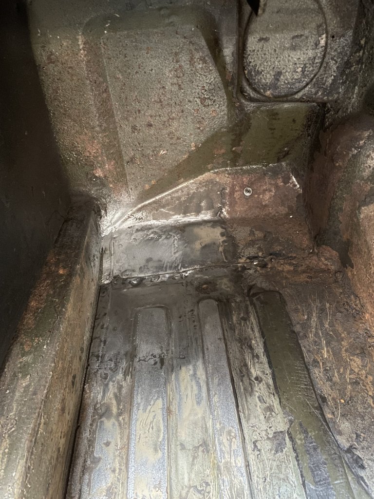

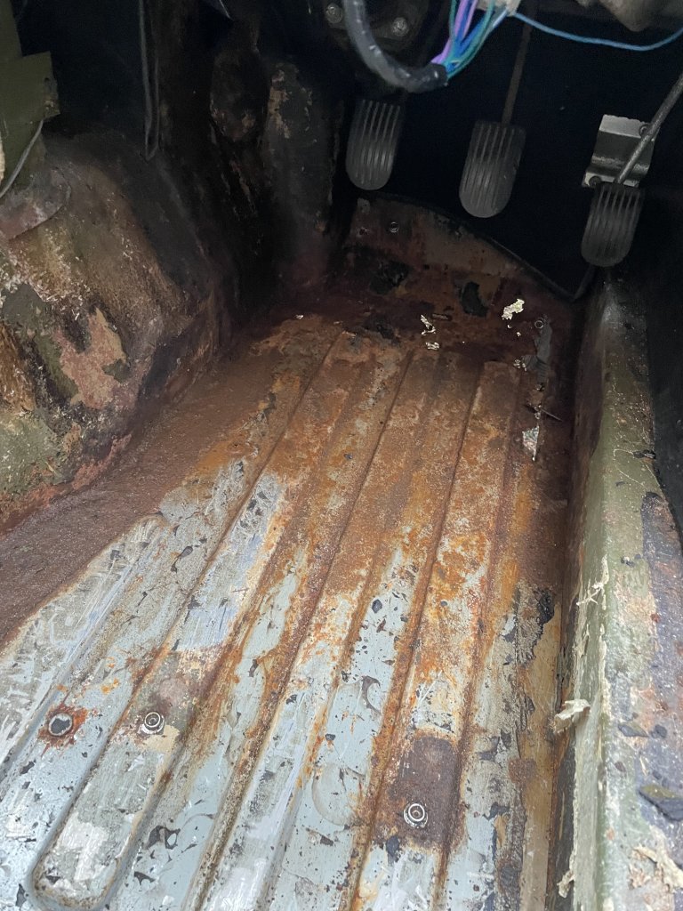

anglebox94 Posted April 21, 2024 Author Posted April 21, 2024 Filled one hole but found two more… Quote
