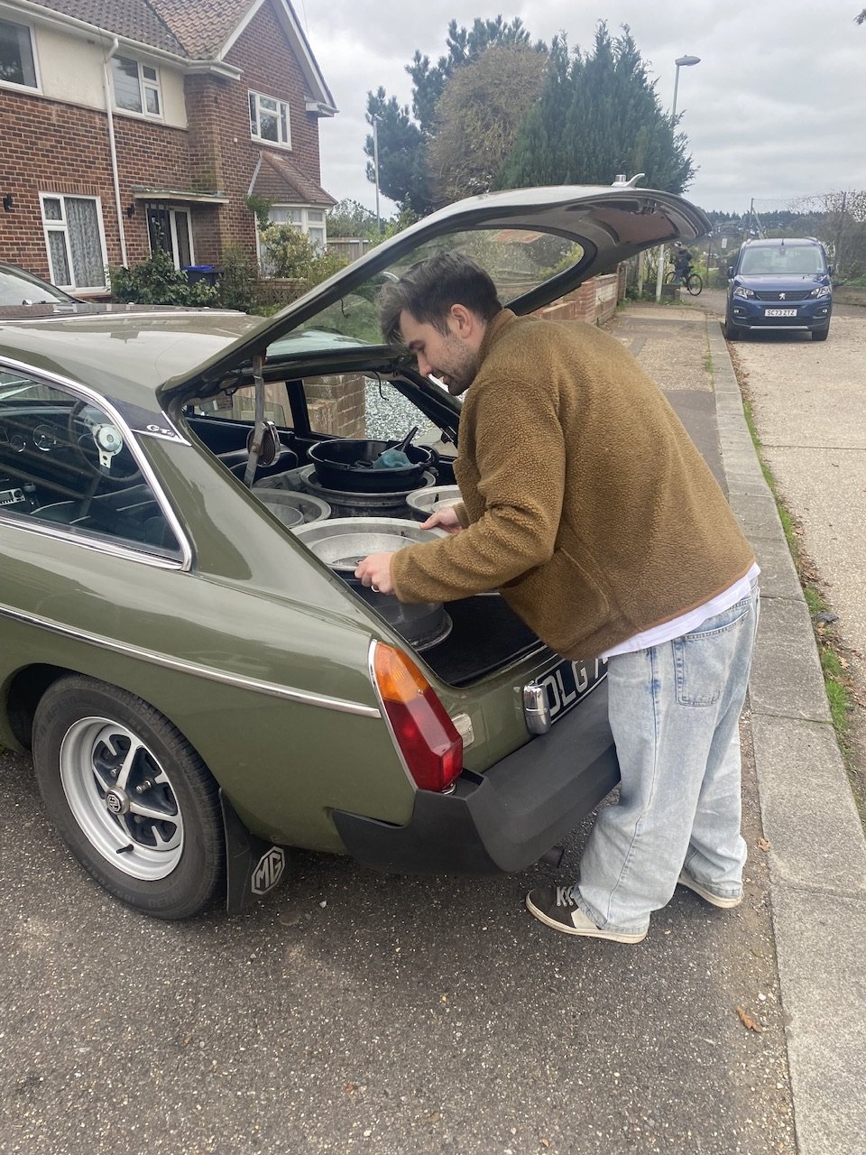

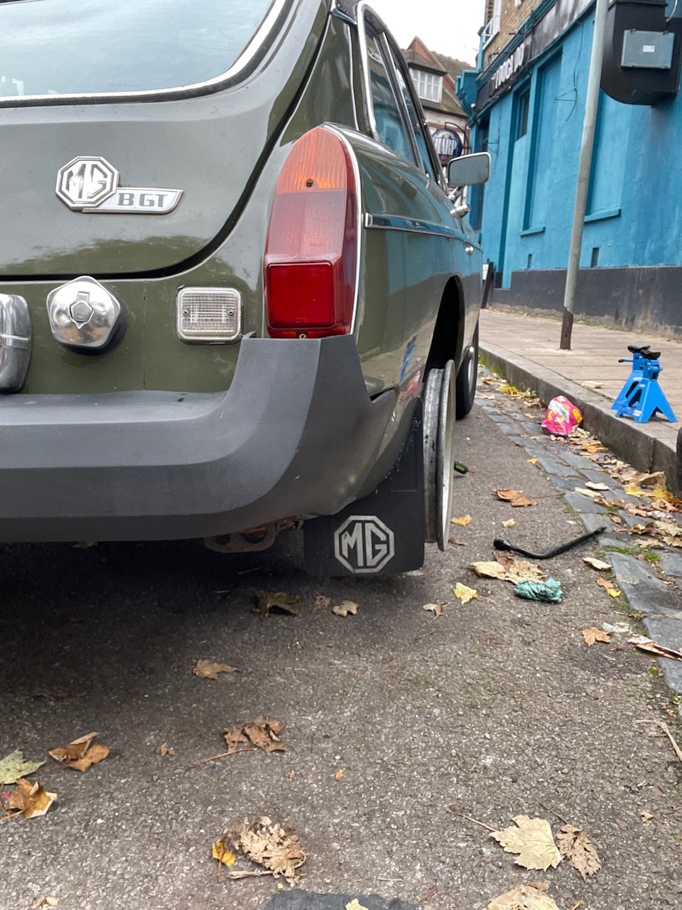

  1. New wheel day Now tempted to drop it a couple inches

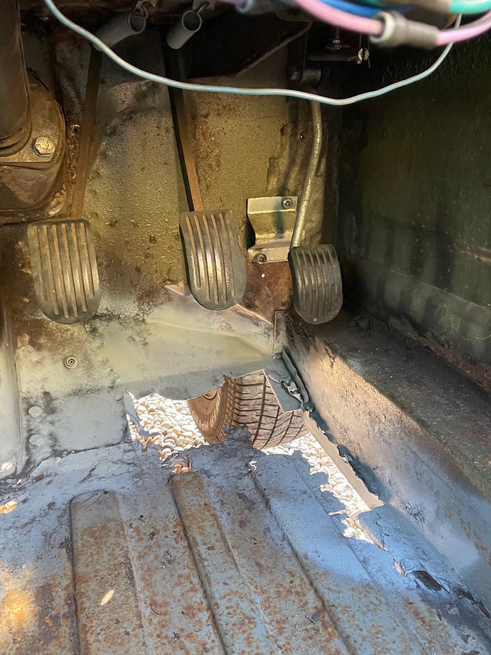

  2. Mission for the summer is to get the floor in. Bit tricky street side but we’ll see how we go.
  3. Got around to cutting out the lil hole.

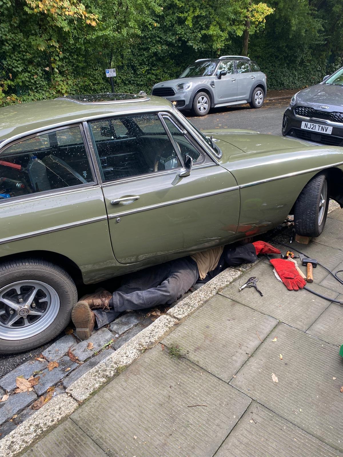

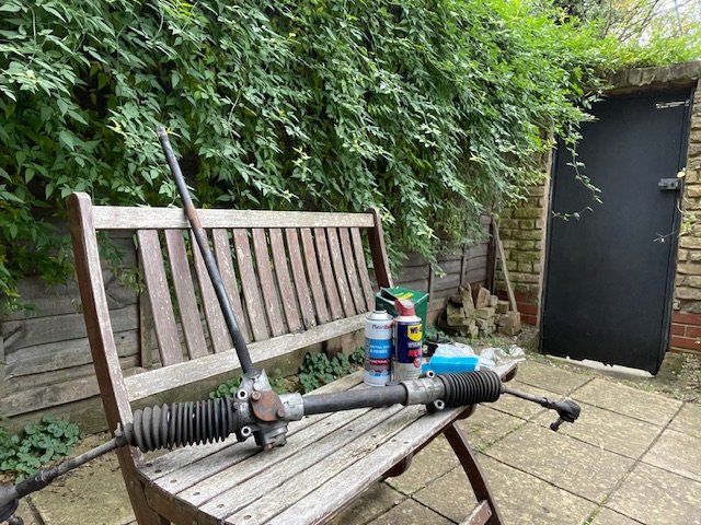

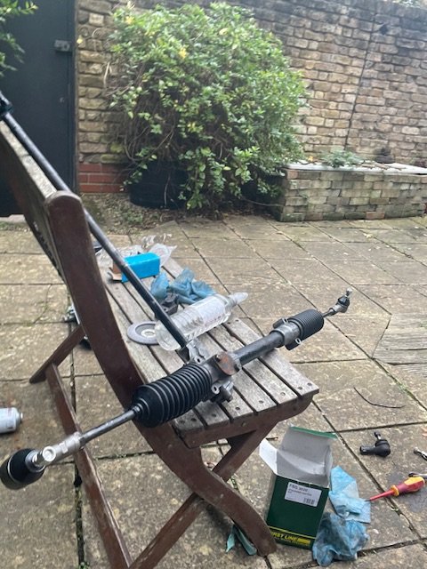

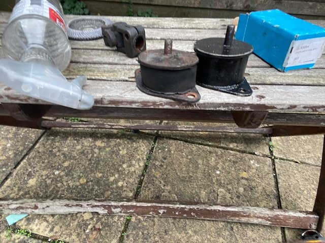

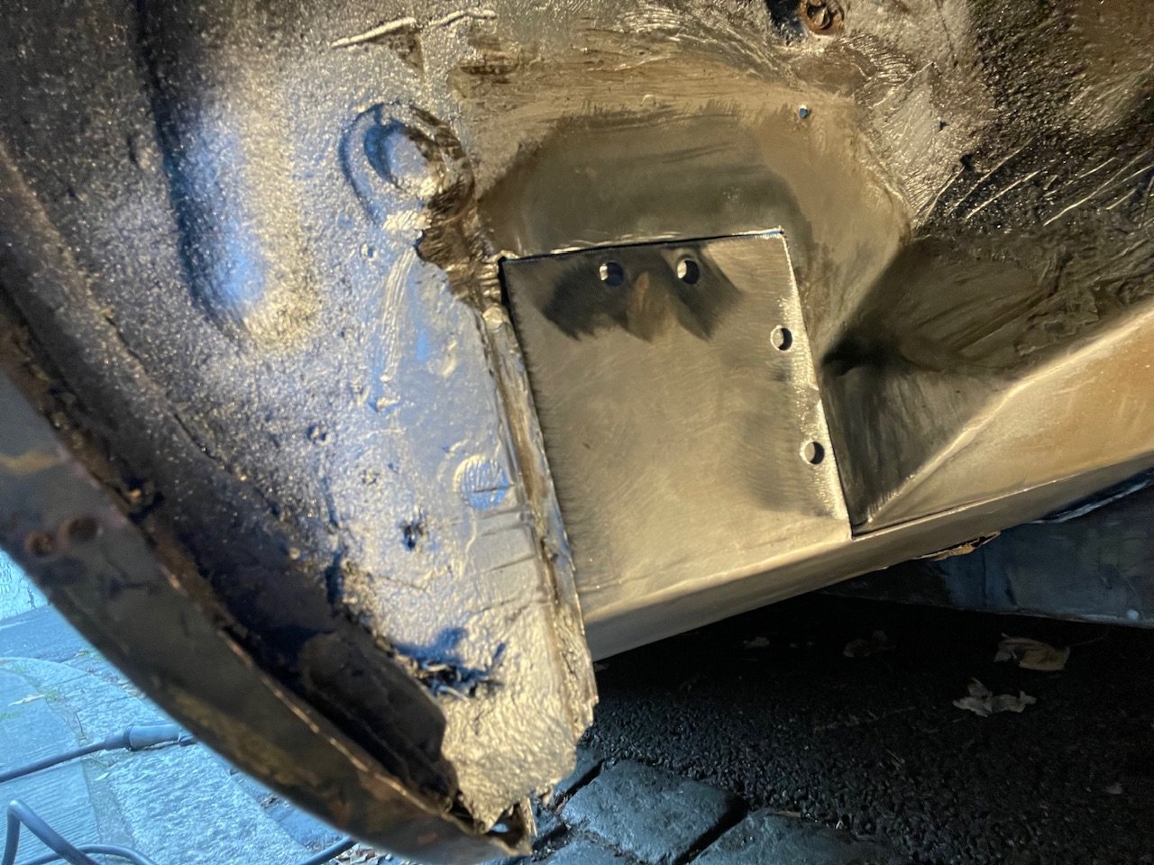

  4. Steering refresh today. New TR ends and boots with a new UJ for the column too as the old one had some play. Also replaced the offside engine mount at the steering column needs to come out to remove - the old one was split away from it’s plate.

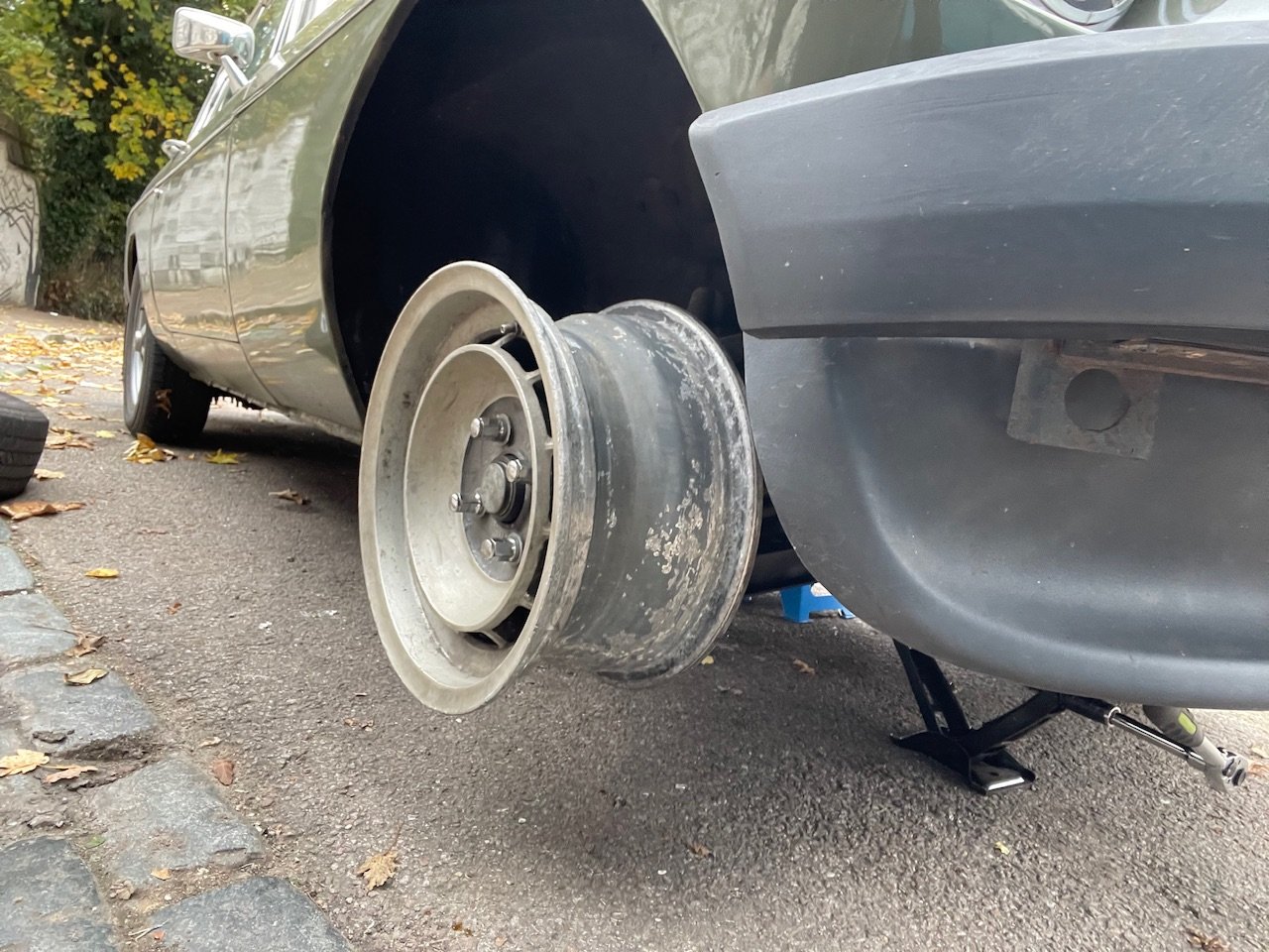

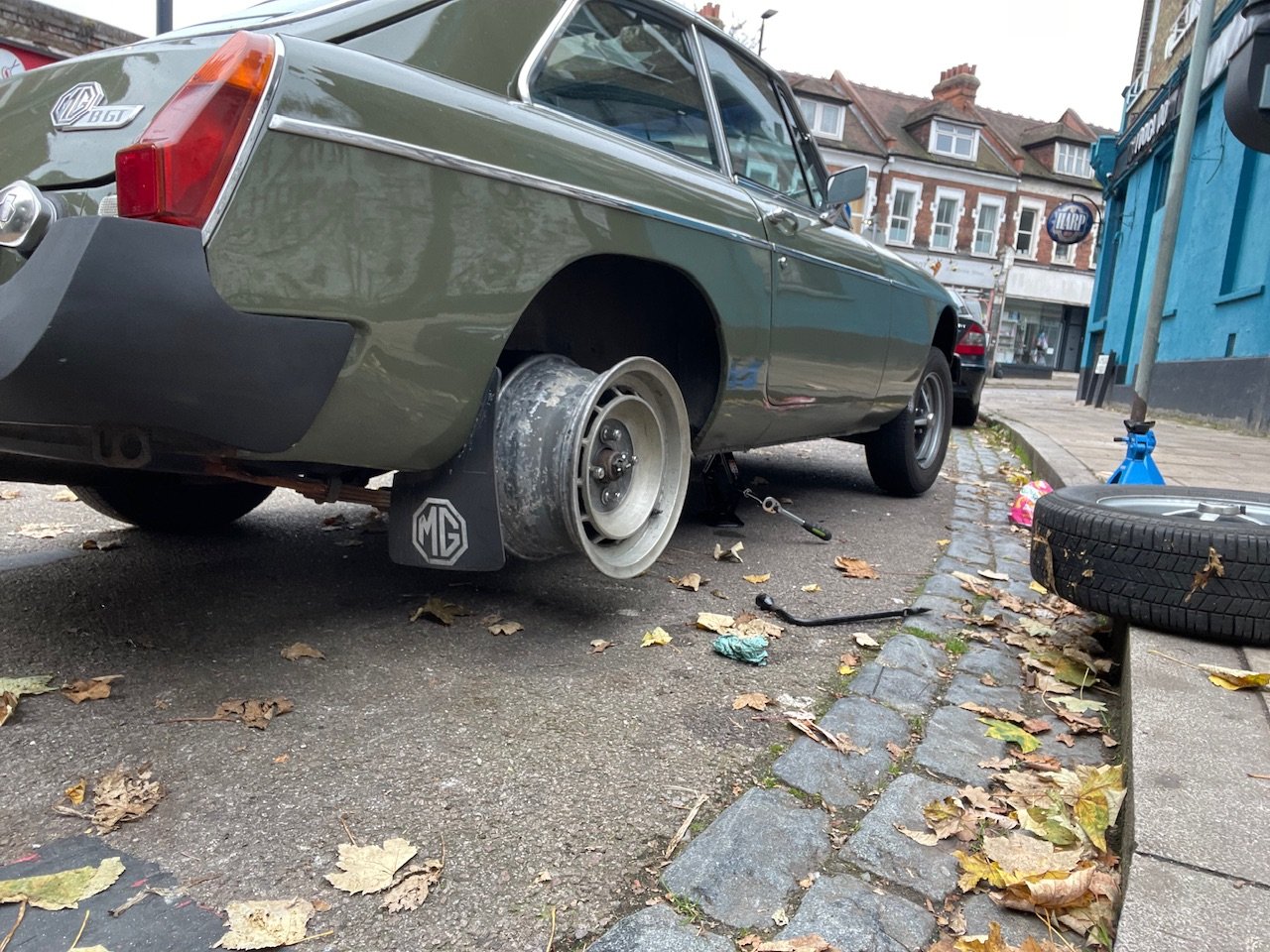

  5. A marketplace mission to Worthing yesterday for a set of Lotus Eclat 14x7s looks like they’ll fit with only some 6mm spacers needed on the front to clear the arb. But will have to see with tyres.

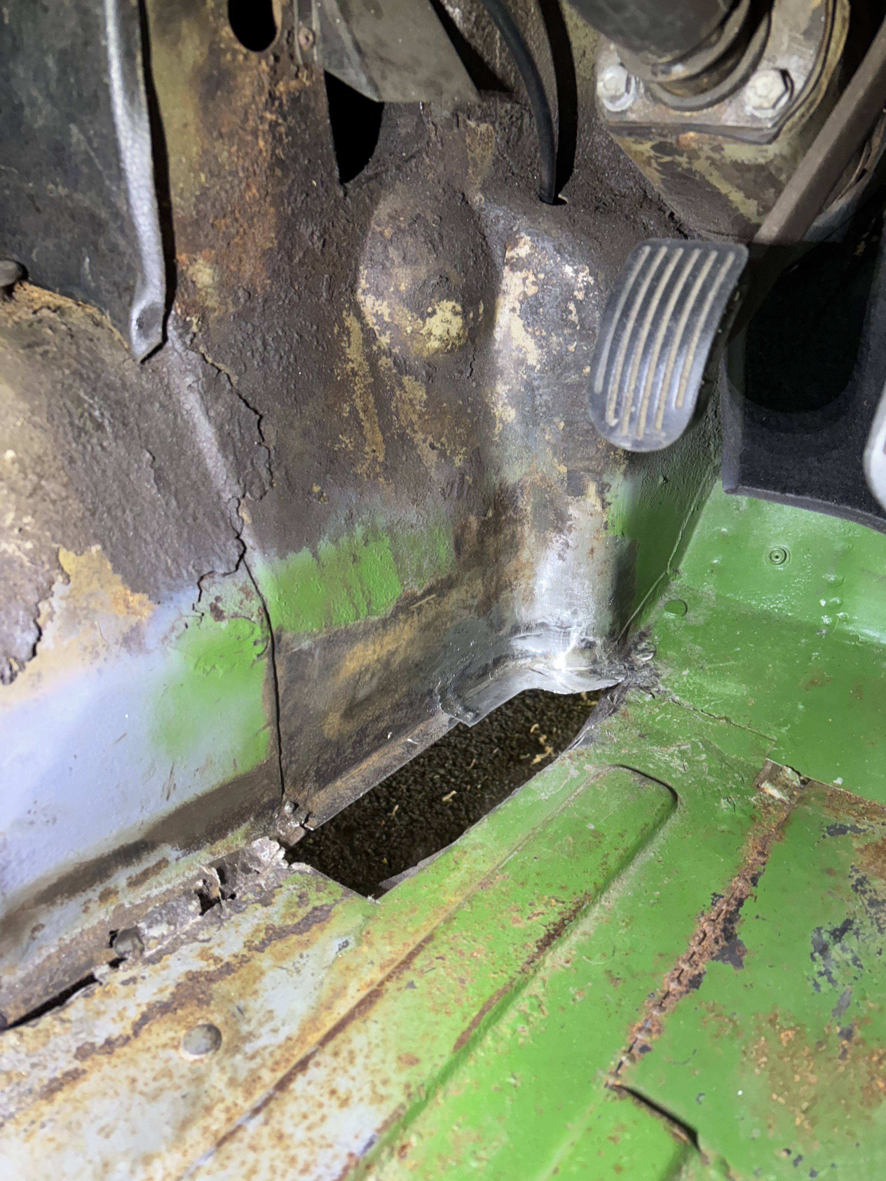

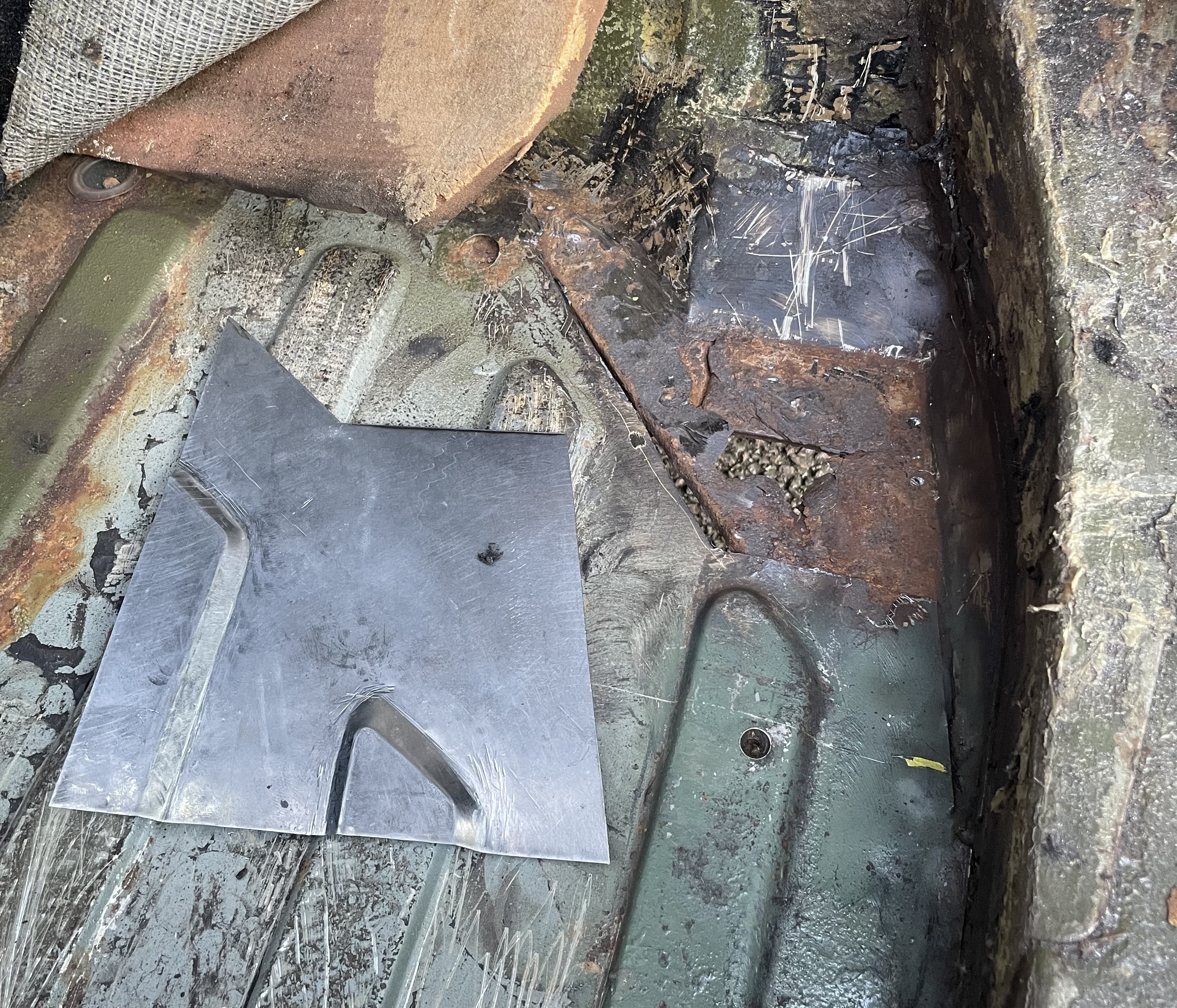

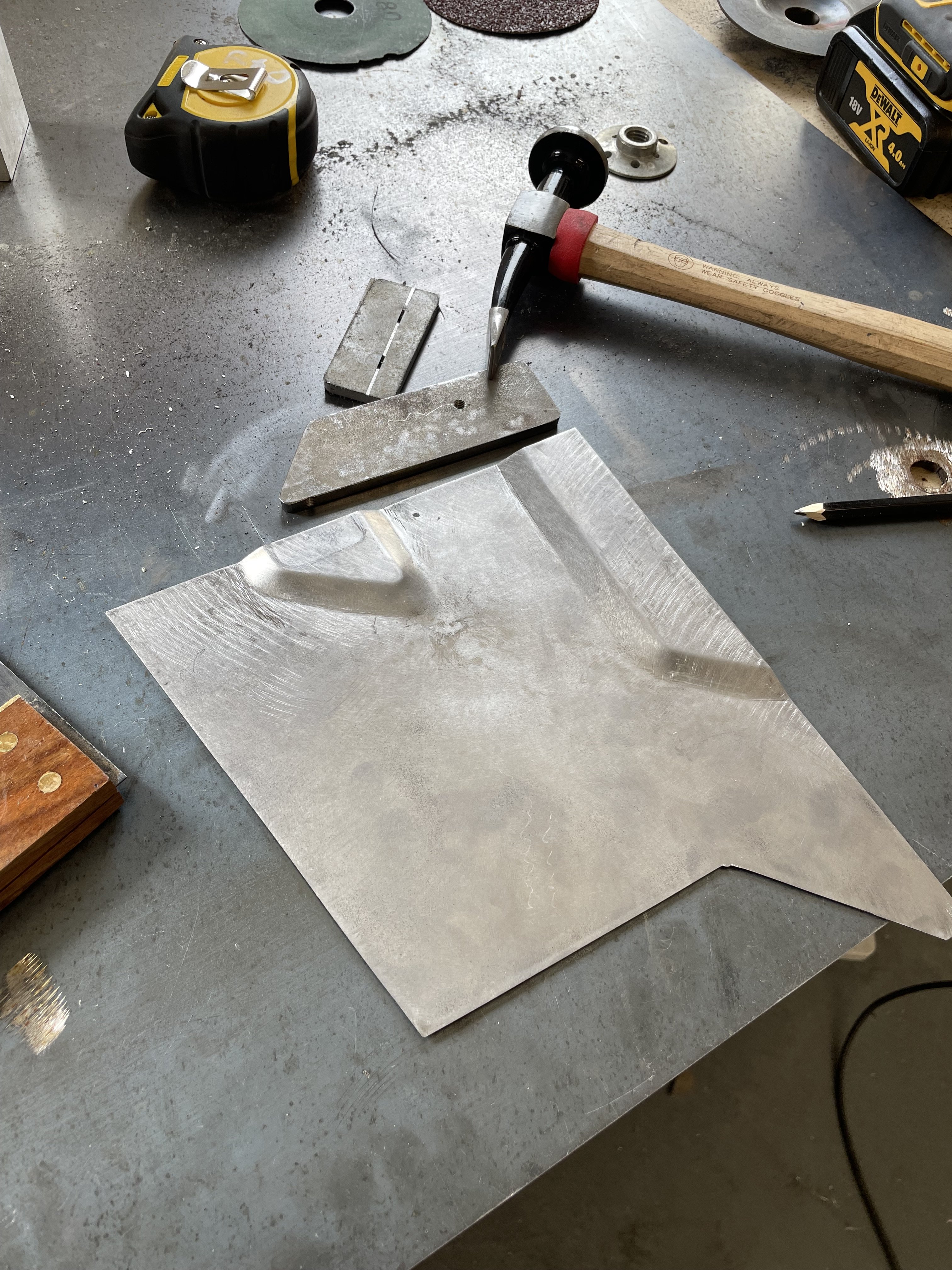

  6. Some couch based metal shaping… There’s an annoying little bit of rust on the radius corner of the trans tunnel that’s not part of the floor panel. So started on a patch to use when the floor goes in.

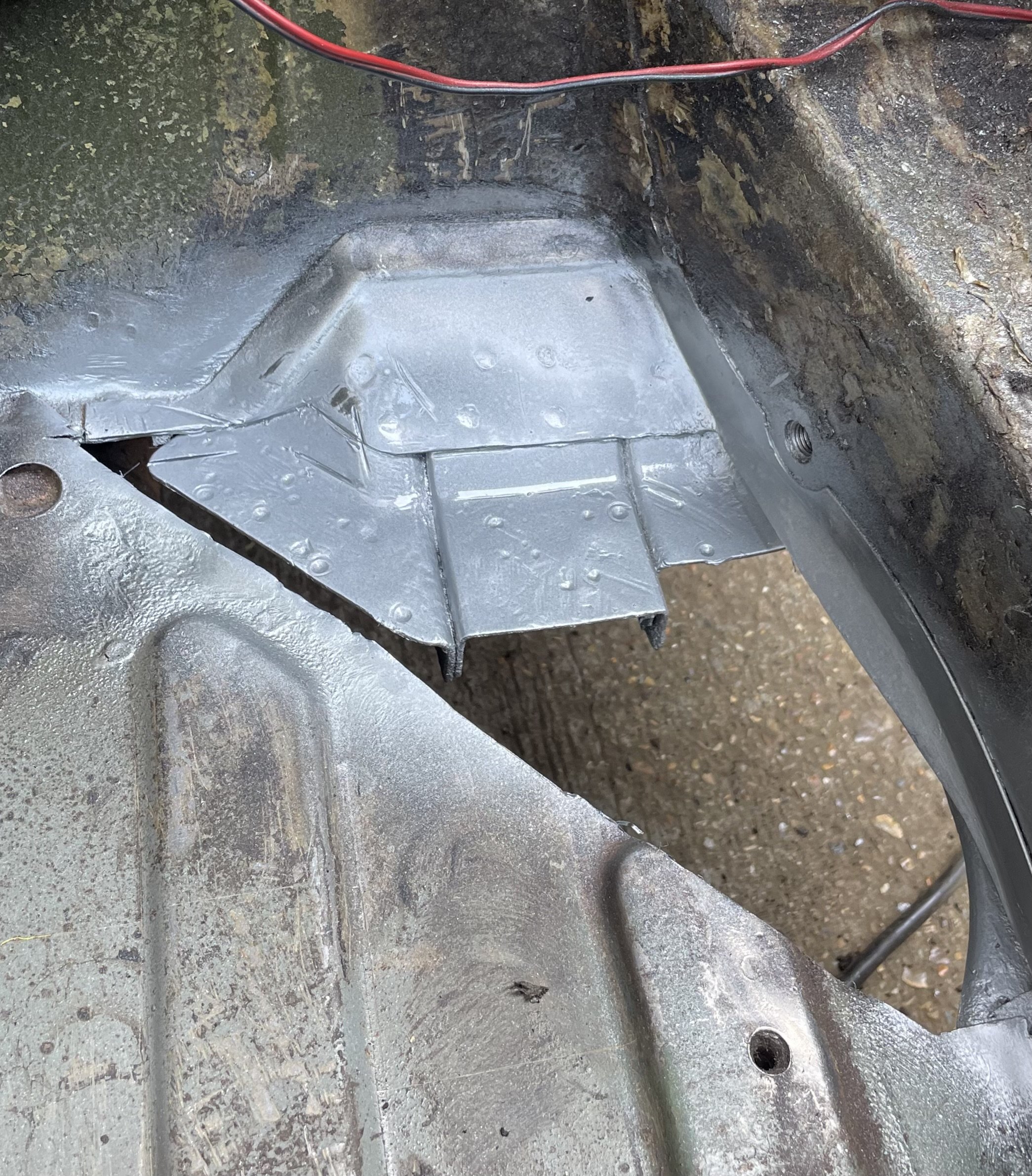

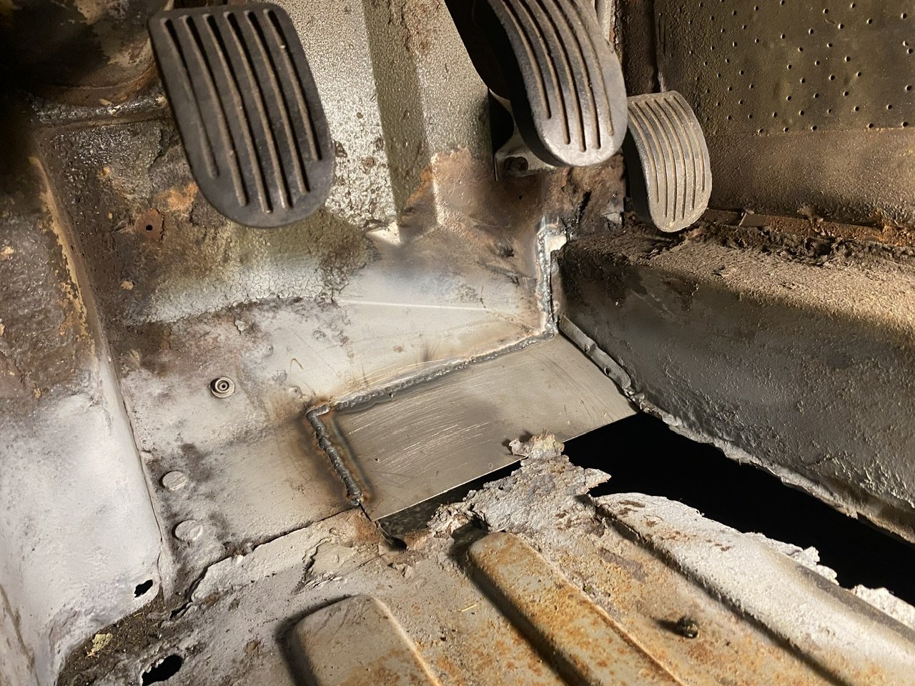

  7. I’ve repaired the front floor section and castlerail in preparation for the full floor to go in.

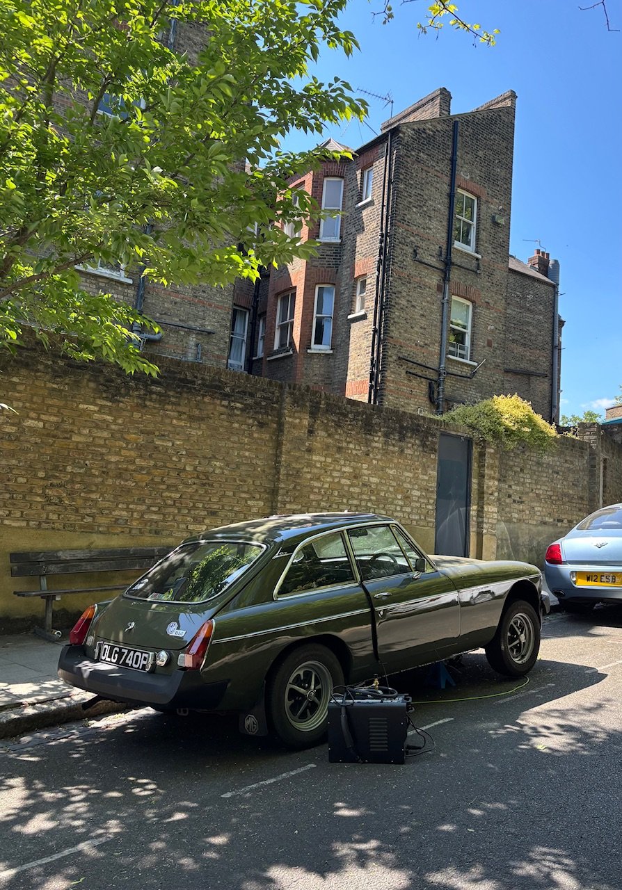

  9. Less than ideal working conditions…
  10. Not perfect but good enough for a floor.
