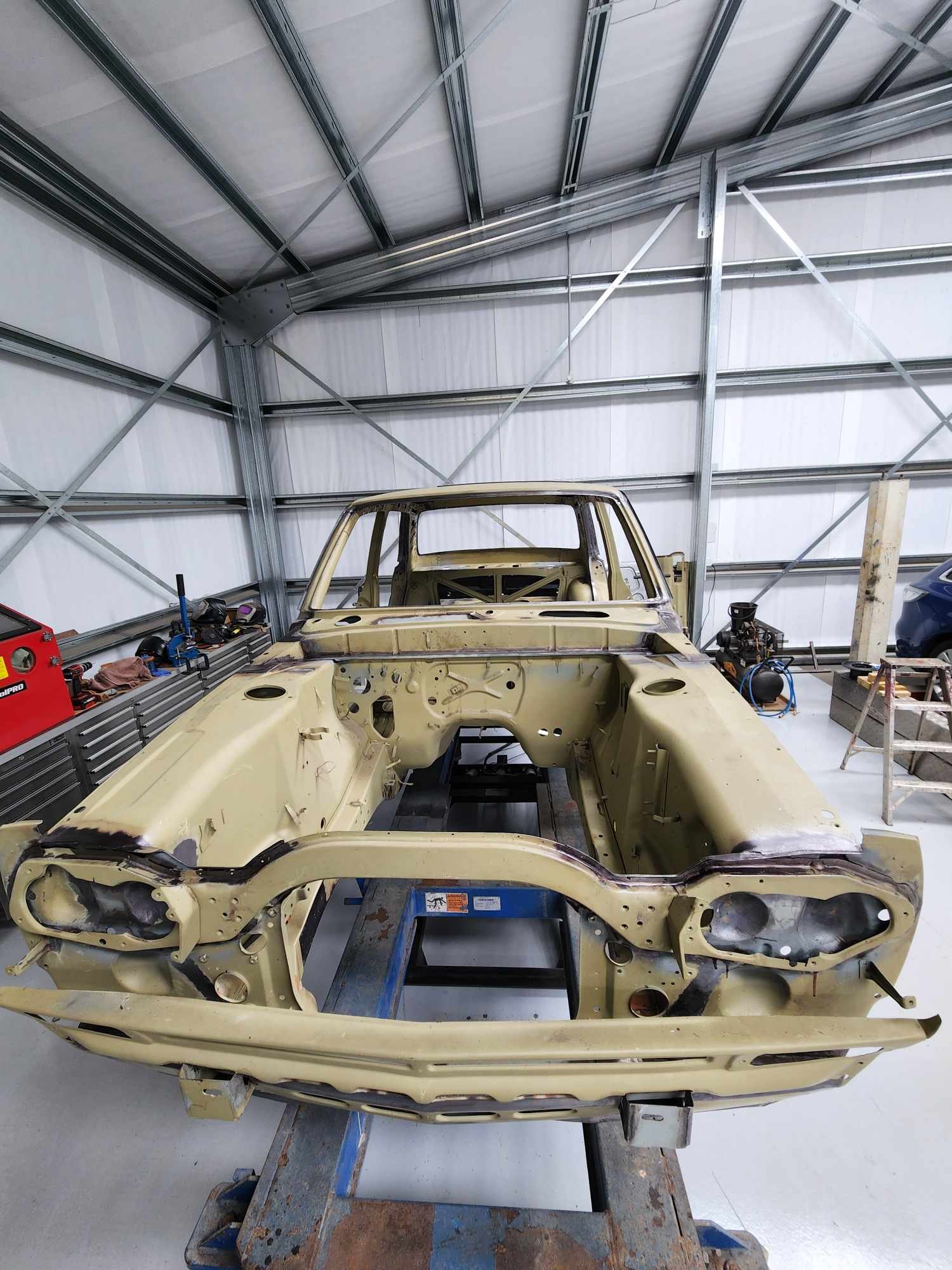

Popular Post mlracing.co.nz Posted October 22, 2024 Author Popular Post Posted October 22, 2024 It has a face again! 5 years maybe since it's had these bits fitted up, exciting! Great news is the car has measured up nicely with the engine cradle fitting up perfectly so panel Barry got his measurements done well; as expected. Once again thanks to Jon @ Strange Workshop for facilitating the delivery of those bits needed. Now the big weld up is on, he's started on the rear area plugging up lots of the drill holes, it's gonna be a long and tedious process. In between doing the rear arches and that section he's also been starting on prepping the roof panels and underneath all that for sticking back together. He said he's just finished up with a MK1 Escort race car which was taking away time from mine (which is fine, I'm not in a rush) but reckons will be able to smash a heap of welding out on it in the coming weeks. 14 Quote

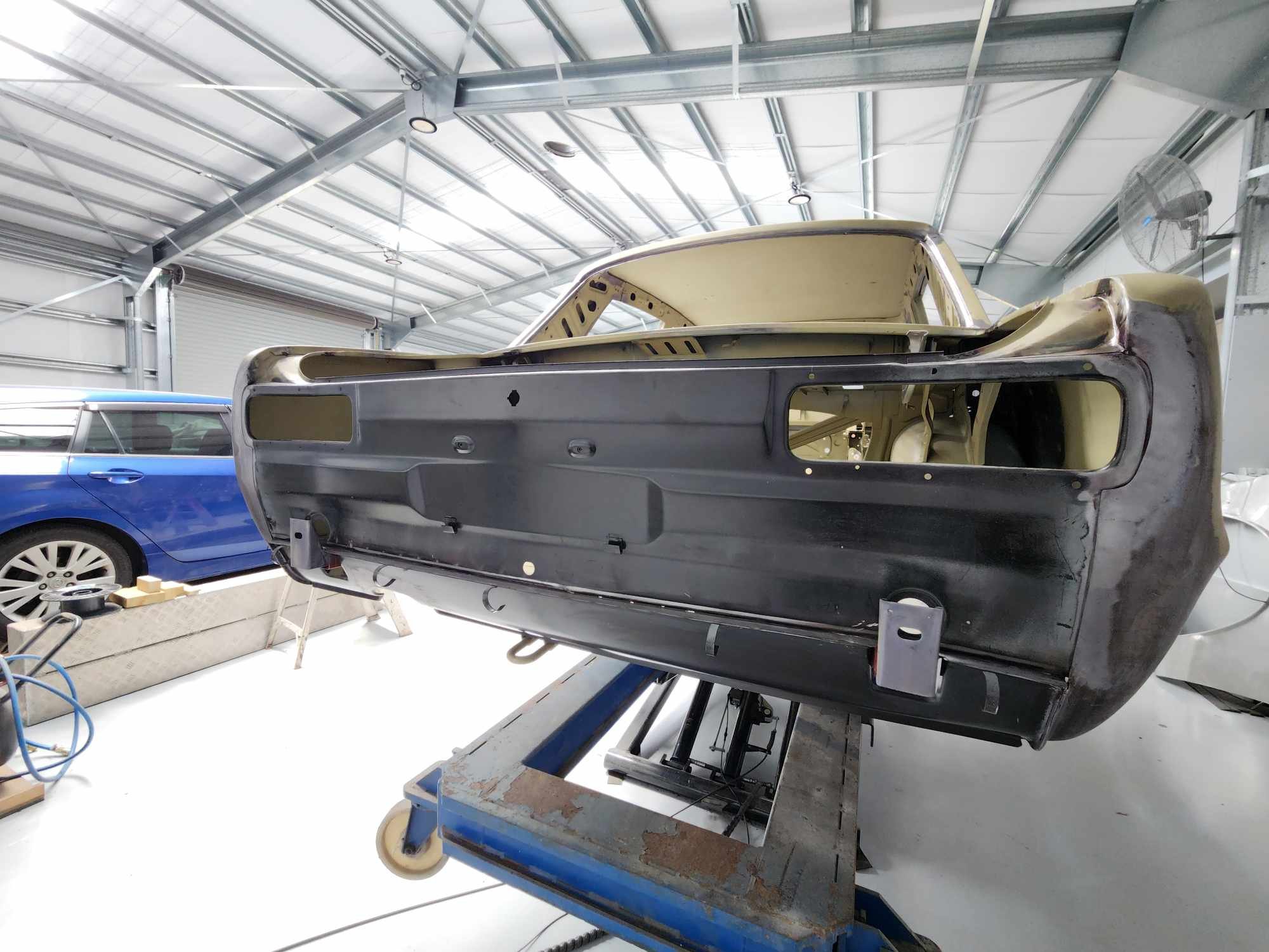

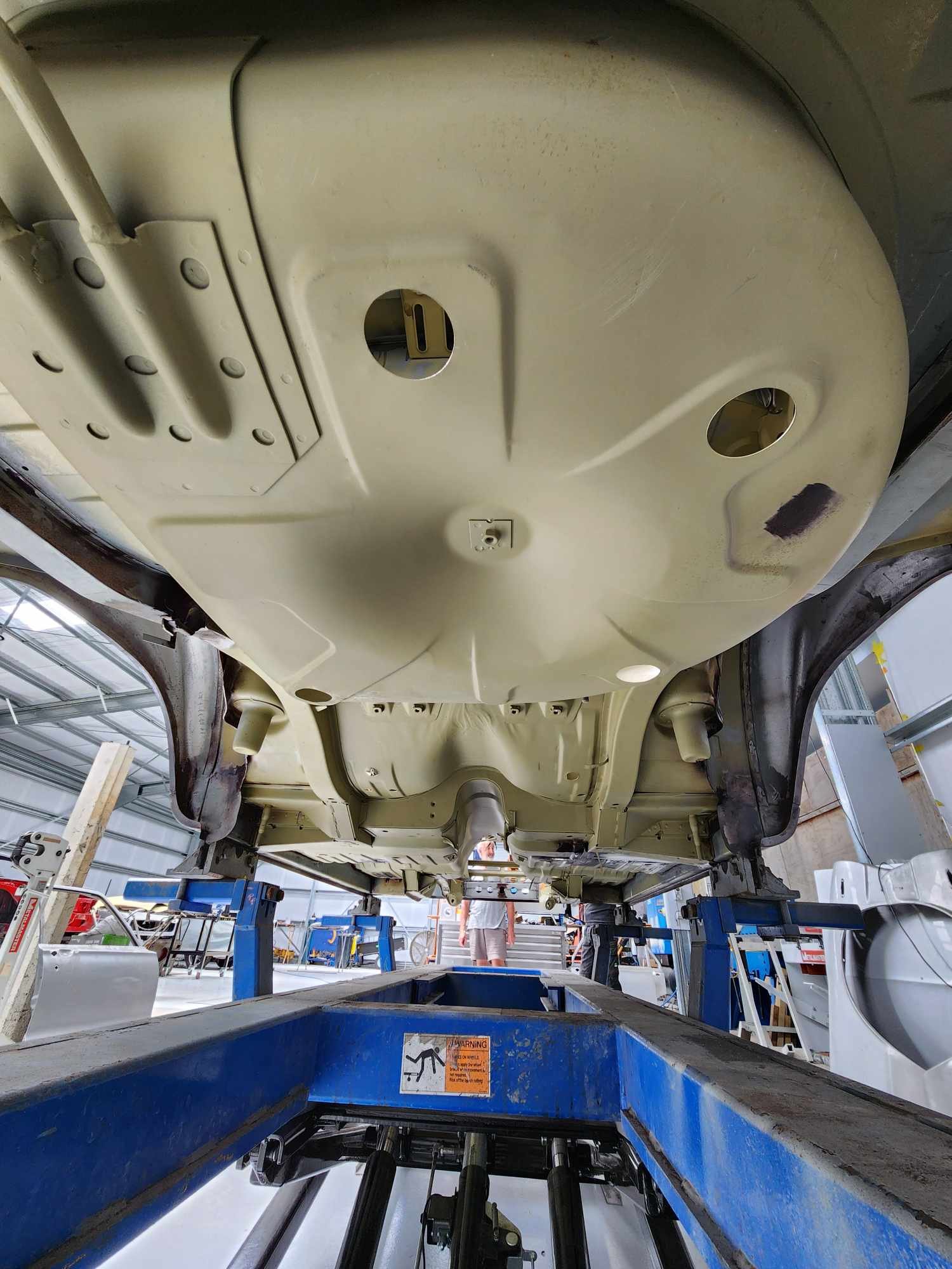

Popular Post mlracing.co.nz Posted November 21, 2024 Author Popular Post Posted November 21, 2024 Another update from panel Barry, more awesome news. The rear has had the replacement back and bottom panel welded on, that's looking excellent. Never know with the repop parts how they'll fit but seems to be good. Rear arches are all done. Front is all aligned and the bumper mounts are welded on. Next up is to finish up the drip rails and drains and get the roof on. Also need to see why the bonnet is rattling and do some fix ups on the doors. Boot I think is OK and doesn't need anything extra (but I'm usually wrong). 10 Quote

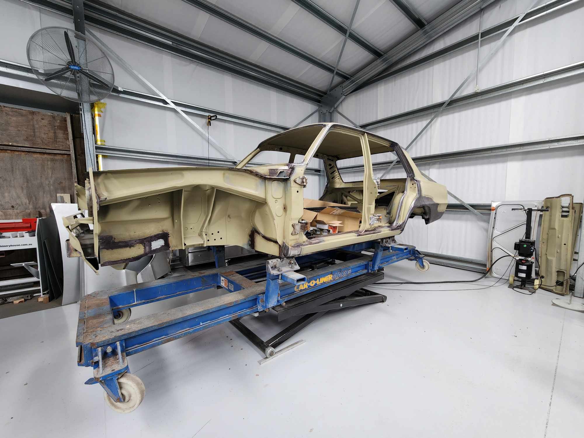

Popular Post mlracing.co.nz Posted December 26, 2024 Author Popular Post Posted December 26, 2024 Back in NZ briefly so managed to head out and see the Skyline progress and talk shop with panel Barry. It was great to see up close all the work that’s been done as well as he was able to tell me in more detail about what's been done and what's still to come. As has been mentioned earlier the main welding has been done but the roof still needs to be completed. A huge amount of work went into fully rebuilding/recreating the drip rails as they were all mangled and drilled out as part of the process years ago. A little more finishing of the actual roof attachment and then we are onto the paint preparation panel work. Good news is he can also do most of this so various primer/blocking stages and final fit will be done here as well then for the actual paint application it will go elsewhere but that was something I wasn't not sure about so I'm happy that blank in my knowledge was filled. So for now the boot is OK, the bonnet front edge has some rust and corrosion so will be fixed up but the doors are going to be the next ballache. The most likely strategy will be to dip them but due to them being multi-layered there is strategy required to get the best result. All of this I did not know before today. Still probably at least 6 months before actual paint yarns are on but it's going to be next year for sure. Speaking of paint it's not quite sure if this car was purple originally or white as both colours are showing underneath. 12 Quote

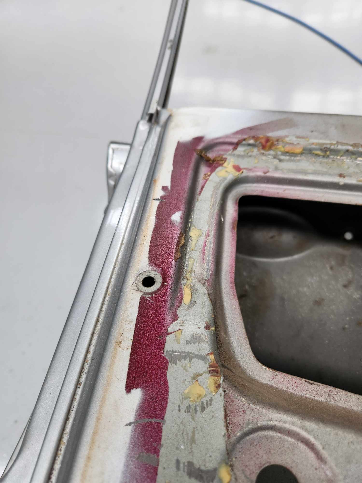

Popular Post mlracing.co.nz Posted May 26 Author Popular Post Posted May 26 Oh it's been a while since an update from panel Barry as he's been doing some other work while we've been deliberating how to proceed. He's spent a lot of time stripping down the bolt ons. Interestingly the front guards have bolt holes that were bogged up from flares in the past, as well as some other repairs. The guards themselves are fine, they'll easily work. The bonnet has rust inside the frame so a little tricky. I may look for a fibreglass bonnet to replace it as those are easily available, but then it comes down to cost vs having it fully repaired. It might not work out better either way. Depends what shipping might cost as the bonnets are around $5-600. The doors are a bit of a larger issue as in order to completely fix this 100% properly they would need to be split. Something that you would do if it were a Ferrari or something but for this it's not going to be cost effective. I don't think I'll be able to quickly find better doors in Japan as they're probably all cactus so the other option that was proposed is to patch them up best as possible and think of it as something to approach again in a few years time. Panel Barry is confident with proper sealing and decent patching they'll last a long while before they become an issue again. The boot also has some spoiler holes which were bogged up so they'll just get filled as I don't want a GT-R type spoiler, it's not a GT-R. You know that scene in The Joker where he lights the money on fire, that's what this reminds me of. I must say bog artists should be celebrated sometimes, master of sculpting. 15 Quote
