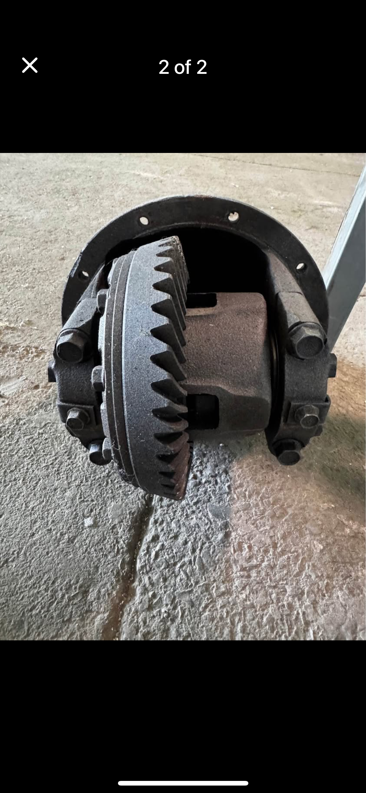

Popular Post shizzl Posted February 5, 2025 Author Popular Post Posted February 5, 2025 Decided to pull the nugget out of the current diff (was going to use the one in the new 4 link diff). glad I did, check out what I found!!! a 3.72 lsd the stock nuggy is an open 4.1 rocking horse poopy I have found, and look at the condition of those gears!! I need to find some coilovers now (QA1 or affco style) I have QA1 PROMA Star DS302’s in the front. will need something with slightly more travel in the rear. 20 Quote

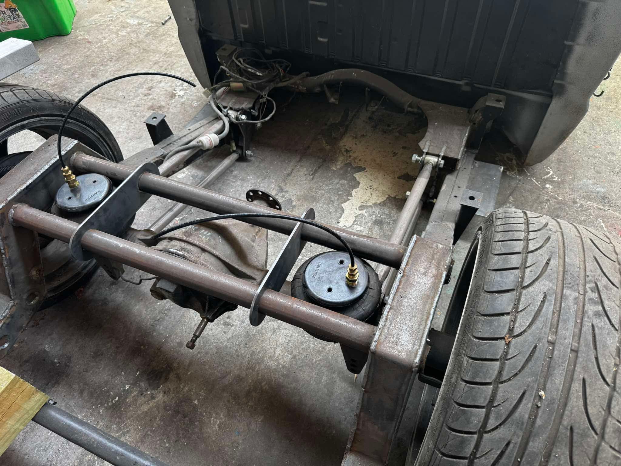

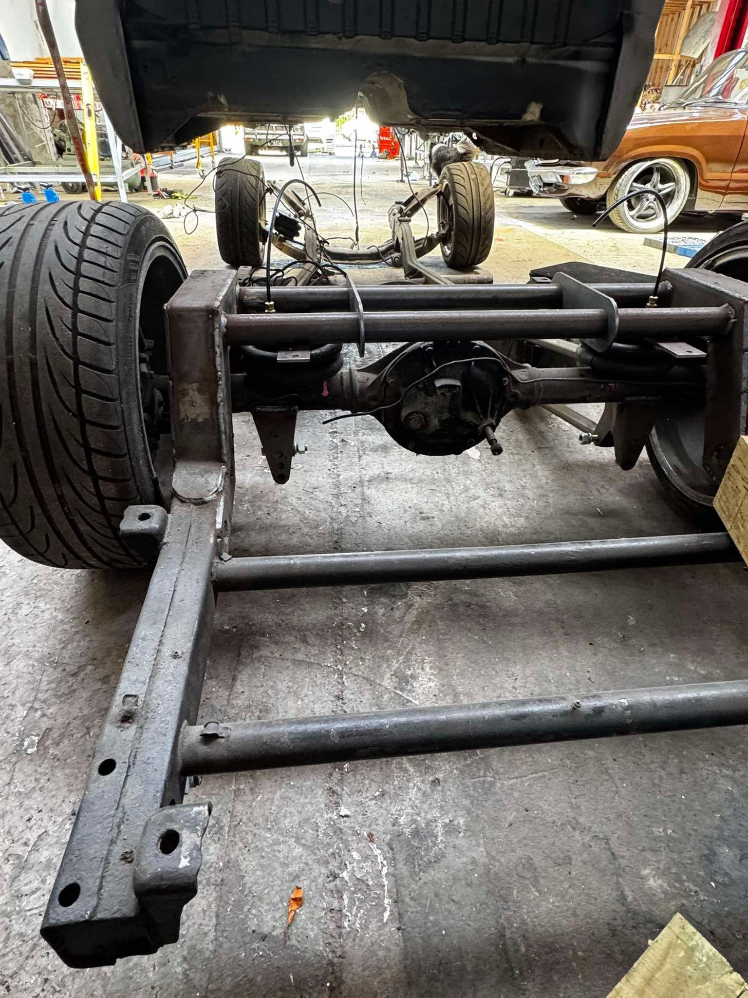

Popular Post shizzl Posted February 7, 2025 Author Popular Post Posted February 7, 2025 Triangulated 4 link completed. decided to cut off the factory spring mounts and relocate the forward lower link further forward. now I need to redo the brake line mounts, handbrake cable mounts, shocks and mounts, bracing for the fuel tank. I will set the ride height to have around 40mm between the chassis and diff and fit a bump stop either off the side of the chassis or find a Coilover with a built in bump stop. ideally I want to relocate the tank to go under the deck too 20 Quote

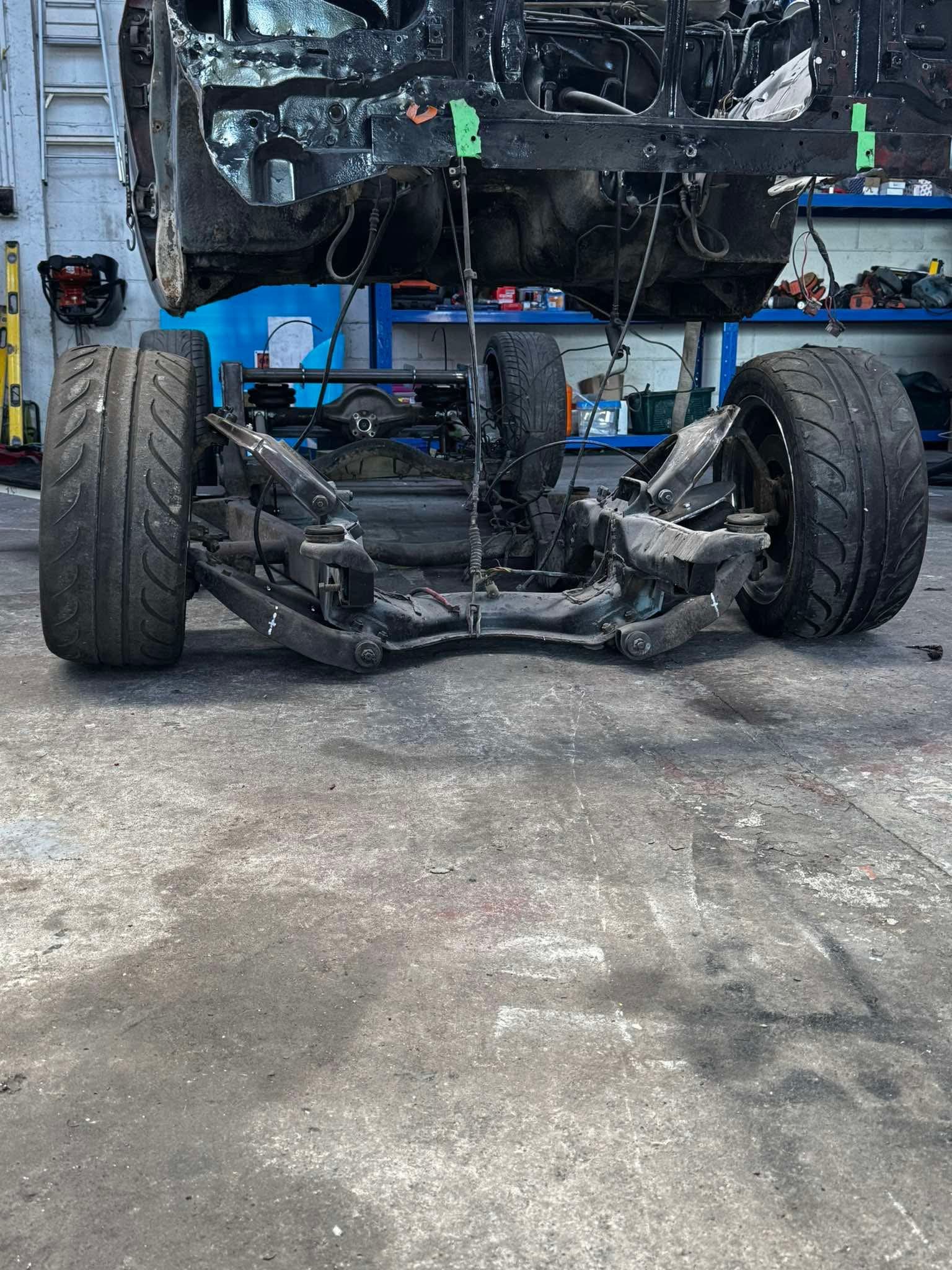

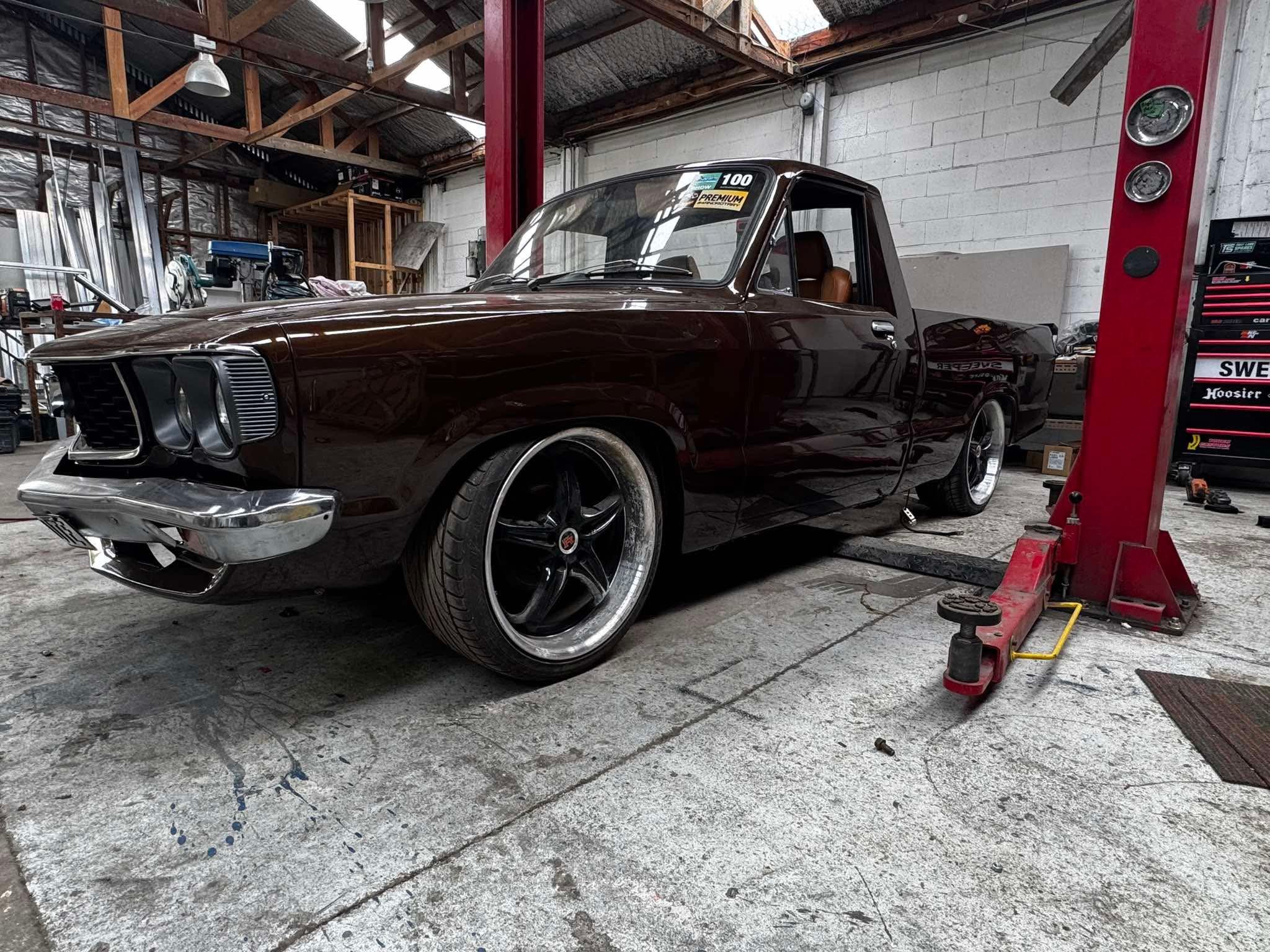

Popular Post shizzl Posted February 14, 2025 Author Popular Post Posted February 14, 2025 I had to swap the front coils to a heftier rate coil. then tried on the 19” DriftRs thoughts? 11 Quote

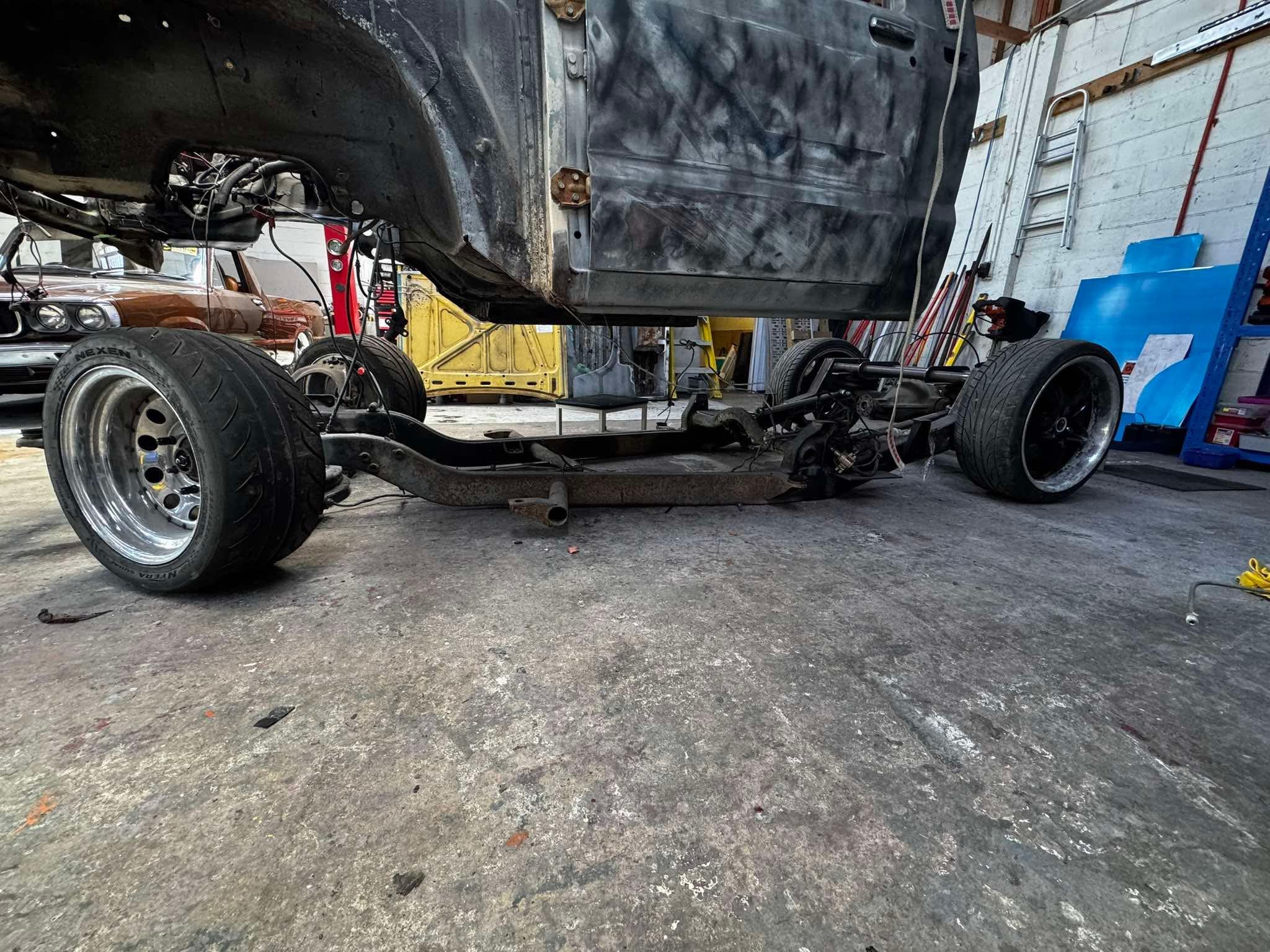

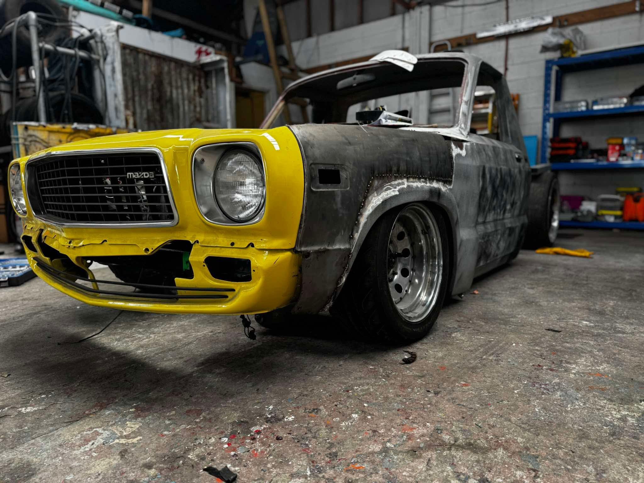

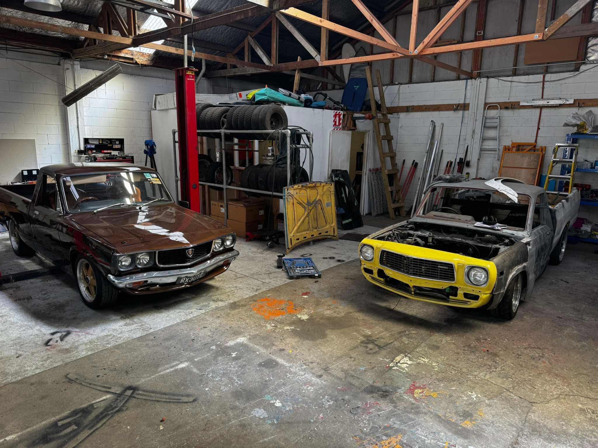

Popular Post shizzl Posted February 18, 2025 Author Popular Post Posted February 18, 2025 With the workers last day on board today I decided I needed to move stuff around. finally got the 2nd ute off the lift and sitting on its own with no blocks/stands and with wheels on it. it is fully laid out as it sits. The rear link boxes and bars clear the ground too so I’m happy with that. the front end, the lower arm bush area touches down first but will need the bump stops set up to stop scrub line or whatever it is for cert. then I decided I wanted the deck and cab off it. so we lifted the deck, now it’s standing I can cut it up for the notch. we made up a frame that sits in the trusses, and used tie downs to which the cab into the air. sorted. Now the chassis can be finished off and the cab bolted back on once the small rust piece is finished. RX3UTE is now in the hoist bay and the hunter is at the door ready for nats. pics for fisting pumps 17 Quote

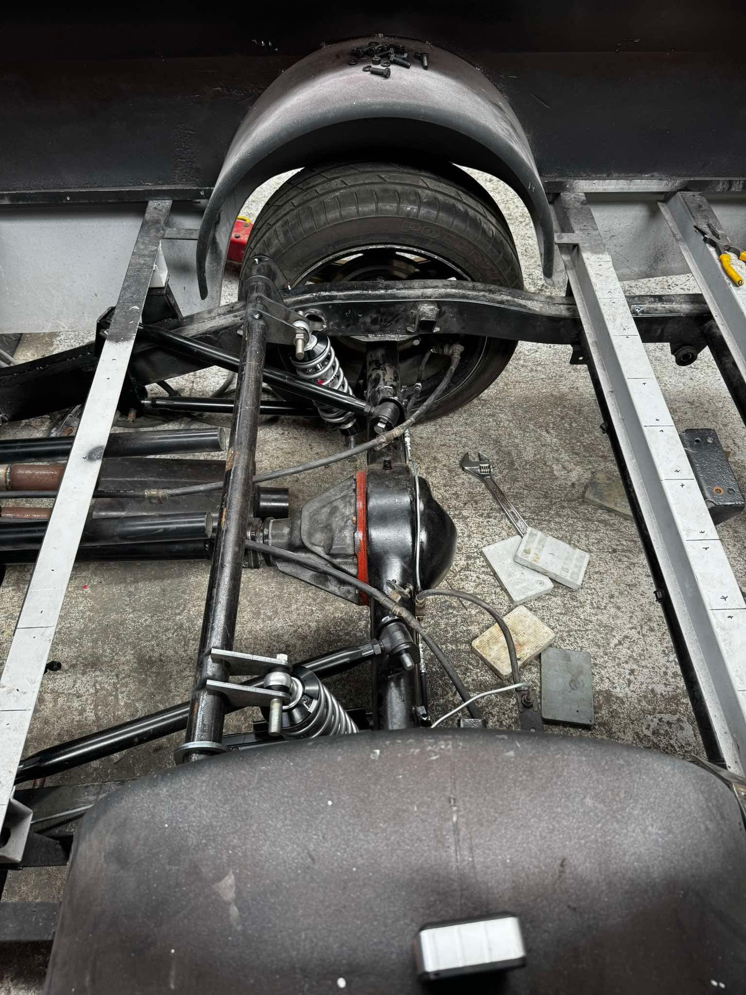

Popular Post shizzl Posted February 19, 2025 Author Popular Post Posted February 19, 2025 This is how it sits with the coilovers fitted. will swap out the 180lb springs for something more like 200/220lb springs or even bigger yet. as it sits, the coils clear the upper arms, but only just, so will move everything outwards 10mm and it’ll all be spot on. 15 Quote
