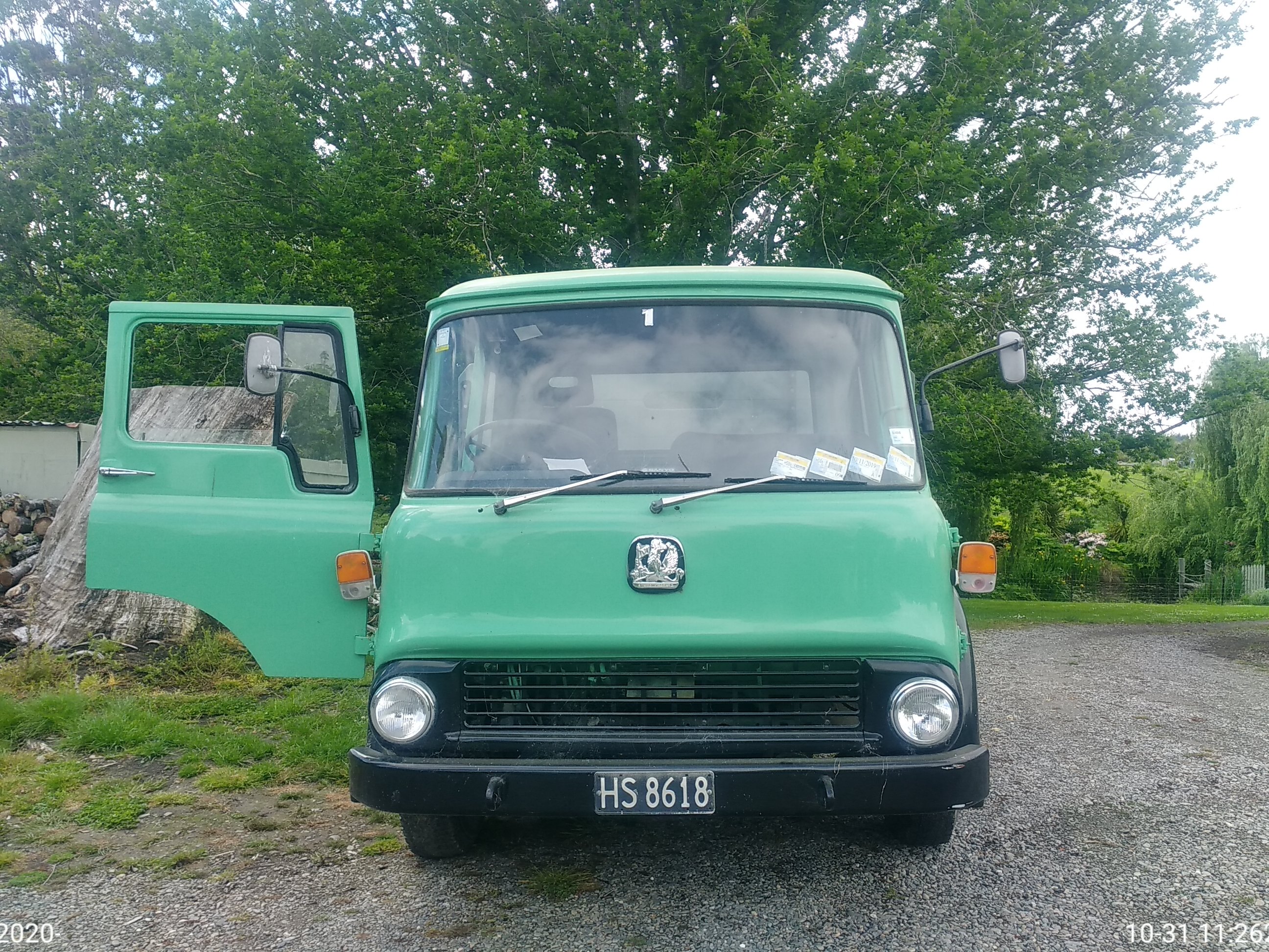

Popular Post Elle L Posted March 29, 2022 Popular Post Posted March 29, 2022 Where to start . . . . . . Probably with my truck, Maddi, that I bought on impulse after the love at first sight viewing when I wasn't even looking for a truck! While a truck wasn't particularly in my plan building a little house has been a dream of mine for quite some time. Spending my childhood with Dad and Popa constantly in the garage working on neat old and home made cars it seems fitting that I have ended up with my very own old school truck So this project is part reviving a neat old truck and part building a house! Hopefully it may be interesting for some of you, and you may even have some tips and tricks to share, as this is one whole new learning process for me Also please bear with me as I figure out how to navigate this forum, thanks! 37 2 Quote
