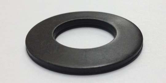

Five will fit. Angelman went down this road and says he has no problems.  However half of my original washers were perfect and after the evaporust the other half looked pretty good (red's ones were all trash), and should survive for a while covered in grease, so I decided to re-use them.  Here's after the evaporust and before wire wheeling and greasing.
Reassembly time!  You can see the post-brush washers front and centre.  Everything here has been slightly greased with brake grease.

There's a chance I melted one of them a bit and used the black car's washer. A chance.
Then, with difficulty, jammed everything together as hard as I could. The manual I have explains every detail of the fuel system EXCEPT for the fuel pump, which is quite both surprising and annoying.
