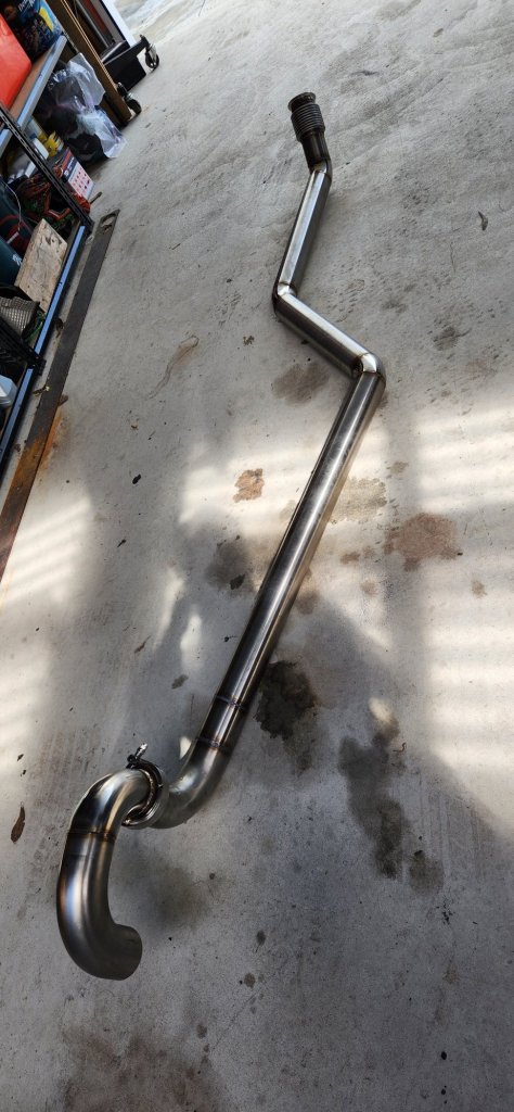

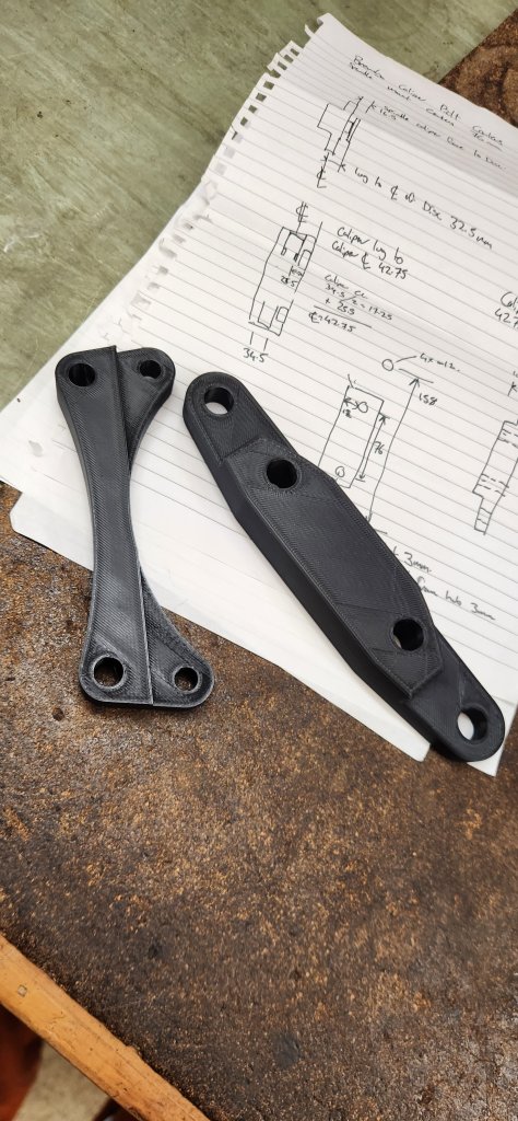

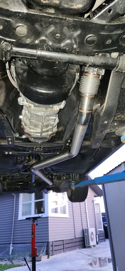

Popular Post vk327 Posted November 3, 2023 Author Popular Post Posted November 3, 2023 Had a few hours free after a customer wiring job so smashed out the 3" stainless exhaust, no Instagram welds here but tidy enough best part it doesn't hit anywhere... Also how good does the paint look in the evening light 23 Quote

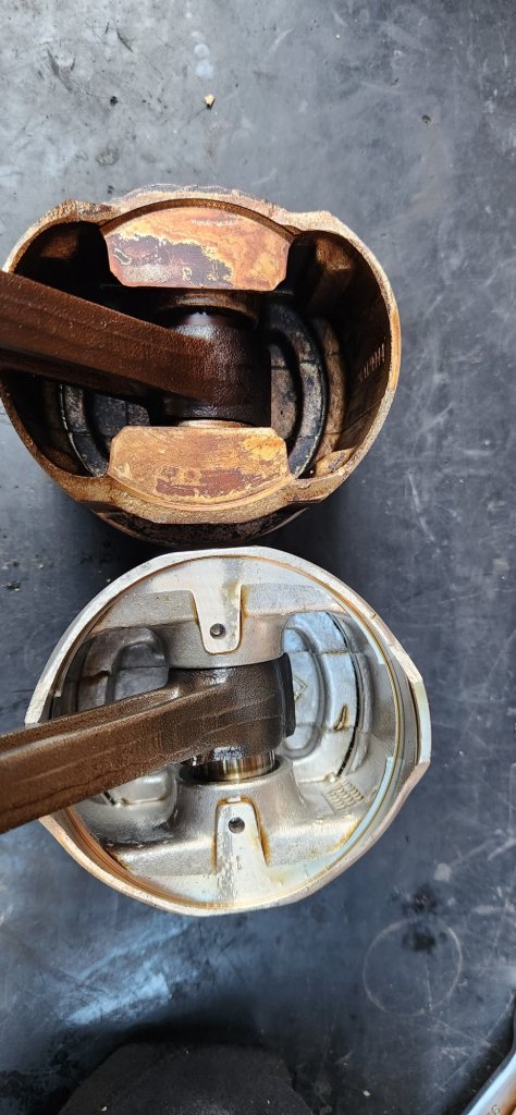

vk327 Posted November 7, 2023 Author Posted November 7, 2023 Well after so much progress on this thing and booking it for dyno tune tomorrow, it gives me a swift kick in the nuts... had it running Saturday everything fine bled coolant all good... took it for a drive last night all seeming well pulled back into the shed and a weird rattling noise getting louder and oil pressure at idle dropped to 12psi, chasing it around with the screwdriver on the earmuff stethoscope. jacked it up and hello Rodney knocking sound from the sump. Shut it off and drained the sparkly oil out all 6.5 litres, weird I only put 4.2 in there so I think an injector is stuffed and may have hydrauliced a cylinder. Mates coming round tomorrow to give me motorvation to pull the engine out and contemplate it's future. 1 21 Quote

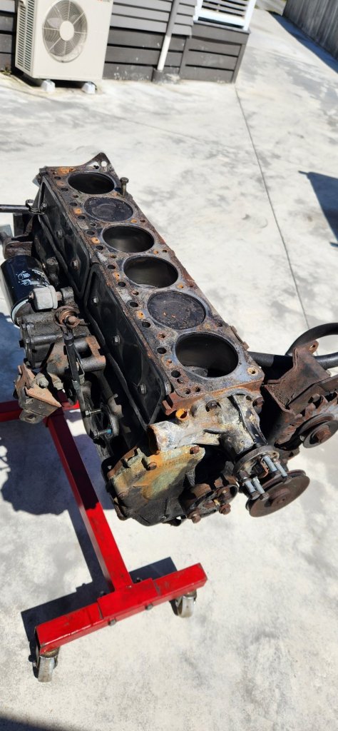

vk327 Posted November 9, 2023 Author Posted November 9, 2023 Well torn it all apart, alot of wear for a motor with 5000k on it glazed bores,ring gaps are all over the place some are +52 thou others around 30, bearings have all had shit go thru them no6 bore is trashed massive fuel contamination in the oil gonna be a new block needed now I think the noise was coming from crank slapping overfill sump from the fuel in the oil 1 14 Quote

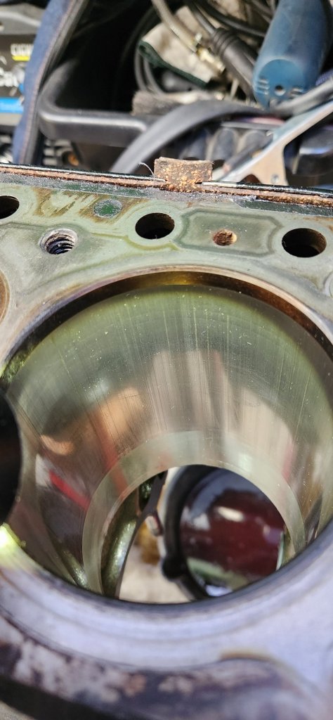

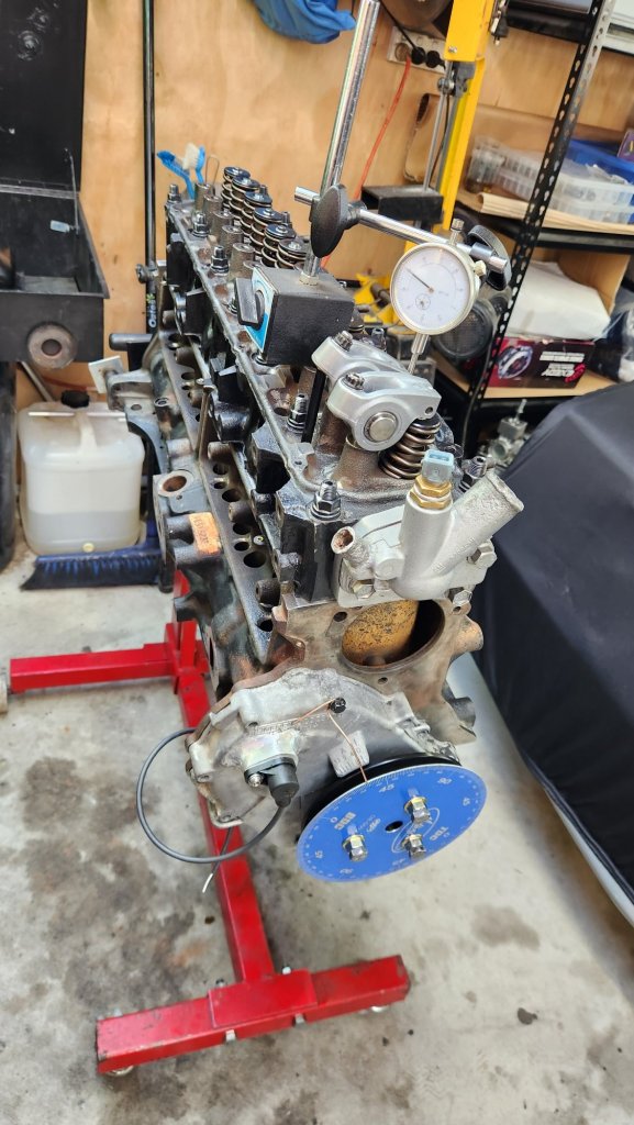

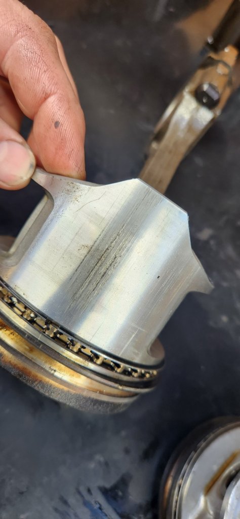

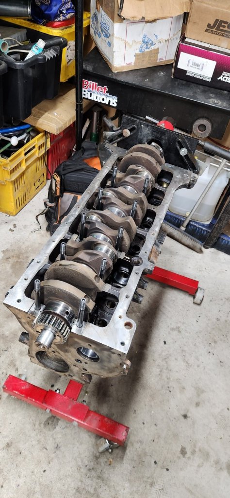

Popular Post vk327 Posted November 12, 2023 Author Popular Post Posted November 12, 2023 Came so close to dropping my turbo barra in this... but just picked up this somewhat ugly looking 3.3 should work for what I need only 120k on it, stripped it down, small mark in no5 but hopefully my 030 over pistons can clean up and bore to suit with new rings, crank looks good so should get away with a polish balance and re assemble On a side note can see why the factory piston used to break the skirts off 15 Quote

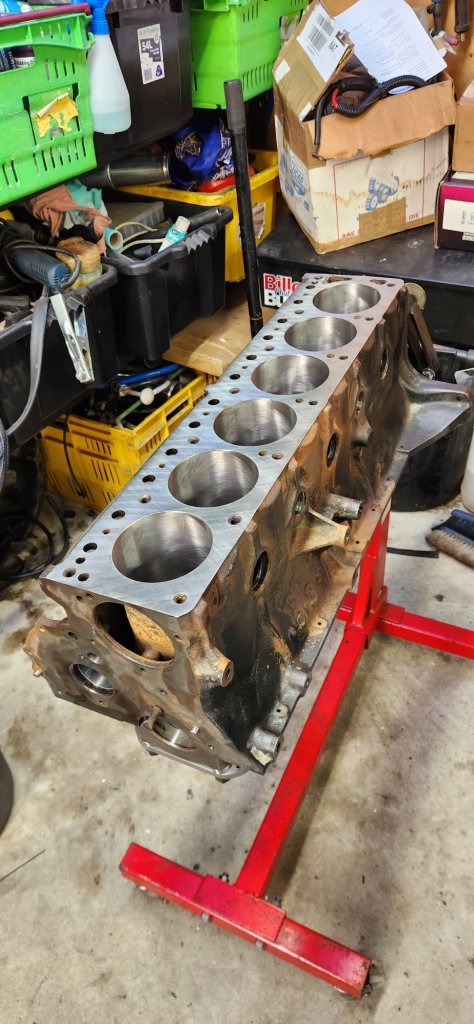

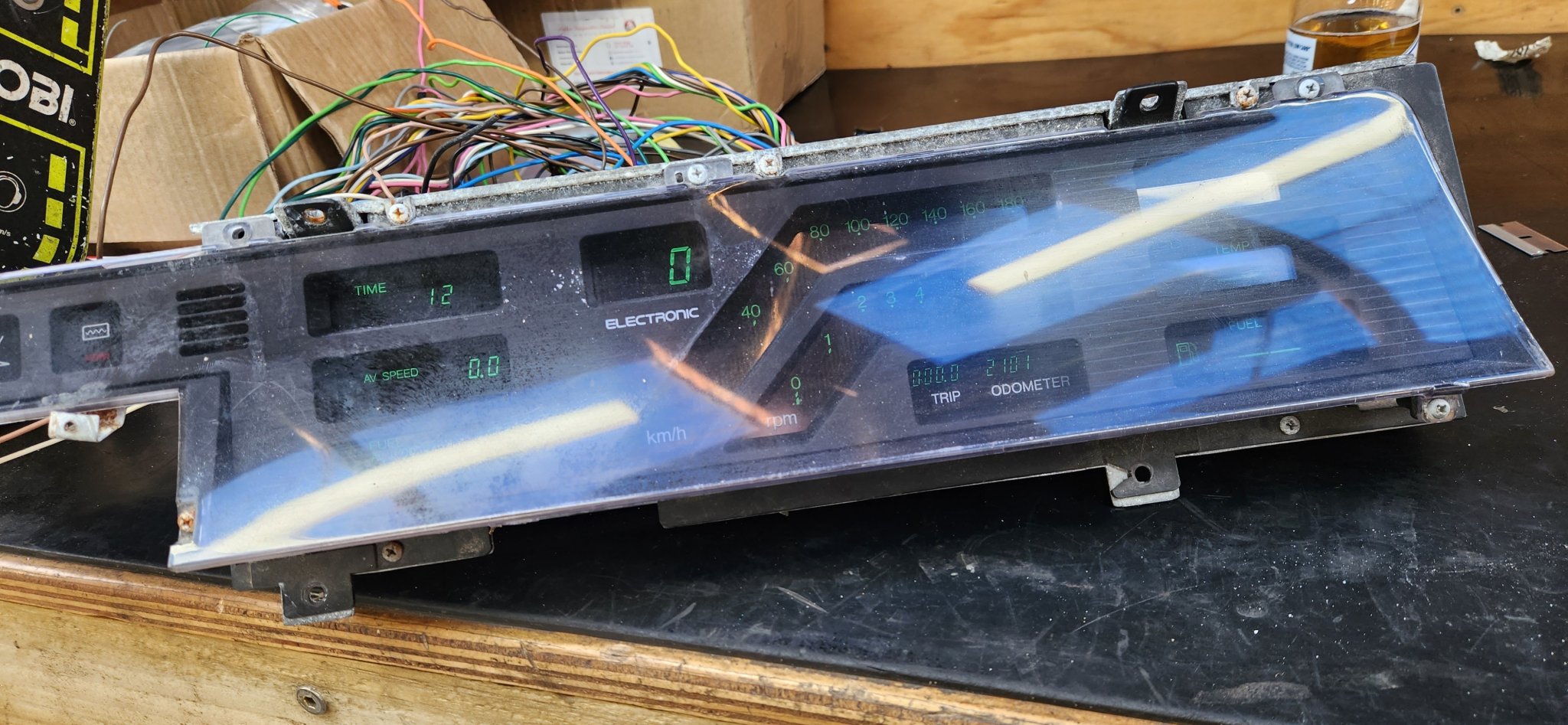

Popular Post vk327 Posted November 26, 2023 Author Popular Post Posted November 26, 2023 Replacement block heading off to Marsh motorsport this week for machining and rotating assembly balancing, gone to a new clutch with a sprung plate to make it nicer on the street. Got distracted on a side quest, vk calais digital dash popped up on market place. Not cheap but so much 80s cool. Gonna set it up all running off ecu outputs maybe a canbus io module, so it will be fully functional including fuel used & distance to empty and can calibrate it so it reads right 26 Quote

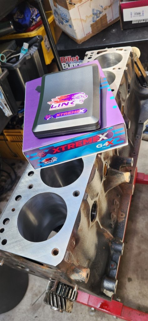

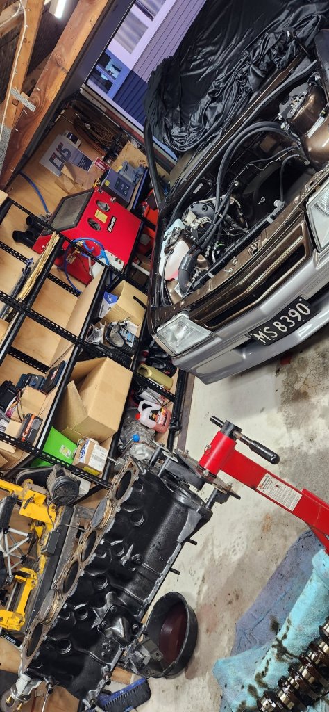

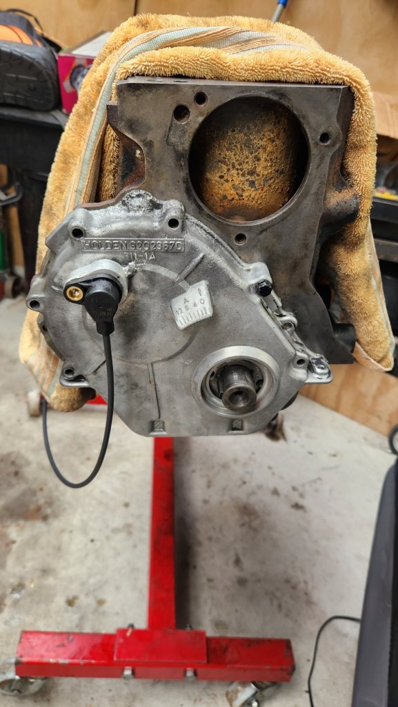

Popular Post vk327 Posted December 10, 2023 Author Popular Post Posted December 10, 2023 Real impressed at Marsh motorsports turn around at this time of year, only a week to have it all ready to go, bored, honed, decked, crank crack tested & polished, ring gaps and bearing clearances set and the rotating assembly all balanced Got the bottom end all assembled need to find my cam card to dial that back in. And cause I'm not busy enough already have decided to go full sequential and drive by wire throttle with a link xtreme so now onto new wiring loom build and setting up a custom cam sensor for sequential sync signal 18 1 Quote

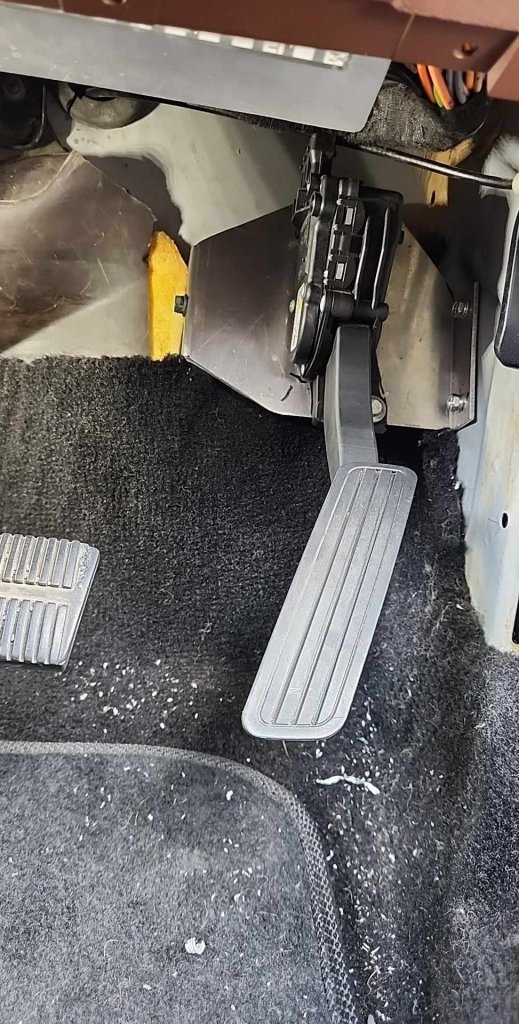

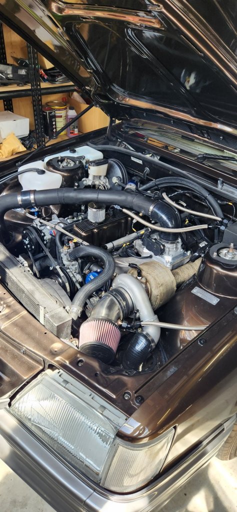

Popular Post vk327 Posted February 7, 2024 Author Popular Post Posted February 7, 2024 Been busy getting everything back together, got it all running again on the monsoon and run the cam in with new lifters after finding a cracked lifter face. Alot of work into building a custom cam pickup for sequential triggering built the new wiring loom for the xtreme and fitted it all up last week, made up mount for the LS coils, adaptor for the e-throttle and mount for the pedal. Off for dyno run in time and tune tomorrow 14 Quote

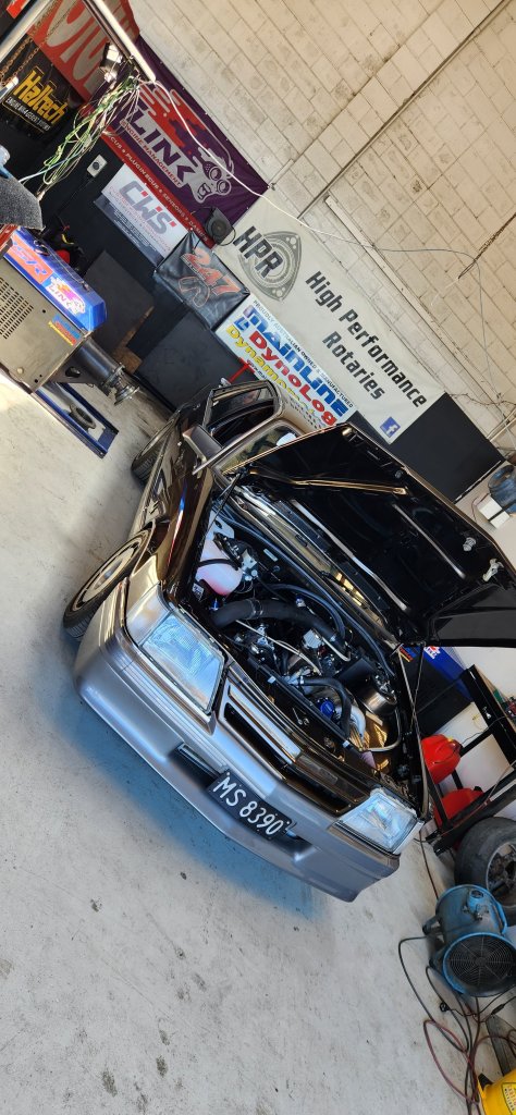

Popular Post vk327 Posted February 8, 2024 Author Popular Post Posted February 8, 2024 Good day on the dyno engine run in went well few teething issues with the e throttle PID control making 190rwkw just under 9psi of boost, running a bit of water meth up top rapidly dropped the intake temps from 35degrees down to 24. Will dial in some more boost later once clutch has bedded in properly. Time to get a wof tomorrow and enjoy it. 31 Quote

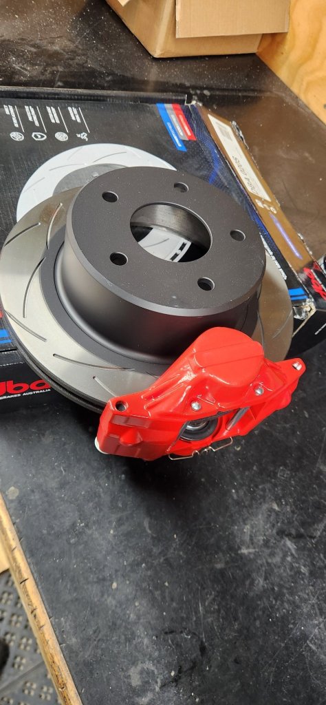

Popular Post vk327 Posted June 24, 2024 Author Popular Post Posted June 24, 2024 May have got a bit carried away with a brake upgrade to do a few track play days... evo8 brembos for the front on 320x32 vz thunder rotors, and z32 twin pots for the rear on 280mm vented vn group a rotors, all brand new bits makes a nice change to having to rebuild old manky brakes Should be pretty easy job to machine up adaptors to suit 16 Quote
Popular Post vk327 Posted July 2, 2024 Author Popular Post Posted July 2, 2024 and down the rabbit hole of 3d printing i go... , brought an ender3 v3 se to have a play with got the adaptors version 1 ready to print when it arrives fronts for the evo brembos Rears to suit the z32 calipers & cutting the backing plate to fit 18 Quote
Popular Post vk327 Posted July 3, 2024 Author Popular Post Posted July 3, 2024 New printer works pretty good, printed dimensions are spot on, now waiting on bolts to test fit and check what i measured is correct, probably not... but hey that's why it's 3d printed 19 1 Quote

Popular Post vk327 Posted October 9, 2024 Author Popular Post Posted October 9, 2024 progress on the brake adaptors, a few chunks of 4140 now match my 3d printed models and fit spot on thanks to Moose design for sorting the machining, there's even hope to keep the corvette wheels it's super tight but they do clear in the 16"wheels 21 Quote
