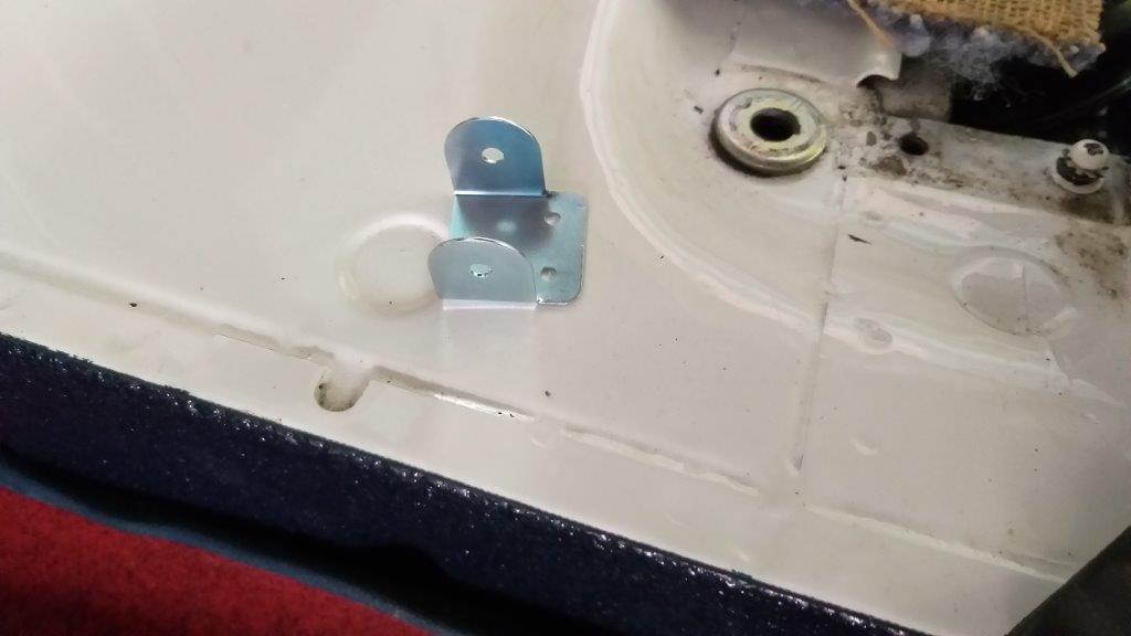

Flash Posted April 20, 2021 Author Posted April 20, 2021 Today I took the bull by the balls and poked a ruddy great hole in the sheet metal under the drivers seat for the additional brake fluid reservoir. Started with a 15 mm pilot hole which is the size of the bolt on my 50 mm chassis punch. The chassis punch made short work of the cab floor and I then poked the 3 smaller mounting holes for the bracket. I cleaned and painted the second hand mounting bracket that I got in from the UK and gave the new reservoir a few coats of satin black to match the existing one. I've ordered 2 meters of 3/8 EPDM fluid reservoir tube which should be more than enough to plumb the dual reservoirs to the brake master cylinder. 8 Quote

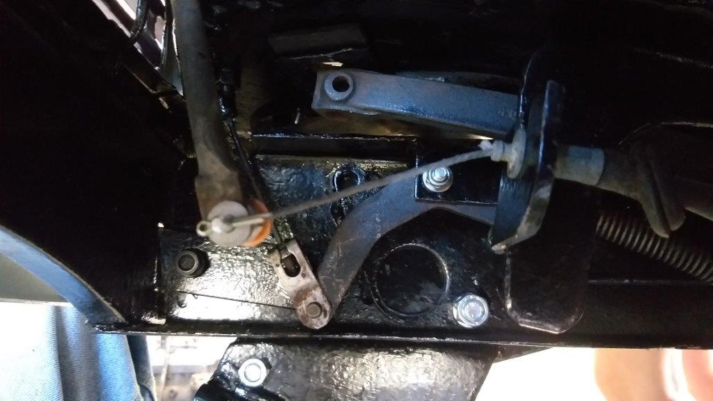

Flash Posted May 9, 2021 Author Posted May 9, 2021 There is nothing nicer than a bit of metal carving on Mum's Day, so this morning I fired up my trusty grinder of angles and before morning smoko I had myself a mark two version of the accelerator cable bracket. The two brackets side by side show the difference in style. 4 Quote
Flash Posted May 9, 2021 Author Posted May 9, 2021 After smoko I slapped it in for a test run. The photo below shows things under full throttle. Much better. Will give the pie cut a quick tickle with my glue gun before I slap on a few coats of Hammerite. Thanks for looking. 8 Quote
